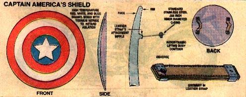

The shield should is 30" wide and based on the picture in the 1985 Marvel Universe Handbook, it should be about 3.5" thick. On the card Jannix Quinn posted, it works out to be between 3.5" and 4".
Here is a Picture from the Marvel Universe Handbook:
And a link to the page about the shield I found:

Since the Marvel Universe details Say the size is 30 inches in Diameter, I would go with that for accuracy.
