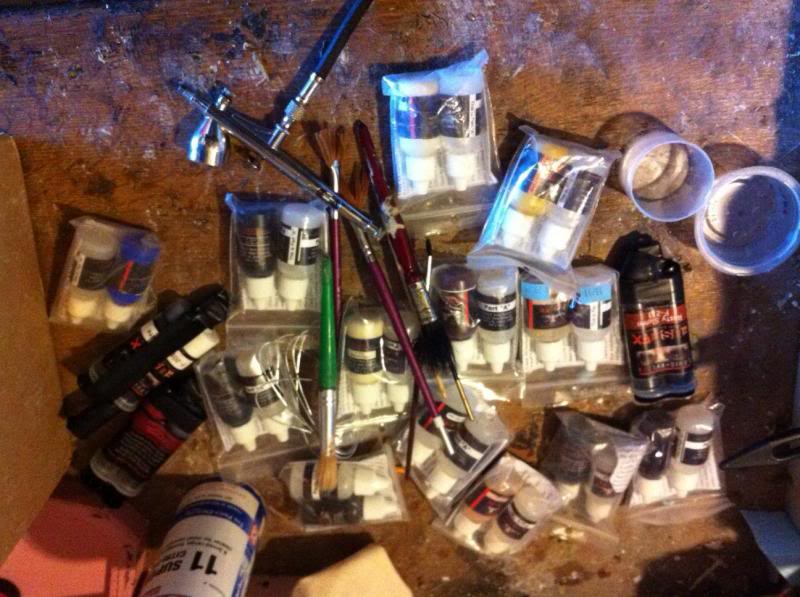

Tools for the day were.....................
Reference for the days was...................
End of the day was..............

the undertones were done by stippling with a brush, then some blending with a airbrush, but the veins were all done with a airbrush , there are quite a few smaller ones but its hard to see them in the photo.

MeanGene. I think I read or was told silicone should be painted ideally in the 1st 7 days of it being pulled from the mould. however I did not paint the hand I have for about a month and it was fine, but I do not want to take the risk really.

No idea on cooling as yet Drew, it fits very well in most places, so im not sure I may just sew some pockets on under armour and stuff them with ice cubes lol.
munson said:
The colors are simply stunning. The FuseFX seem to be well worth the cost with how they look. But yea, bookmarked your thread and going to start on one. Too inspirational! Keep up the great work!
Yeah I love the system, do not like the price, but it does what it says on the tin haha.
