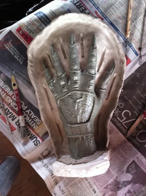

here goes the hand. just going to round off the edges of the locator slots, then clear coat it before gelcoat sexy time. this was a pain in the arse to get the dividing line where i wanted it, i actually headbutted the table at one point trying to see if i had any gaps lol.

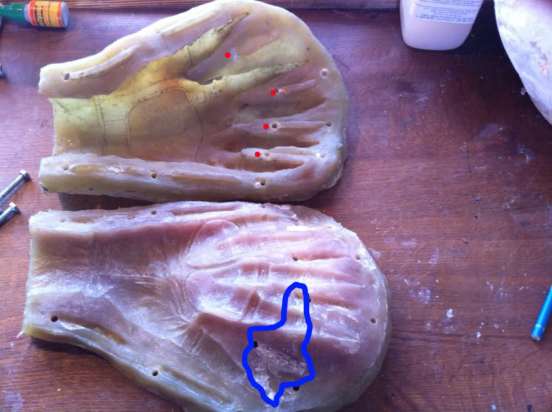

Ok, aaaaaaall fixed ( i think )
After Dremeling down the poly resin runs inside the hand and filling the crack ( all inside blue ring ), it made me think , maybe they were what was stopping the mould butting together, and maybe it had not warped.
Sooooooooooo i drilled some new bolt holes half way down the fingers ( red dots ) and after i had cleaned out the clay , i bolted it back together, apart from the middle finger, all the joints line up fairly tight, and the middle finger has approx 0.5 of a mm gap near the base of the finger.
conclusion = i dodged a bullet i think, i will probably make a glove tomorrow so see if there are any bad areas, epoxy sculpt will be setting in the crack until tonight anyway. ( again inside the blue ring )
I also placed my hand inside the mould and put the 2 halfs together, it feels ( more manly guess work ) that there is approx a min 5mm of movement all around, bigger in some areas, which is alittle thin i guess in places, but silicone will stretch so i am really not too botherd
