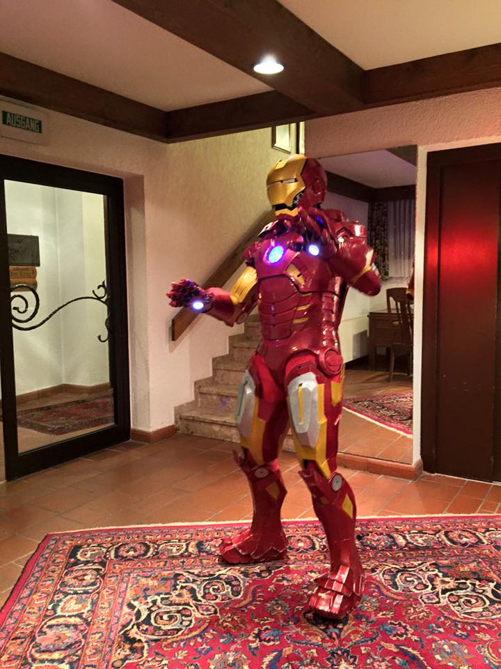

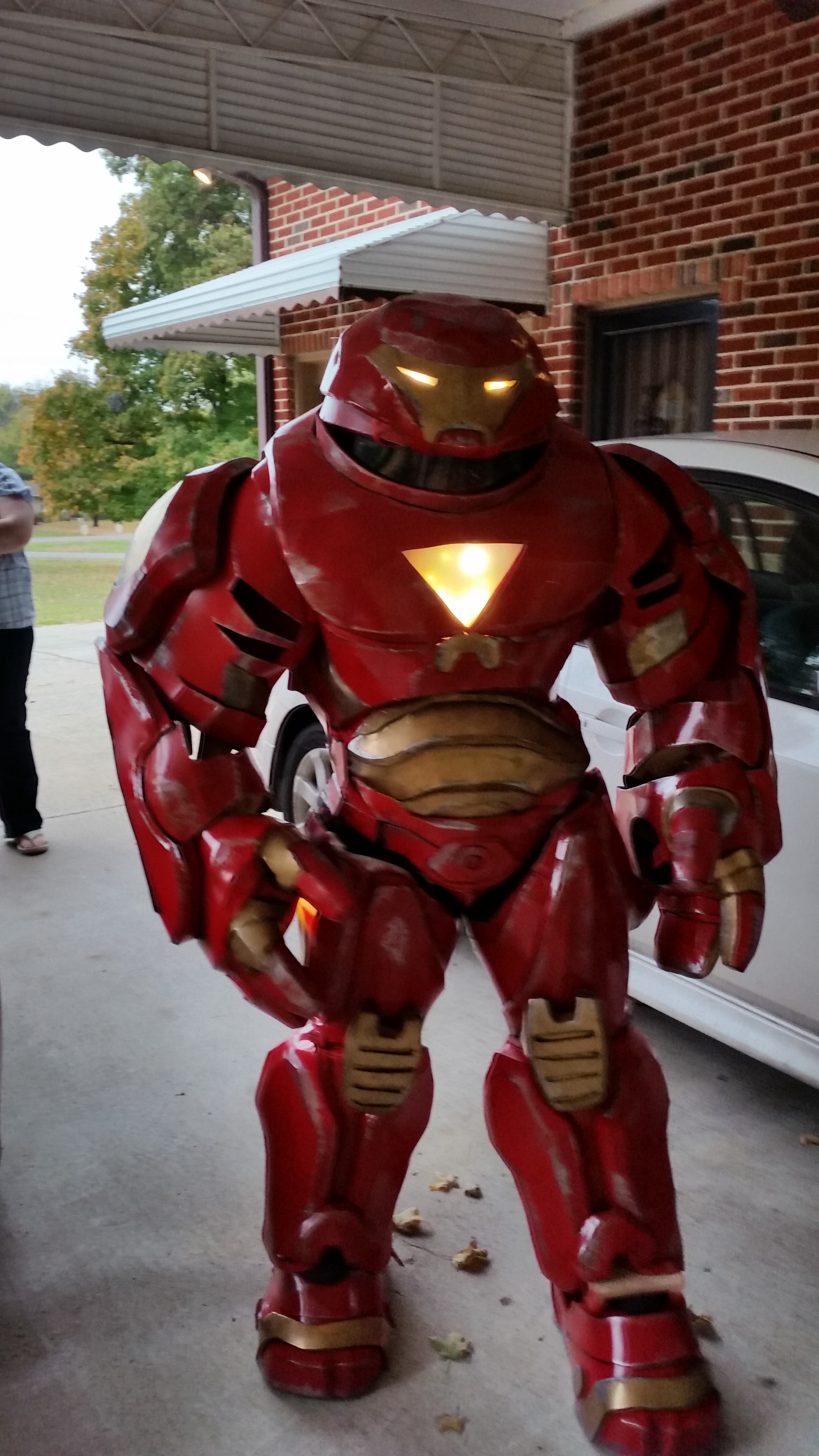

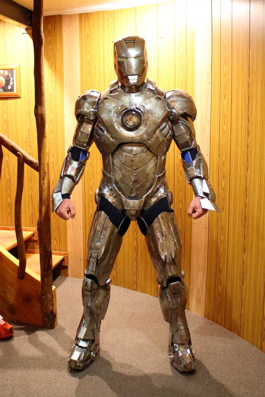

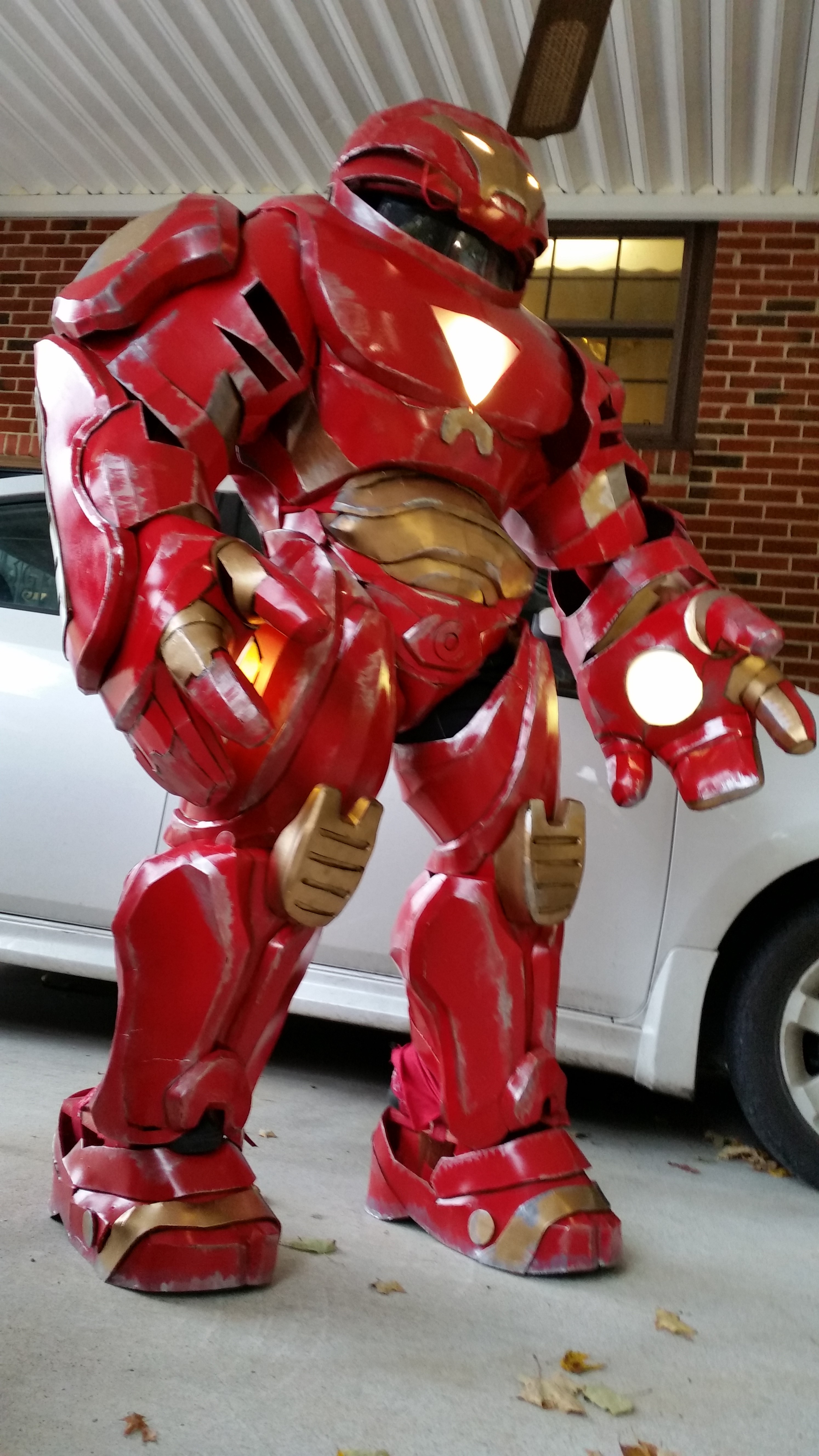

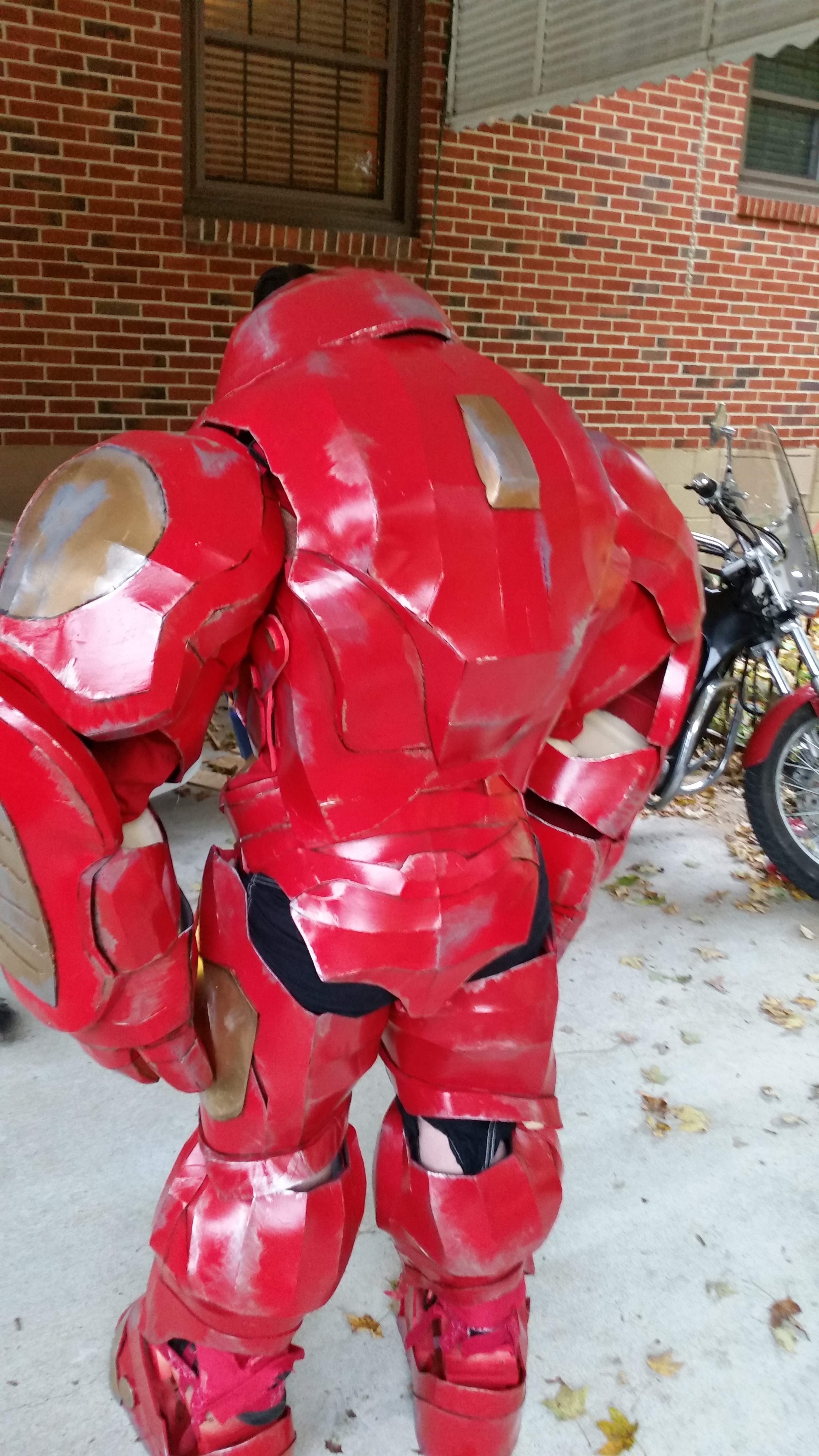

OOoooh, I forgot about this thread. I favorited it a long while back when I was just getting into the suits, and forgot to come back and post mine. So, this is my "classic" HulkBuster!
Thanks!

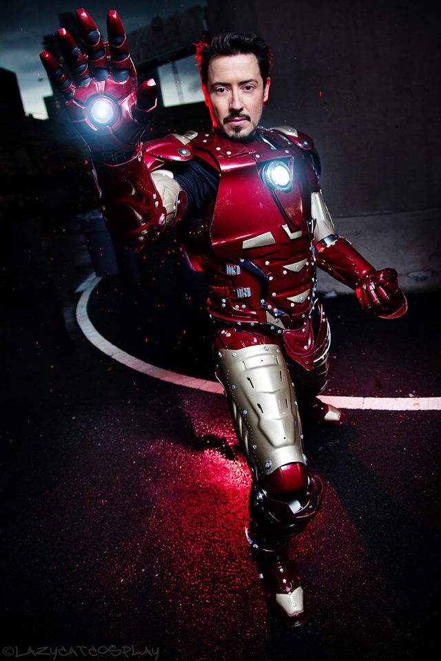

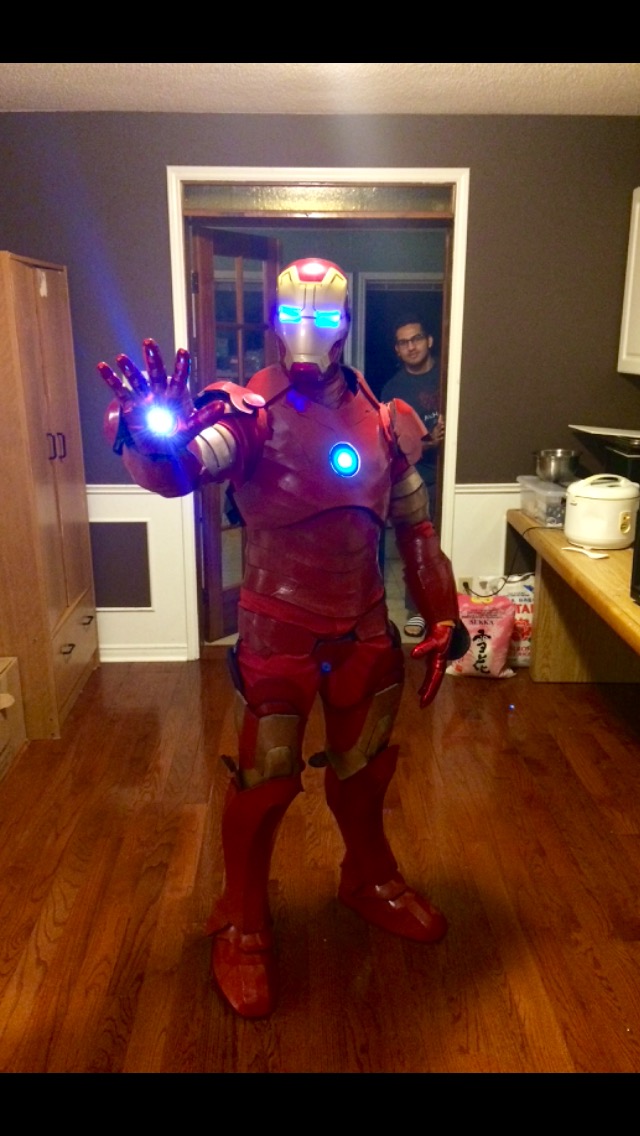

My Mark 6 armor, showing regular position, repulsing position, arm out, bending to show the flexible abs, and 'sleeping' lol. also a shot of the real thing for comparison.

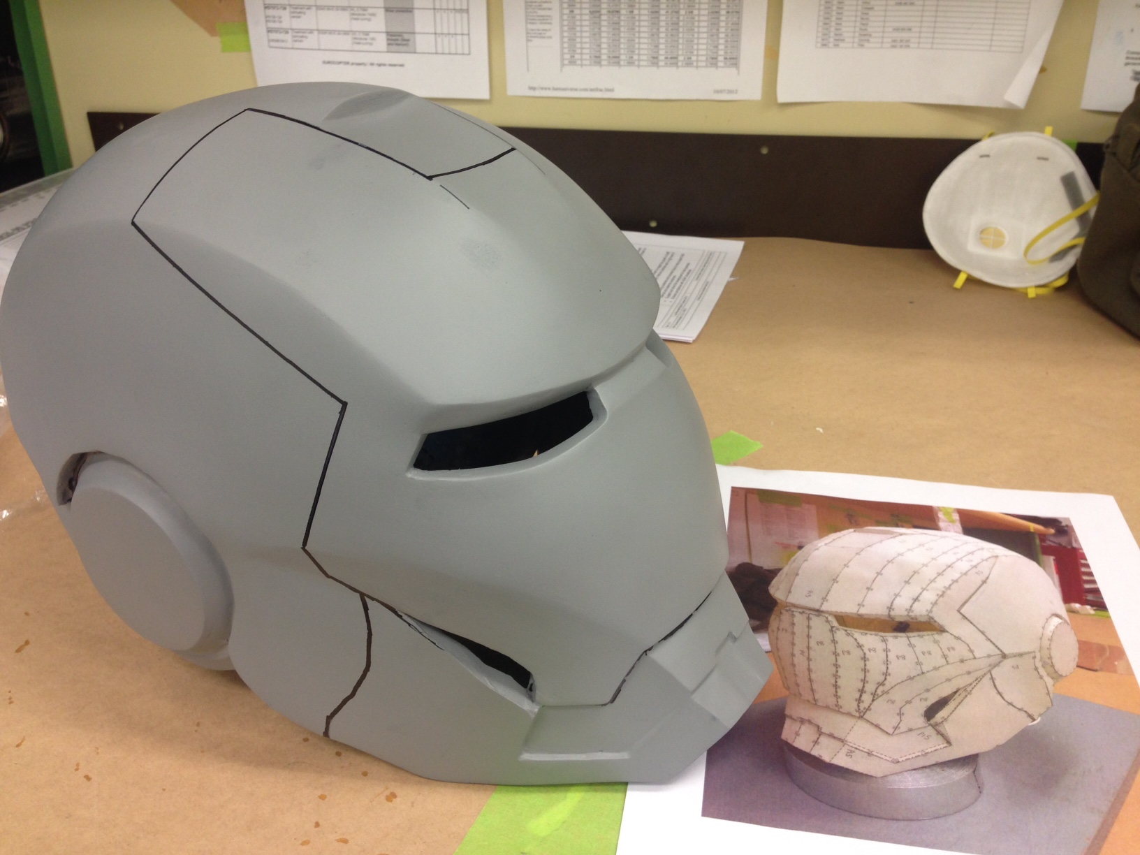

I'm currently part way through my carbon fibre helmet build (check out http://www.therpf.com/showthread.php?t=250518 ) but thought I would throw a pic or 2 up here.
An entire carbon fibre suit would be mad as.
Maybe, depending on how the helmet goes.
This is going to be the plug to make the mould and then lay the solid carbon from that.

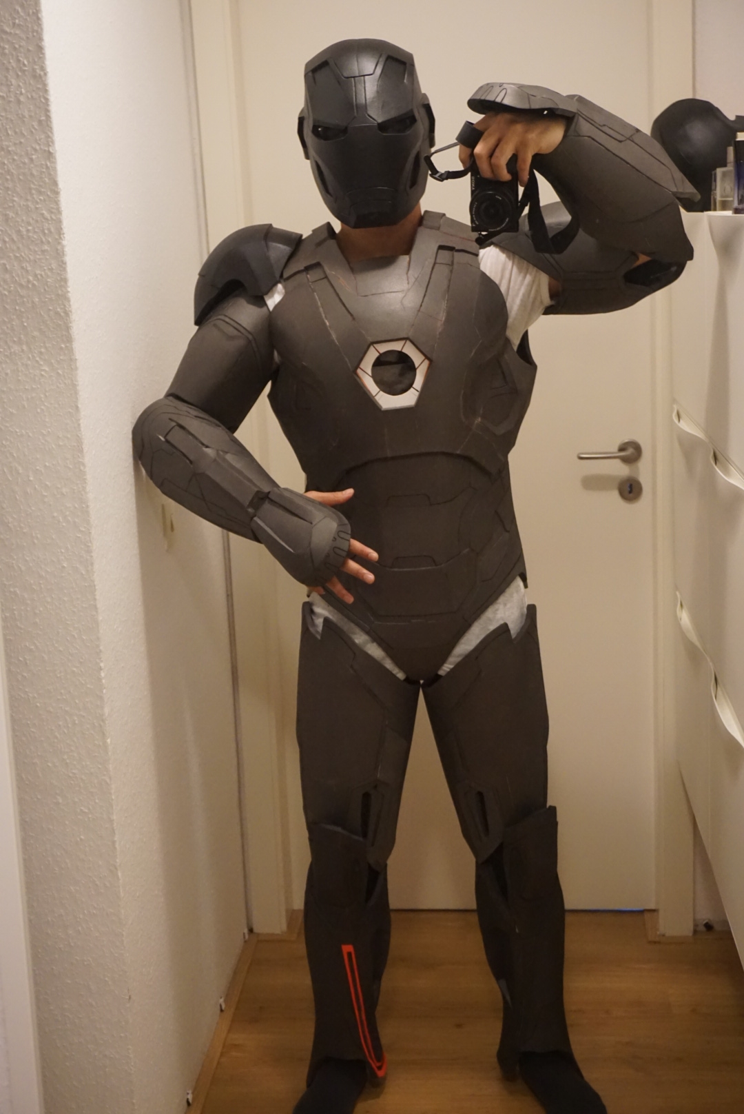

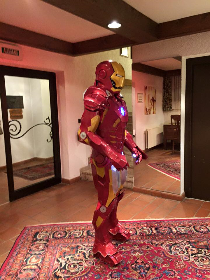

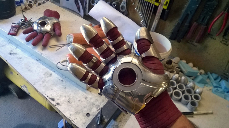

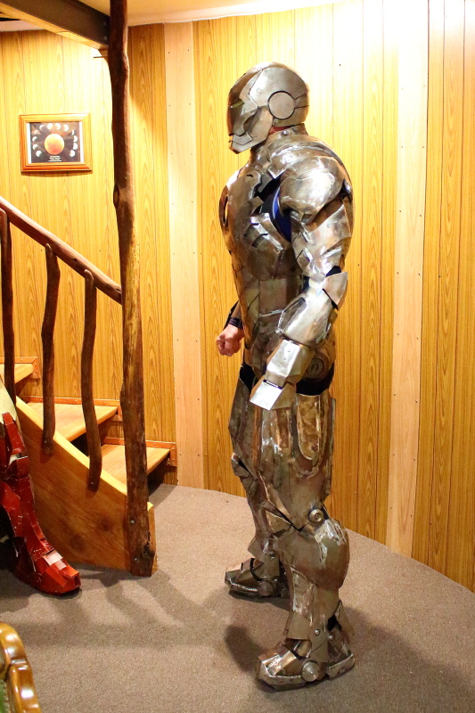

what did you use for the inner elbow? how far can you bend your arms?
Is a strip of foam with 6 more bands glued, then covered with pva (6 hands) sanded with fine 200 paper and sprayed with plasti spray. Then primer and paint and finisher. The foam actually bends without cracking, but the arm can bend just 90 degrees due to hinges.
Hope this can help you!
