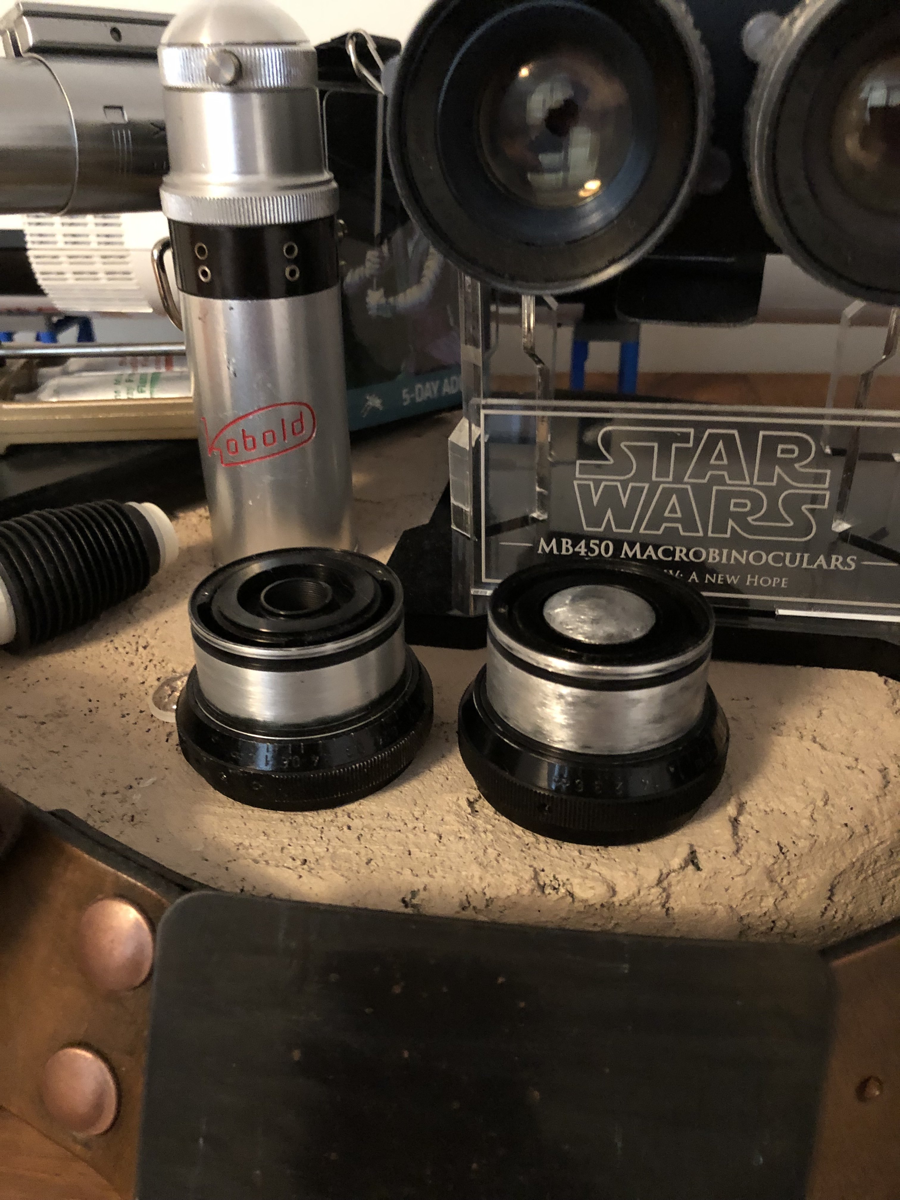

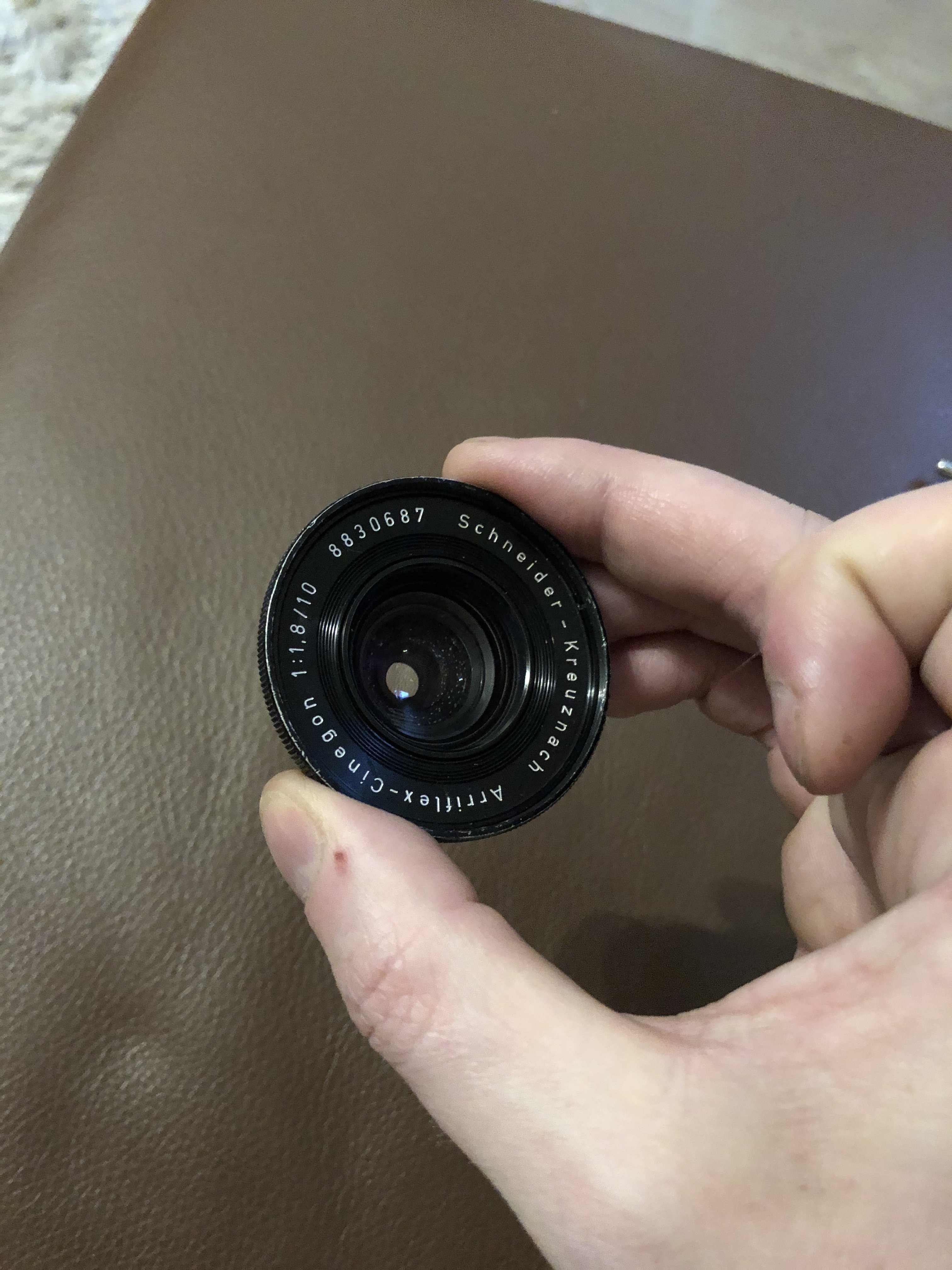

Was able to find another reasonably priced “for parts” Arriflex lens so built a 3PO version to go along with the R2.

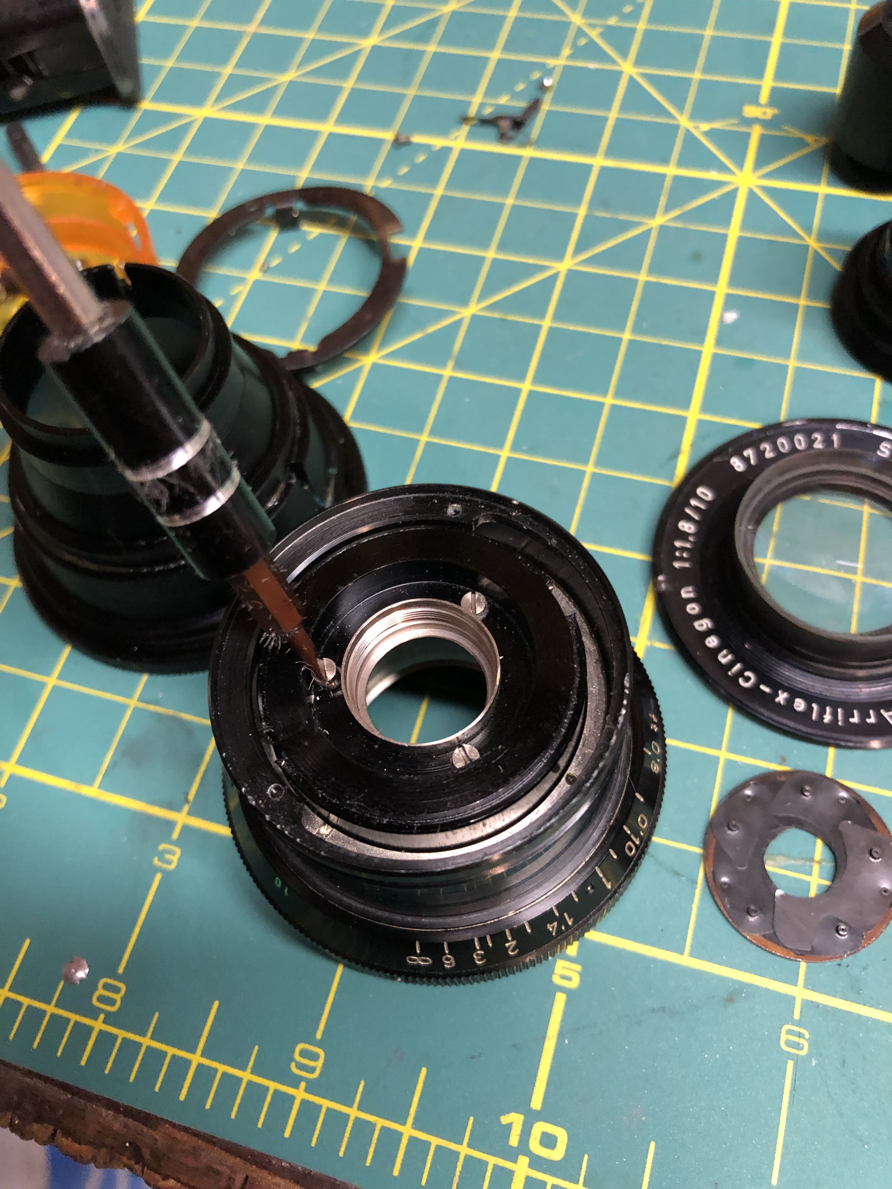

Build process obviously the same as the previous, only thing I did differently this time was to add back the silver piece in order to be able to thread the bolt.

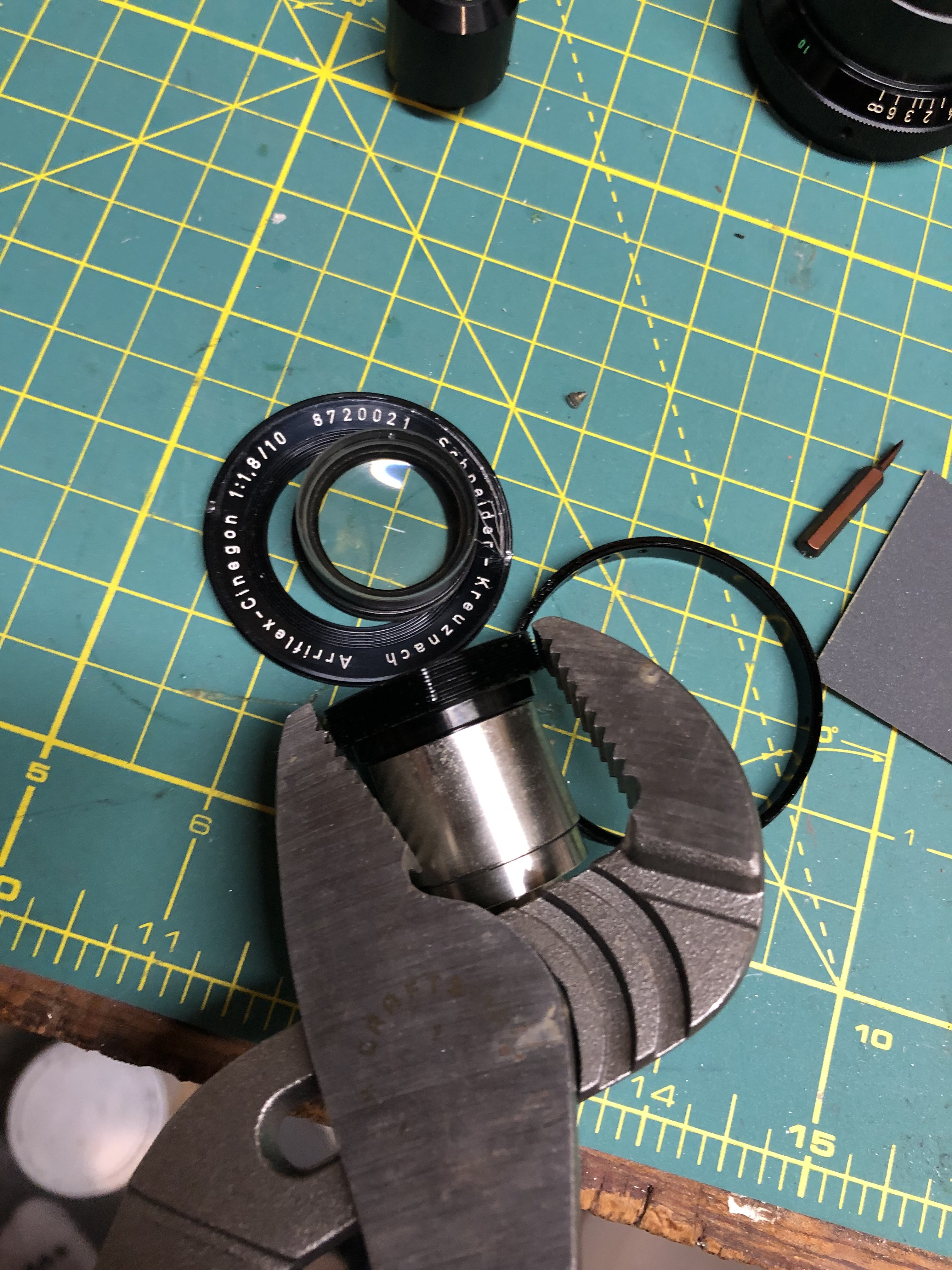

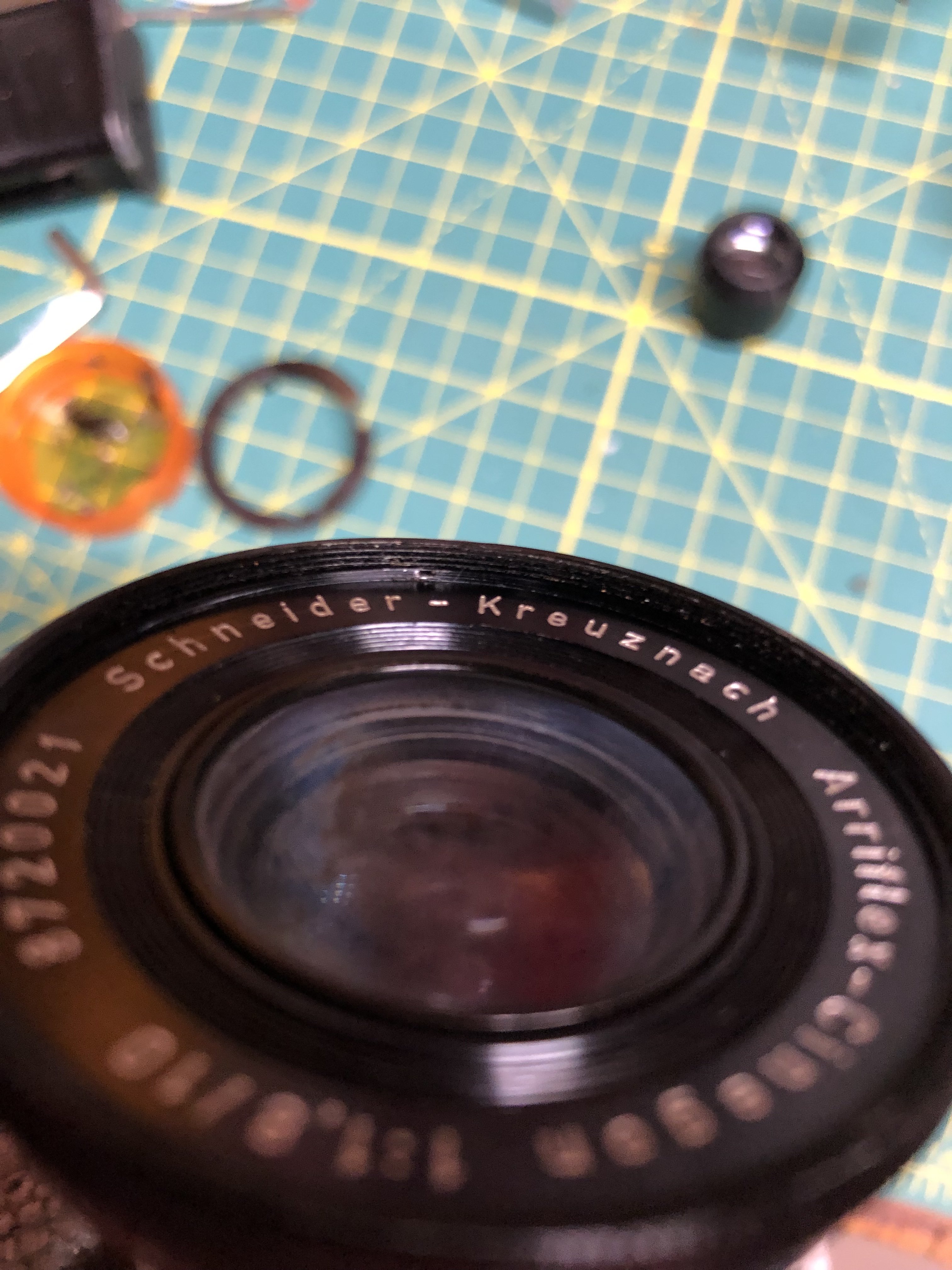

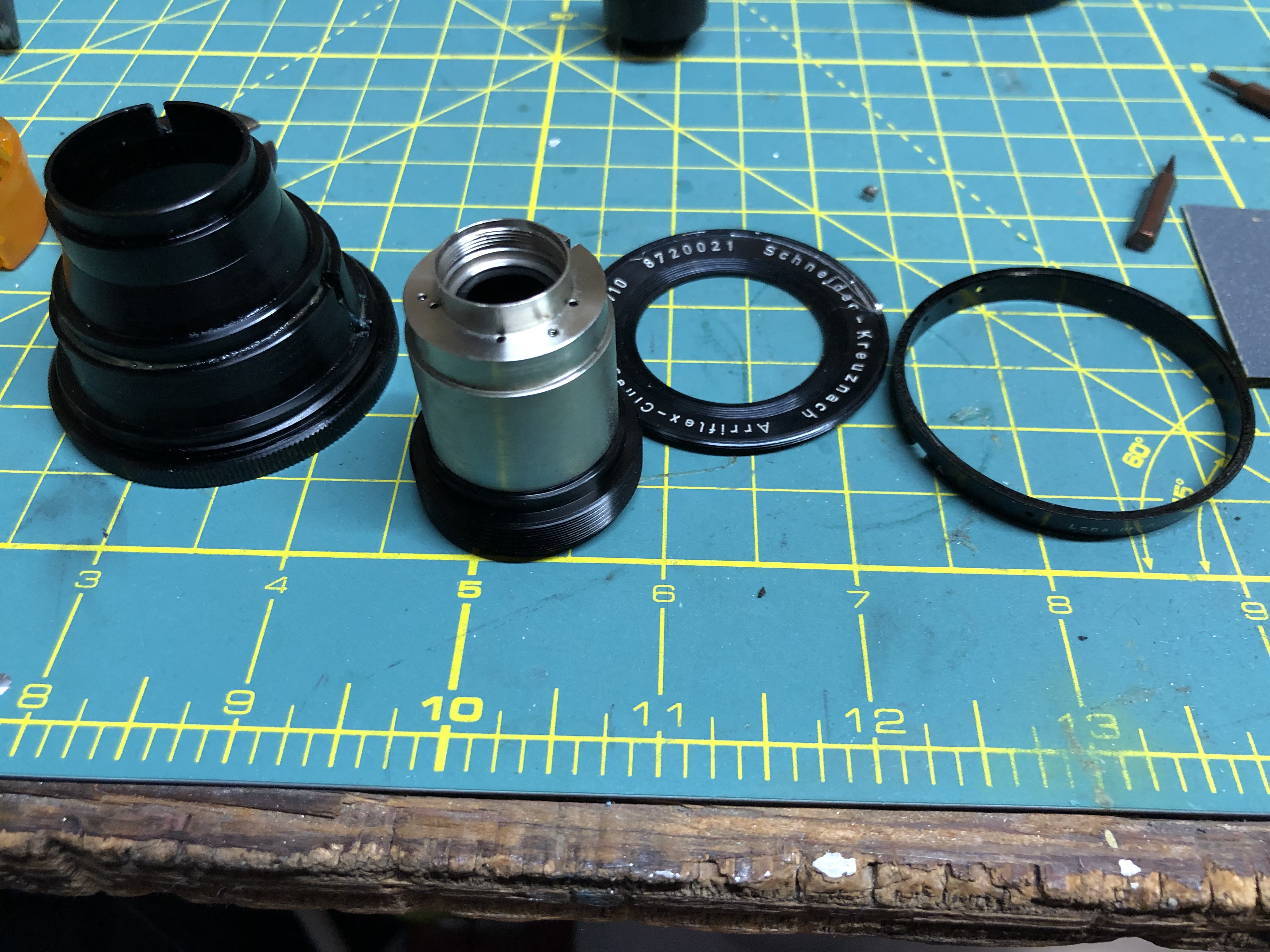

Had to remove the lens plate, which, as you can see is just threaded on. Simple, right? Not when your lens was clearly dropped like third period French. Took some convincing but eventually came off.

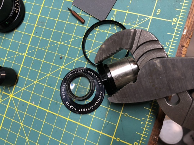

Then after threading a few other pieces out you’re left with the metal part.

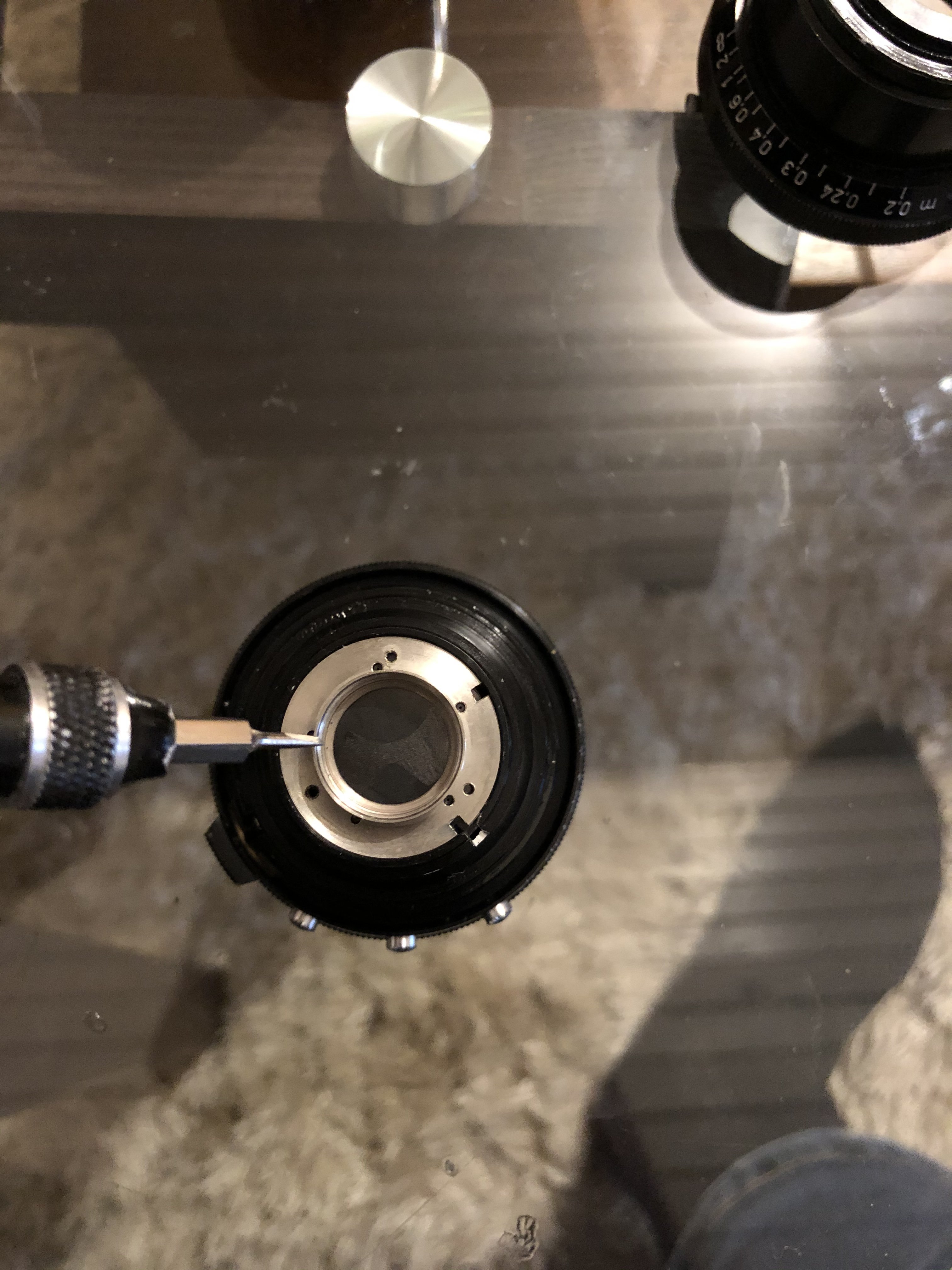

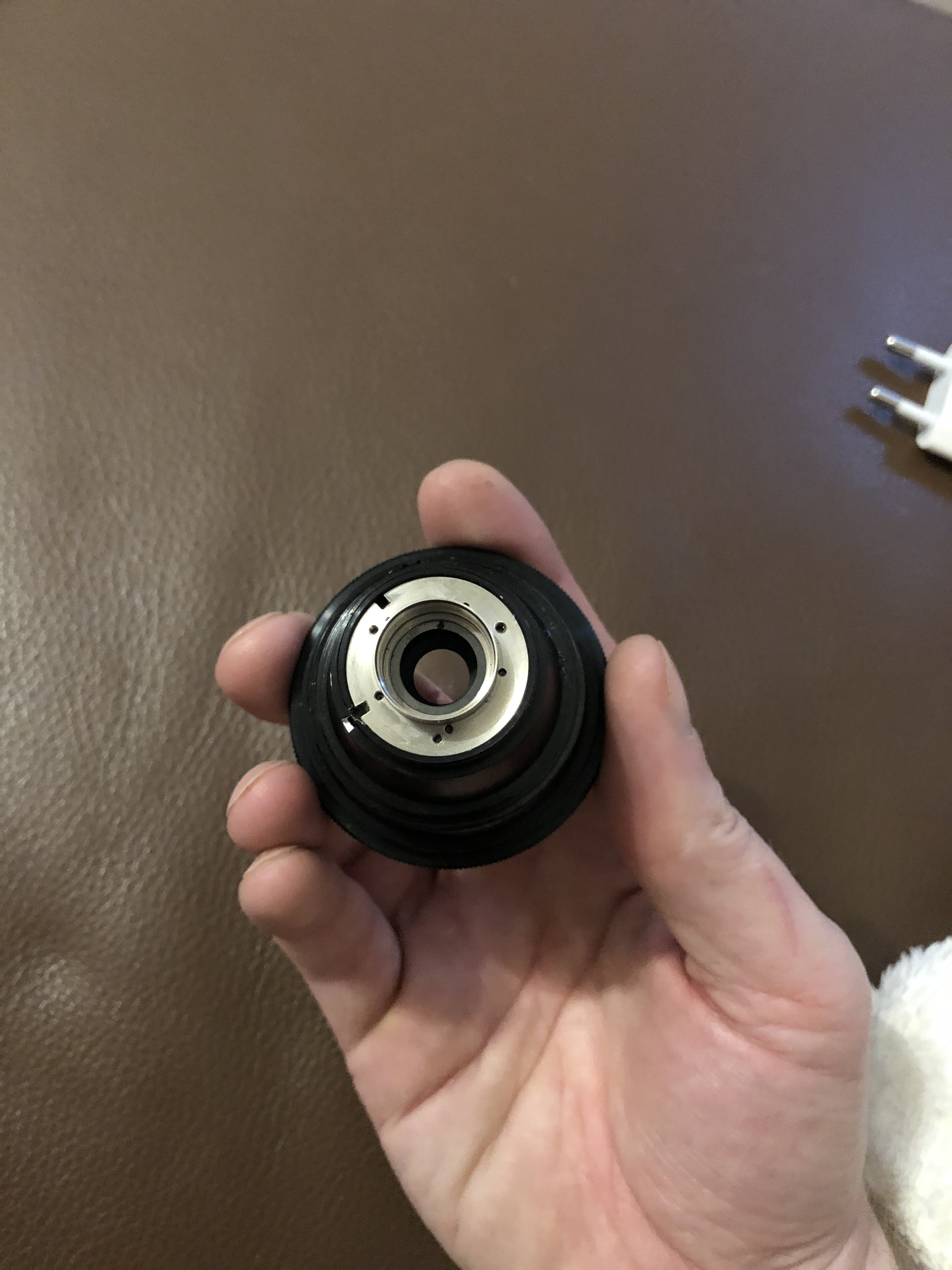

Next is to grab that black part with a pair of pliers again, twist, and hope for the best.

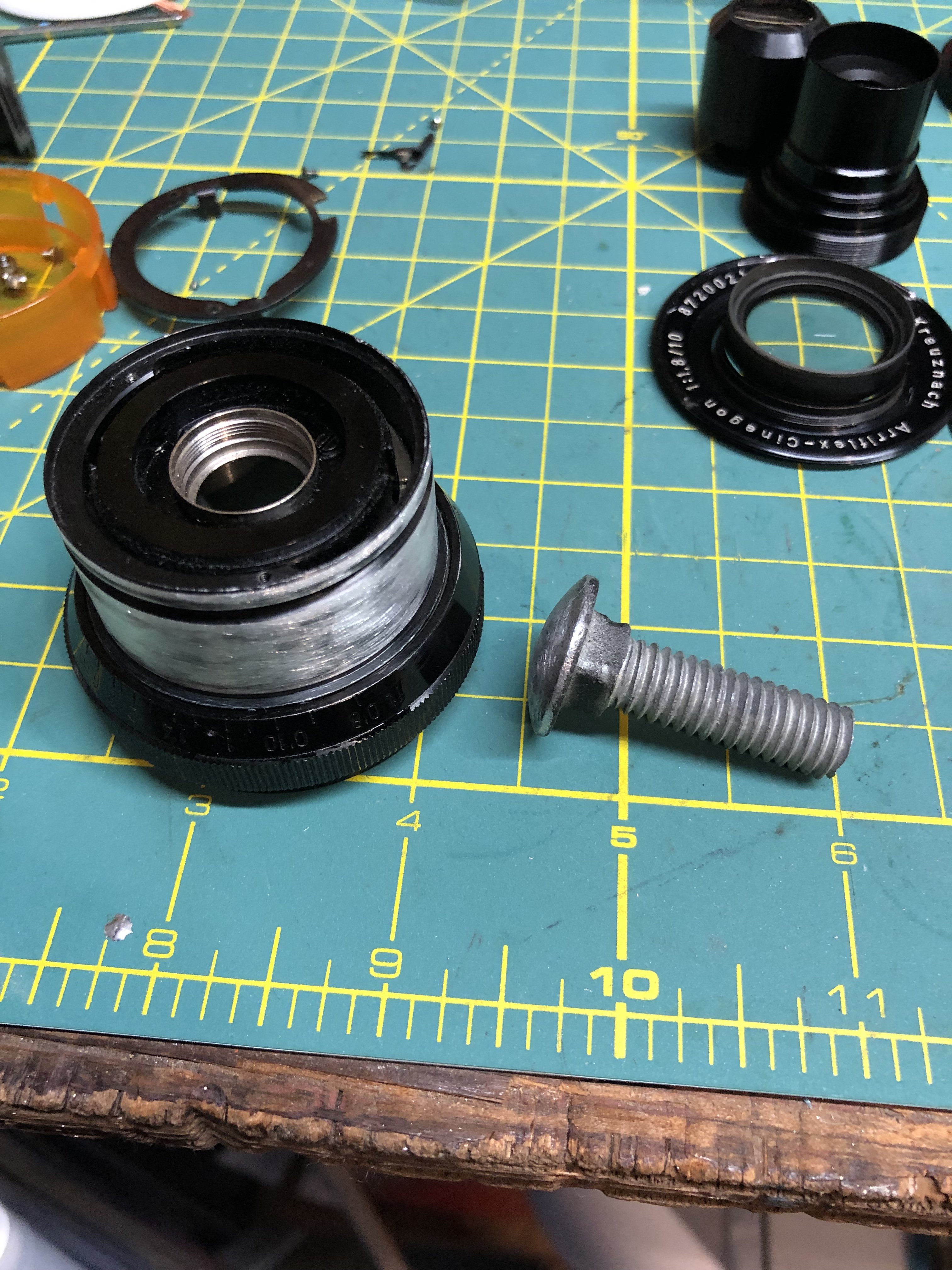

Throw those screws back in...

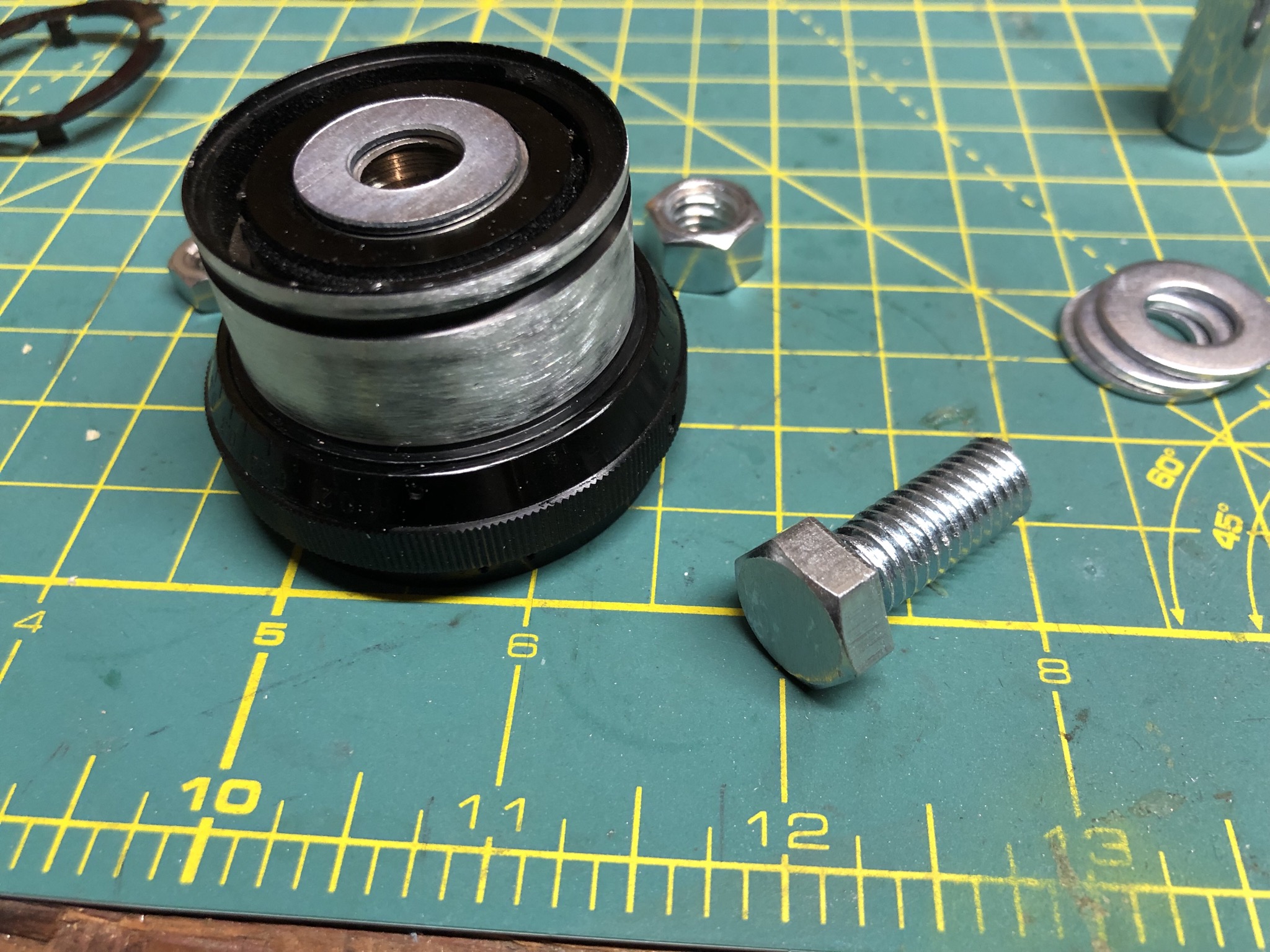

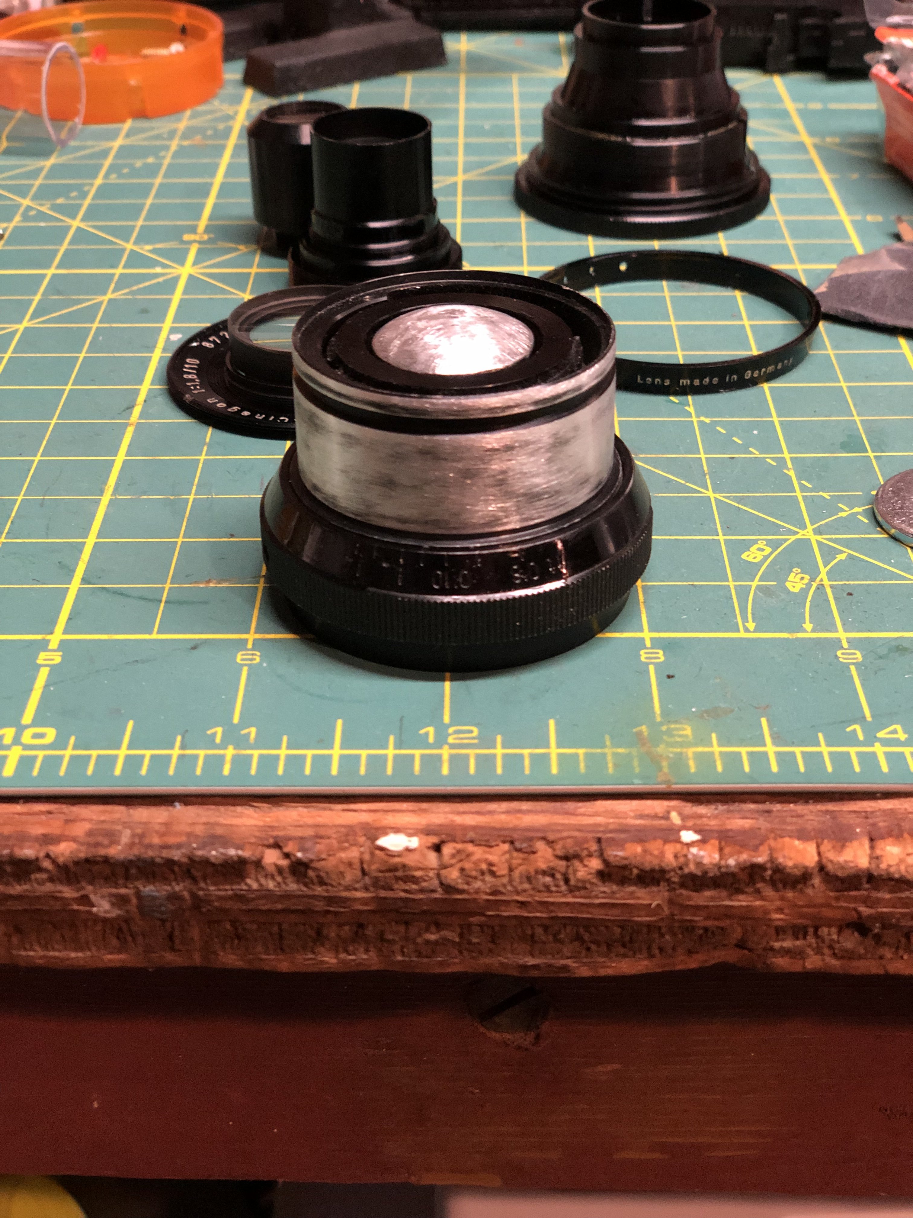

Trim a carriage bolt, ended up being about an inch and a half.
Voila!

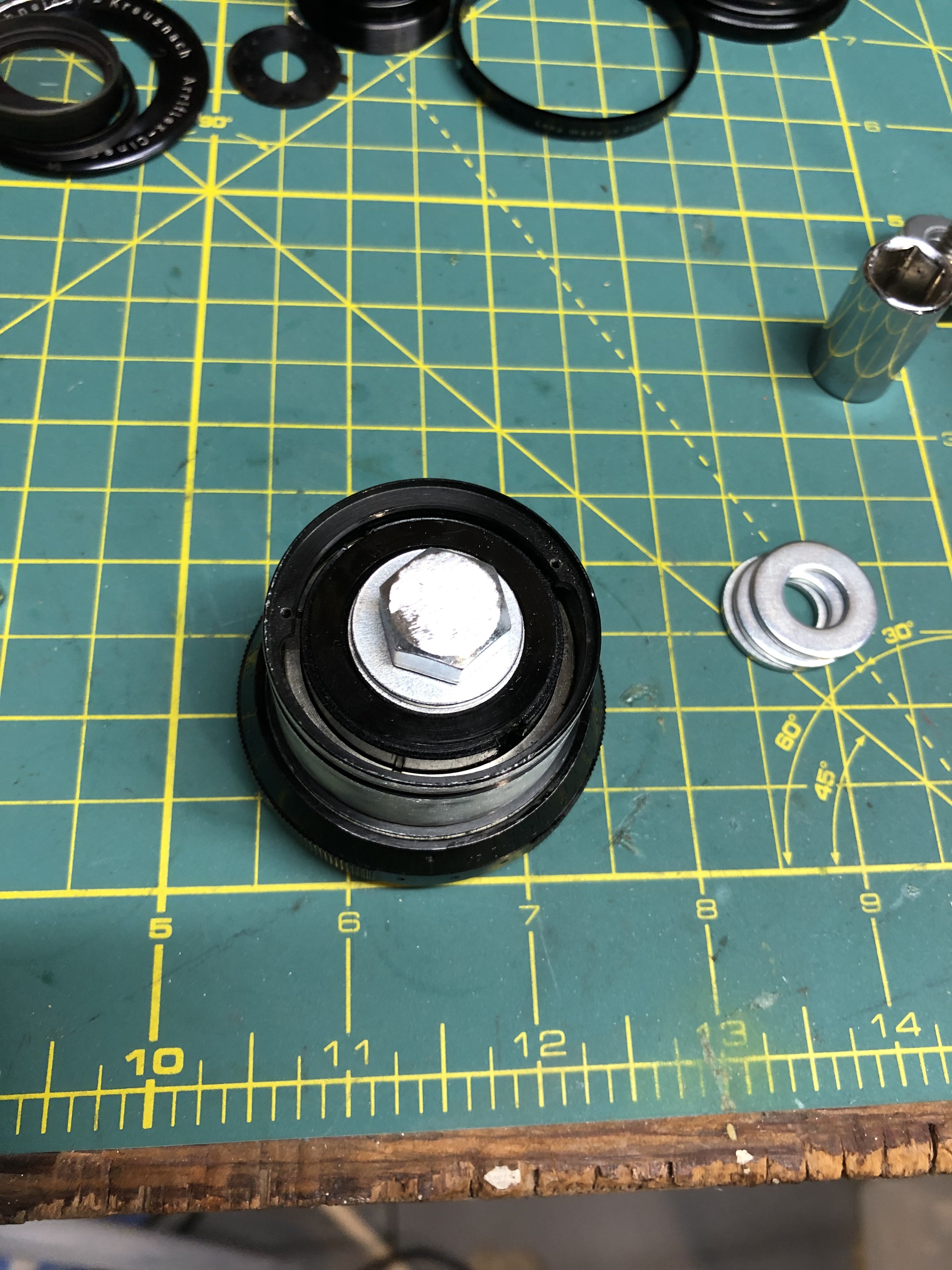

You could totally be right Dann. I swapped out the 3/8” bolt for a 1/4” with washer and that definitely looks better, but yeah maybe I’ll try turning it around and see how it looks fully reversed.
So I tried with just flipping it around, so that the smooth part is underneath and bolt is outward facing, and with the line you see between the bolt and nut I don’t think it looks right. I swapped out the carriage bolt entirely for a hex head bolt I had lying around and I think this is closer. There’s might have been a shallower head than I have but I feel like this is closer to the look.
FWIW, I'm seeing a hex nut on the end of a threaded rod/bolt. Scratch that... I didn't account for the washers; so your pic above looks more correct.
Yeah, that looks like it could be correct, nice job!
Did you try running a 3/8" carriage bolt through, from the back, then adding a hex nut on the front, without any washers?
I will say, I like the LOOK of the smooth head carriage bolt better, but what you've done here does look more like the screen shot you posted.

I did it with the washers, didn’t take any photos though. The problem I had with that was the visible line between the bolt and the hex but, which I don’t see in the image.
Also, I totally agree that I prefer the way the rounded carriage bolt looks with the washer through the front, but my screen accuracy OCD won’t allow it!

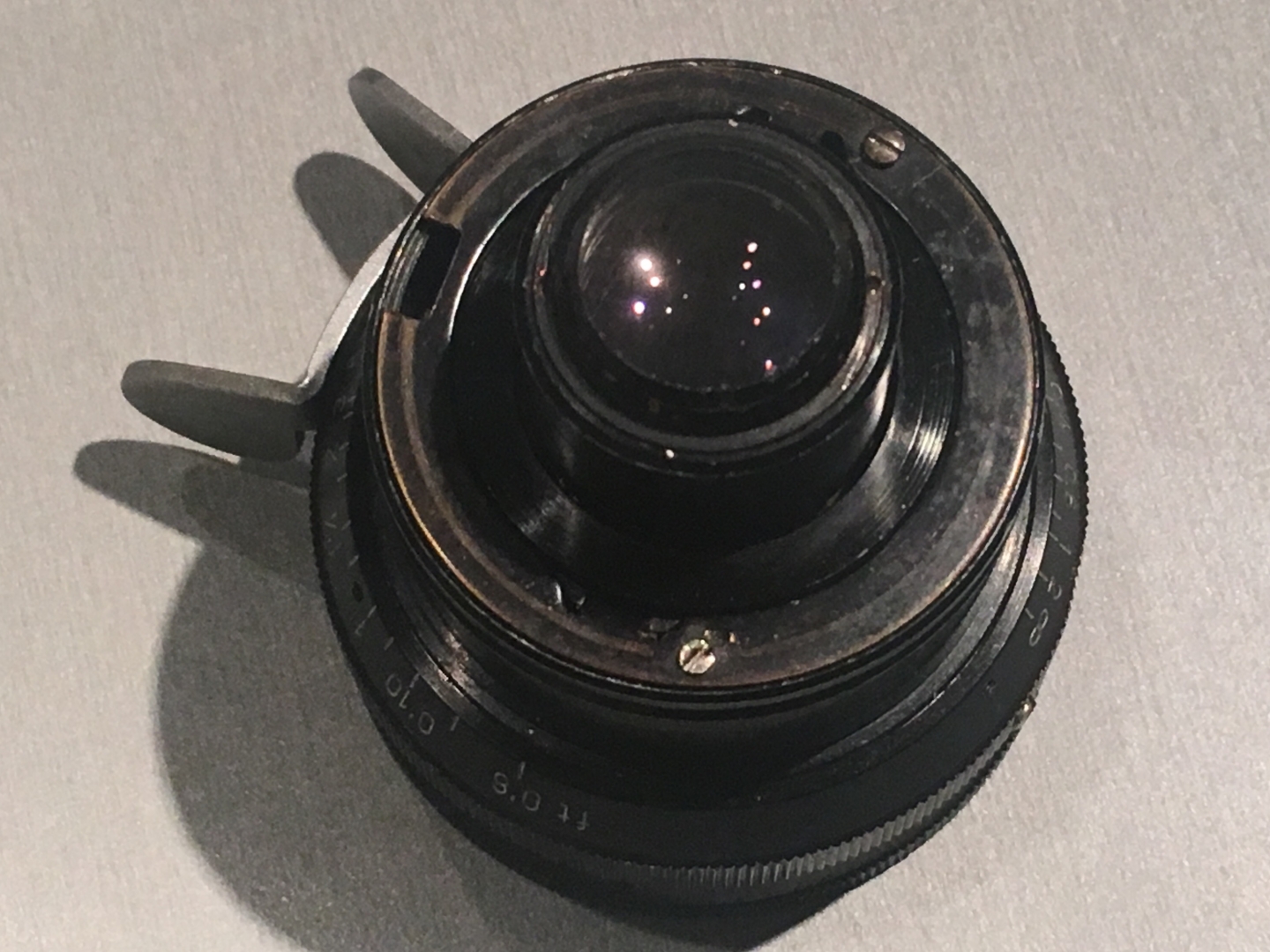

Anyone think we might be looking at the rear element of the lens stuck in the middle and not a bolt at all? Looking at some other reference photos you can see it looks more like a round shape (i.e. not a hex bolt) with a distinct line around the edge, which could match the look of the rear element... Thoughts?
View attachment 1055444 View attachment 1055445
In that photo you’re totally right that it’s round, as opposed to any kind of hex end. I don’t know that I see the rear part of the lens, though. To my eye it definitely looks more like the carriage bolt that we originally suspected. Especially taken with some of the color photos, like above, where it has a full on, consistent silver reflection that you wouldn’t get from the rear part of the lens.

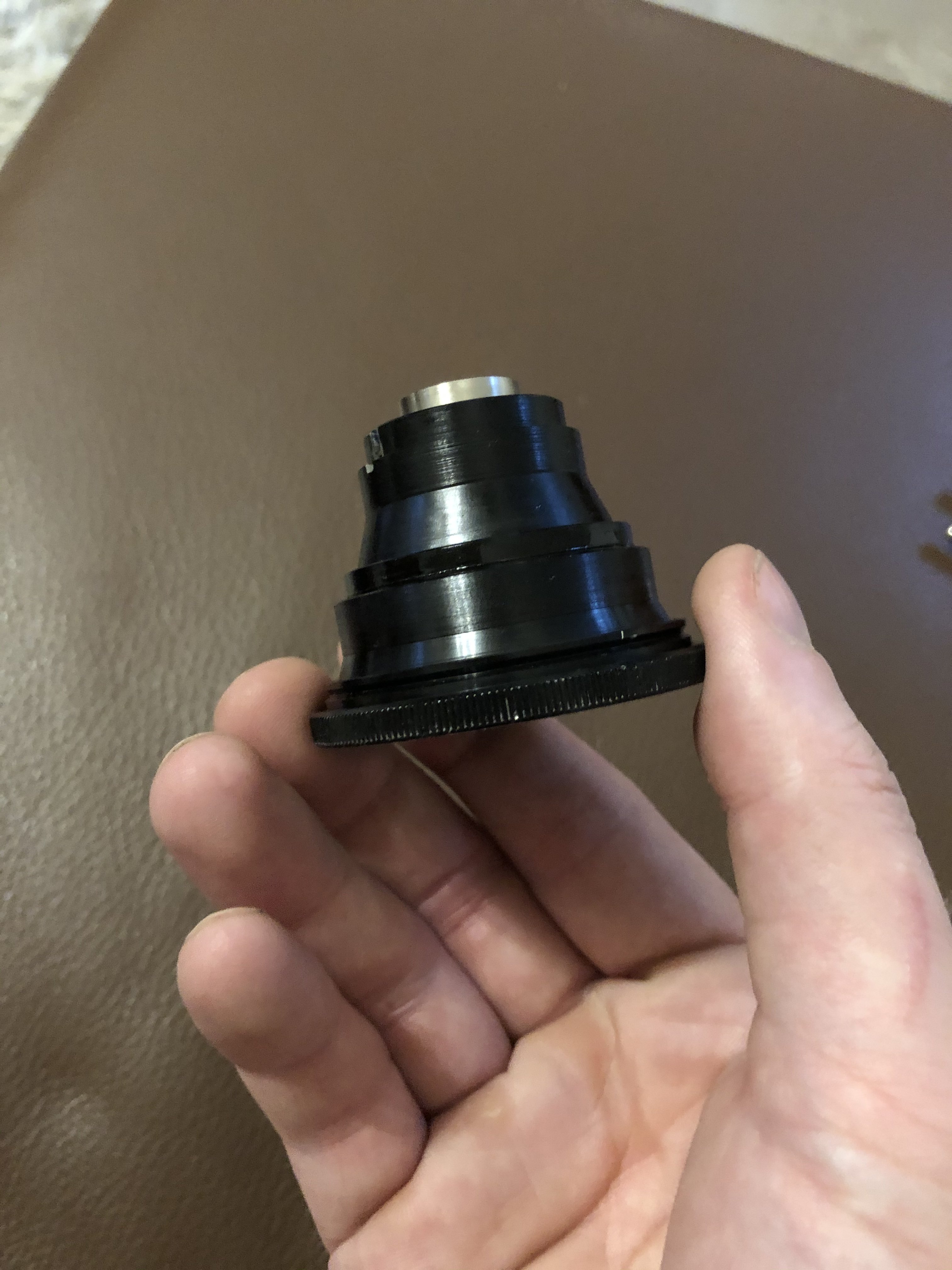

It will all come apart. You should be able to remove that ring with the silver buttons / tabs and that center larger silver section should twist out. I found this pic from when I did mine a while back.
Ty for the picture.
I am now this far but have no idea how to remove the silver part.
