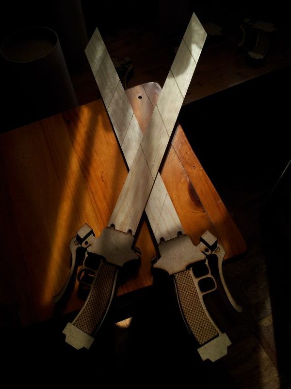

SWORDS:

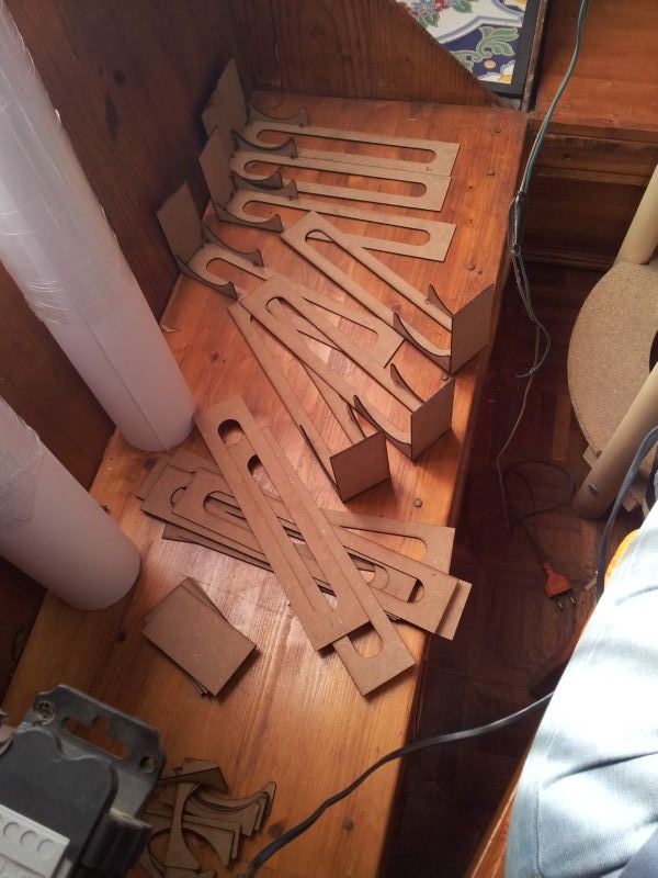

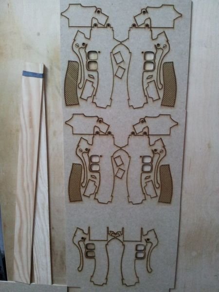

Not much mistery around here. To keep them simple, I made a sandwich of lasercut MDF parts with no movable pieces and an inserted pine wood blade. (the kit shown below is composed of three small sheets, however, it looks like a single big one...aligned them too well for the photo! ^^U )
I was not entirely happy with the design, but had just one week, afterwork, to do it, in preparation for the weekend, so I wasn't going to do it perfect either.

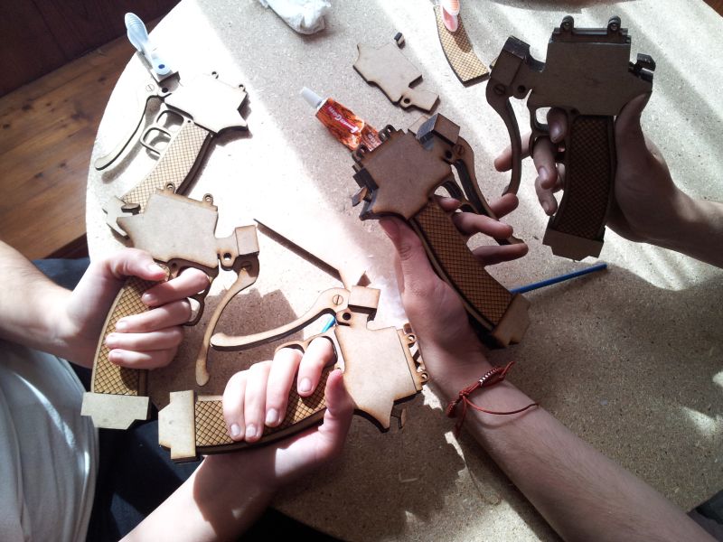

People have the bad habit of gluing more than two pieces at a time, with thick glue, this can create a lubrication effect, prompting the sandwiched piece to move around, and ruining the alignment in the build. I instructed the girls to only glue two pieces at a time.

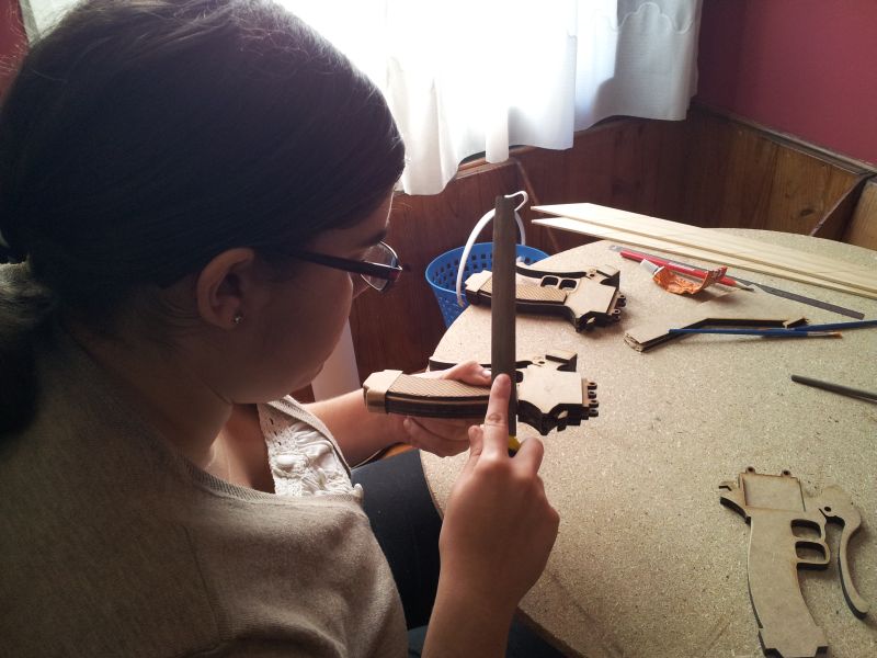

Sanding can turn a passable piece (better than nothing) into something you could call a prop:
I would call this, acceptable:

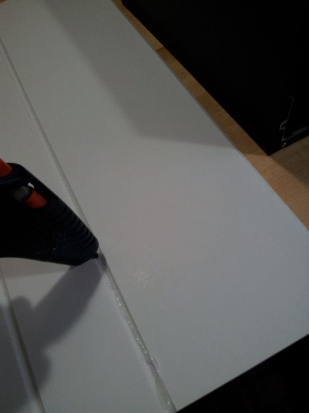

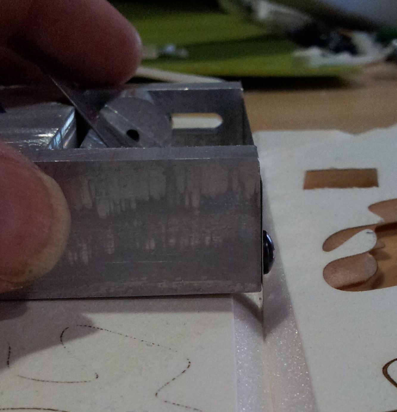

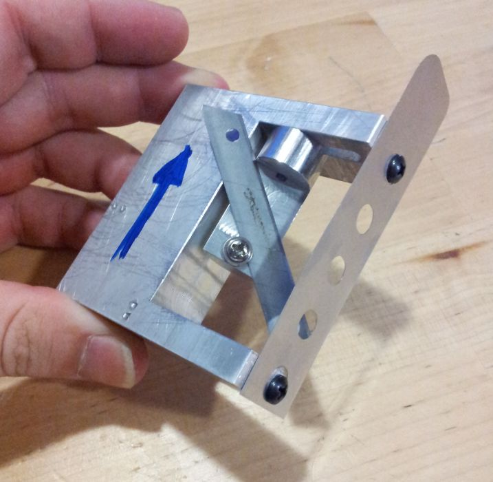

To make the bodies, I switched to 5mm foam core board. Instead of cutting four separate pieces and assemble them into a rectangular shape, I devised this tool wich, used in reference cuts, allows you to make smooth 45º cuts on either side of that reference cut, then fold the board, and have a super smooth curved finish on the exterior face.
Cutting the actual panels. Apply hot glue and fold the pieces against a wide thing wich makes a 90 degree angle with the table (I used a spare computer case XD ). Since the hot glue spurts out of the cut, it gives an enormous strenght to the bond:

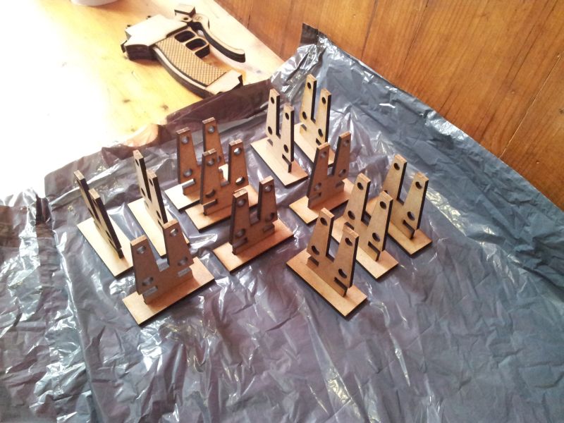

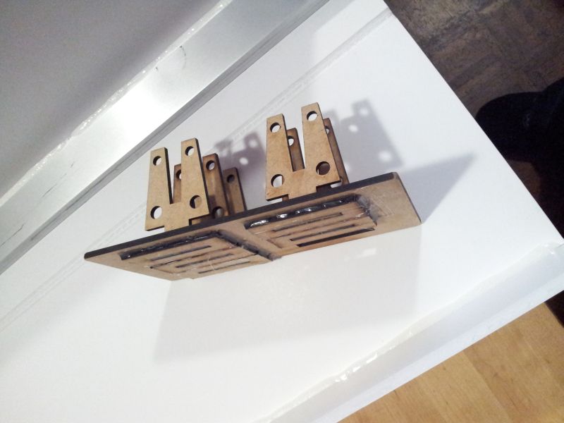

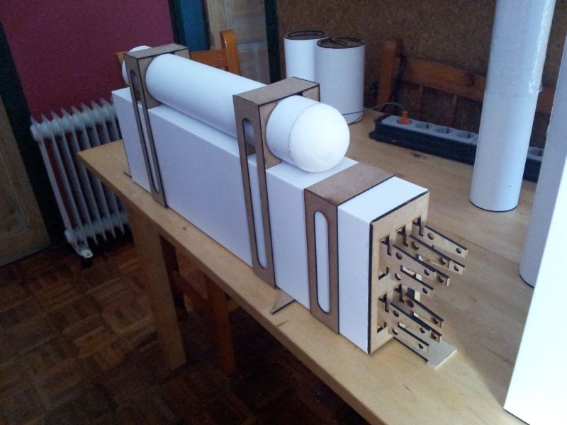

BLADE CARRIERS:

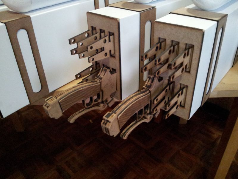

No mistery there, five fake blades and a hole for the sixth.
Since there are no other things inside the case, and while in use it has the cases pointing upwards, I decided not to put anything to hold the sword in place. Actually, part of the handle gets into the hole too, so the sword is not bouncing around as much as you might think. You can see that there is an open angle in there. Photo was taken prior to hot glue that part. However, it is true that on these boxes, one corner is a bit ugly. If I had to do it again, I would cut the underside in two segments, and made a front to front join, instead of an angle one. We kept the ugly corners against the tighs, so they would be the least seen (corner).

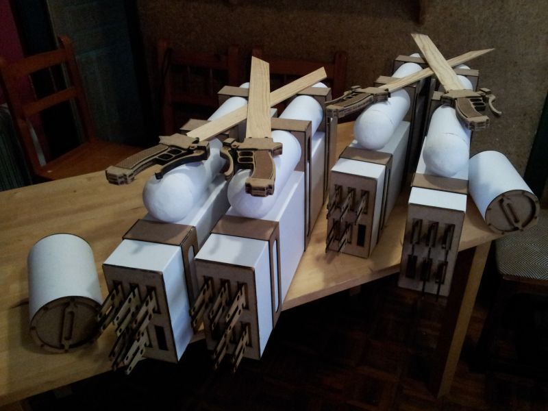

Last pieces and final assembly:
It was time to attach all the blade carrier parts, and I prepared all the pieces in thin 2mm mdf. If it weren't for the ladies messing up a bit, the tubes could actually be removable (not that I would want it, for the sake of practicity and strongness). The gas tubes and the boxes got a thick wire of hot glue to bond them together permanently.
Final photos:
It's missing the cable guns, two small boxes that go into the belt and the gas valves (and the cables), but the weekend was over, so I decided I would do them this week. With that, my job will be done, as painting is on the ladies.

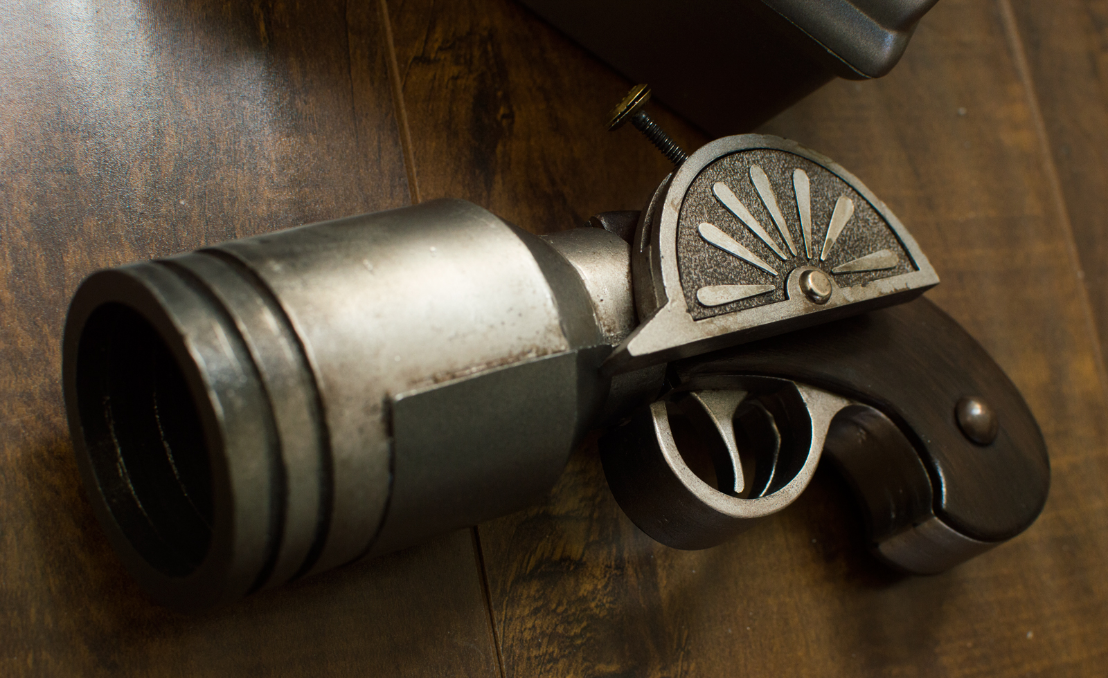

Awesome! Glad to see a build from Attack on Titan. I built a flare gun from the show for my brother for his birthday a couple months ago (I used a similar technique). I look forward to seeing more of your build, it's already looking great!

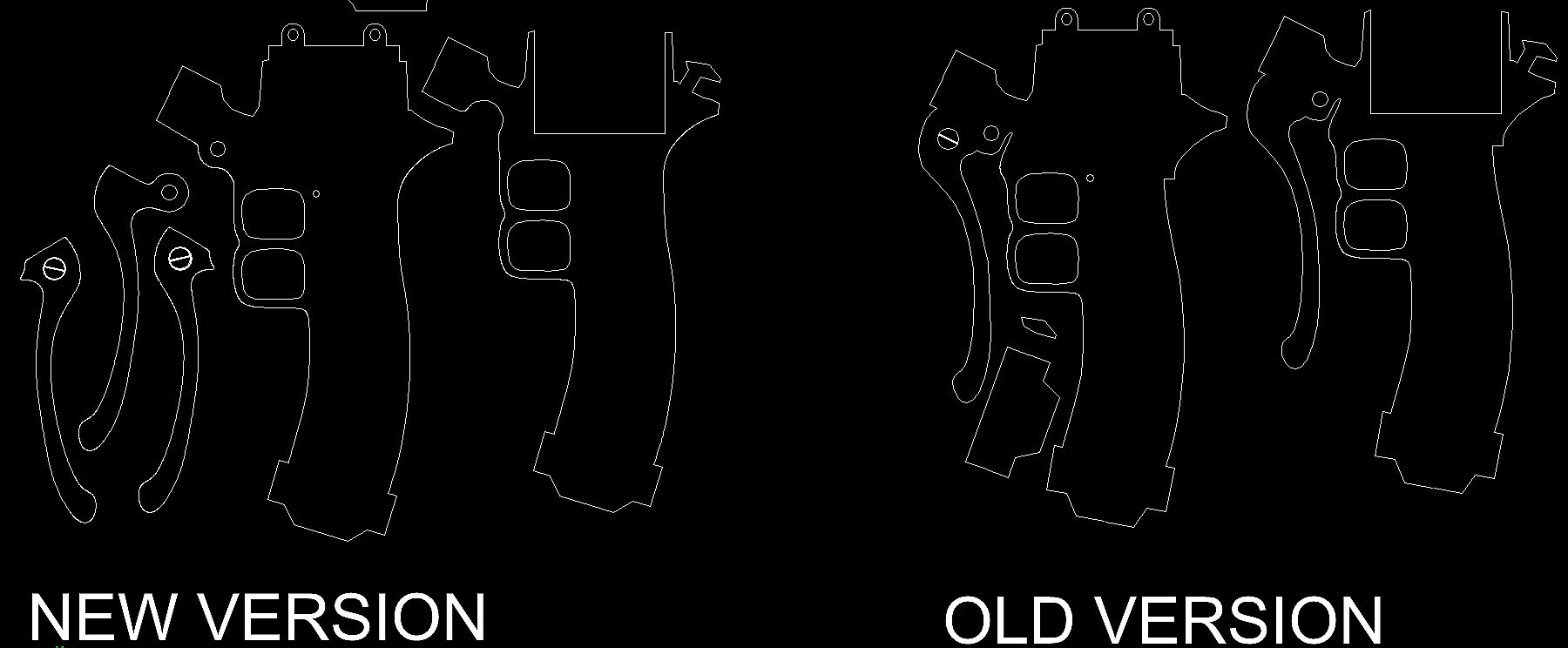

As said, I'm reworking the cut files with splines instead of polylines, for a nicer smooth finish out of the laser. Since there is no real quorum about wich design is the correct design, especally on the handles, I'm also changing parts of it that I don't understand or like. The new version is far from finished, I haven't decided yet on blade hold system, triggers, and hammer (or whatever that is) shape.

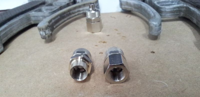

This is how we made the cable attachments for the swords:
The girls couldn't find threaded pieces, so I lathed hexagonal ones and press fitted them. Clear PVC pipe was covered with coaxial protection.
