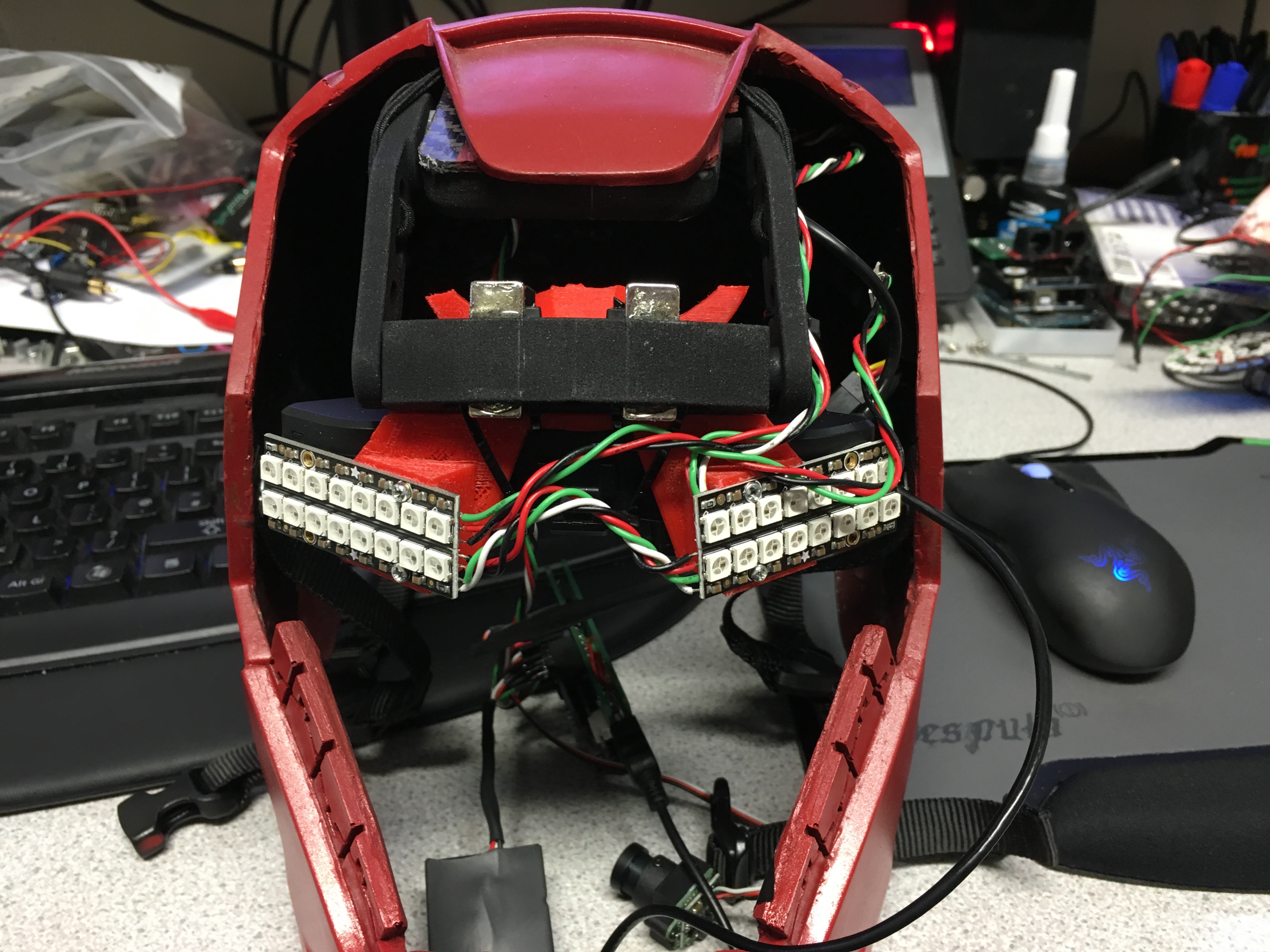

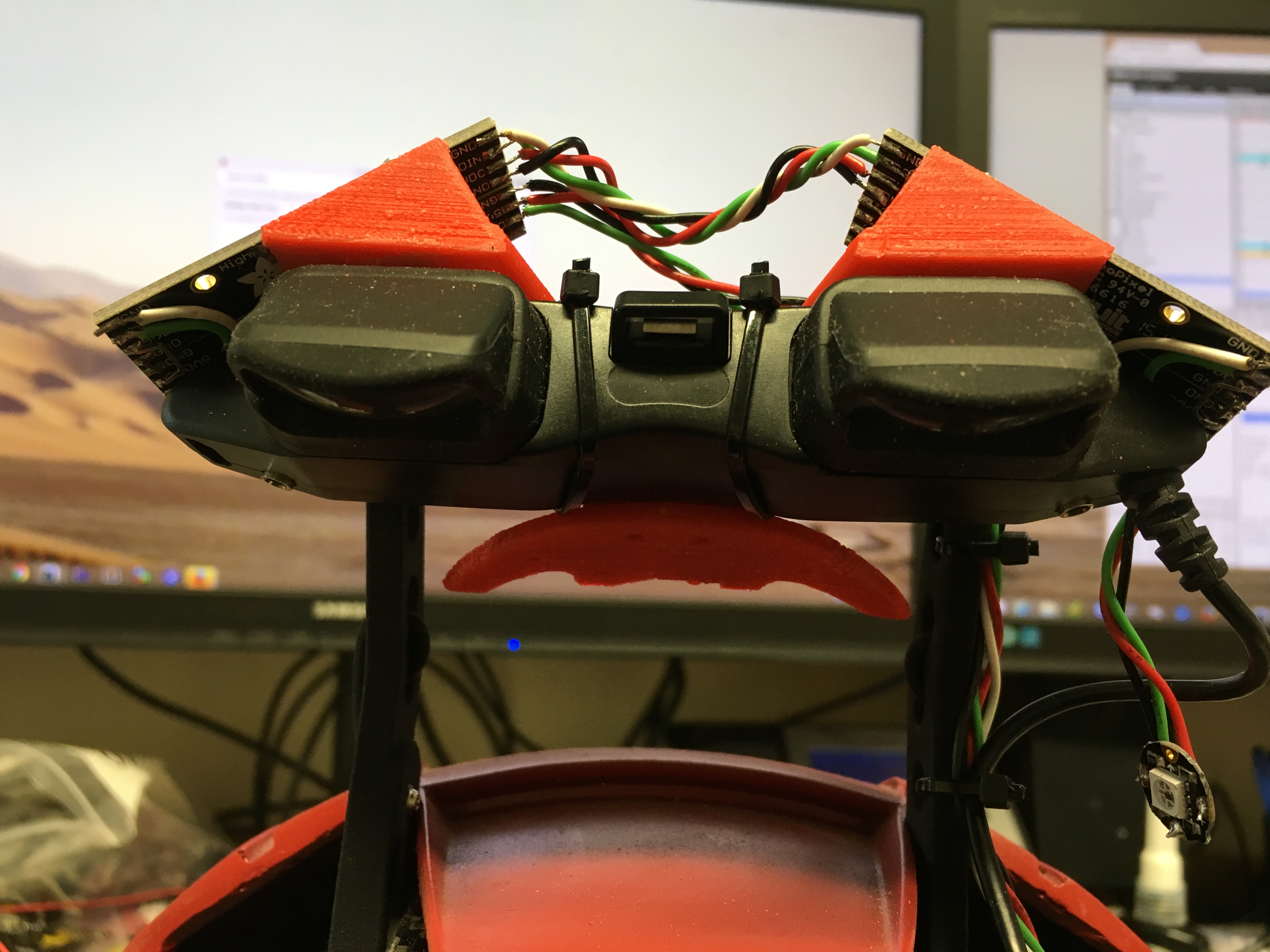

Have just done a test fit;

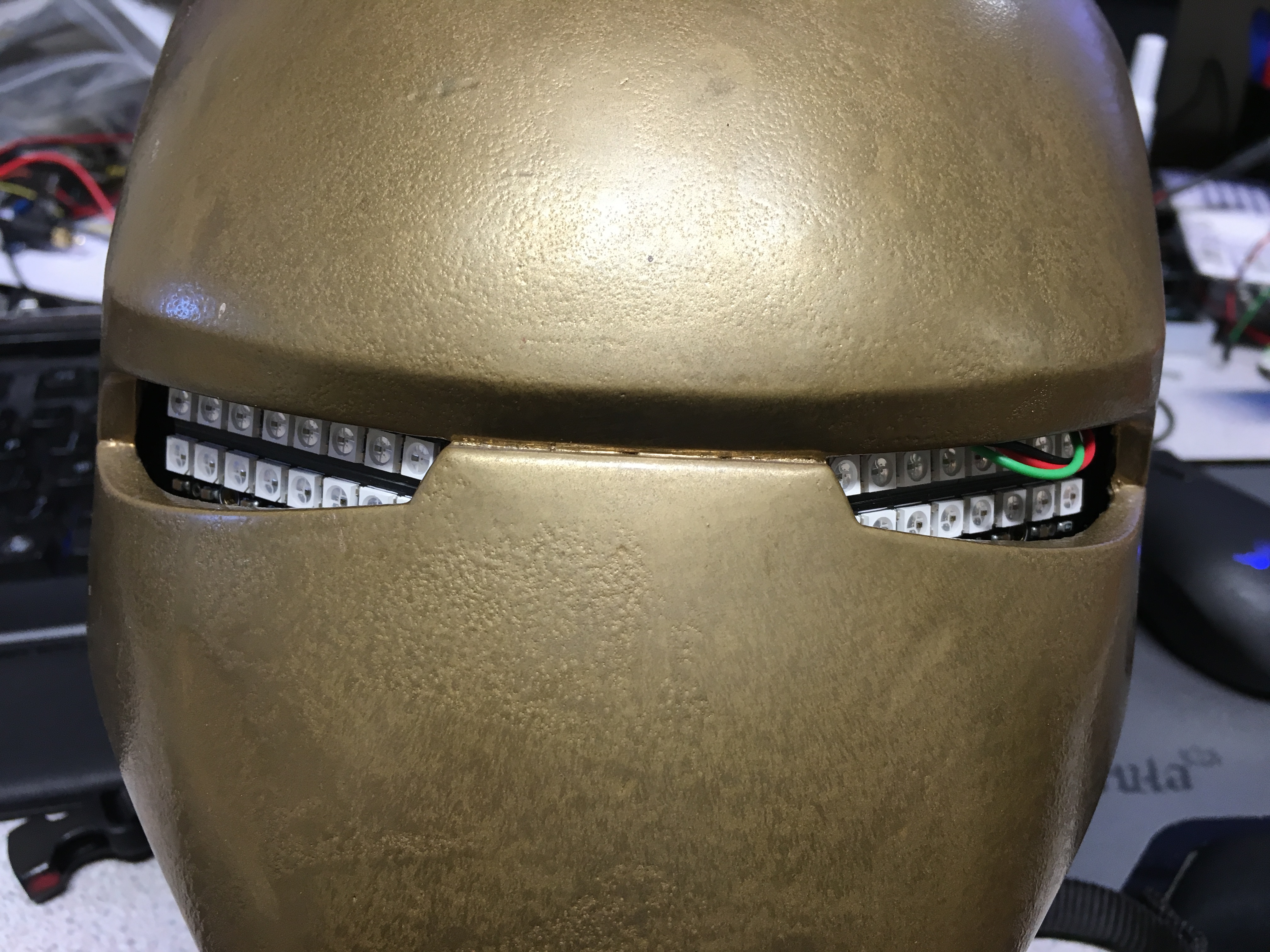

I either did an exceptional job with my measurements, or more likely completely fluked it on the first go, but the eye LED's are in the right position and the video goggles sit perfectly.
I did have to trim the headrest, which was a bit annoying, but overall I'm happy. Just the helmet audio system to sort now, and the major job or figuring where to put the camera.............

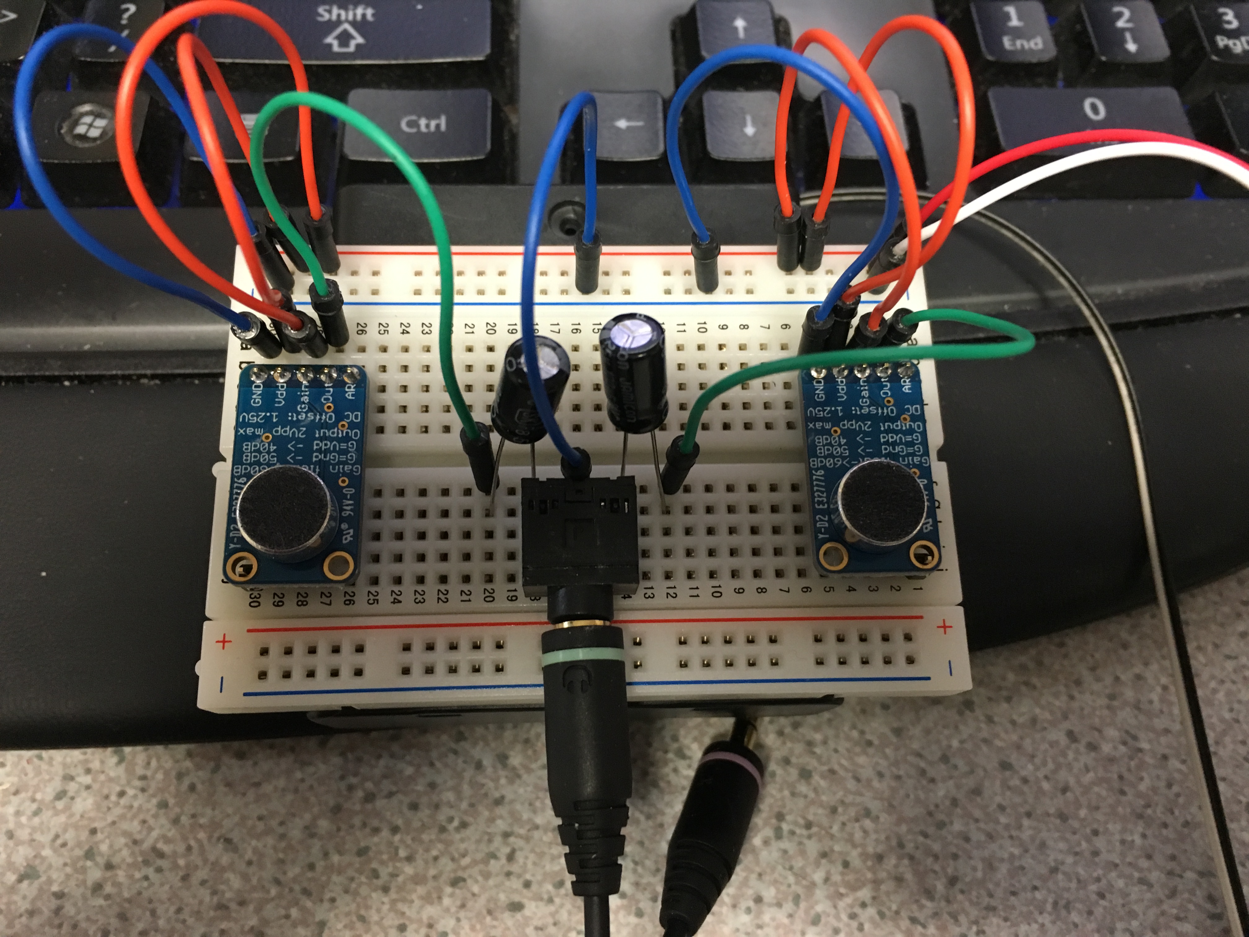

Helmet audio prototype:
Undecided if I want to stick with stereo, or add two more mics and speakers and go for surround sound..........

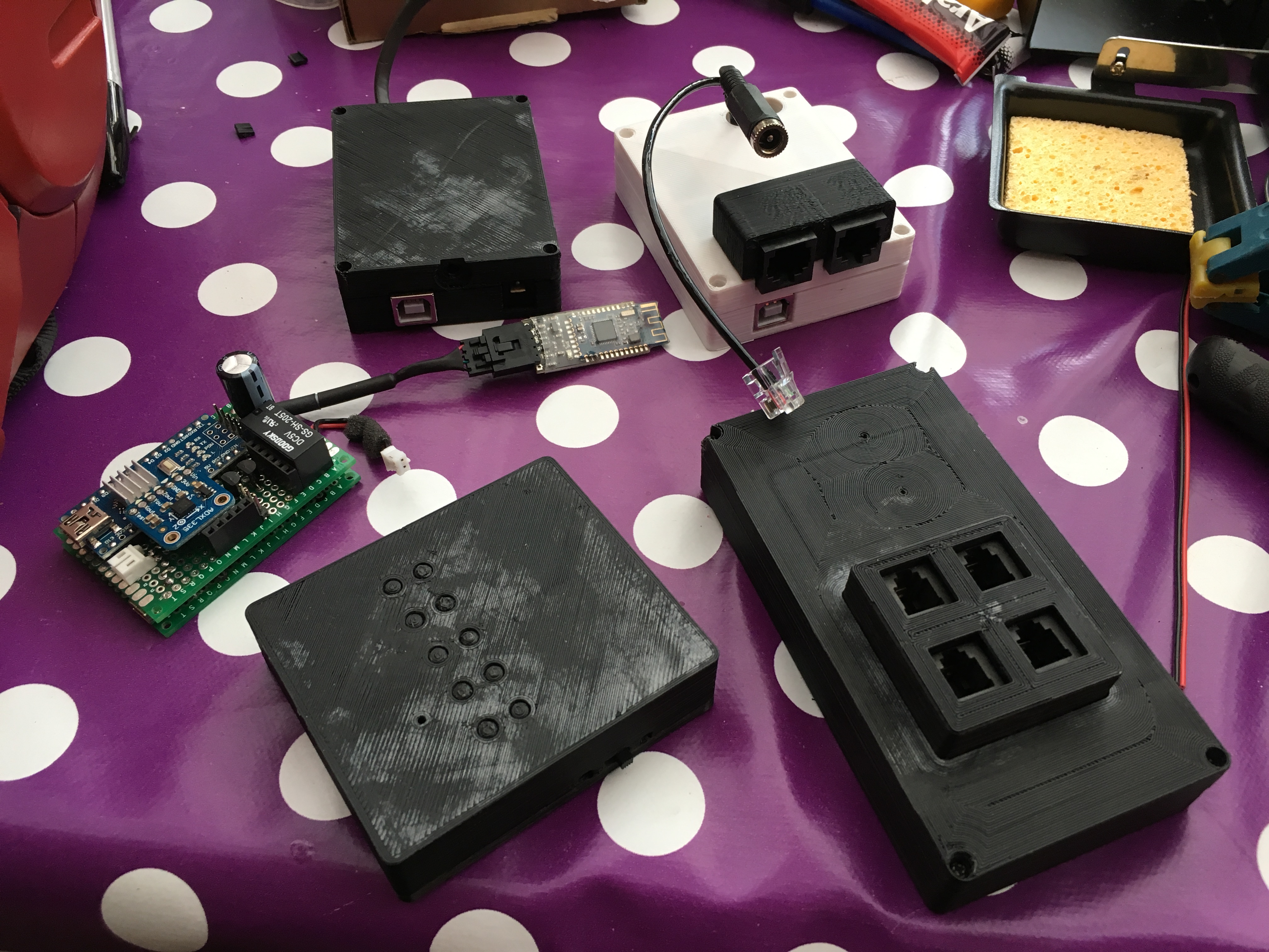

Before I pack things away for the summer, I thought I'd finish off the electronics I was working on;
The exposed board on the left is the completed helmet controller, now with a bluetooth module attached. Top left is the audio controller, top middle the hand repulsor controller, top right the chest light controller, bottom right the comms controller, and bottom left the external remote.
The plan is for everything to be connected to the comms controller, either by i2c, or in the case of the helmet and remote, by bluetooth. Once they're all coded, I'll share what all this connectivity is for.

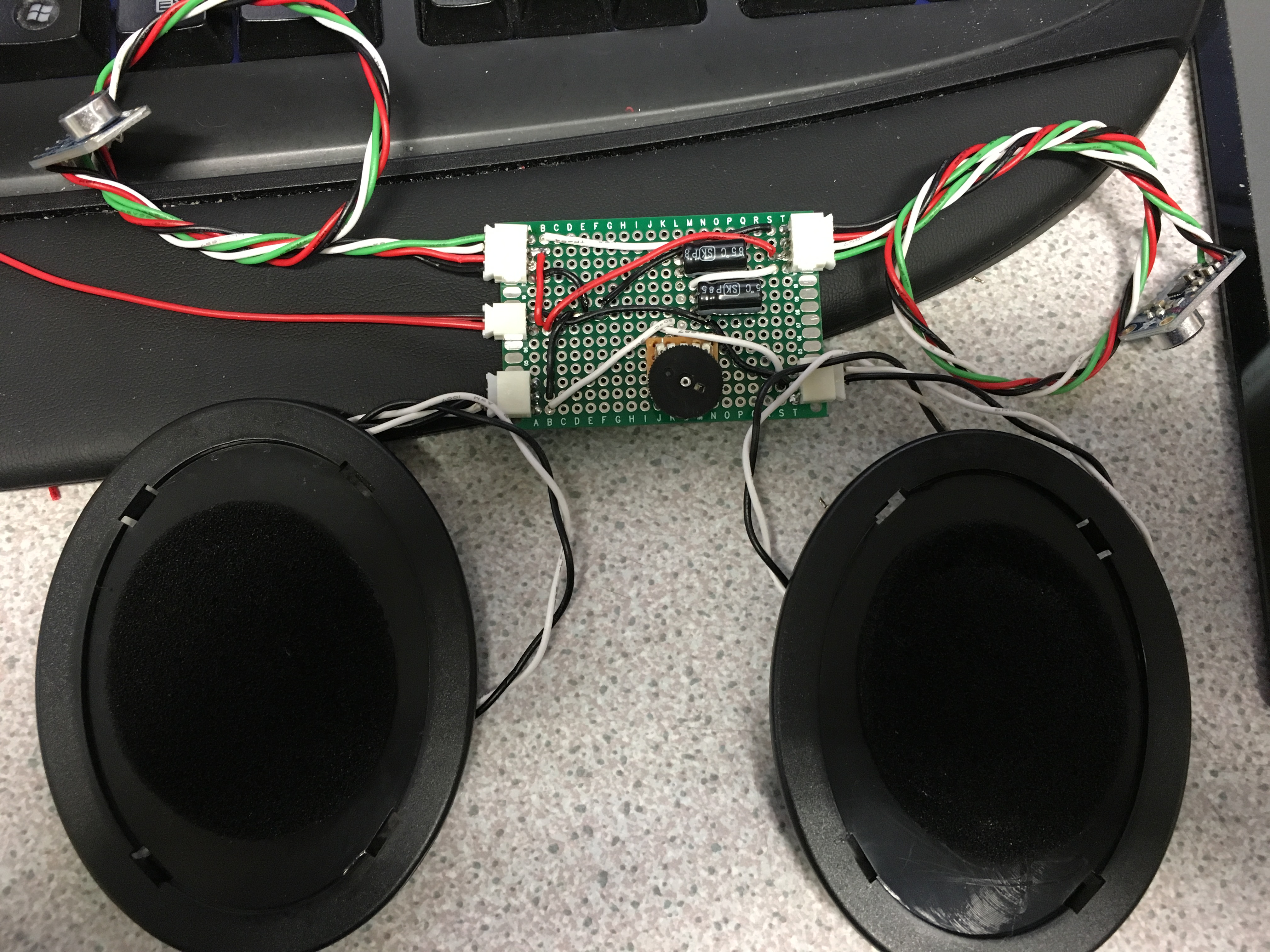

The next thing I'm sorting is the helmet audio;
The headphones are secured in place with small (but strong) magnets, and the mics are just push fit in the teeth for now. I still haven't figured out where to mount the camera yet, but this audio system is so damned good, I might not need it. With the volume cranked all the way up I can hear my fingers rubbing together at arms length - I'm talking Daredevil hearing!
