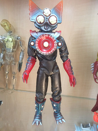

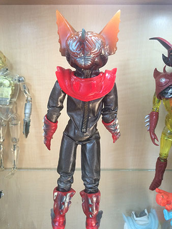

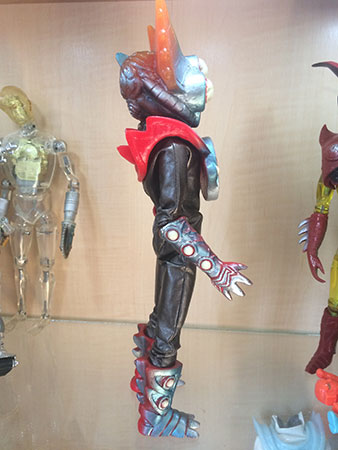

I'm new to the forum. I've been sculpting, designing resin and soft vinyl toys for a few years now, and have been trying to get my head around making a costume of one of my own designs.
Here is the design as a toy in it's 1/6 scale version. Ignore the henshin cyborg in the background, I didn't make those!

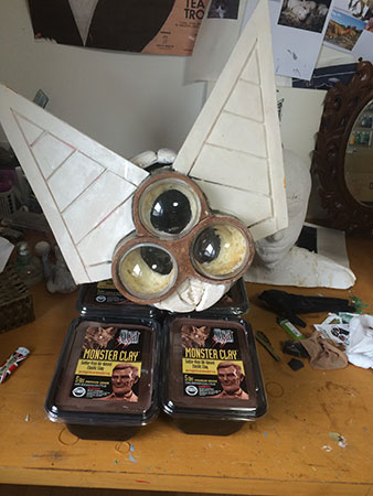

I had a bash at making the head out of a mix of various materials (foam board, light paperclay, new fando, fibre glass/bondo). However, I just succeeded in making an over bulky mismatched mask that defies further detailing revisions. I've decided to start again, using Monster Clay over a plaster bust, and molding from that. It's my first time with Monster Clay, but I've heard it's probably closest to the way I way I want to sculpt.
