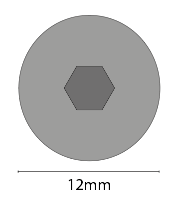

2) How can I find a bolt with a head that looks like this? I don't care about the specific type of bolt - I'll cut off the head to fit the sign anyway. It's just the outer surface that matters.
Specifically I'm trying to find a stainless steel bolt, faced, like this, with a perfectly flat outer surface. A tiny bit of chamfering on the outer edge is fine. Cap head ideally - no knurling and parallel sides, preferably not countersunk. Not stamped with the steel alloy type or part number. 12mm in diameter, with a roughly 4mm hole for an Allen key.

What your describing is a "socket head allen screw". What your showing in your hal picture is a "stainless flat head allen screw" that someone put in a lathe or spinning device and either machined the top surface down or hit it with some sandpaper to give you that machined top surface look. That finish is called machined finish
