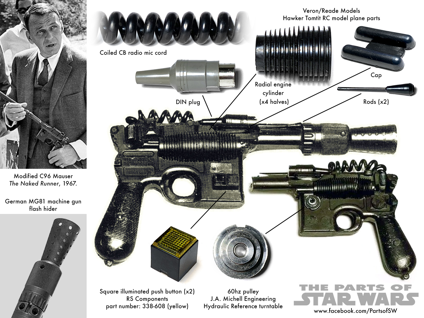

Did you add this Greeblie or was it already part of the casting???
I’m very curious as the exact same Greeblie was recently discovered on the E-11 Folding Stock from ANH; E-11 Previously Unknown Prop Details
Those are square push button caps by RS Components.
I believe the button cap is only on the one early E-11 prop photographed for reference/approval by production.
Same two button side by side configuration is on the Merr Sonn too.
It's also on the front sight of the Margolin Leia/Luke blaster, DDC Defender.

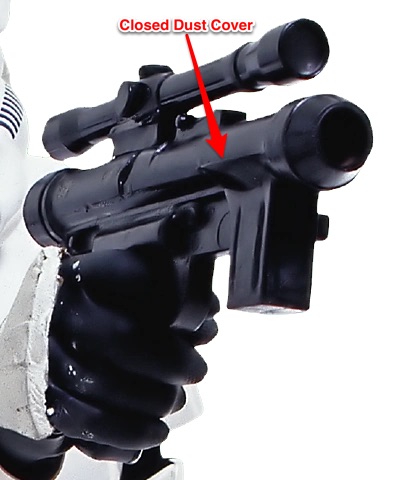

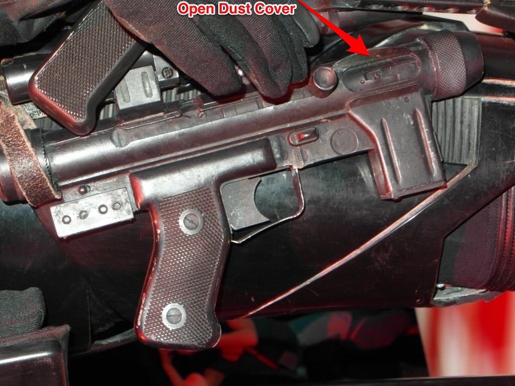

Maybe just the trigger if anything for installing electronics for light/sound. Still early to tell, but I’m told the Dust Cover will not be functional, it will be fixed open so no converting this R1 kit into another version with a closed dust cover.
Anyways the point to my previous post is that the SE-14r example that came with the Anovos Death Trooper statue appears to have captured all the slight differences caused from Lucasfilm 3D scanning Shawn Morgan’s cast into a digital model and is accurate to what was used on screen for Rogue One.
It’s basically an exact copy of the props used on set, no exaggeration.
Suits me since I kinda prefer the Rogue One onwards version.
Sorry to seem dim but which part is the Dust Cover?
The part covering the Ejection Port.

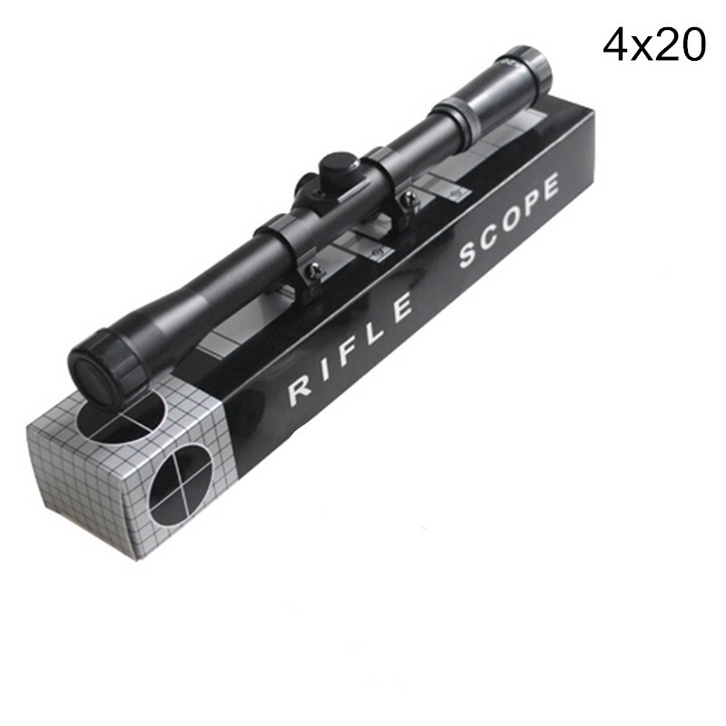

Also each version had a different scope, the Rogue One version had this 4x20 hunting scope, thankfully still available and very affordable.

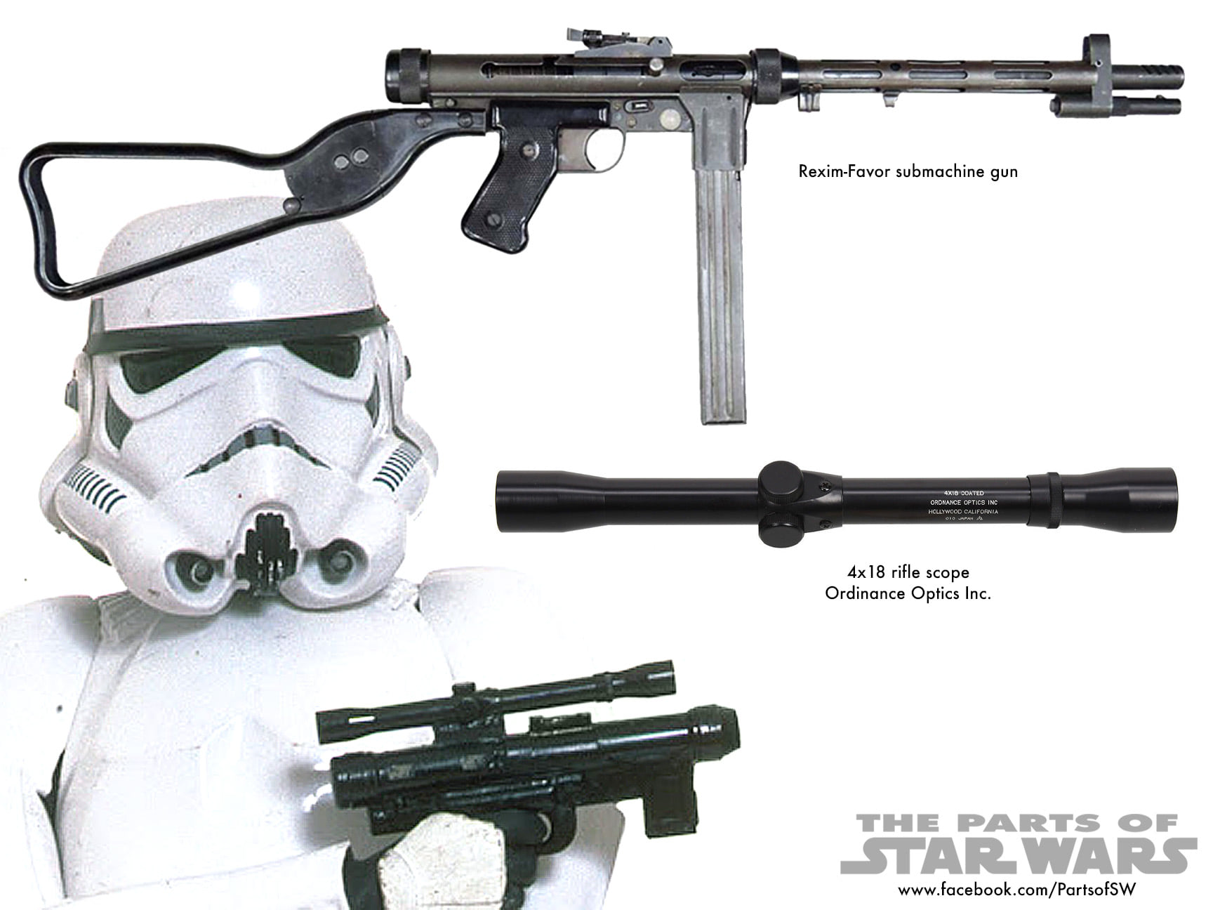

The original Stormtrooper variant had a 4x18 rifle scope from Ordinace Optics.

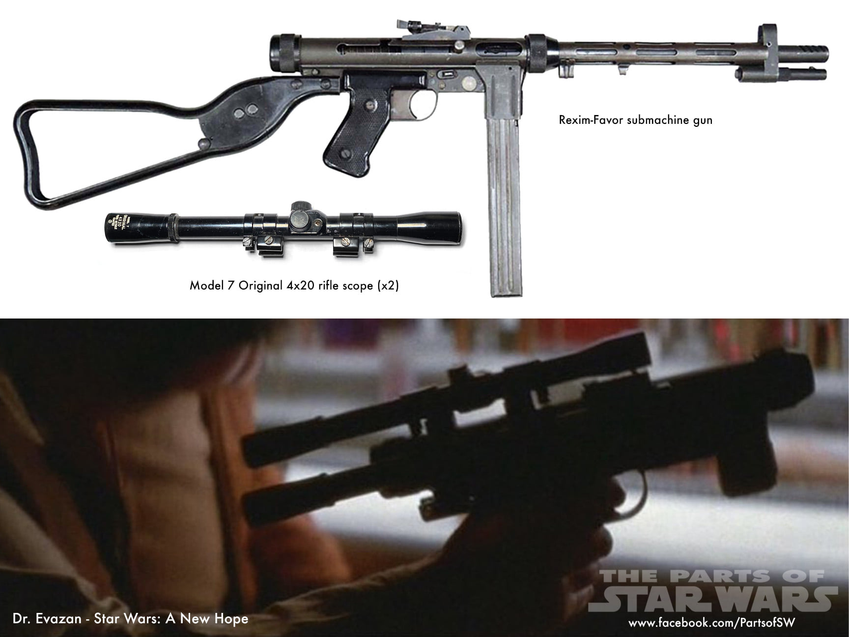

And Dr. Evazan’s blaster used two Model 7 Original 4x20 rifle scopes.
