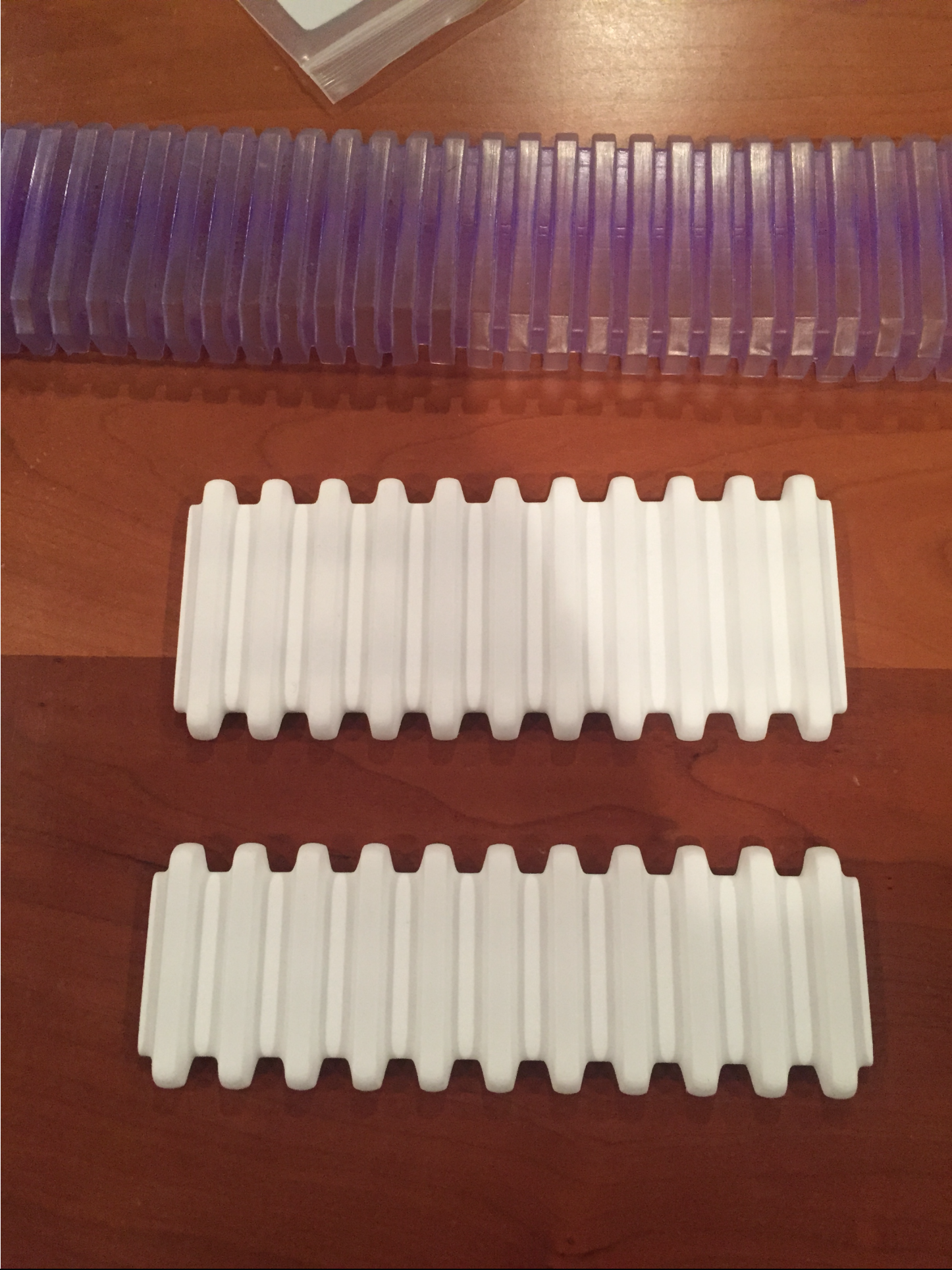

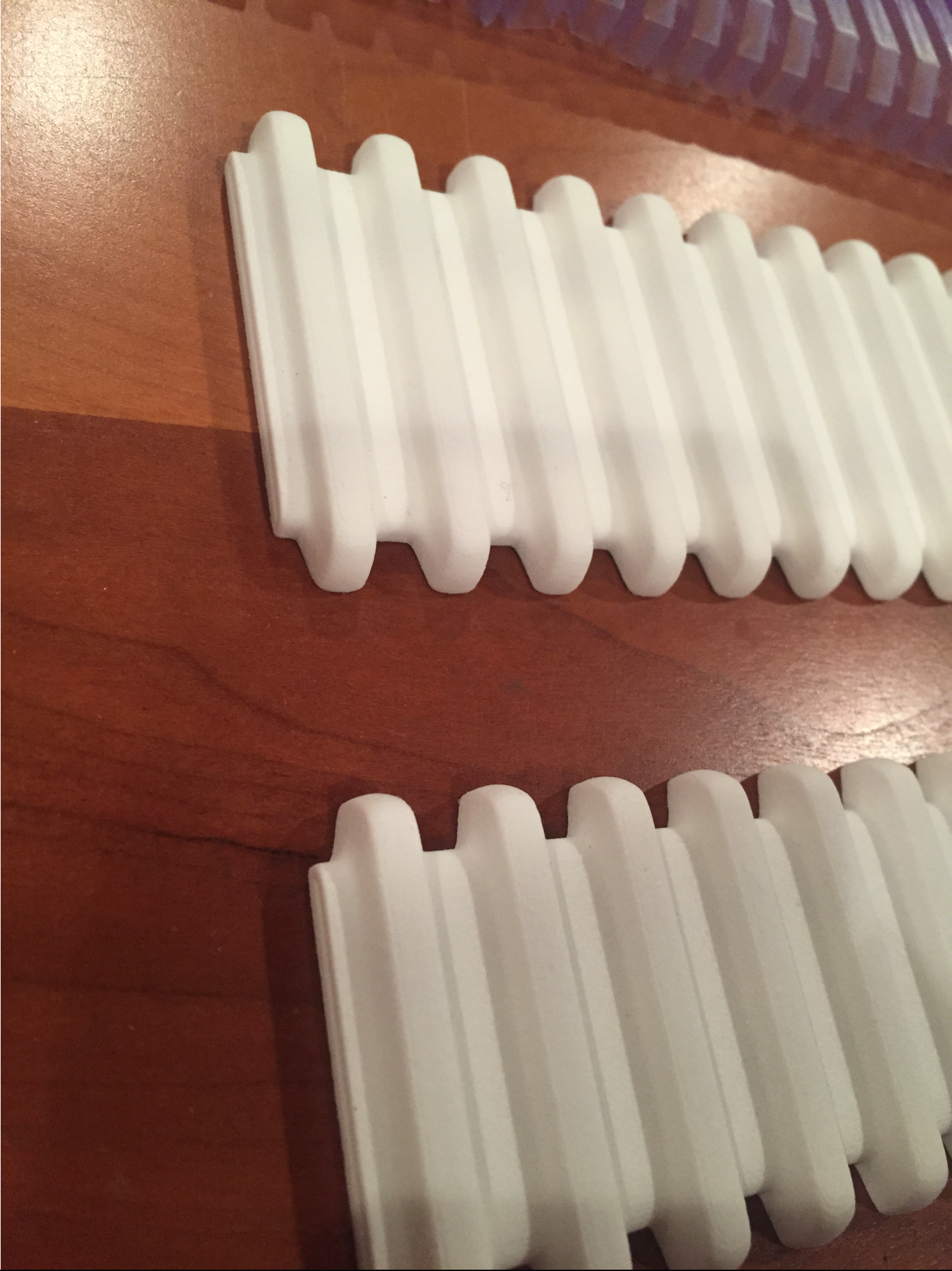

After having the post office jerk me around for a few days without updating my tracking, the printed pieces came in today. I've done 6 inch sections of each the belt and the cuff and will cast multiple hard copies to make my final full-length masters.
Here are some quick shots of the prints, as well as one of the common "chair back bellows" that people use just so you can see how strikingly different theses pieces are...and how thin. (Matched to the amazing profile shots we have from the 2011 Nike Mag launch event)
Screen Shot 2015-10-30 at 11.42.53 PM.png Screen Shot 2015-10-30 at 11.44.20 PM.png
The prints are EXTREMELY clean, but I'm still going to master them. So that's what I'm going to do next.
If anyone else is interested, let me know.
-Nick
