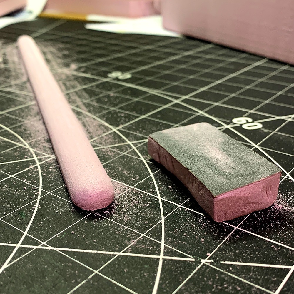

Well - after a few busy weeks on client work I was able to get back to this build. I hadn't been able to find any 1/2 round product that would work so (as per usual) I had to manufacture my own piece.
Cut a blank out of milled down XPS Foam and test fit it in the opening of the scanner:
Once the blank was made and fitting well I took my time carefully sanding it into a 1/2 round piece:
I was really pleased with the results! Here are some photos of the scanning bar dry fitted in the rest of the build:
OVERVIEW:
Being busy and not having time to work on the project did give me a lot of time to think about it! When I came to actually do the work the build went pretty quickly!

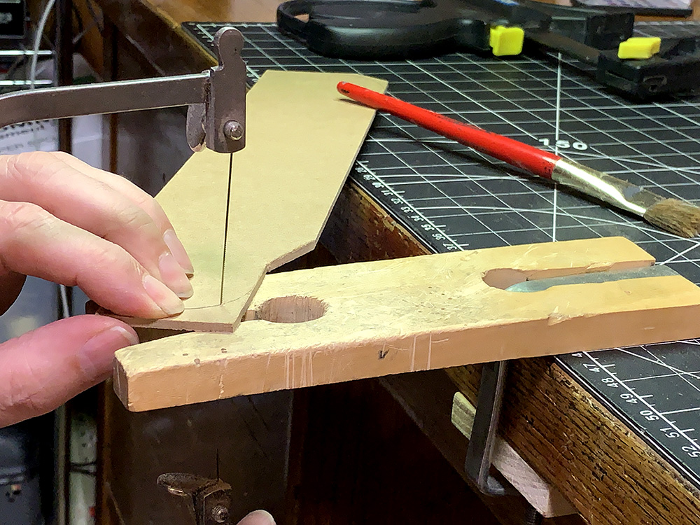

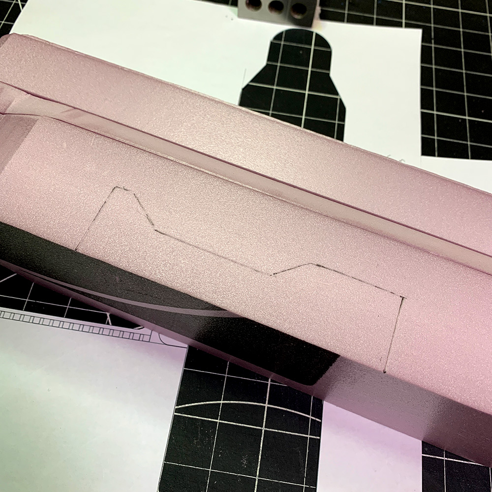

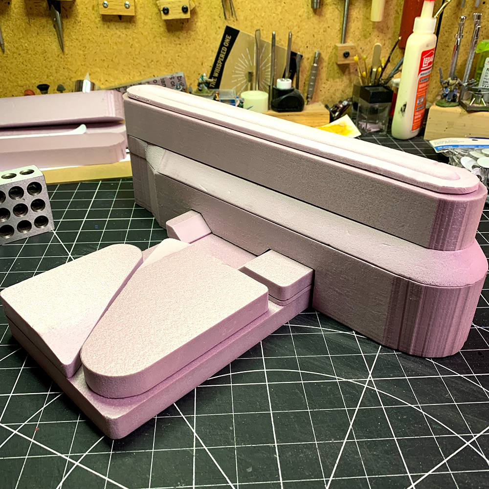

Everything went so well with the scanning lens (last post) I had time to work on cutting the contour area out of the bottom of the scanner head so it will fit onto the tray area.
I traced the outline of the tray onto the scanner head as a guide:
Next - I made a jig out of thin MDF and taped it into place on the scanner head. The "cut-away" area is the product I don't need so there is some safety in not damaging the scanner head piece. I used my Proxxon Hot Wire Table to carefully cut away the area I didn't need:
Here is the scanner head sitting on the tray!
OVERVIEW:
Super happy with how this stage went! Again - I spent a lot of time thinking about it and was really proud I didn't cut it freehand but instead took the time to make a jig (progress for me).
