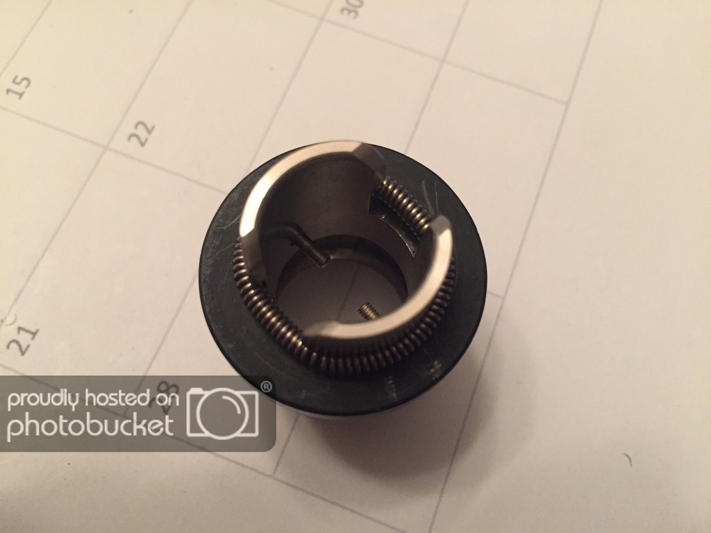

Stealing the photo from @DARTH SABER, once you disassemble the flash bulb array, you get this:

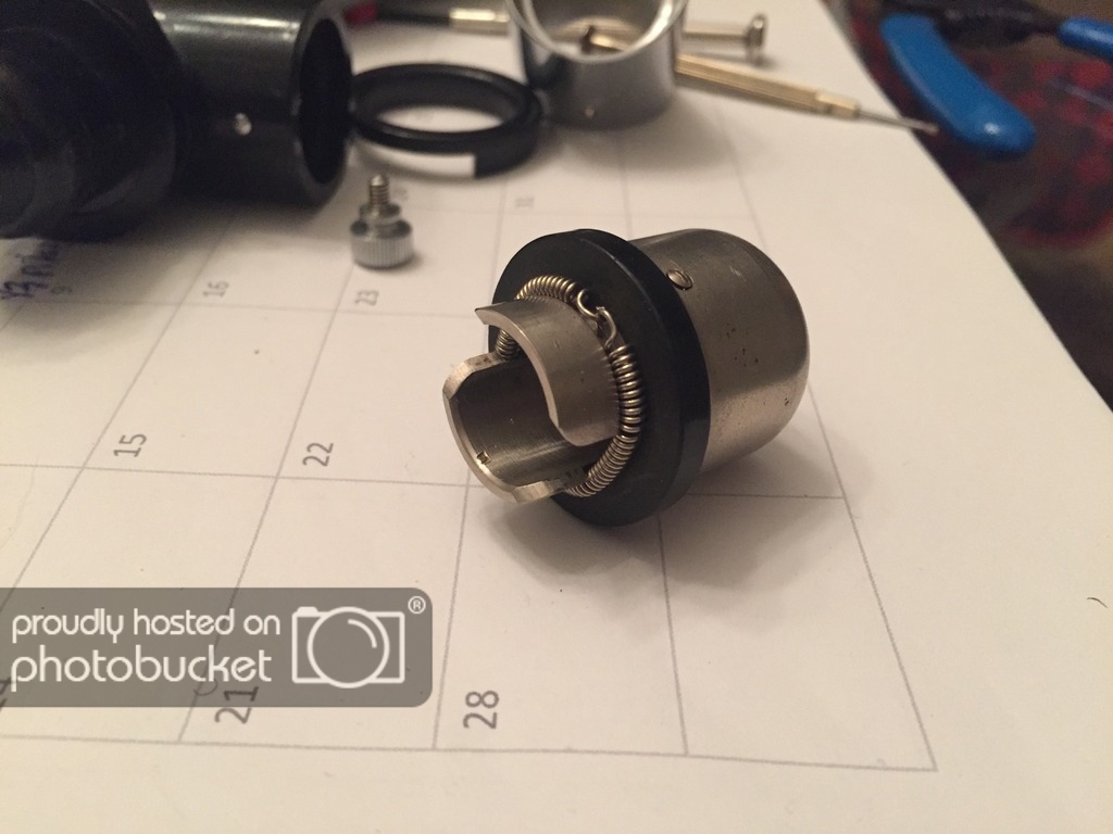

Next, all I did was take the metal 'cup', the screws that were used to connect it to the body, the black plastic ring spacer (not pictured above), and the metl 'prong' set and did this:

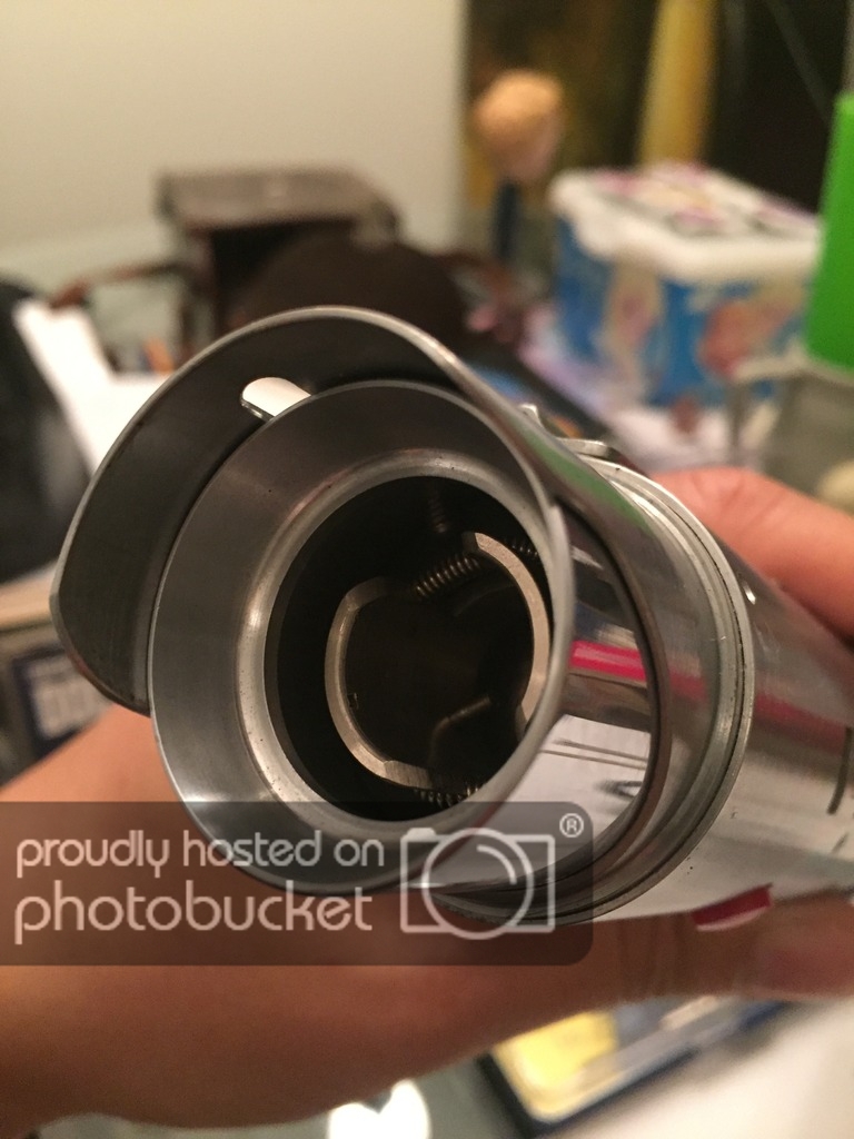

And because the 'cup' just naturally clamps into the flash body... you get this:

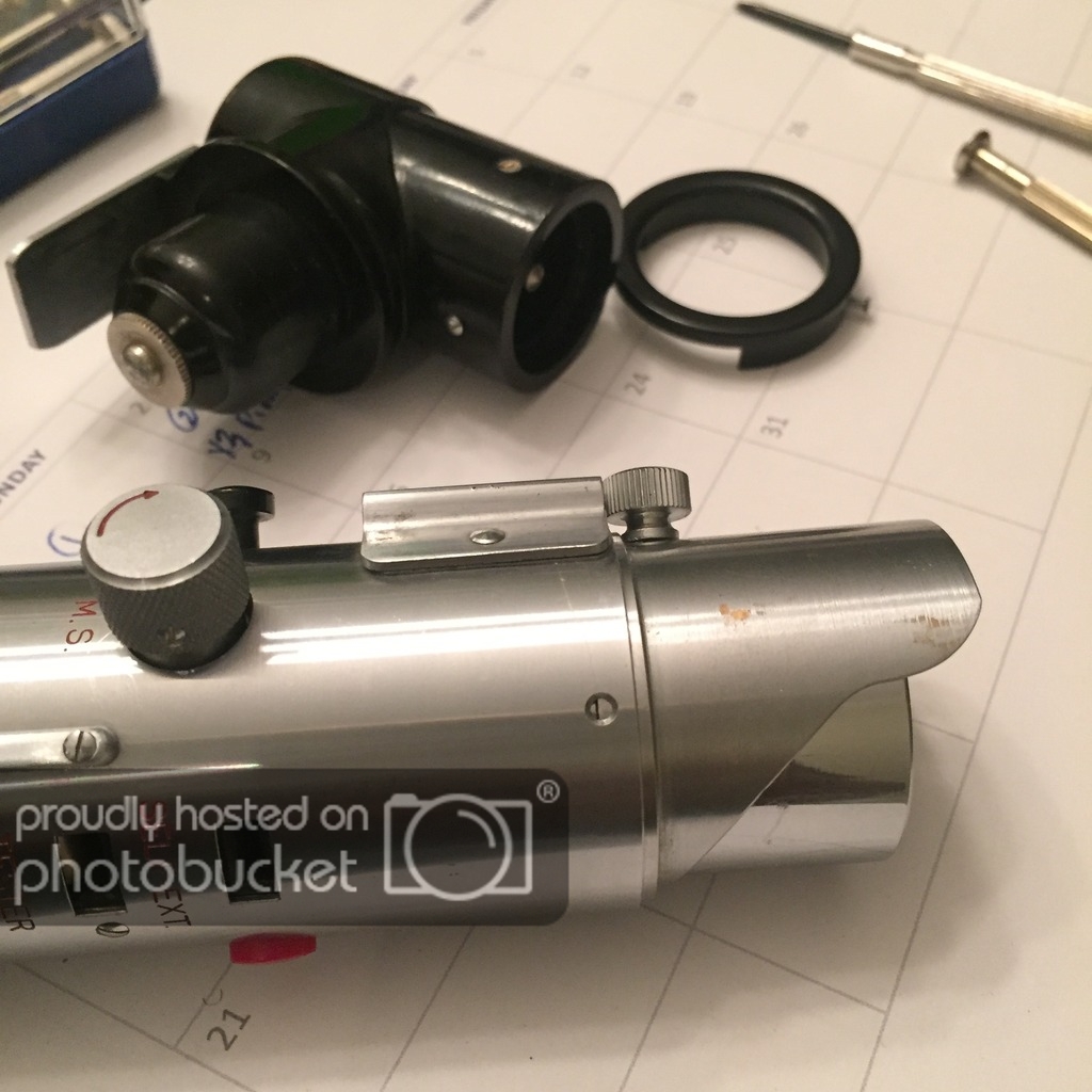

It's actually pretty elegant if I do say so myself... the cup holds the emitter array in place and the thumb screw holds the chrome sleeve in place. The screws are too long, but I kind of like it... they remind me of pilot light igniters.
No drilling, no glue, no additional cutting required other than needing to tap one of the smaller holes on the chrome sleeve to fit the thumb screw.
Now all I need are some of those funky grips that @Scott D uses to finish this puppy off!
