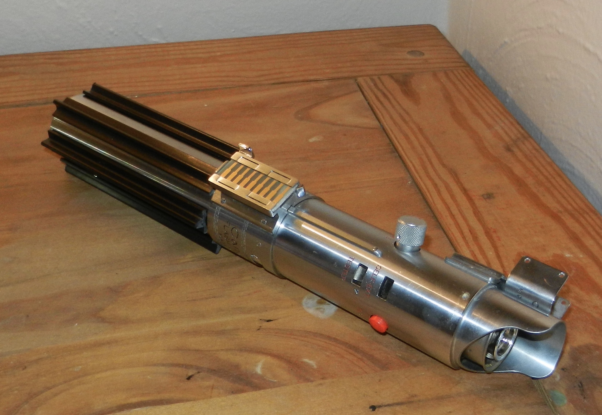

The grips are pieces of stainless steel from an Ingersoll-Rand valve kit. They're like a guide for a reed valve and they come in various lengths. I've had a bunch of them in my greeblie stash for years and and many were used on 12 custom Lightsabers that I built in 2015. (Pics of those projects are in the "Show Your Custom Lightsabers" thread) Between that and giving several sets of them to my fellow RPF members recently, my supply is starting to dry up.

This is what I like to see. :thumbsup Found items can be discovered in the scrap bin at work, inside an old computer that you're about to throw away, or in my case, I picked up a greeblie in a parking lot today.
Other builders might have access to better equipment/tools and have an easier time working with metal, but it's a chore to me. Especially working with stainless steel.
Cutting the grips to length isn't so bad. I have a die grinder for that, but when it comes to drilling the holes, it can be a struggle.
I use an old cheap/borrowed drill press with a wobbly chuck and I tend to buy new bits on every other set of grips made. Not very good at sharpening them, either.
I like the look of 8 grips, so it's 16 pilot holes and another 16 passes with a larger bit to make the holes big enough for the 6/32 allen head screws.
I made a jig, so to speak, using some more grips to hold the one I'm drilling in place.
The bits get plenty of oil on them to help cool them down and assist with the drilling. When the job is done, there's usually a big mess to clean up and I'm kinda OCD. :facepalm

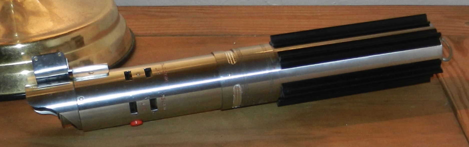

The emitter he used was the bulb housing on the right angle flash. The weird thing about Canon;s is minor differences in the clearances on the top. Of the three I had, one of them had the bulb housing slip right out when I took out the screws, the other I ended up more or less destroying trying to get out. It just wasn't going to come free.
The emitter would be the part that you have it resting on, inside that chrome sleeve.
No way to know until you take it apart. The reports have been scattered by everyone who's had a Y or X. Some are singular pieces that come out, some, like Scott's, had to be cut out. Some fit right inside the end to be an emitter, others are too big.

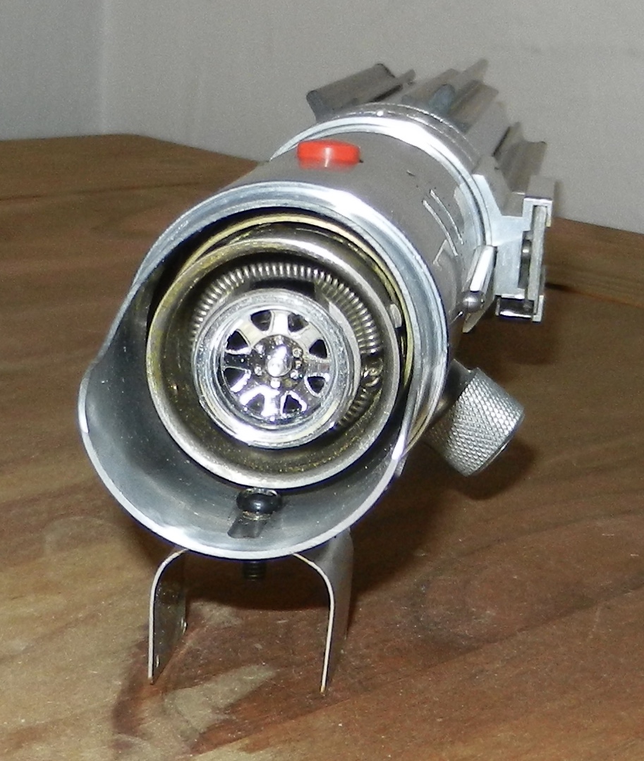

That's what I did - If you remove the black plastic lip you can slide the beveled section (with the long vertical hole) in there
I also used the spring piece and the cup to make an emitter (along with a model car wheel). I think I stuck something underneath the cup so it would sit higher, because the cup is the exact width of the socket.

the beveled emitter has a lip around one end that wont fit inside the flash tube.
did you cut that lip off?
That's what I was talking about-- some fit, some don't. Scott had to cut his, I didn't have to cut mine. My second Y and the X didn't fit so I used them on other sabers. You mean the Graflex-ish curved shroud right? With the numbers on the back?
By emitter I was talking about the bulb socket with the spring around it. One popped right out and fits inside-- the other I destroyed trying to remove-- and that's what Scott had to cut out as well.

i made a small change. Instead of cutting the lip off the shroud i grinded along the edge of the lip until it fit nicely in the flash tube.
another downside is the hope for the thumbsrew is now one of the holes for the smaller screws.
im going to have to make the thimbscrew hole bigger and figure out the the right thread count so i can tap it.
