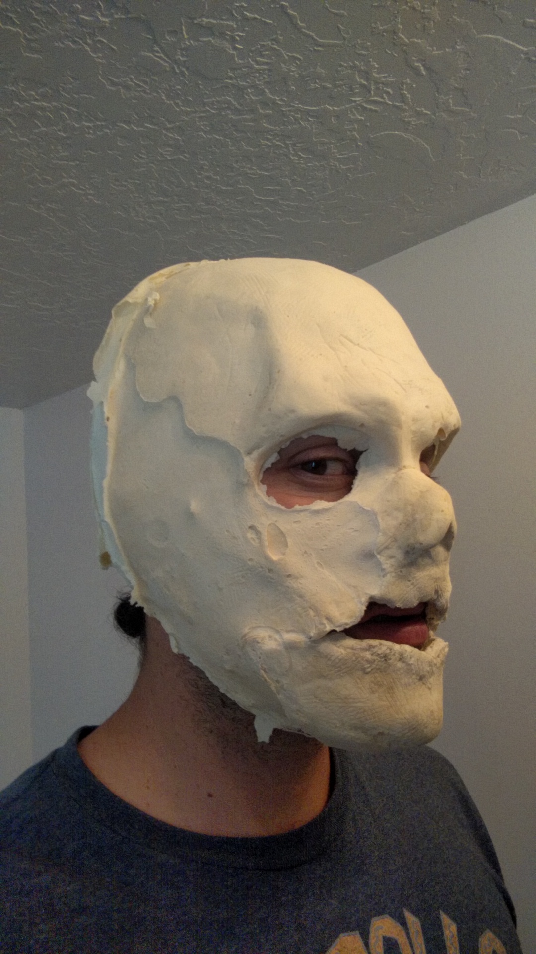

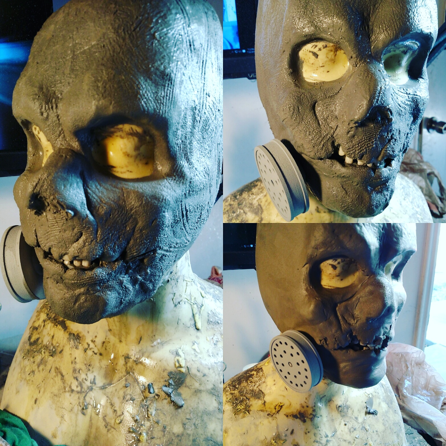

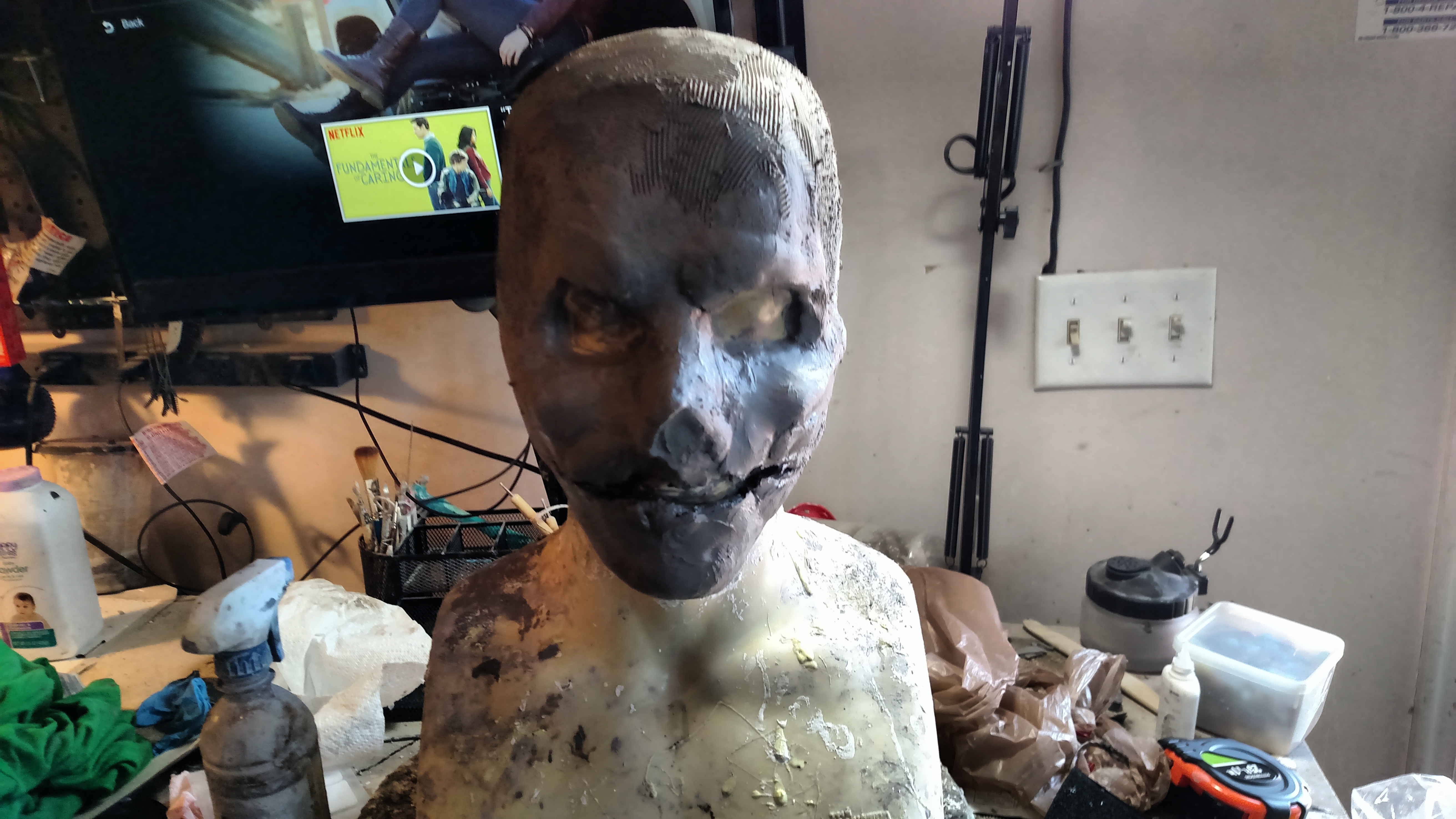

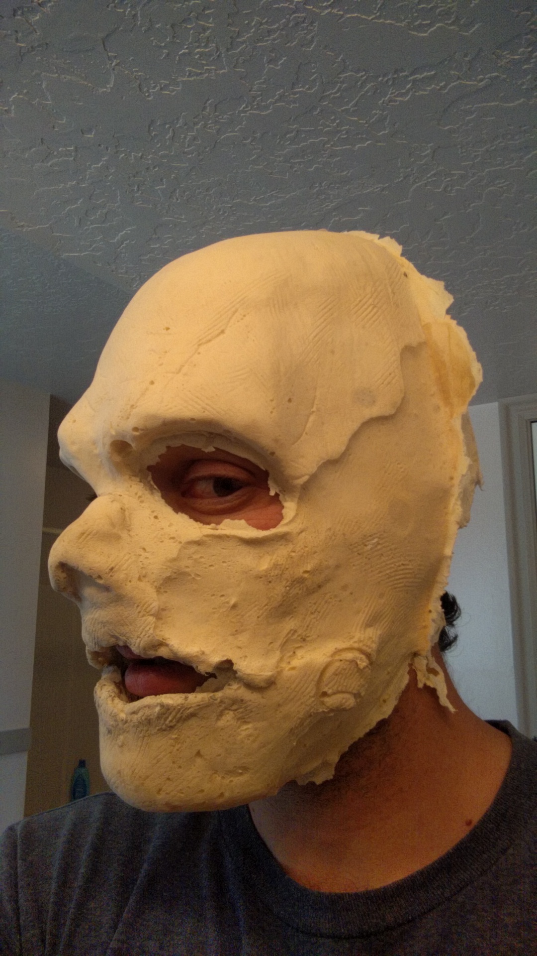

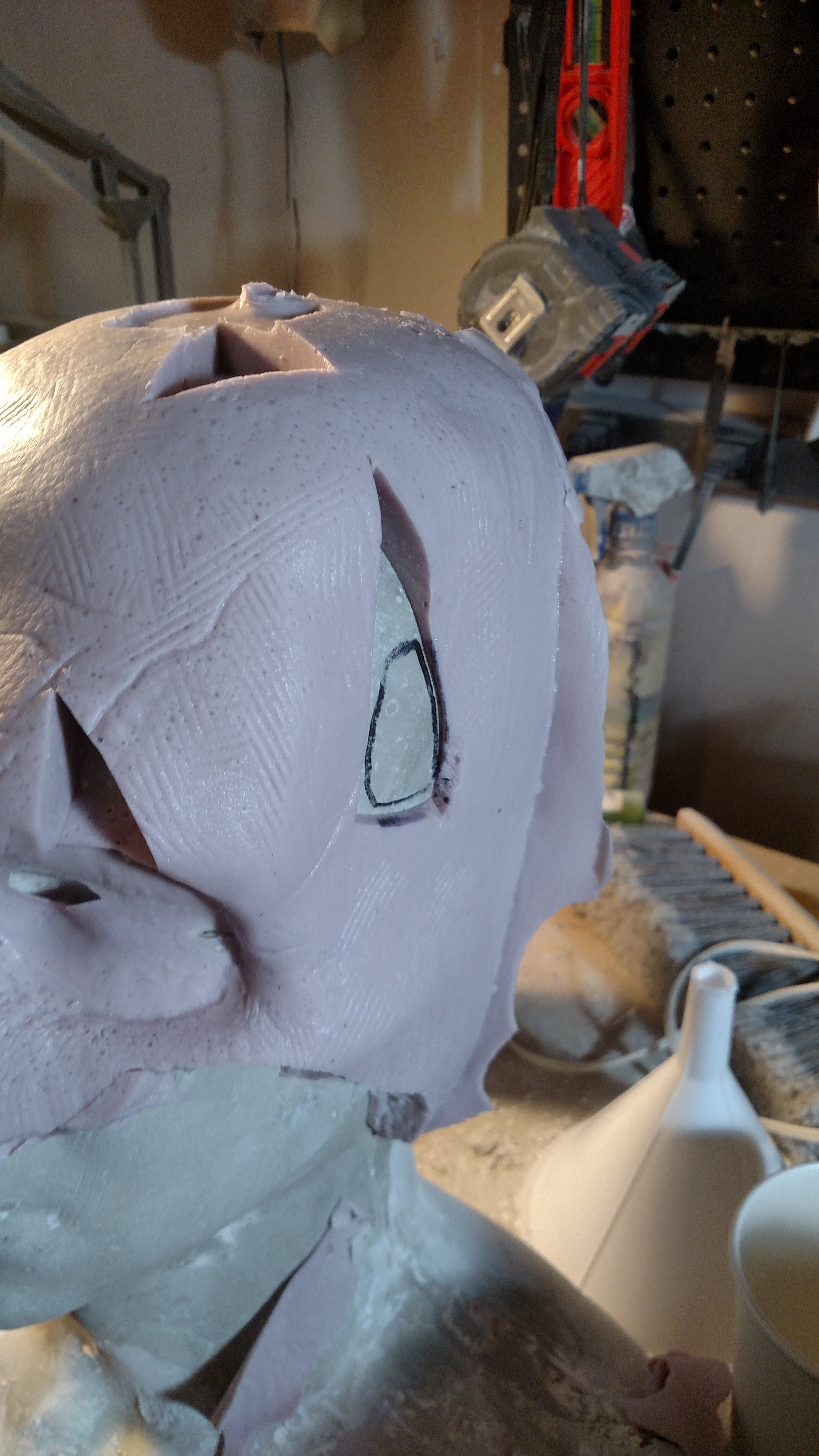

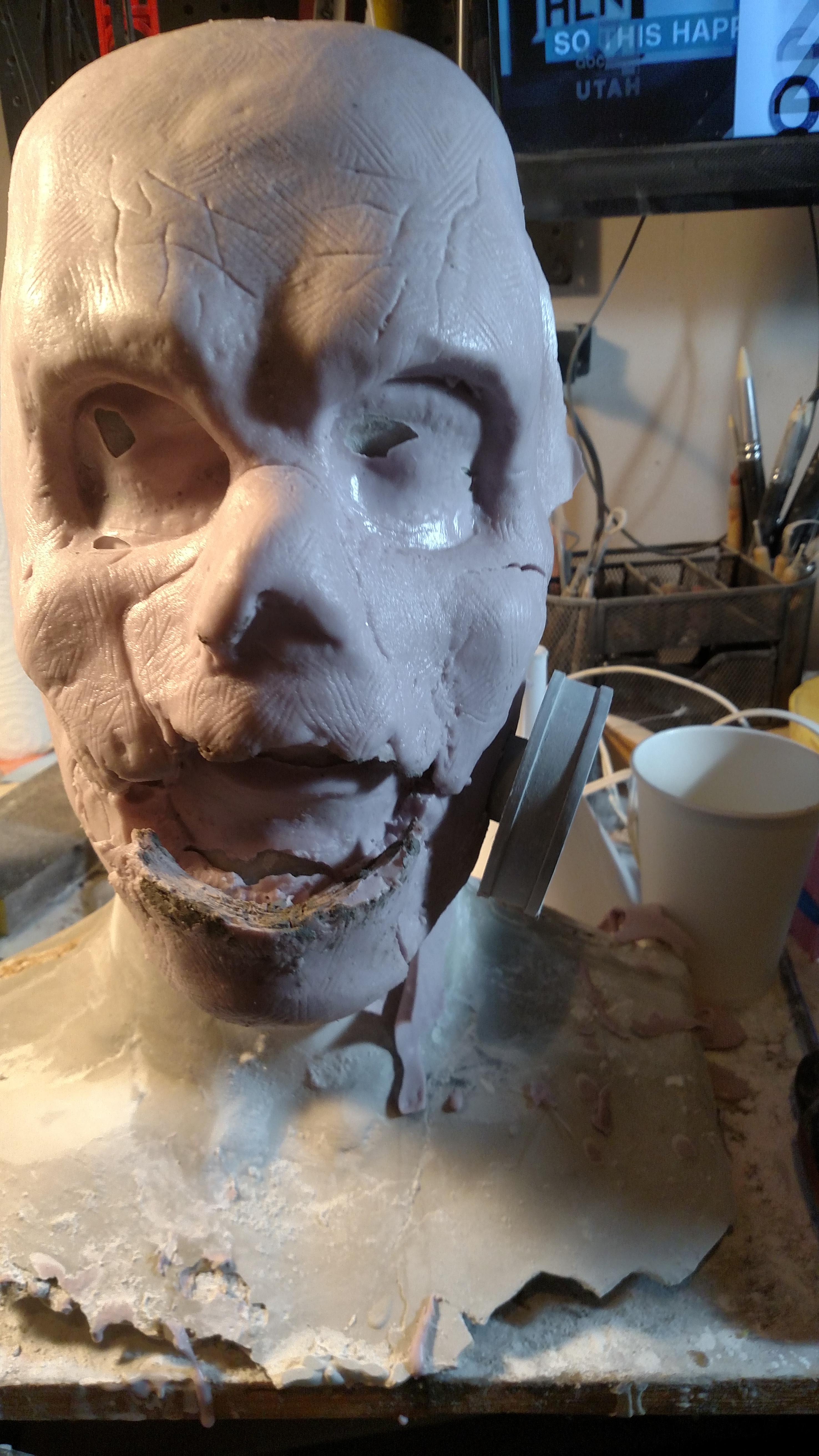

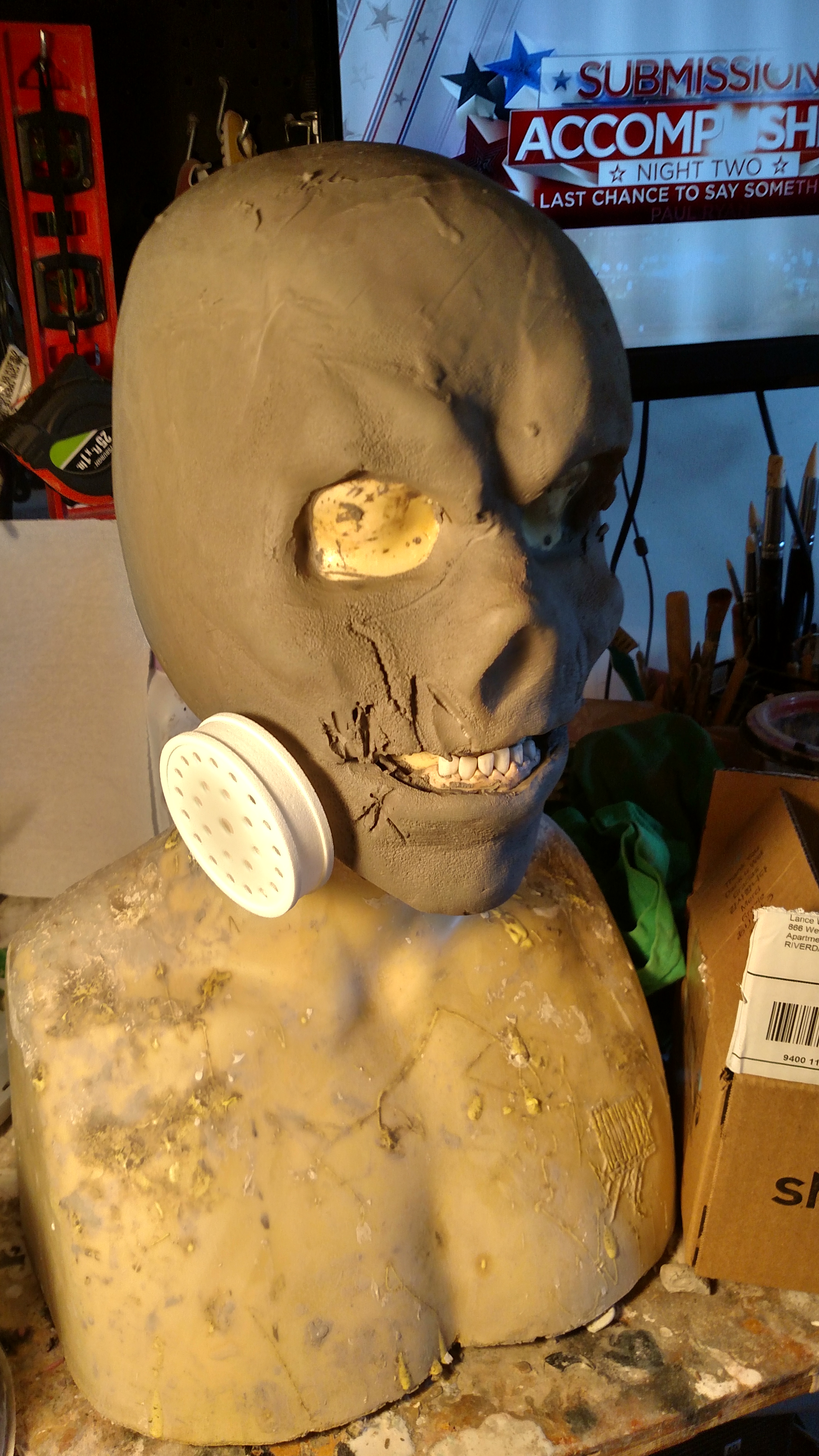

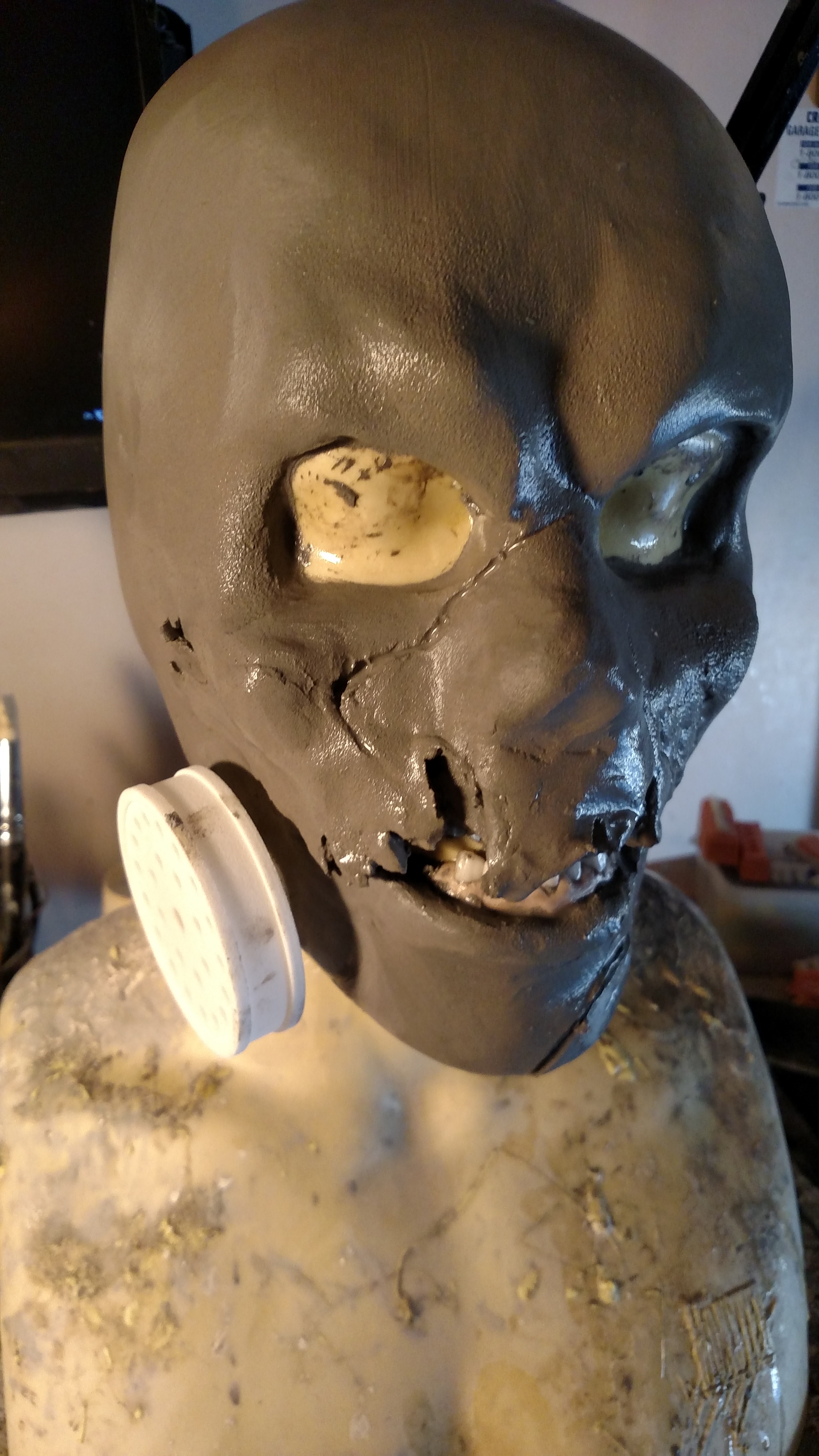

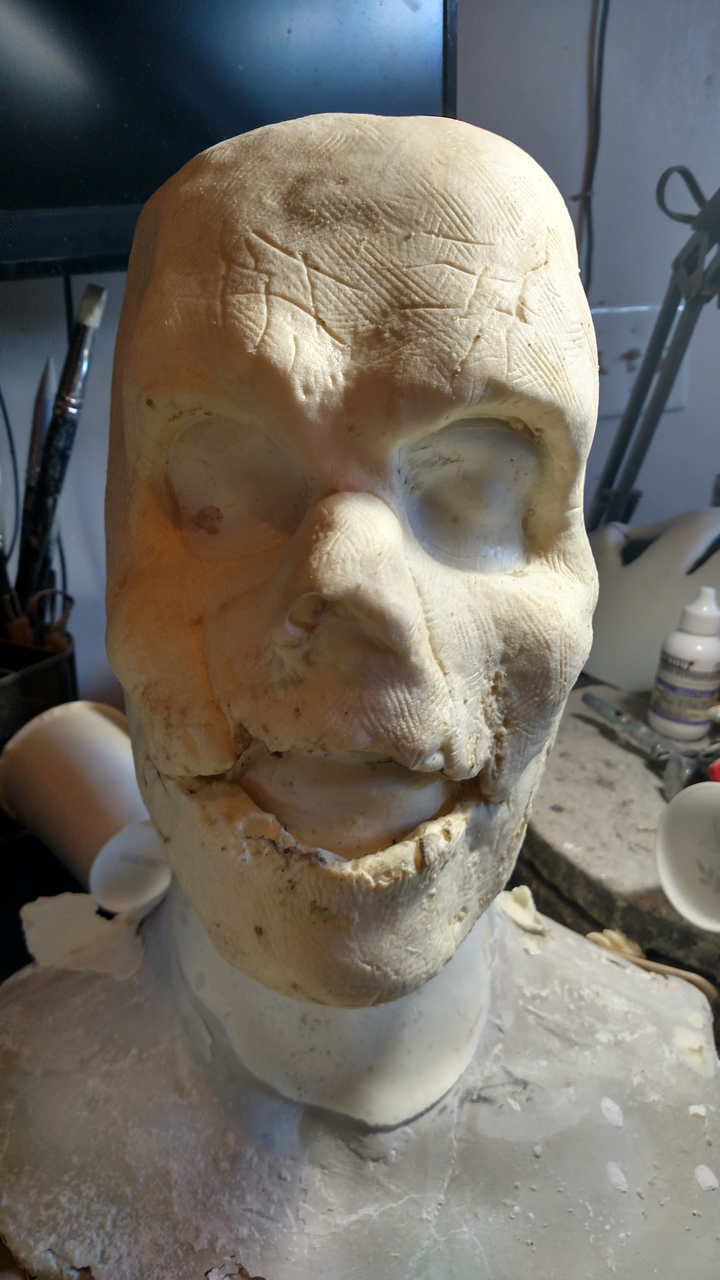

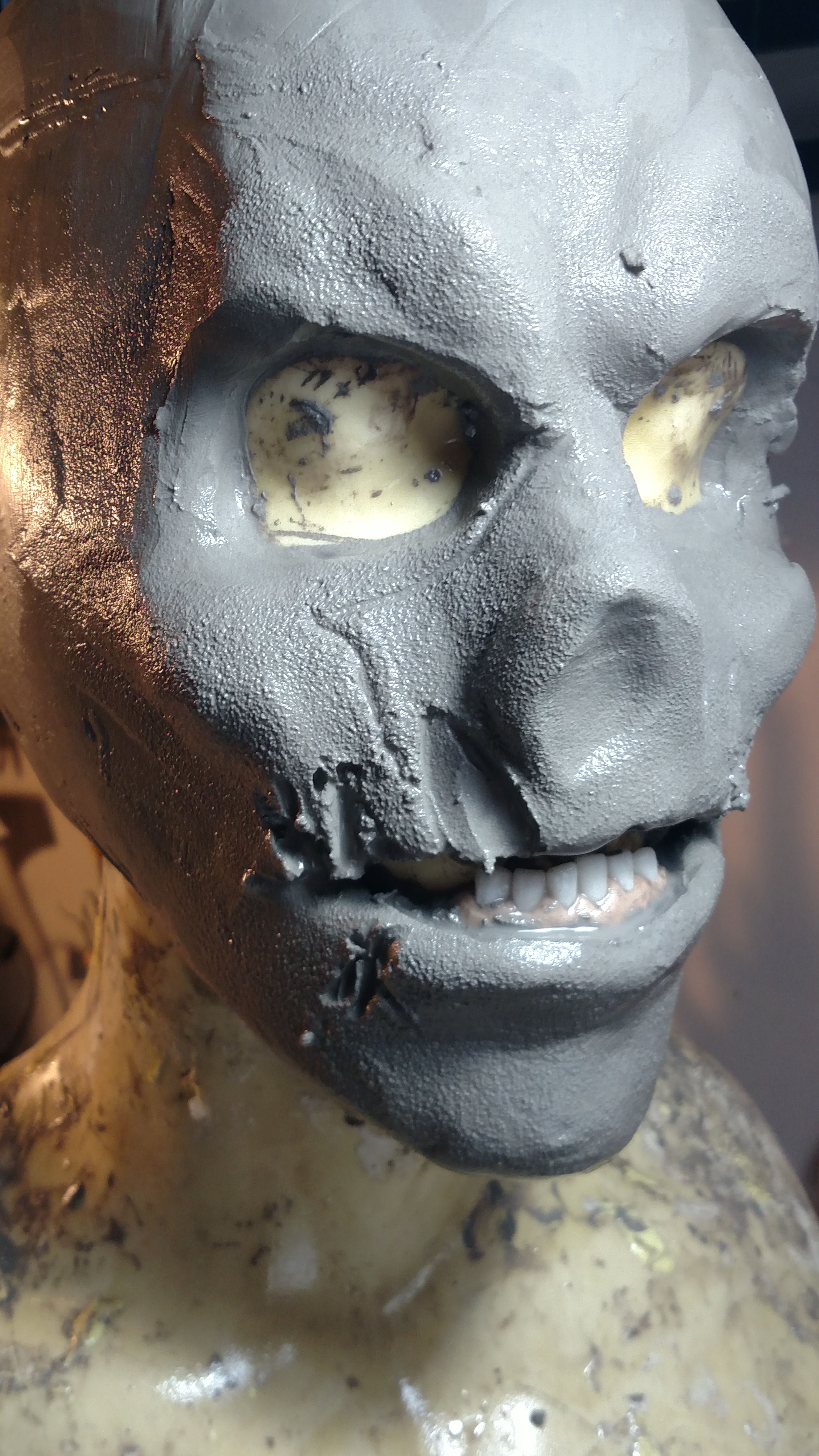

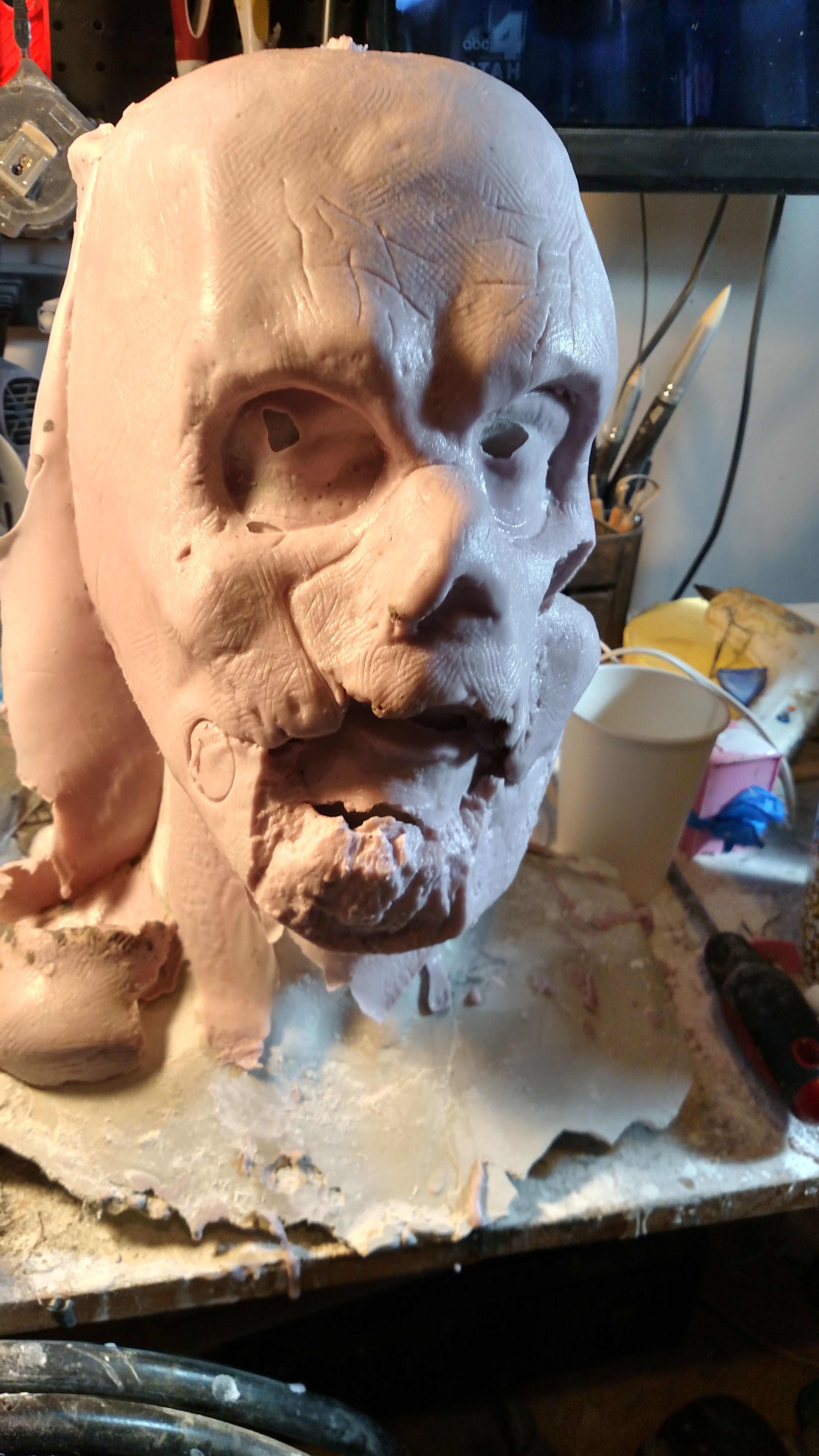

Hey guys. For this halloween I decided what better way to freak everyone out around me than with Scarecrow. I've wanted to do this costume since I first saw his design, and thought why not now. The first thing I worked on is the mask. I sculpted it with EM-210 water clay. This made for quickly blocking out the forms. For the respirator part I designed and 3-d printed that to save some time. And the teeth were made with tooth molds I had and then implanted in clay for the gums. Up to this point I have molded the mask, and this morning I did a test cast with alginate. This allow's me to see if I have any problems that need to be fixed, by cutting out triangle sections and checking thicknesses before I go ahead with the foam latex cast. There are a few spots that need sanding down, but otherwise it should do the trick. I hope to have a foam casting done this weekend.

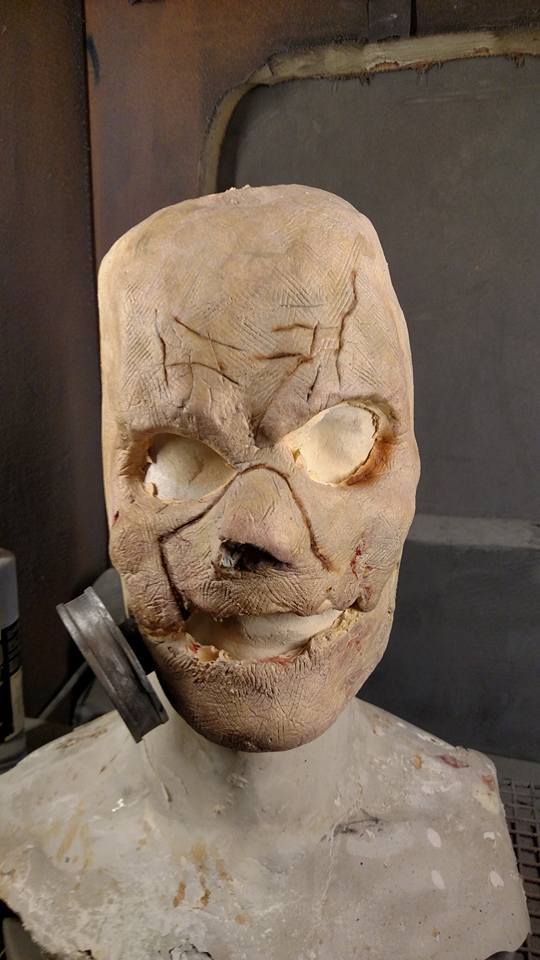

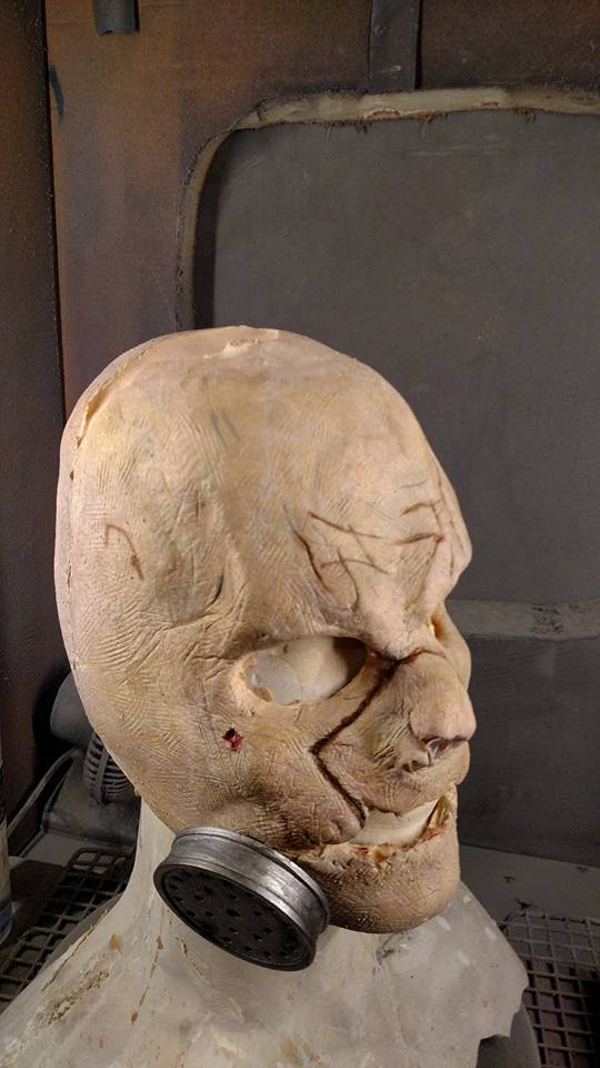

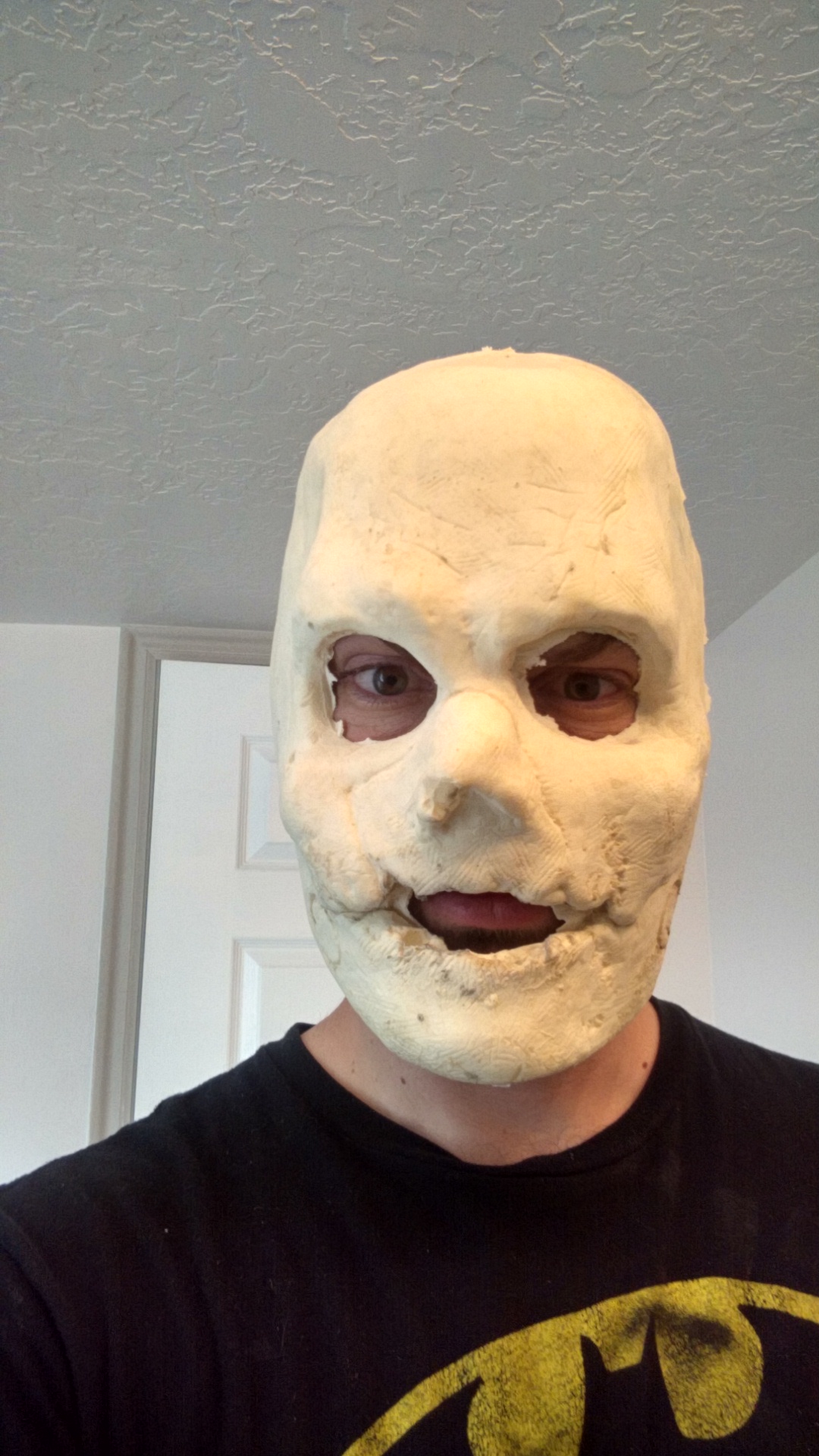

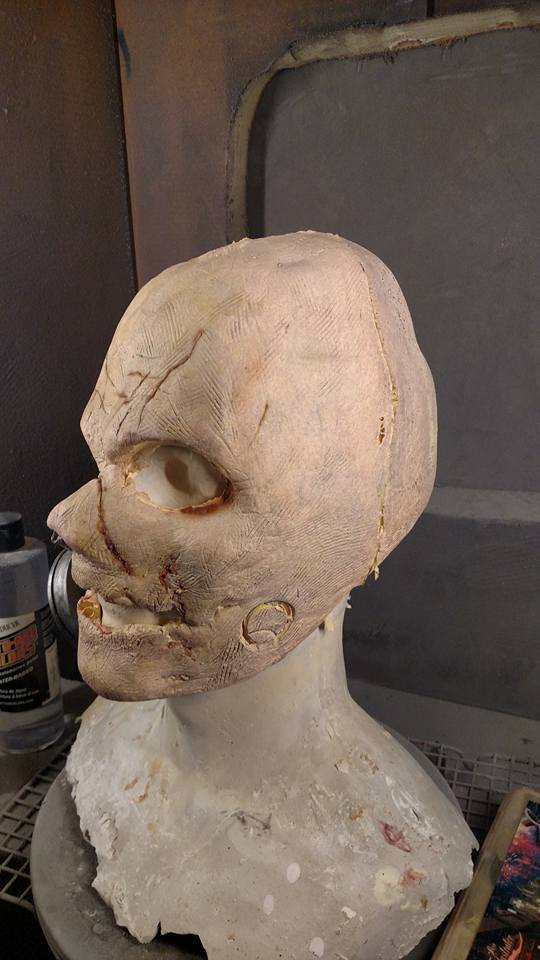

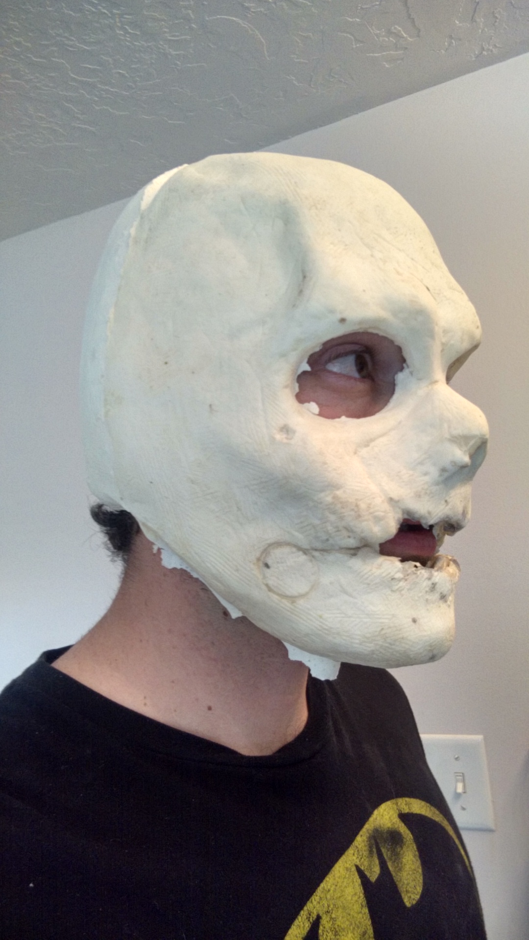

After several attempts at casting the Scarecrow mask, I finally had a mostly usable piece. I had problems with the foam collapsing during the baking process in my first attempts. I decided to fix this I would lower my baking temp by 20 degrees, and add 2 hours to the baking time. That seems to have done the trick, I just need to add a couple of bleeder holes in the negative now to allow for steam to escape for a few problem areas. But for now I will use this as a test piece for painting and assembling the other components. I finished my design for the gauntlet so I'll begin constructing that in foam in the near future as well. I'm thinking with the final costume I will glue down the eyebrow area, just to help with movement.
