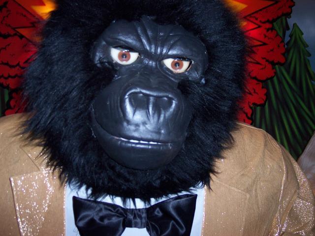

I'm currently painting a mask for an animatronic character and I'm trying to figure out how to achieve a satin finish. I'm using Monster Makers paints, but they give a flat matte finish.
Here's some photos of what I'm trying to do.
It's not glossy, but a leathery kind of satin look. I was considering using latex mixed with ammonia and pigmented with a satin black acrylic paint, but wanted to see if there were other suggestions.
