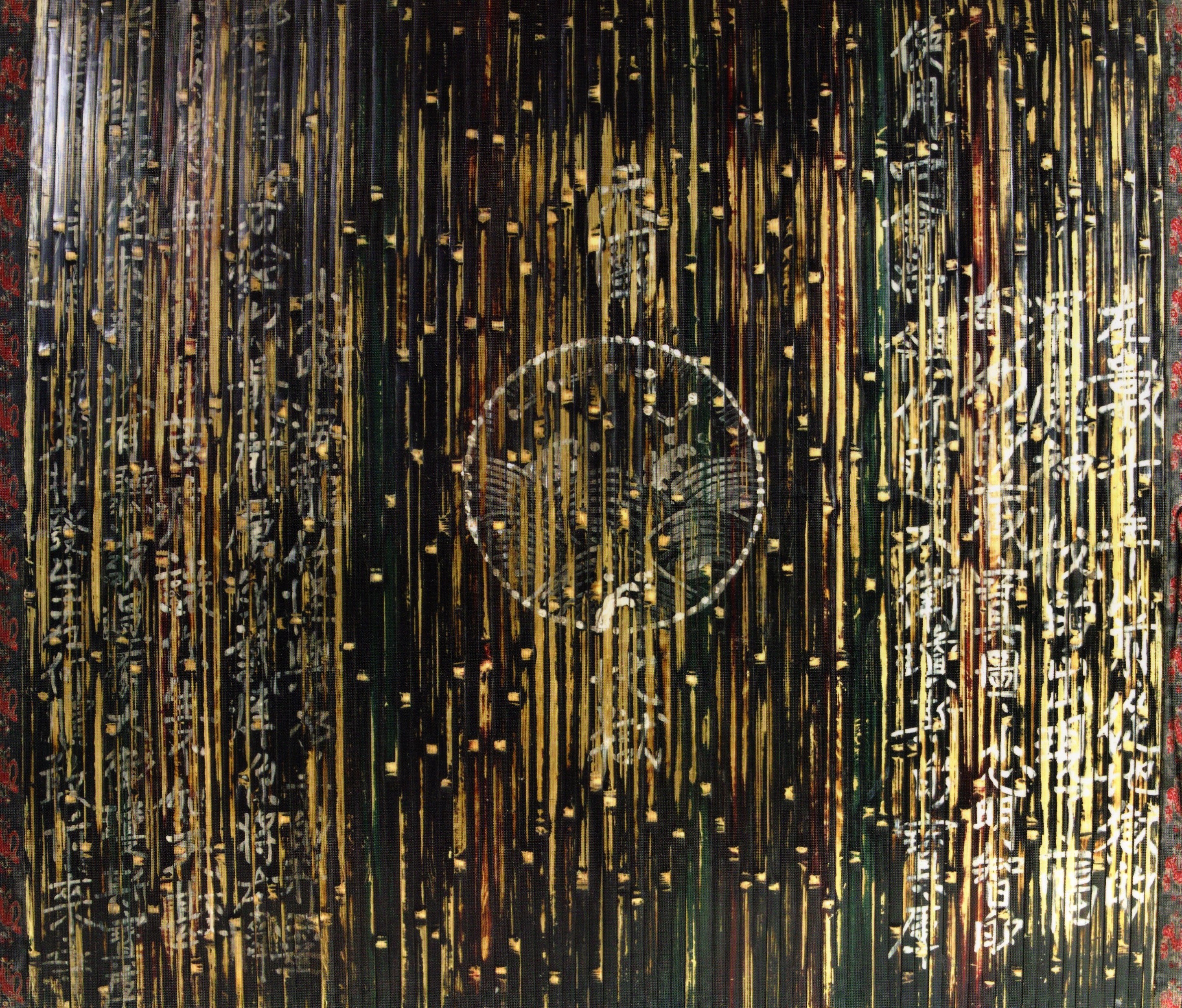

For the meantime the first iteration I'll attempt (if I have the time) will just be a static map on the bamboo backing. Does anyone have any reference images of the back of the map? Or any of the prop itself? I remember it wasn't just plain bamboo slats, there was like charring and I think writing on the back of it.

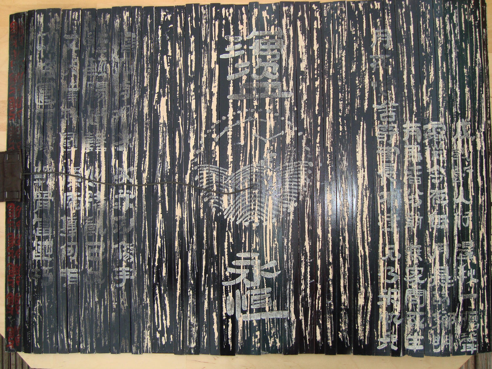

Here is another version of the back, this one from a replica made my someone else.
I might be taking a more complicated approach but my plan is to score the back with vertical lines, spray the back with spray paint, paint all the white symbols by hand, and then sand a bunch of it to give it a weathered look.
