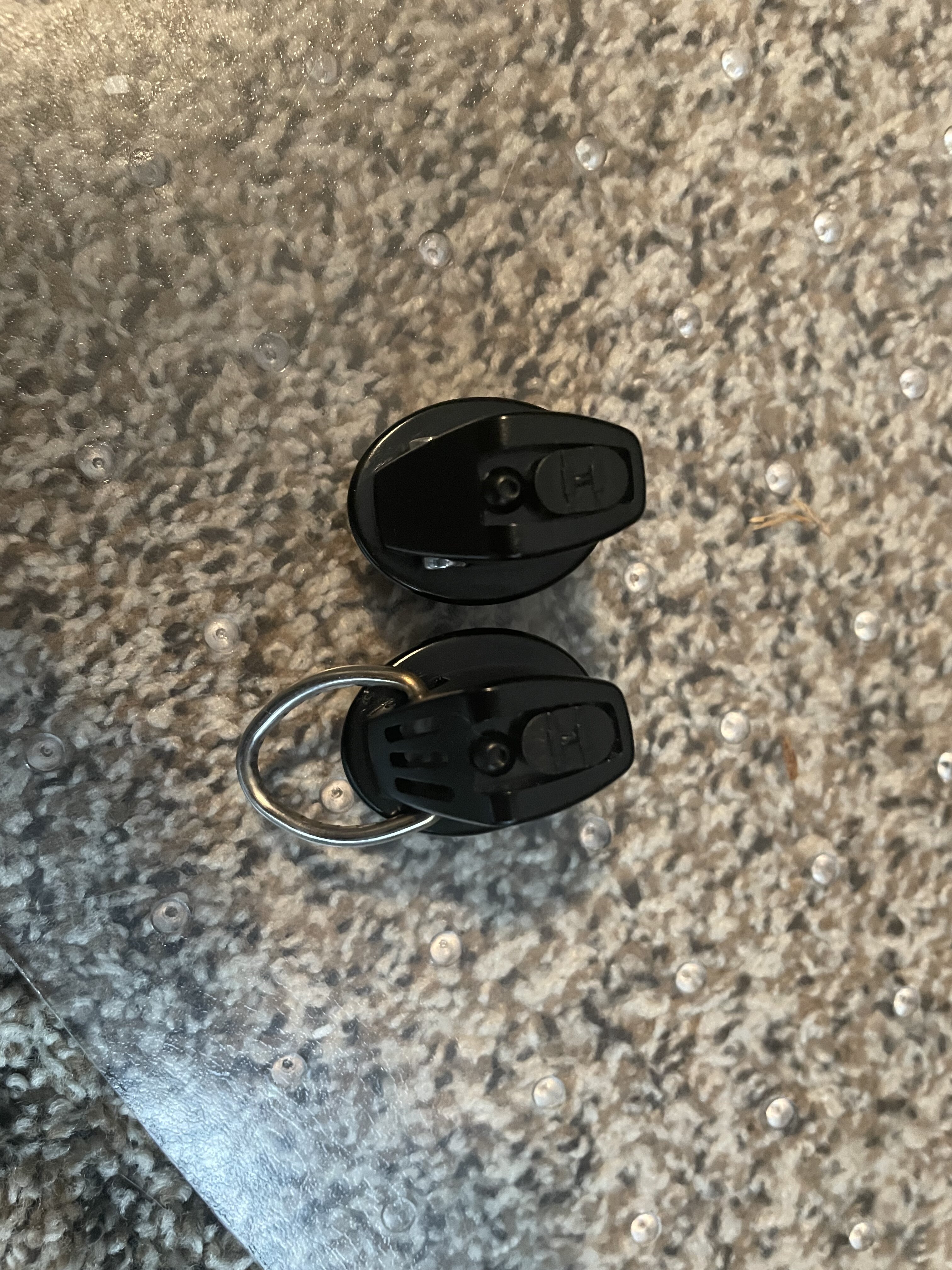

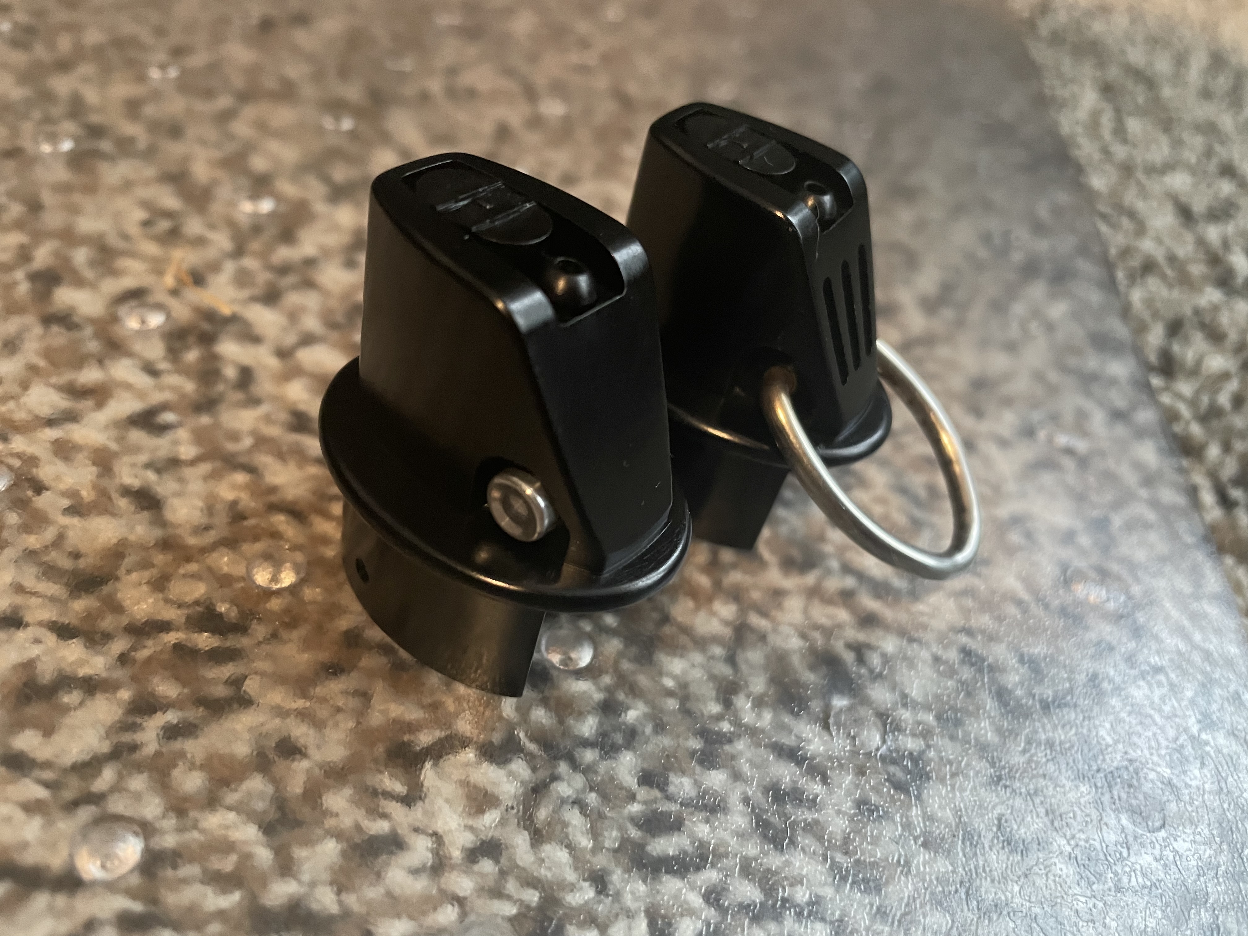

Isn’t guabe s vented pommel a more elegant solution without deleting detail. Static and vented could literally be the same but adding one more machine operation.
Not sure where the confusion is coming from.
Kit is going to come with 2 pommels.
One vented and one static.
The static one resembles the concept art render for season one, where it does have a d ring instead to rivet like greeblies which our kit includes.
And the season 2 style one with the d ring where the greeblies would have been

Sorry I misunderstood the other post. These are dope, appreciate the clarification.

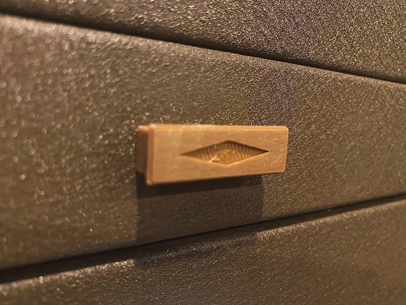

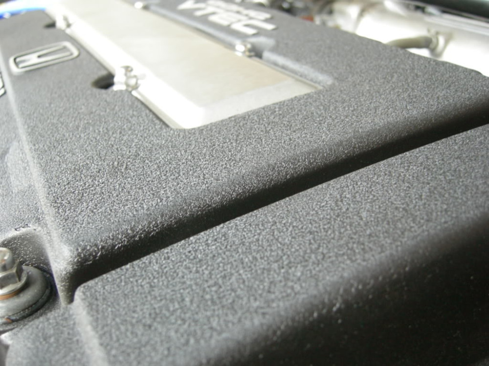

It’s seems like an obvious path but might not be feasible, but if wanting to achieve the renders texture, Kennedy machinist toolboxes have a similar texture, I know there is touchup cans, but they also powder coat their tool boxes now. I’m not sure if it’s the category of paint they use but on other machinist forums they sometimes call it VHT wrinkle paint. I’m no expert.

Random car part with VHT wrinkle plus

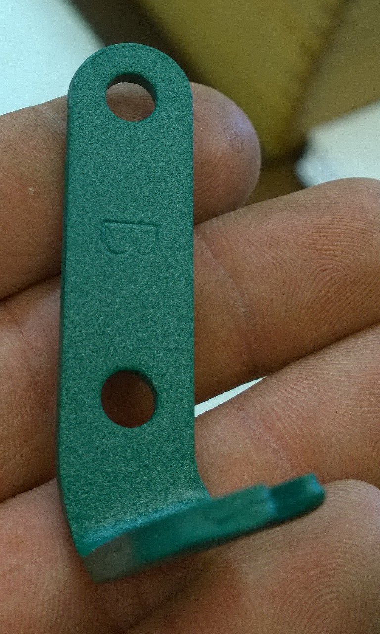

I feel if painting is the goal to get that texture, cerakote would make more sense due to it's durability. Commonly used on firearms.
yes but not in two tone like this with the raised, non symmetrical areas being one color and the recesses being another
