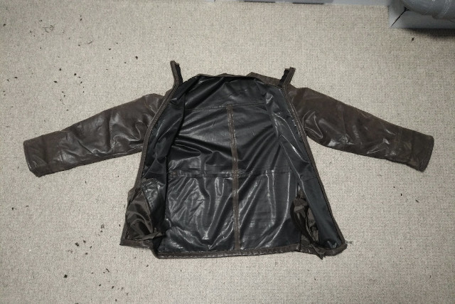

First thrift store outing proved successful, as I found a faux leather coat and some white shearling. Though Yang's jacket is more of a bolero-style bomber jacket, buying a longer coat provides me with some extra material to make the larger collar, leg band and two pouches. The coat is light, the material is thin which will make sewing easier, and already has a weathered appearance, so it works perfectly.
First thing to do was remove the faux fur liner. I'll keep this in my supplies for later use, as it's quite nice.

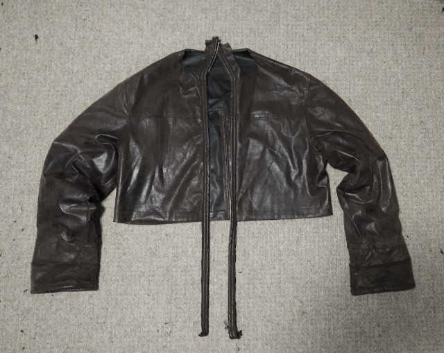

Next, I needed to cut it bolero-style. Luckily, there was a panel seam exactly in the right position, so I carefully removed the stiching, and cut down along the zipper. I probably won't use the zipper at all as it's a little dark.
I'll make the collar out of the material I removed, which will give me something more substantial to attach the shearling to.

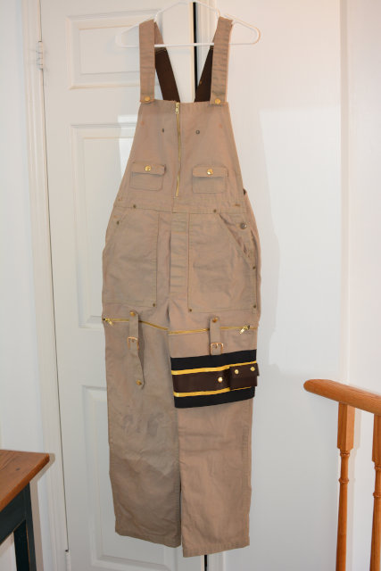

Second, a set of bib coveralls. My Blackberry KEYone camera sucks, and again the colour is way off. In reality, these are more brown than tan, and will require a re-dye. To get them looking proper, I'll first carefully remove all the pockets, loops and such that aren't correct, then wash it about 5 times to soften the cotton duck as much as possible. I'll do a bleach bath or two to lighten it, and finally, I'll dye it the correct grey/tan colour.
Once I've got the colour right, I'll cut the legs and bib, add zippers, the black-and-gold liner on the right leg, leg straps, and replace the suspender clasps with buttons or snaps.

I've removed all of the pockets and panels from the overalls that weren't needed, and am testing the bleach and dye to get the colour right. I only want to do this once so I'm being very careful to test and get it right.

After removing the extra pockets and knee panels, I bleached the overalls, then did a dye bath with grey RIT liquid fabric dye. It came out HORRIBLE - very blotchy and looked more dirty than grey/tan after it was dry. I quickly ran it through a RIT Color Remover treatment to try and get it all out. I'm not really sure what went wrong - I followed the instructions exactly, including tips from others. I think that the original fabric used had some chemicals on it, such as fabric softener or fire retardant.
The RIT Color Remover got most of it out, with the exception of one spot around the knee. I hope that this will be hidden with the purple neckerchief. I still need to re-dye it, as it's yellow right now. I did an additional 'scouring' wash with vinegar and baking soda to try and get the invisible chemical patches out. I'm going to try a higher quality fabric dye such as Procion MX and see how it goes.

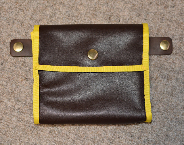

Decided to just make the waist pouch myself.

After multiple dye jobs and a fair bit of sewing, overalls are finally done. At this point I don't think I'll do the folded down right leg (though it can be done, if I change my mind). I'm sure it would look good on a woman, but with my hairy chicken legs, not so much.
