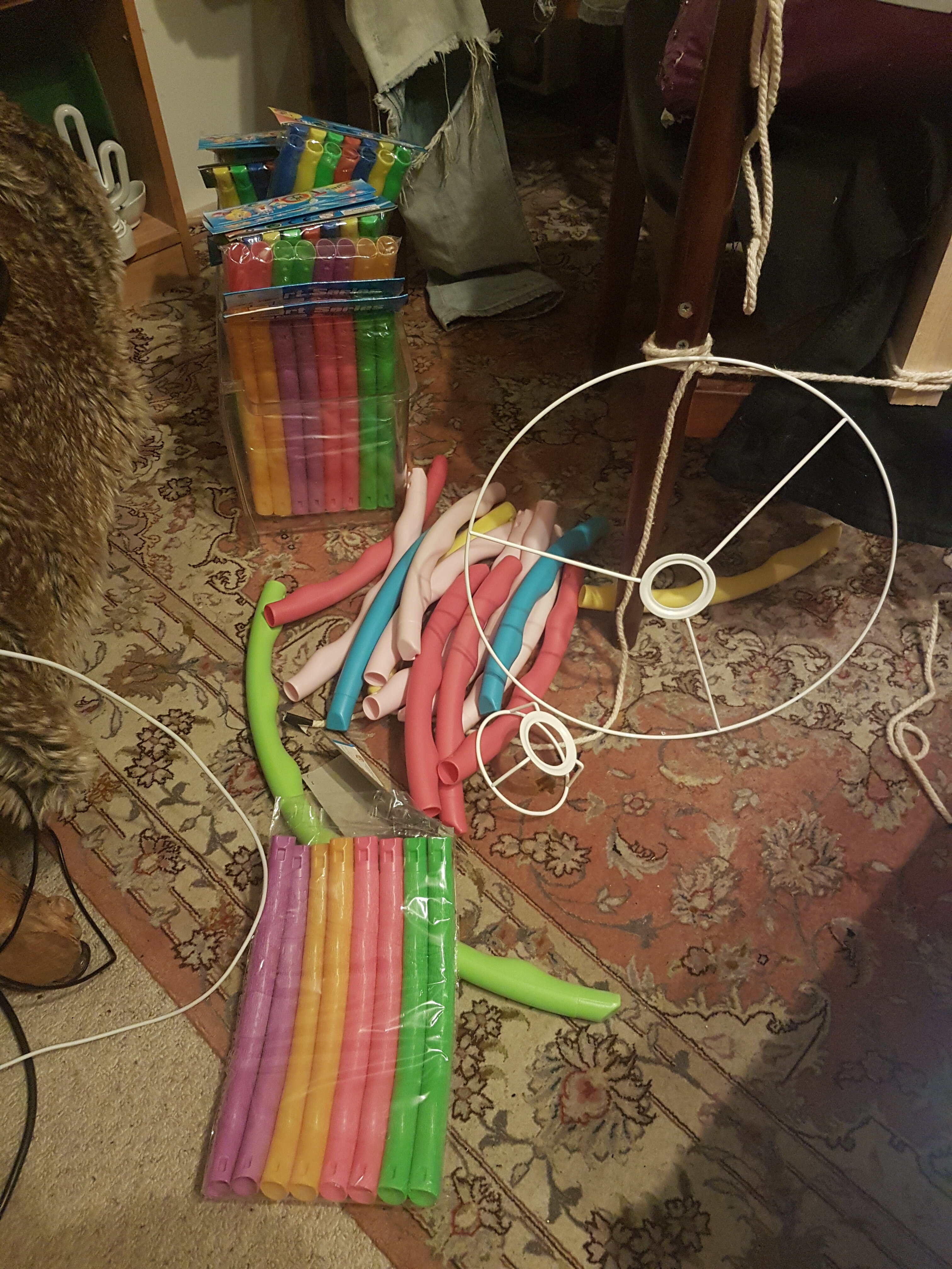

First step was the bones! I, like other totoro builders, had trouble finding rattan or willow cane in order to construct the hoops. after some thinking I realised hula hoops would be fairly cheap and also lightweight as well as already being roughly the right diameter. After missing out on a bulk lot nearby I found these on ebay which are in sections, which make them even more suitable as I can just add/subtract sections to get to my desired diameter. I think I completely cleared out 2 ebay sellers. I also ordered 2 blank lampshade rings in different sizes to become the very top of the costume and hopefully provide some more structure on which I could attach some kind of mounting system

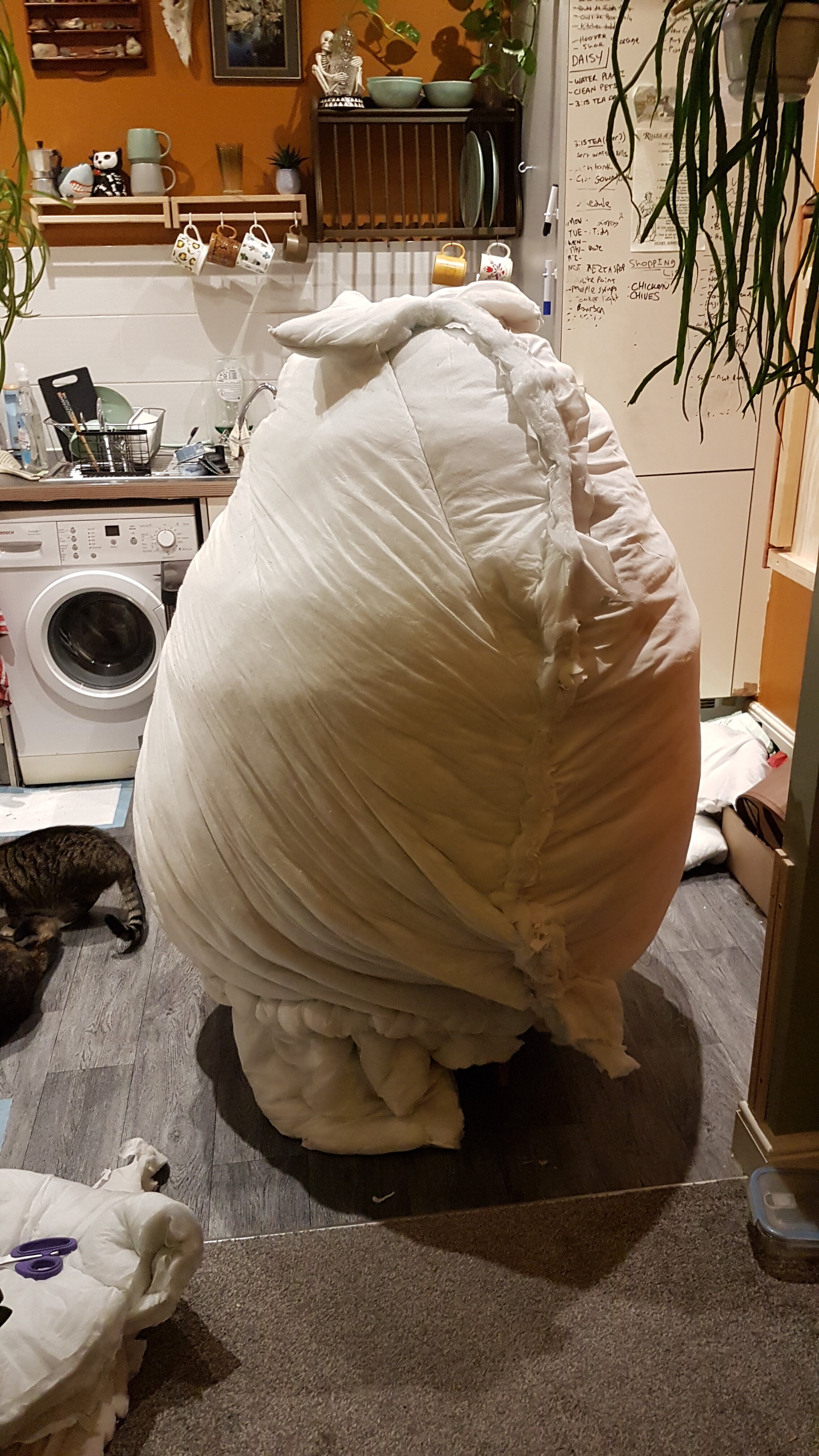

at this point I looked at fur samples and ordered some 3inch fur. The fur on it's own ended up being over 50% of the total cost of the whole project. however I was stuck on the wadding. turns out wadding is really expensive in the thickness I needed it! after some thinking and browsing on FB marketplace I realised people give away free duvets all the time and those are pretty much wadding. and so I went and found some that weren't too grim and set about sewing them together which was quite the chore. but I did it! also thinking it sort of looks like a giant version of the Alien egg in this stage. which freaked my partner out when they walked in and my arm suddenly shot out the top

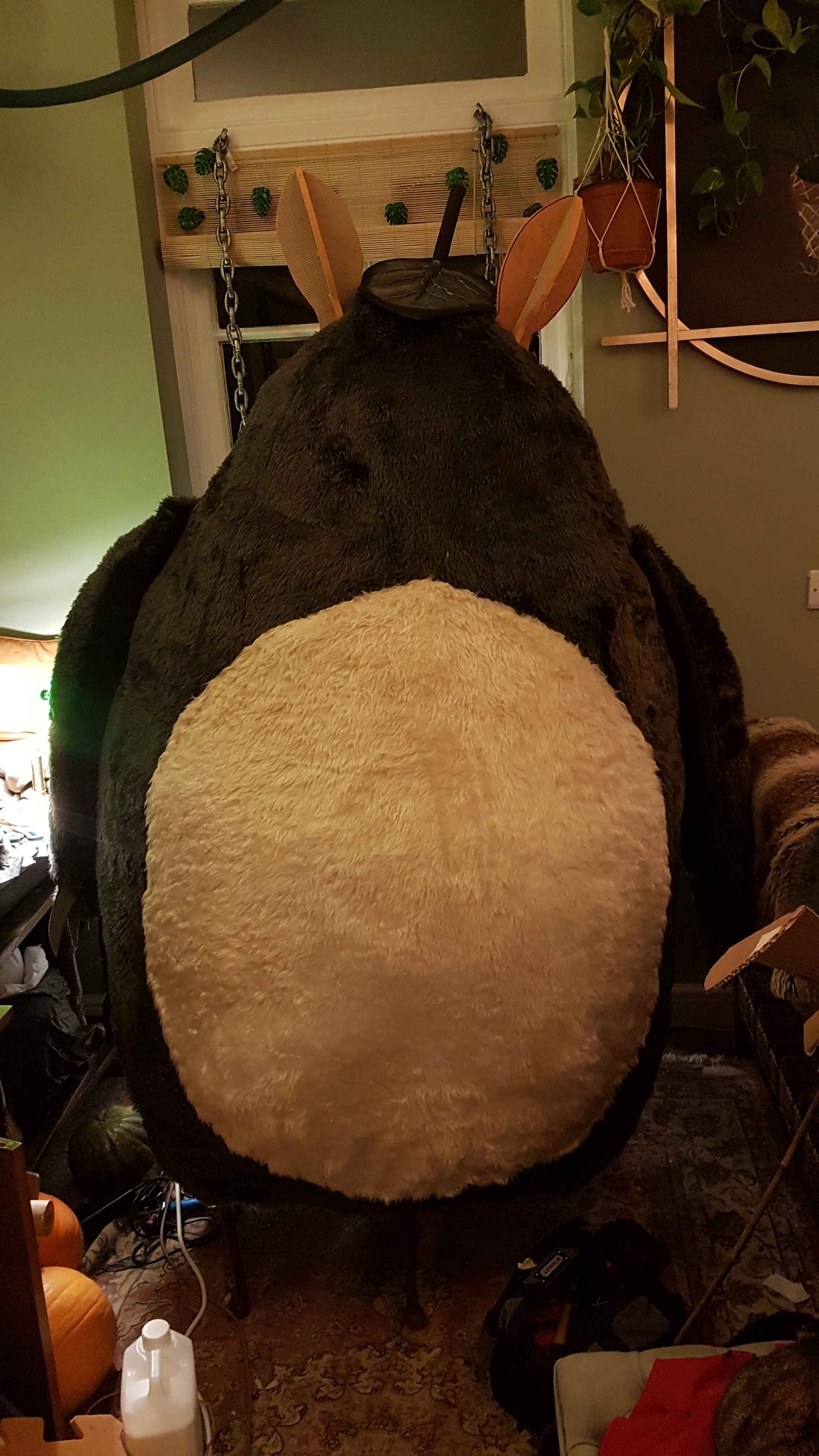

Alot of trimming and holding up later I had something I was happy with
More feature playing. The eyes I ended up copying a maker called Adam who made his eyes from a hard hat and fortunately I had one that didn't need the top kicking around from another project I was completing at the time. The iris was craft foam. Ear and nose mock ups in cardboard. Also I was approaching about a week from the con at this point so the pictures become more and more sketchy

I also realised that ugly hole at the top would be entirely hidden by the leaf I had planned to put onto his head! so I hinged it at the back and weighted the front down with some spare nuts in order to make it want to close. The leaf is made out of EVA and some scrap electrical wire. I ended up covering the top half of the periscope in some spare fur scraps in order to help futher disguise it. I can say it worked perfectly as I frequently had people discussing where I was seeing out of as they couldn't see a camera lens or an opening. My handler would then point out the periscope and they would be ecstatic!
