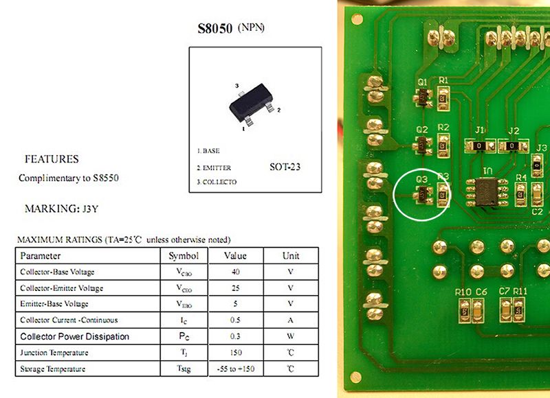

Hello Gus, does your engine lighting pose any risk of blowing the stock board? Do any modifications need to be made to power your units? Someone posted on the Facebook tread that they may require more power than the stock board provides. Thanks!

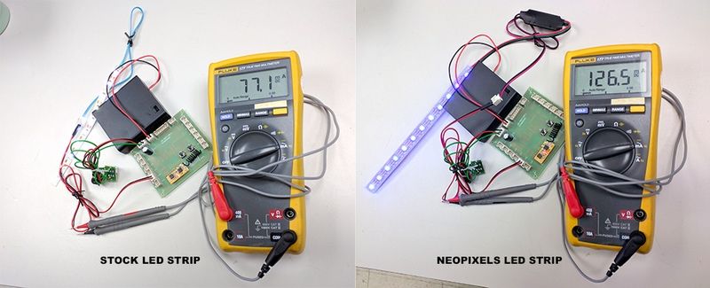

I heard there was a concern about Neopixel LEDs drawing too much current so that it can possibly damage the circuit board that is supplied by deAgostini. In short, I don't see any reasons for concerns. While Neopixels do require a lot of current, please note, only 1/3 of LEDs are ON because only blue color is emitted. On top of that there is no current spike because the brightness is turned on gradually and Neopixel LEDs are never all at maximum brightness. I did a quick current measuring test on the stock LED strip and Neopixels LED strip.
As you can see while The Neopixels indeed take more current then the stock LEDs, it is still within acceptable value for the transistor that opens the current (500mA).
