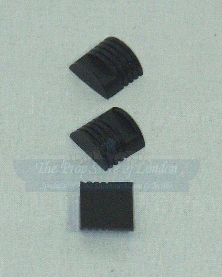

Yes, please make the flash suppressor & the 3 piston halves in Delrin,
as that is what was originally use. The material can be machined like aluminium,
and it cost less than metal. The option will allow for a more accurate repro.
I want 3 to replace the aluminum ones I got from you ~10 years ago,
and 2 for the (MGC-based) DH-17.

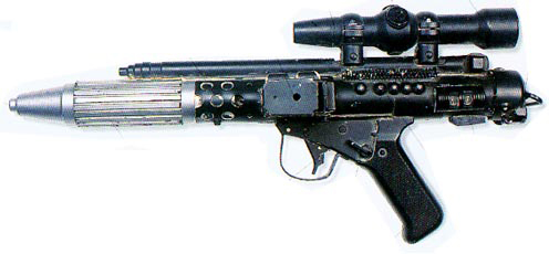

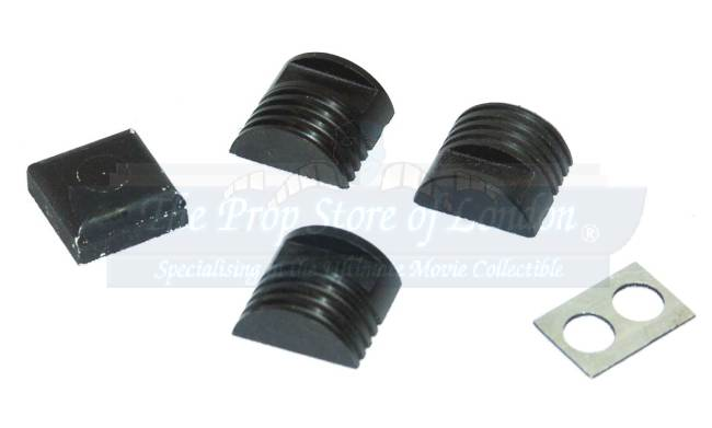

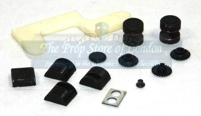

Photos of the 2007 PIH auction for extra blaster parts (not all used),
the evident Delrin flash suppressor (worn away silver paint revealing black underneath),
and the DH-17:
Solo DL-44 ROTJ unused parts propstore 1.jpgSolo DL-44 ROTJ unused parts propstore 2.pngSolo DL-44 ROTJ unused parts propstore 3.pngSolo ROTJ DL-44 flash suppressor MOM comparison.jpg
