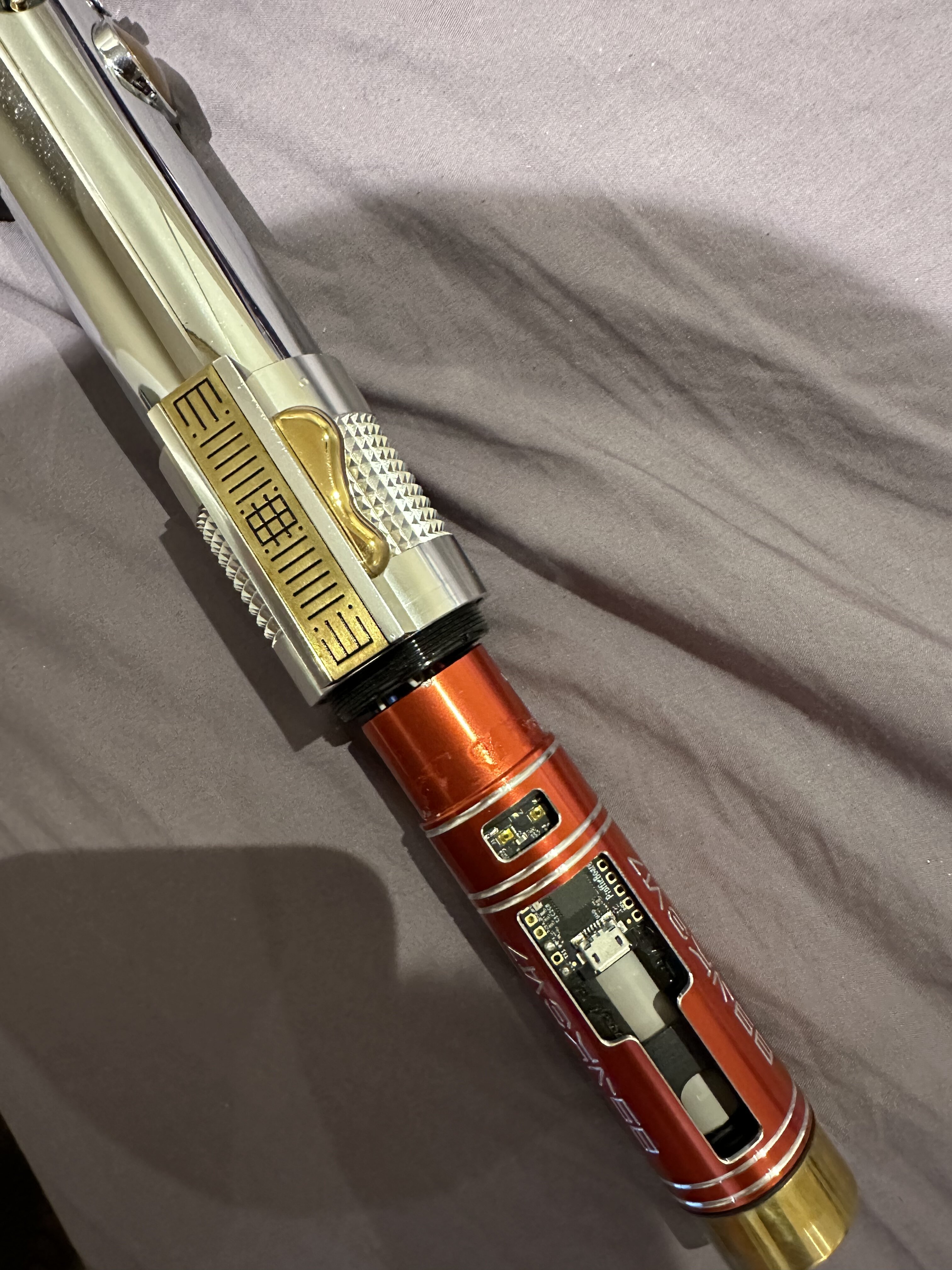

My other question is that the non removable chassis has come unglued from the main body of the hilt, what would be the best glue to use, would e6000 be safe to use to glue two pieces of metal?

E6000 should be fine for that application.

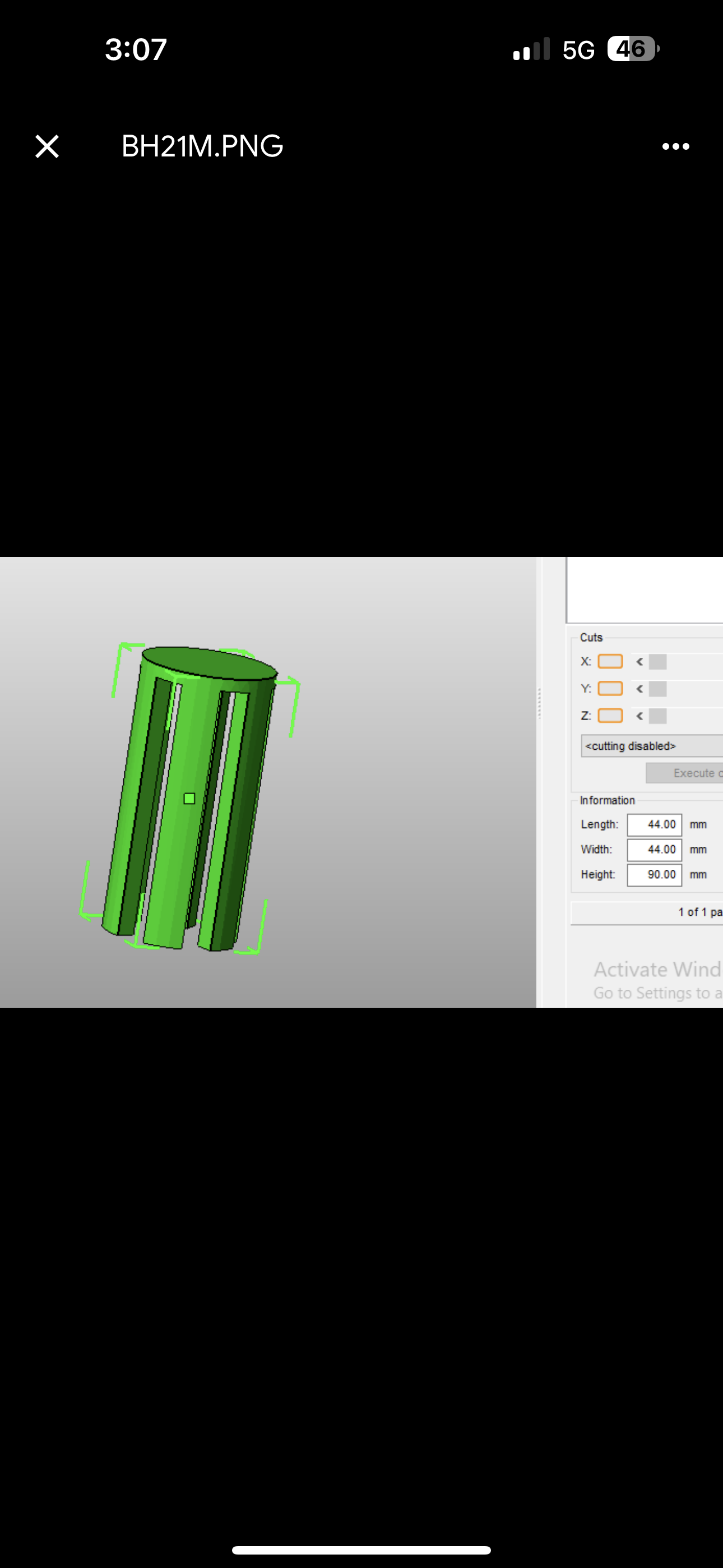

So this is what the company sent me
Inner dimensions 26mm
Spacing 2.4mm
And it’s actually meant to be more like
Inner diameter of object 31mm
Spacing (negative spacing) 9mm
Spacing 2.4mm
They said the file they got was 26mm interior? Let me look at my file and I will get back to you. I could print one and measure it. If you are willing to pay shipping, I could post it to you.
They didn’t say that. They sent me a photo of what I’ve attached and that’s it, prior to me purchasing. I just assumed they match the specs to the stl. I only measured what they sent me last night.
