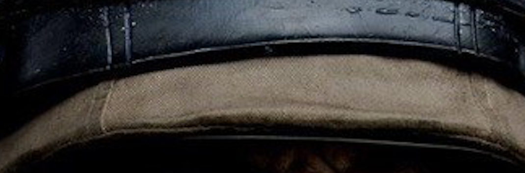

I really think that the fabric cover is a cloth, rather than a suede leather. It's definitely hard to tell, but the stippling effect just below the dome shield here looks to me like a twill or something...

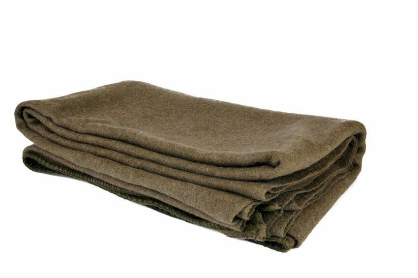

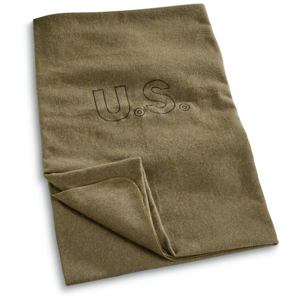

What about the military standard issue blankets from Vietnam? My grandfather served in Nam and he says they look very similar to the standard issue blankets.

The cloth cover is just that, cloth.
Most helmets come with covers or you can buy one.
Try to match the material.
