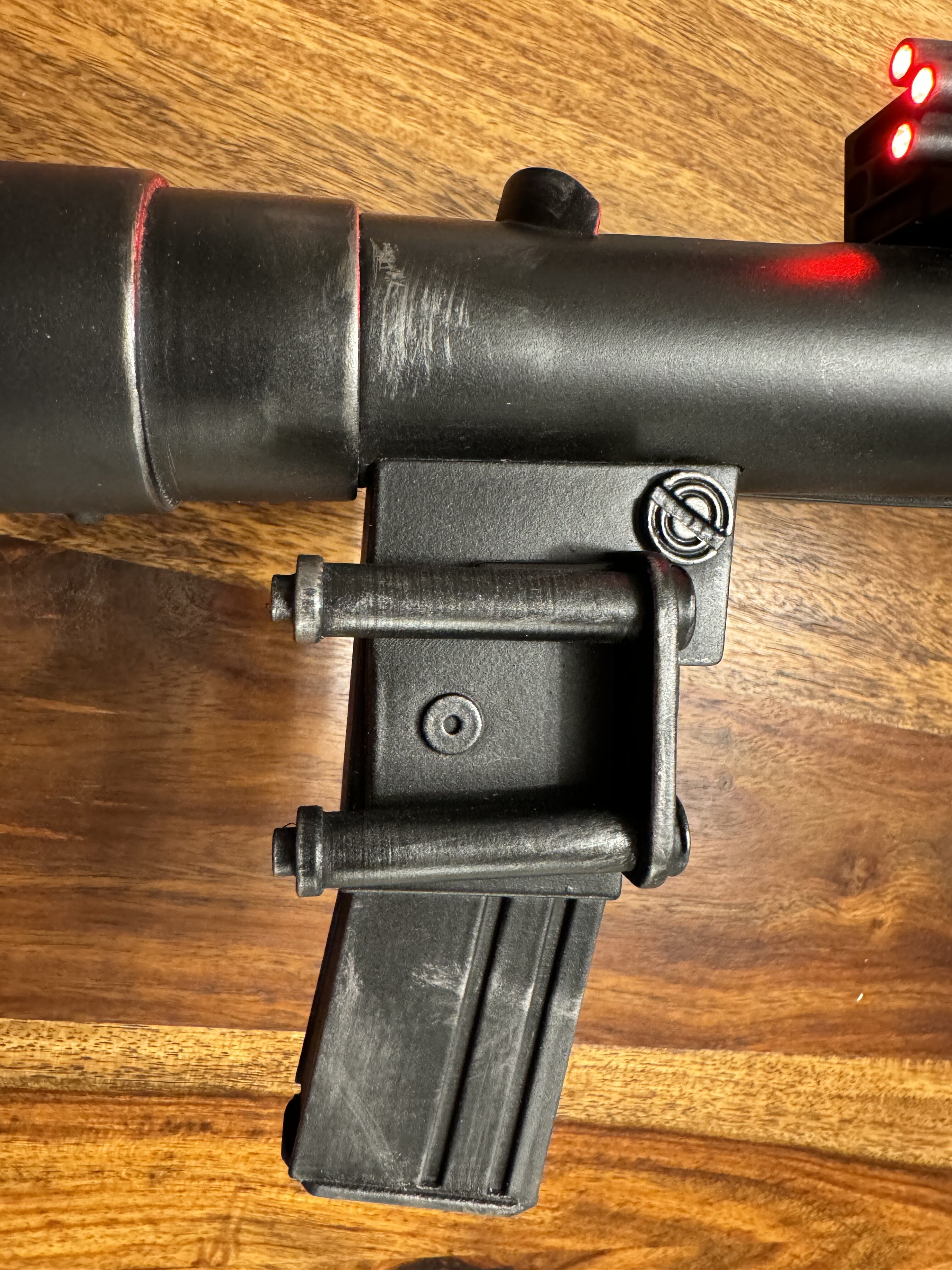

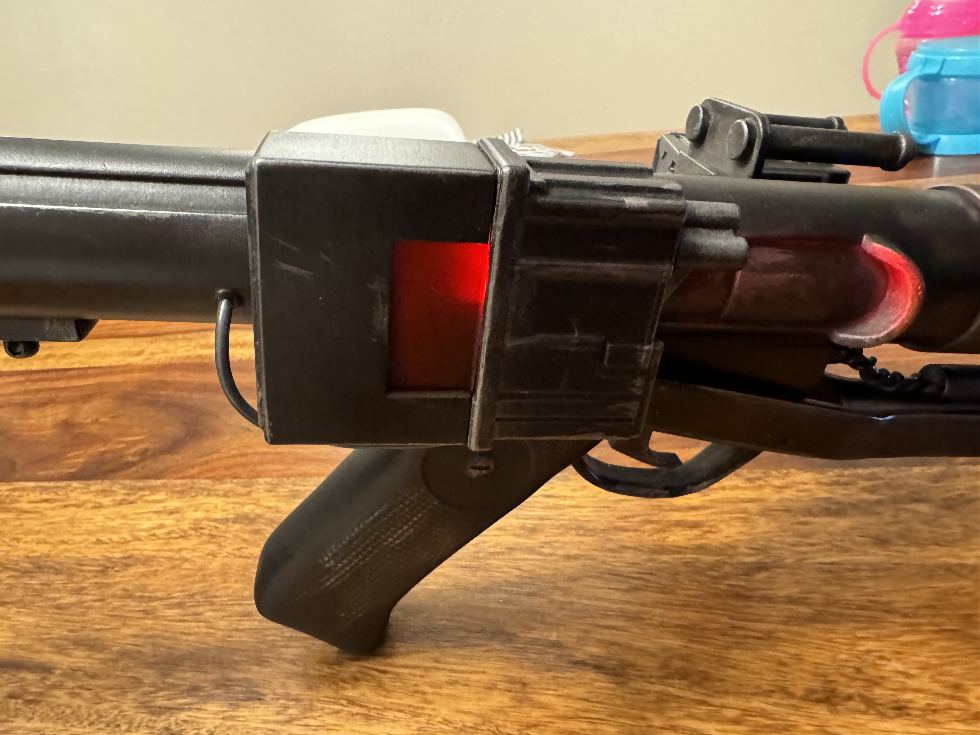

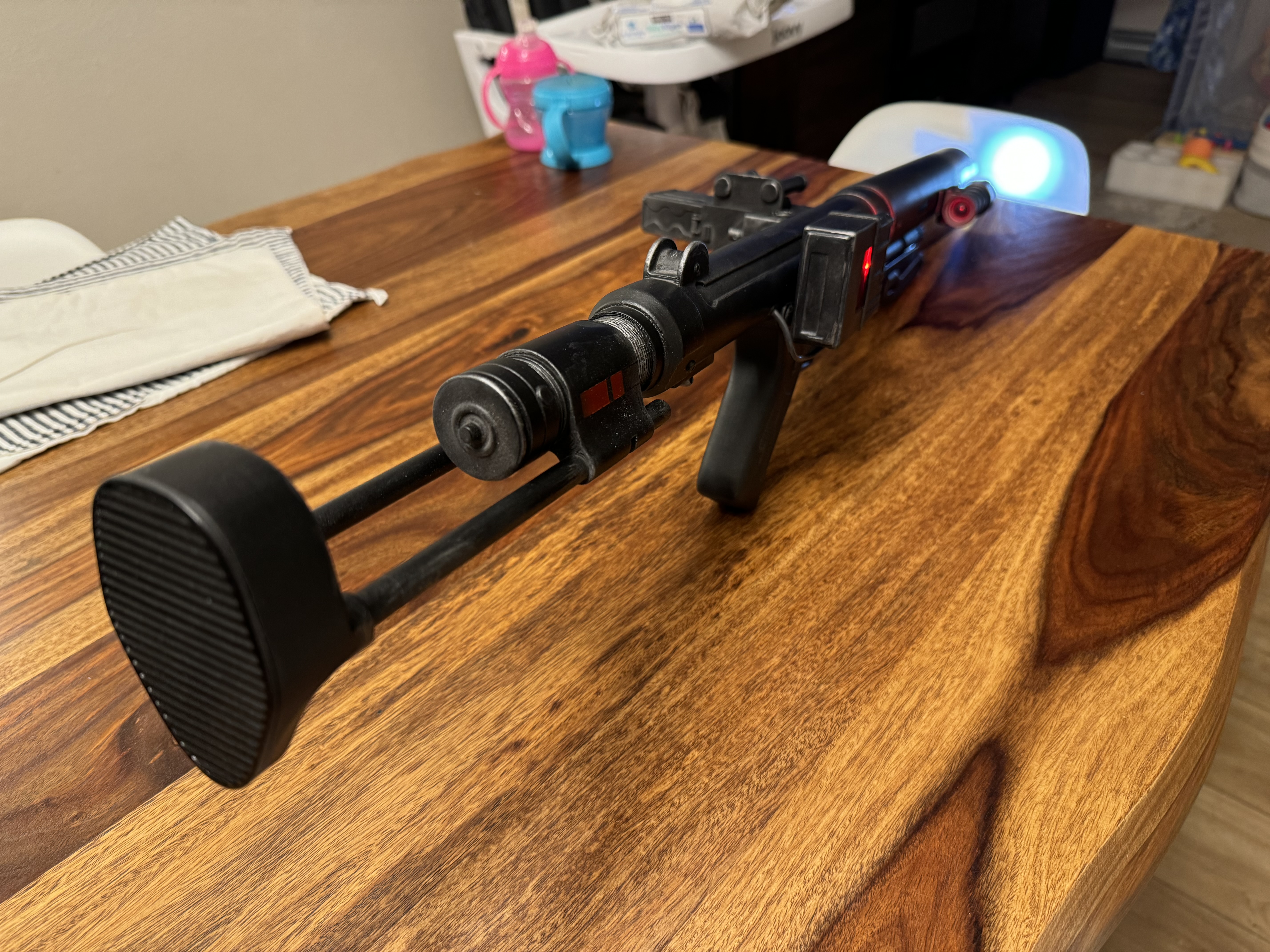

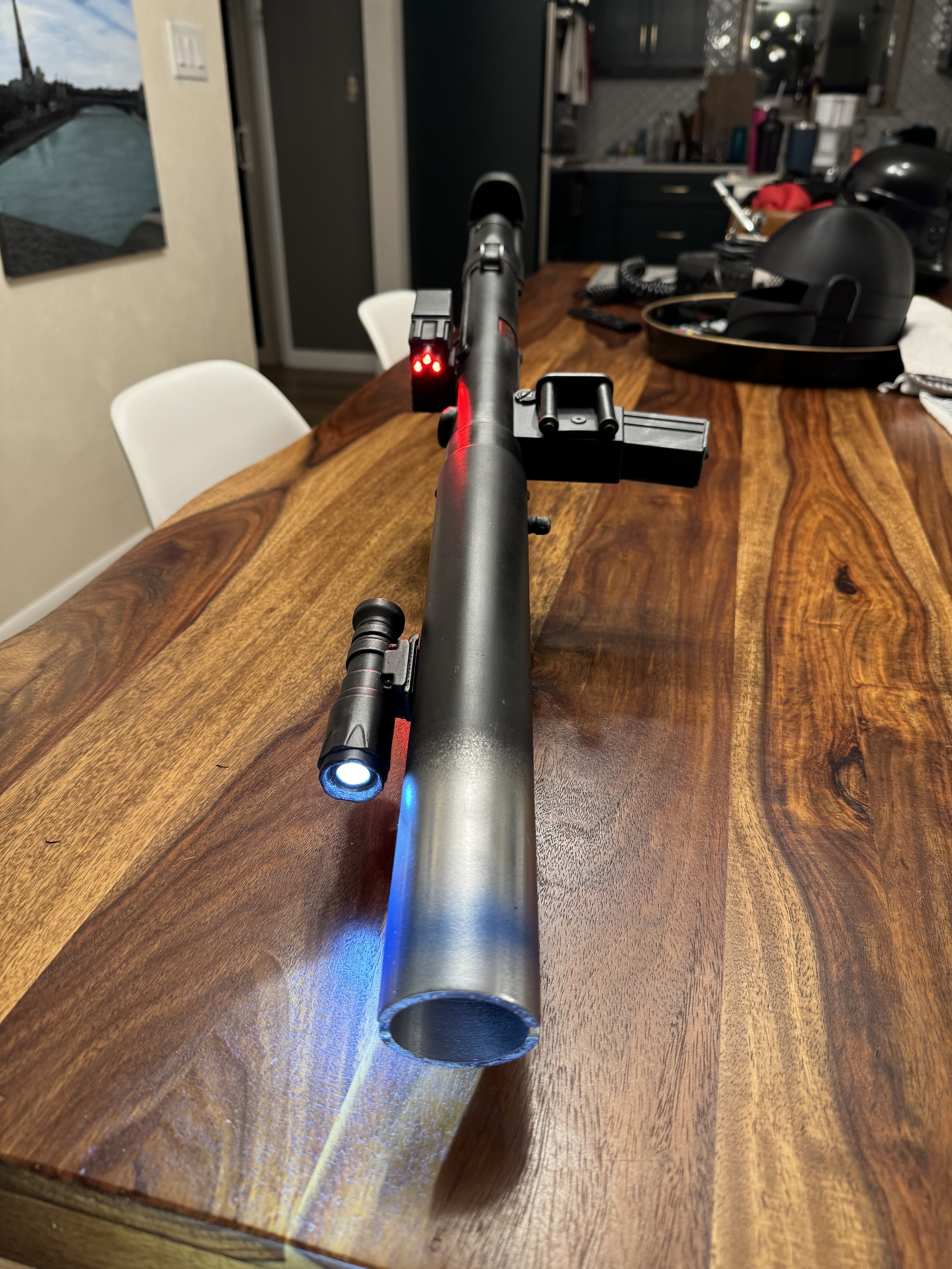

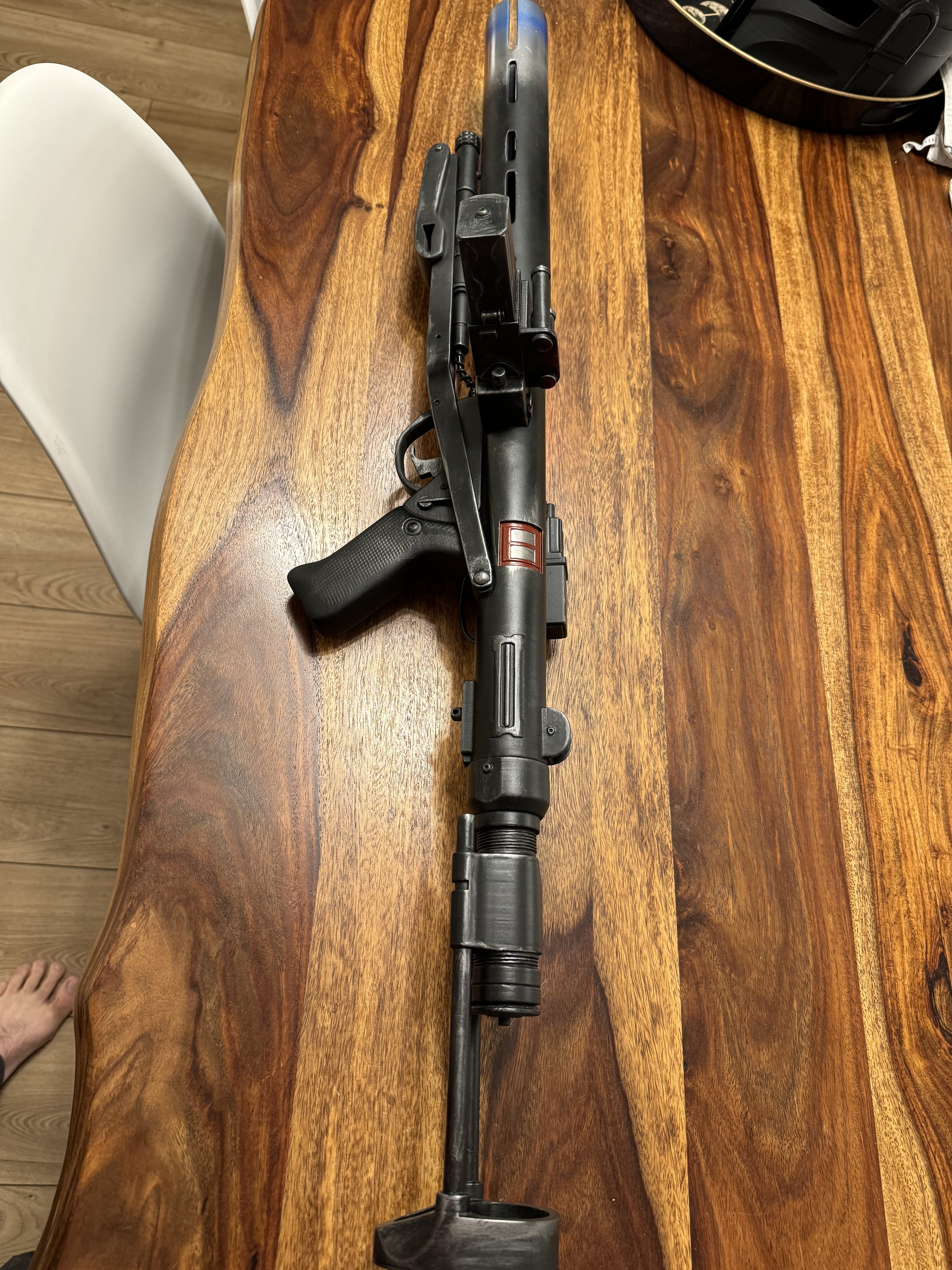

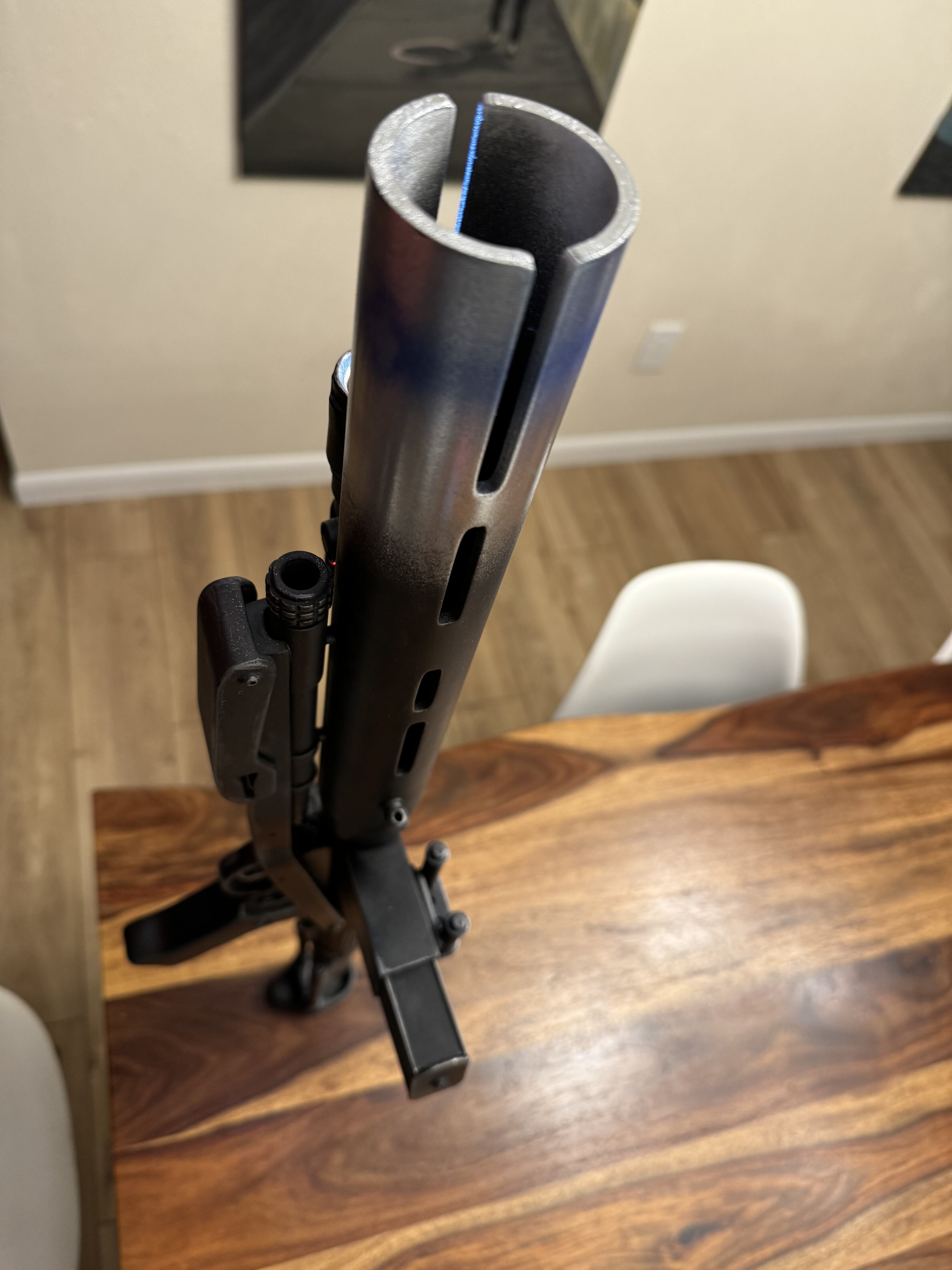

3D printed from Galactic Armory model, and customized the power cell housing with LEDs, and installed a functional flashlight. Weathering/wear applied to match screen prop and Rogue One movie.
Also gave the trigger spring action.
Let me know if interested!

Nice! What infill did you use? My nephew printed something out and I was skeptical of printing props, but it had heft. I think he used 50-70% or something. I've got GA's Republic Commando helmet waiting to sand/paint now.
Hello, and thanks! I used 25% for basic infil, but my printing profile also assigns more solid infil %s for edges/angles, so it’s not only 25%. Even so- I use a think wooden dowel that runs through the core of the blaster, and some small diameter metal rods to reinforce the rods in the buttstock and underbarel. I plan to print the GA Republic Commando helmet too! Good luck on your bucket!
