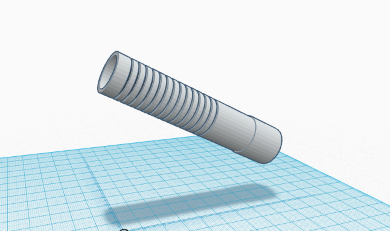

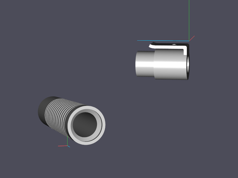

Put together a rough mock-up of the flashlight in Tinkercad.

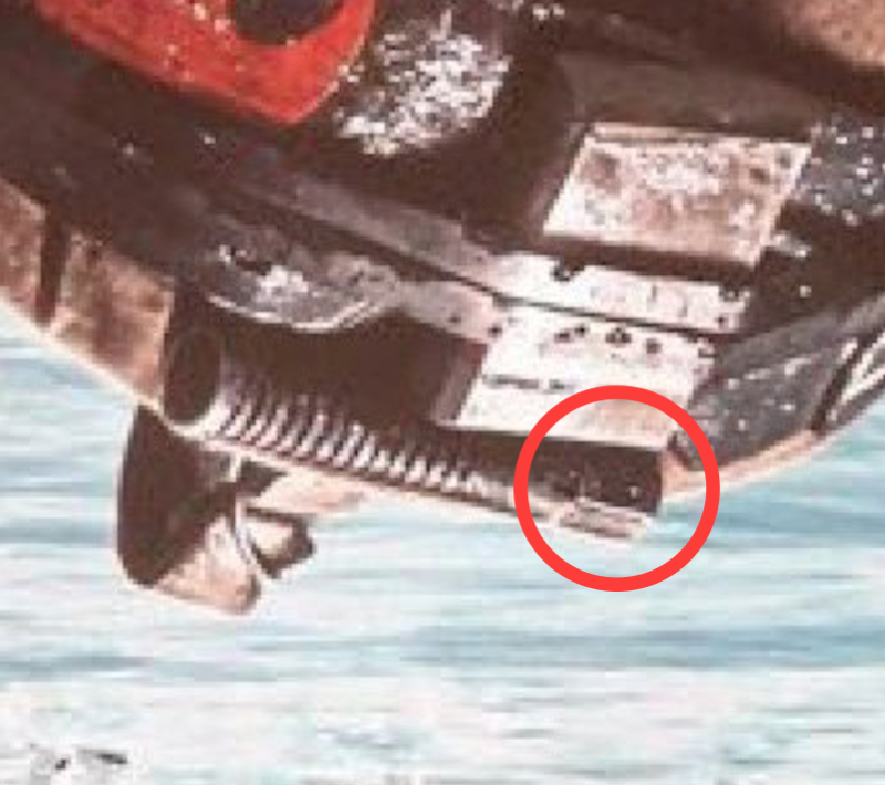

Everything is really straightforward until you get to the end section...not too sure what's going on there. It looks to me that it might be a clip of some sort? Or maybe a switch? What are you guys thinking?
Overall it appears that it is only one this one spot and doesn't repeat on the other side.

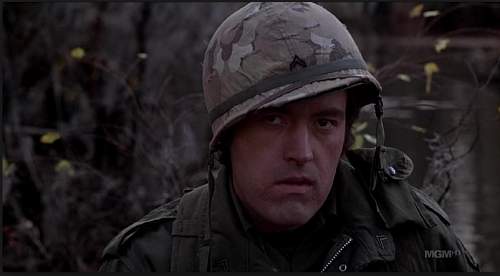

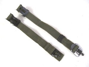

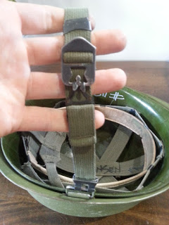

I've been trying to figure out the chinstrap. To me it looks like the studio used varying chinstraps, but the predominant one in the screen shots appear to be the 1960s T1 chinstrap. If the strap is the T1 there would be no trouble in sourcing those.

i agree i see a clip as well.

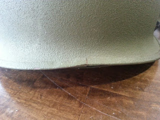

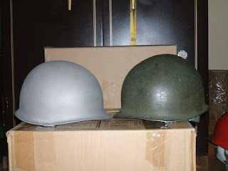

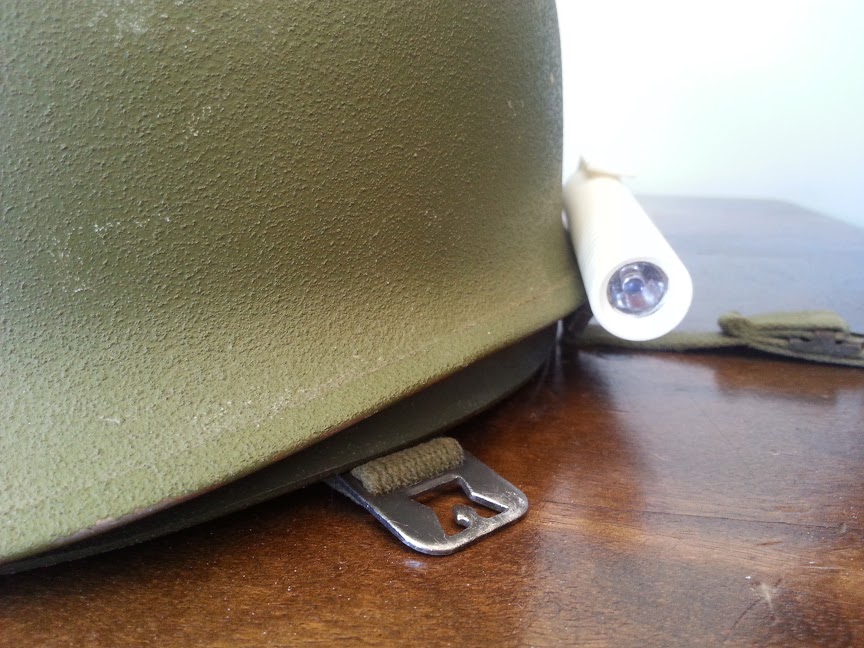

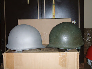

The correct version of the M1 helmet is the Vietnam era style, lower profile helmet. Hope this is helpful.
If your looking for the Correct version here are the things to look for;
Curve of the Helmet, left is the 1970's M1, right is the WW2 version.
rpf member BobZurukle
The seam around the bottom of the helmet is joined at the back, If you find one with the seam at the front its a WW2 version.

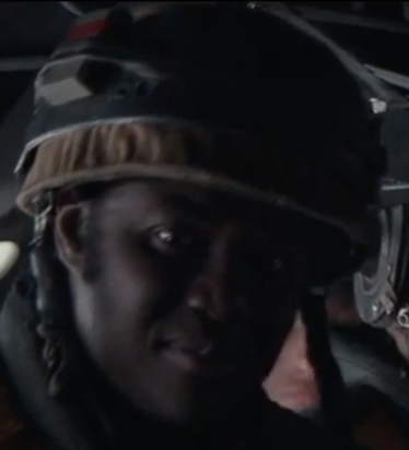

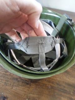

Your straps may vary and could have been repaired with a plastic rim for the strapping to fit to the inner helmet, its your choice to decide how authentic you want your build to be. here is an original inner with original strapping.
Close up of the strap and screen shot of the trailer helmet.
screen capture Rogue One trailer.

So I agree with the torch ideas, the clip looks like the go.

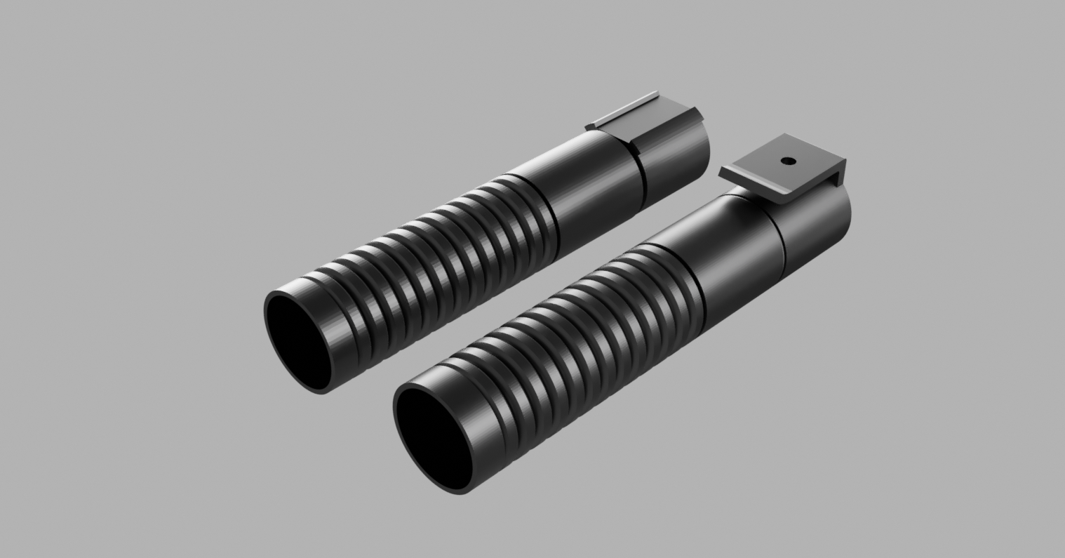

here are some renders that I've made up, Thain looks like you have it sorted too.

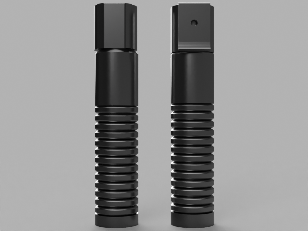

I beveled the edge of the 13 rounds on the cylinder and made the front end beveled with a lip for torch like end. Made two as the first one I made before, when I could not tell if it was a clip or flat surface with a couple lines.
you can see afew small differences. the right one is the one Im thinking is more correct.
starting at the top, both 100mm long/20mm dia.
end cap - left one flat edge - right one clip with hole 1mm longer. I think thats what I see.
main body - left beveled edge at top - right one 2mm shorter, and rounded top edge.
end cap - right one 1mm longer.
If there are any suggestions pour them on. at the end of the day I will make suggested changes and share the files for printing, and print one myself to see how it looks.
looking at the poster I already think the clip should be a few mm longer or lower to the cylinder (currently 1mm space).

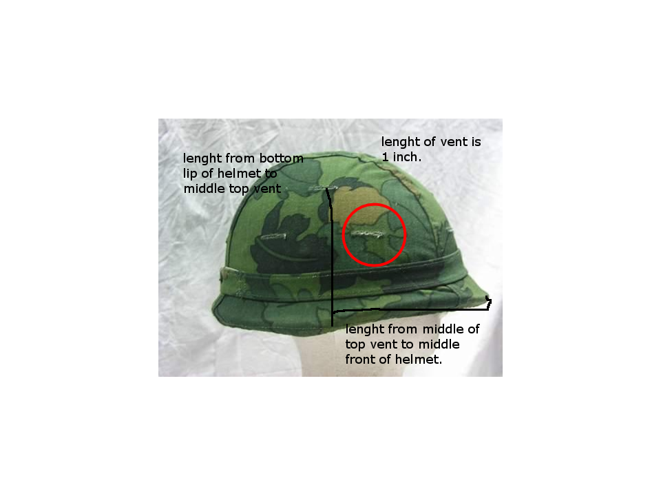

Sheeple or anyone could I please get the a couple of dimensions from the helmet. Just planning out the lay of the fabric cover, Im after the lenght from the top vent straight down to the rim/lip of helmet and then from the center front around to the side right angles to the middle of the top vent. Pic below :)
thank you for sharing how to tell the difference. i dont think ill be able to head out this weekend because of work, so next weekend I'm going to take the hike and check out the military surplus a few towns over see if i can't find one
My fabric cover is a bit different than that one, but the measurements you're looking for are around 5.5" for the height and 6.5" length. Hope this helps!
Thanks Sheeple ;)

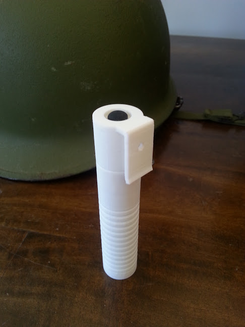

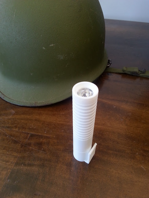

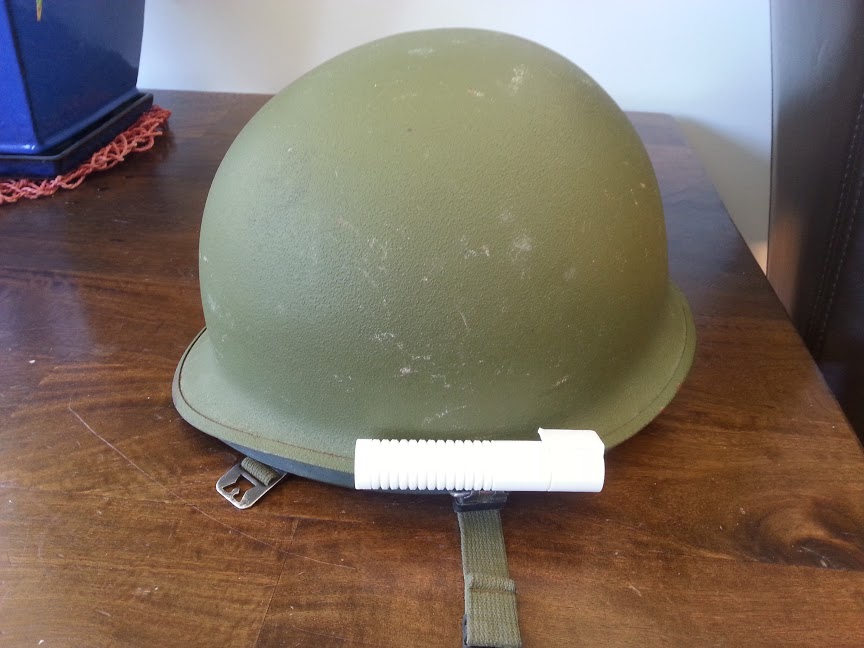

Just started printing the right model made some adjustments to the front in the pic below you can see the inside lip and reflector part of torch. I have made the internals big enough to fit a AA battery and a 15mm reflector (OD) with the option of two end caps one with a hole for a tac switch and one thats flat.
once the two parts are printed I will take some snaps and post, and send files to Elr02 so he can print too.
canister sounds good. Then I'll print with probably 100 microns and primer-bondo the whole thing to make it smooth. Then it goes to halliwax for casting
Printed for your inspection, you can see this could work as a real tourch. I have not wired it just slid in a 15mm reflector and led then pulled the rubber on off cap from a $2.50 torch.
I will post some more pics once its sanded, primed and painted. I will be a bit easier to see then rather than all white. Also how do you delete a post. double posted.
https://3.bp.blogspot.com/-9HkYYnaR..._vXcAV41uaSfdaK2tvWakjjByLACLcB/s1600/end.jpgView attachment 675849https://3.bp.blogspot.com/-F6wOhDfD...suQSH-i_1LiqvDmbPP40Ez7pACLcB/s1600/front.jpgView attachment 675850
Awesome! Looks great, and I love that you've made it a functional piece. Great to see a prototype on a real bucket...this project is coming together!
