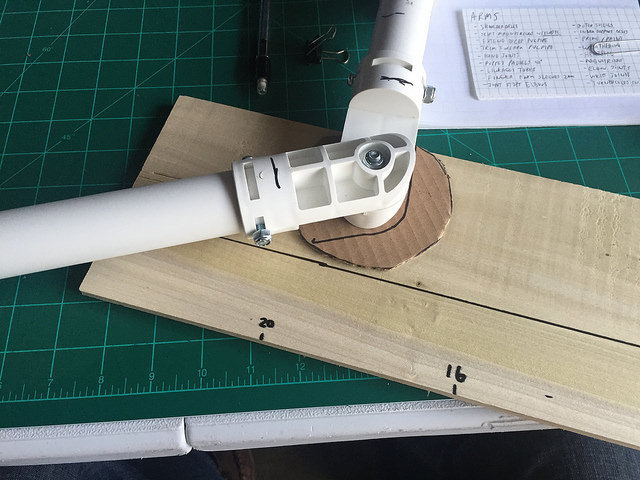

    Time for some reworking of the harness. It just puts his torso too far from me and the weight of that wears me out.
    [​IMG]
    Fortunately everything is screwed together so no glue to make things difficult.
    [​IMG]
    I traced the original harness shape to compare after making modifications.
    [​IMG]
    After making it much shorter and swapping out the 45* fittings for some pivot ones it was getting better.
    [​IMG]
    I heated up many of the components with my heat gun to expand them over the slightly too large angle joints. I also pressed everything close together against the harness.
    [​IMG]
    Bending the PVC around the lower angle joint.
    [​IMG]
    This version was too high and needed to be lowered about 6".
    [​IMG]
    Version 2 had K-2SO tilting very far back and 6" too high for his legs to connect.
    [​IMG]
    Version 3 lowered his torso and still kept him closer to me. I still need to balance him some. I saw another K-2SO cosplayer make some loops for their legs and make connections that way. I might make leg loops and connect those over my shoulders to the harness. That might transfer some of the load to my legs and help my back.

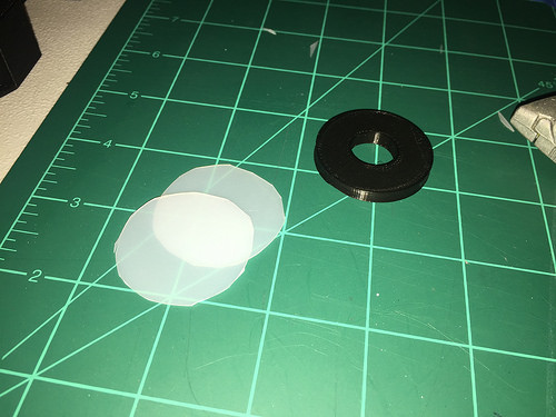

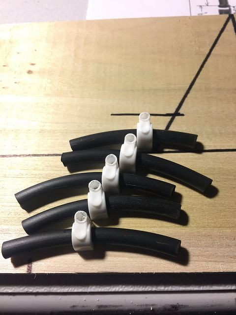

    Update on K-2SO! I'm performing some of my K-2.0 updates such as the knees and hands. I've already moved the harness closer to his body to help with the weight layout.
    I'm so excited to start teaching foam classes at the Vocademy Maker Space out in Riverside California this summer! This is a great place with an awesome vision for educating makers.
    I took my first class as well, Laser 1. Made this little K-2SO coin.
    Also per the advice of Evil Ted I picked up a Kershaw sharpener to keep my blades sharp.

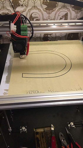

    Doing vector work on the new linkage based hands. The best part of this is the pull line will have to move only around a centimeter to make the whole finger curl.
    These will be cut out of mdf layers with the laser and fashioned together with Chicago screws. I need to make a prototype before finishing the other 4 fingers.

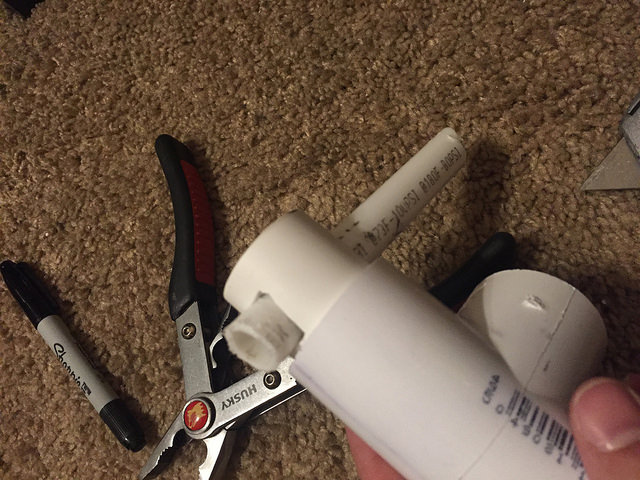

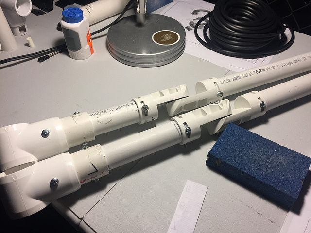

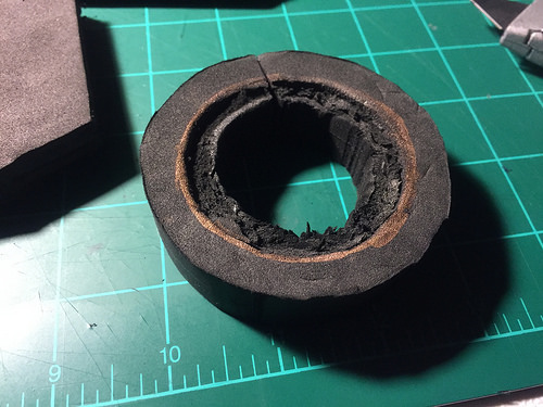

    Another Home Depot run, this time for a 1-1/2" coupler for the improved knee joint.
    First I carefully removed the outer two plates and any extra foam inside the knee.
    Then I shaped down the coupler to about a third of the fitting, notching one of the corners.
    These were held in place by two pipe clamps.
    And secured with a wide head screw to keep them from accidentally overlapping.
    Now the knees don't over extend they also will allow K2 to take his own weight while I am standing.
    I glued the outer two plates back on the knees with super glue and put K-2SO on his new rolling cart. This will let me get him from my car to the changing space in one trip at future events. Still need to figure out a way to attach his stand without zip ties so it breaks down fully.
