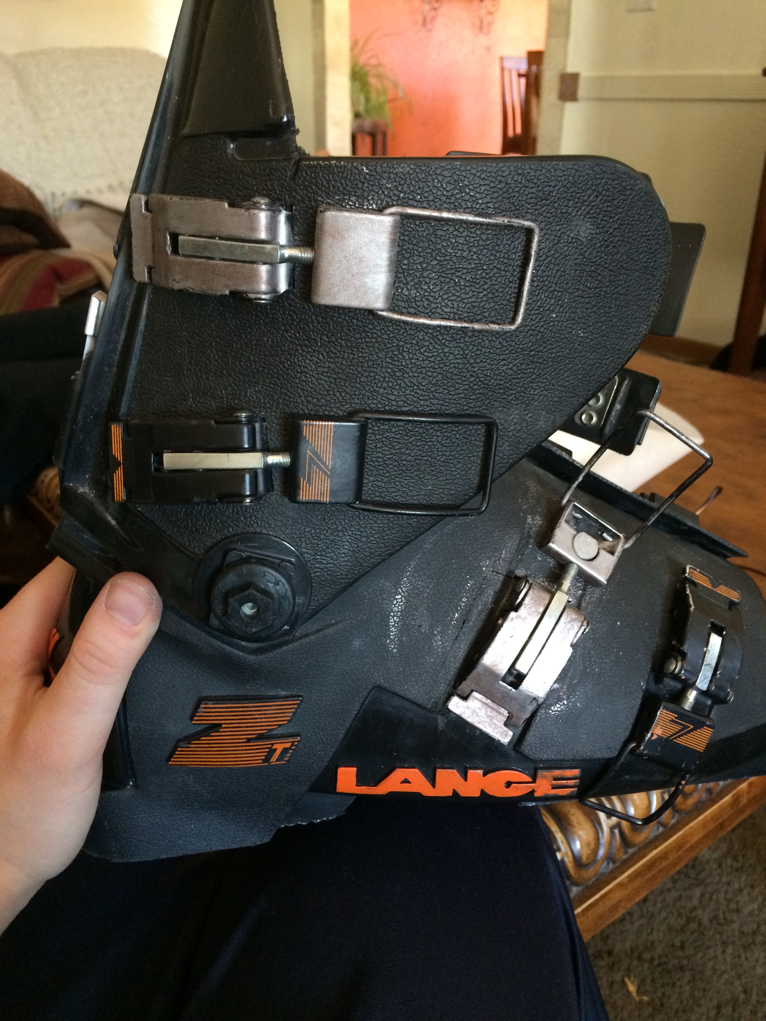

Same here! I happened to find exactly what I was looking for at a thrift store for about $10, but now my problem is I can't remove the straps. I tried cutting through the boot (which didn't work at all) and then I tried to undo the screws holding the straps down, but I still had no luck. Does anyone know a more efficient way of getting these straps off?
We just drilled them off where they were attached to the boot, but I also used a different Lange boot so I'm not sure if they are attached the same way on yours.
What kind of drill did you use? I'm afraid I don't have very many tools at my disposal so my options are a bit limited.
When I tried to drill the rivets out of my Lange boots the rivet started spinning and I could no longer make any progress. Instead of trying to clamp the rivet, I ended up using a metal hacksaw to cut through the stem of the rivet. That ripped up the plastic of the boot but I was not trying to save them so that was not a problem for me.

Thrift shops are going to be your best bet, most of them should be starting to put out the winter/ski stuff around now. Mine were about $14. If there's a ski shop or ski hill nearby, you could also see if they have a swap sale in the fall, too. The buckles you want are the small toe buckles off of a pair of boots from the '80s or '90s, newer Lange buckles are a different style. Ebay has them sometimes, too.
Unfortunately, there's only one set of the small buckles on most pairs of these boots, as far as I can tell.

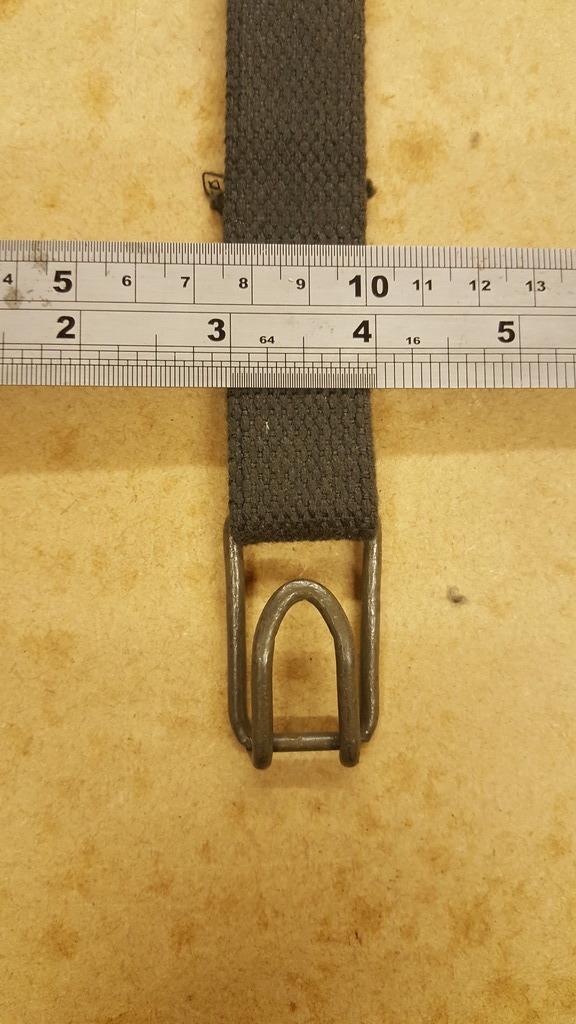

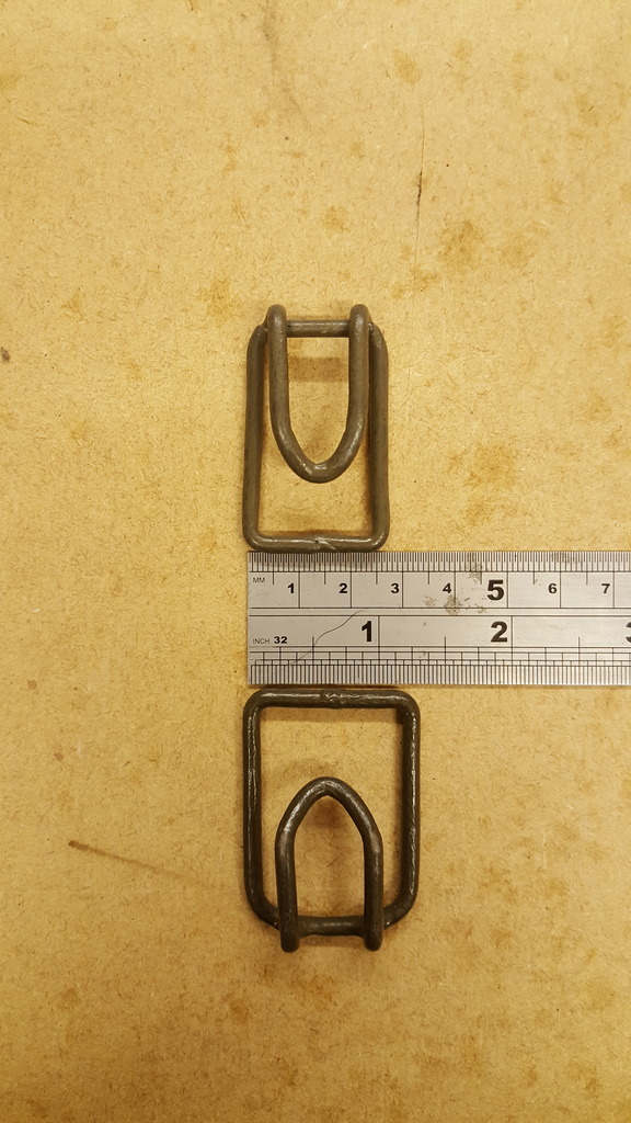

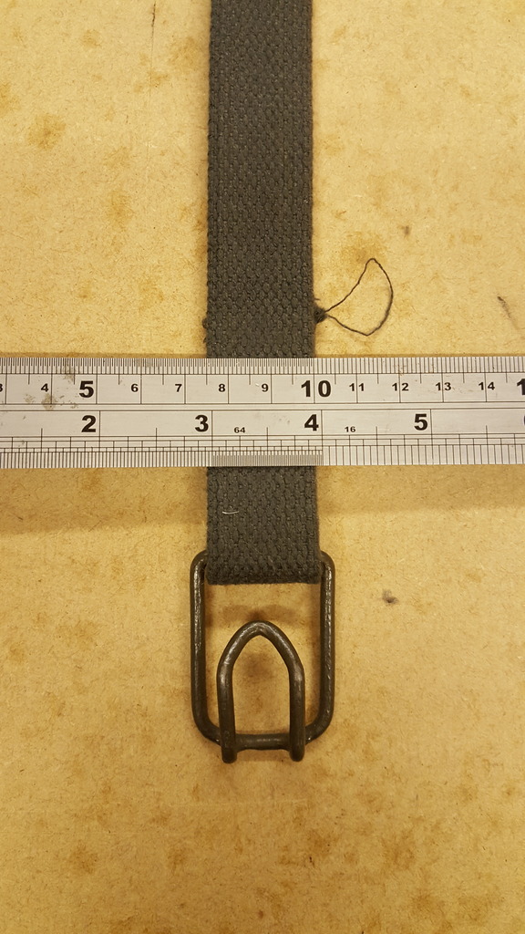

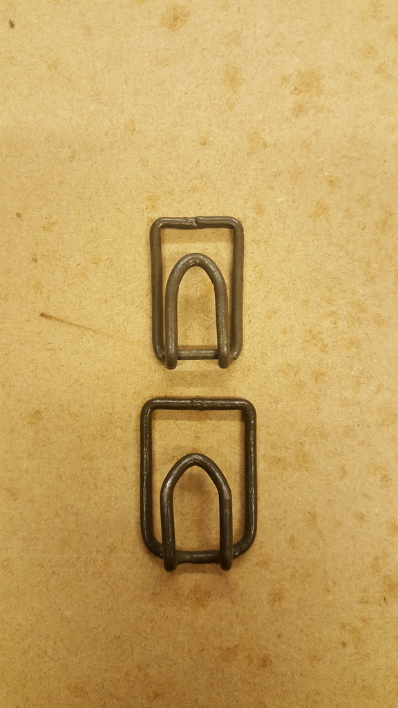

Okay, I have managed to get some comparison pics of the hook types from the Czech back pack strapping rigs. The narrower hook comes from the leather rig and the wider buckle from the webbing rig.
The ones from the leather rig, the narrower one, appears to me to be closer to the size used on Jyn's vest - as per smithjohnj observations.
If you look at the narrow hook with 1" / 25 mm webbing the fit is tight... In the hand one can see the round of the bend between the upper horizontal and the vertical sides, this is not coming through very well in the photo.

The wider hook looks a bit too wide? A bit too much of the upper bar shows on either side of the webbing? In the hand I can slide the hook side-to-side 1/4" / 6 mm or so either way. It doesn't 'feel' correct.
Not the most compelling review I'm afraid.
View attachment 670539View attachment 670540
The ones from the leather rig, the narrower one, appears to me to be closer to the size used on Jyn's vest - as per @smithjohnj observations.
The narrow hook also has a closer profile / silhouette to the vest hook...
View attachment 670542View attachment 670543

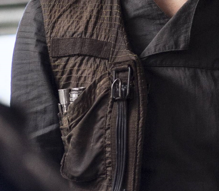

Actually, looking at the hook does it overlap the vertical tubing, or is it tucked behind? If the latter these buckles may not be correct, unless the prop builders added a small horizontal bar across the lowest part of the hook? Look at the pics of Jyn, what do you think?
There are several parts of the vest web greeblie. These are my observations which I presented previously. I believe the base is 1" webbing. The hook is slightly less than 1" or 25 mm wide and about 1 cm from front to back. The hook rests on the webbing and is attached at the top with a piece of narrower (less than 25 mm) webbing which surrounds the flat top and is sewn to the wider webbing. In the middle of the hook, behind the hook and lower bottom bar there are 4 separate hollow rubber tubes. These hoses are held in place by what I call a hose clip which is about 20 x 20 mm. (I provided my design for these clips in another post). Beadalon (a jewelry/beading supplier) makes a 4 mm and 6 mm hose. Using the 4 mm hose easily fits inside the hook and under the bottom bar. (EDIT: So the hook 'hinges" down over the hose clip and top of the hoses.) There are a total of 7 hose clips( inside and outside, both sides) and one left, lower, external connector for which I still do not have a good design or clear reference photo
Here is the photo I use to reject the ROK hook option and show the relationship of hook depth, hose, and webbing. However I am always interested in what others get from their analysis of available information.
Thanks smithjohnj
I am happy with the analysis as I just think that the narrower hook has the correct 'feel'.
Yes, agree, not the ROK. That also shows how the hook lays, which answers my previous 'wobble'.
