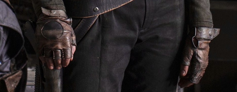

Hello everyone ! I would like to thank people here for their contribution, it help me a lot to find the items that I needed. I'm starting to make Jyn Erso "Imperial Ground Crew" costume, and I've made a list here on this thread : http://www.therpf.com/showthread.php?t=265444
The gloves and the boots are the same used for the imperial disguise.
I've been able to get the diamond gloves and Frye boots this week, and I'll post here my progress. Here are some pics that I've found :

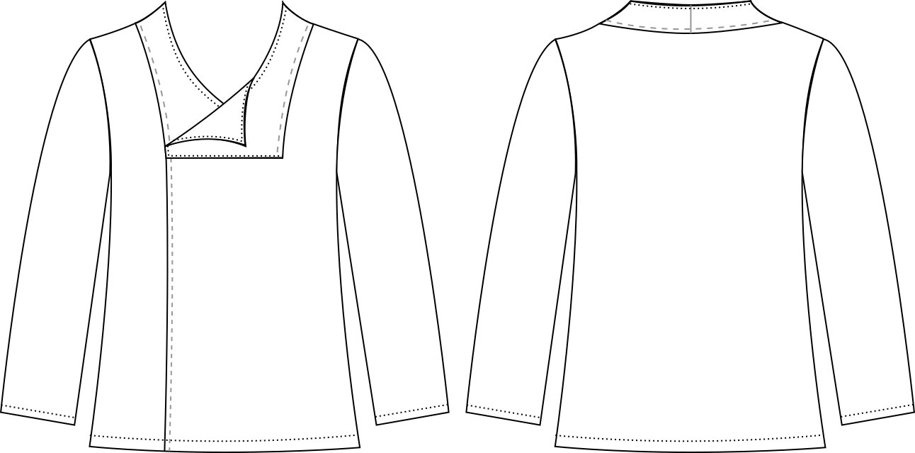

I've created a line drawing of the updated shirt structure. Any suggestions, changes?
(Updated 7/12/16 with body seam)
Thanks for the drawing. This shirt is what I am drafting today so it is nice to see that I am on the right track. On the original, there is a seam running down from the corner of the yoke to the hem on the left side as you look at it. You can see it (barely) on this photo I took at Comic Con but it was clear to the eye that there was a seam line there with topstitching about 1/4 inch to the right (as you look at it) of the seam.
Oh, good! I had added that on version 1 of my shirt, but was afraid I had mistaken that for the seam at the top of the yoke! Thank you! I'll update the drawing tomorrow.

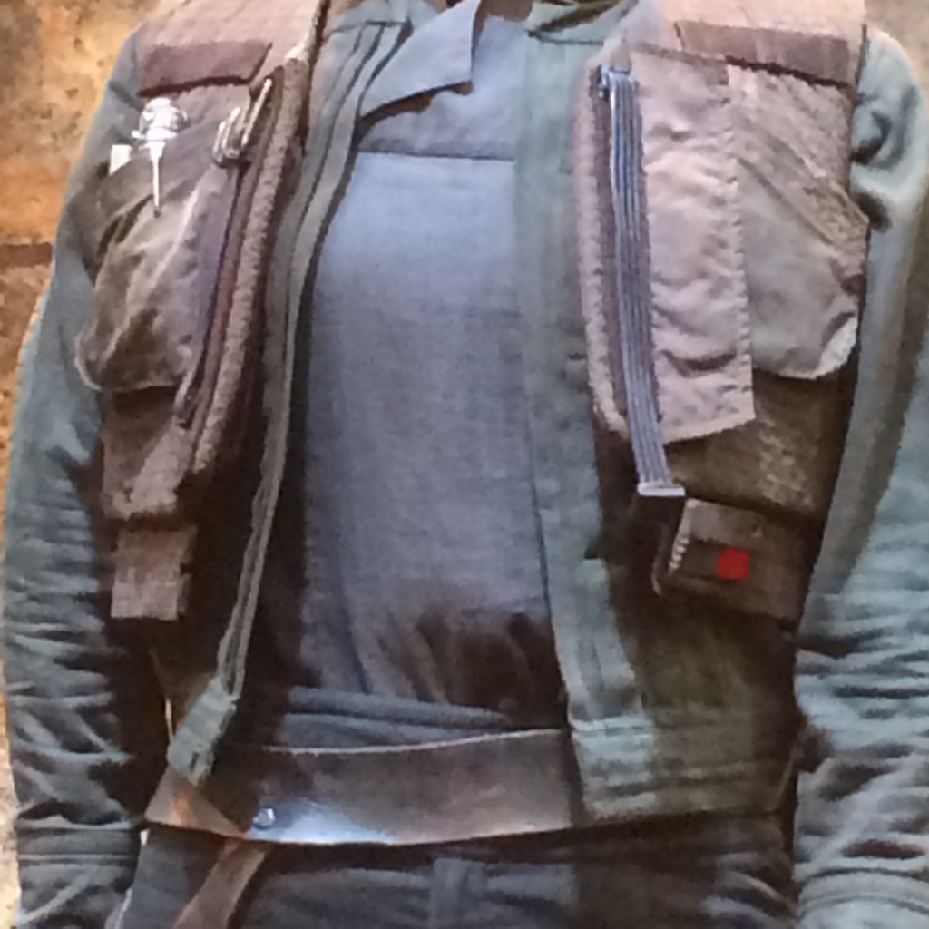

marishkabibble if you're trying to figure out where to begin and don't need official confirmation about the fabrics, from pictures and observing the costume in person at SDCC the shirt seems to be a linen or a linen blend that's equal parts blue and grey. The vest looked like brown cotton, and the pants are the same as in her cold-weather costume.
