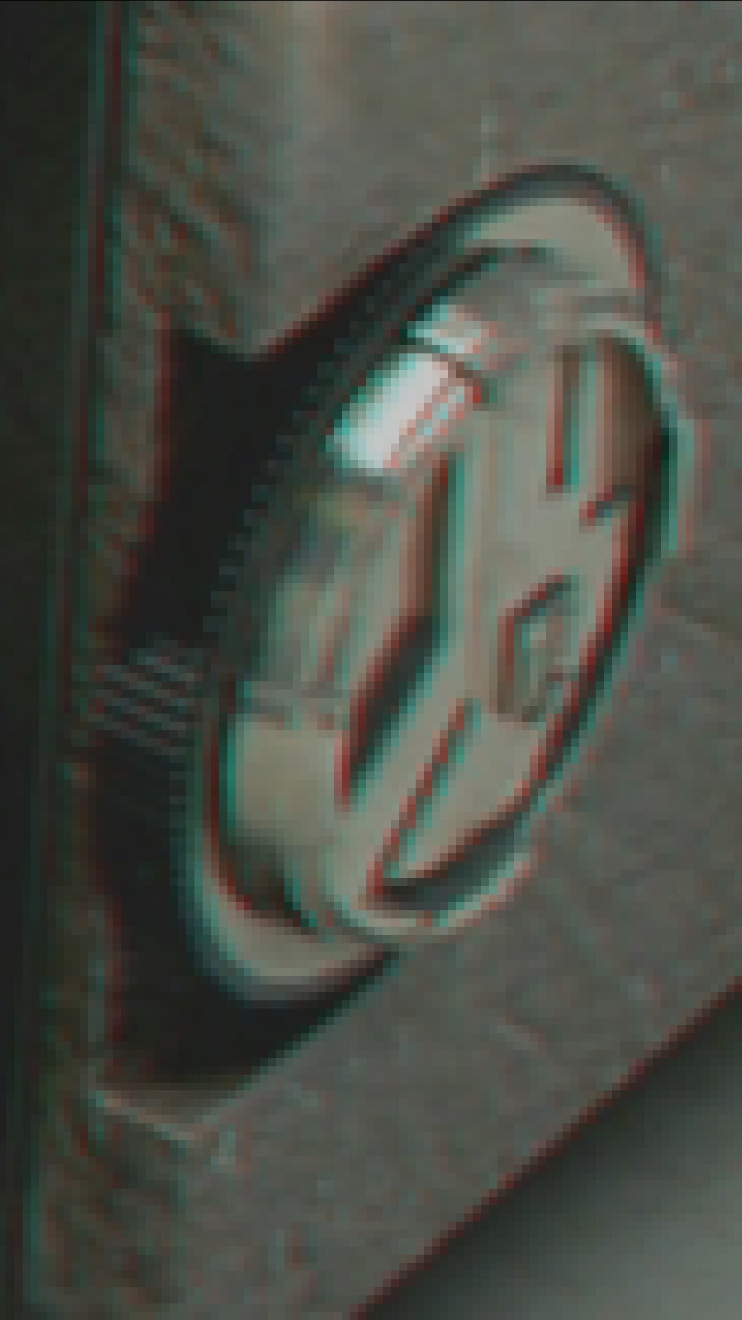

Also FWIW, I feel like the Coax connector is actually a dial knob with the innards removed, It looks like they drilled out the top with the little mark on it and glued the coax end into the knob. This is the initial picture that has the tight style on it, though I am still sourcing the make/model/era of radio it's off of. What do you think?
To clarify, the end we see is the one currently pointing to the innards of the radio, IMO.

Guys we need your help!!
We have no idea what we are looking at. Perhaps some of you might recognize something. We were thinking of a resized V8 part but that doesn't seem to be the case. So any help/advice is welcome.
