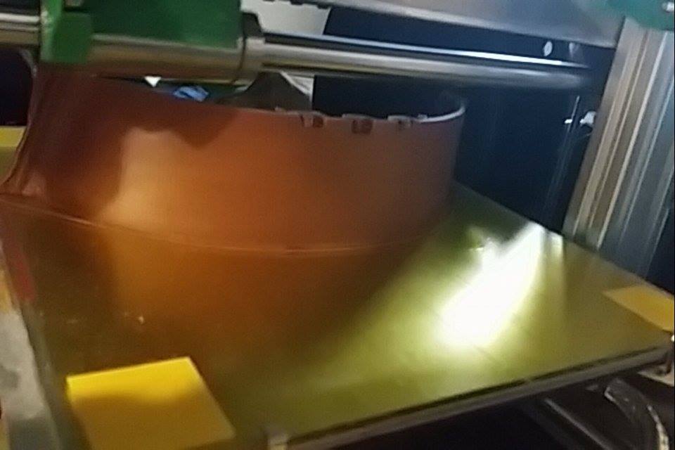

the helmets being 3d printed

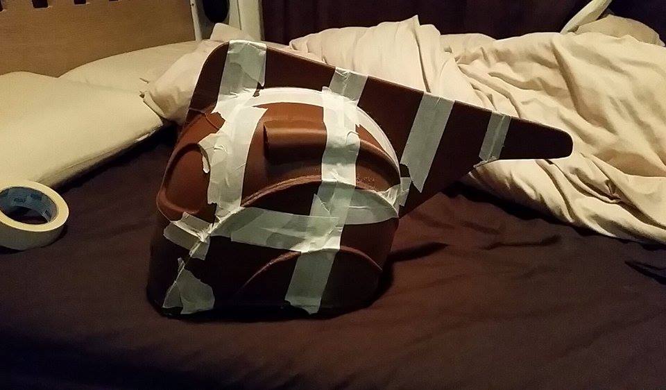

after a very long time ive finely got it all taped together to make sure it all fits nice.

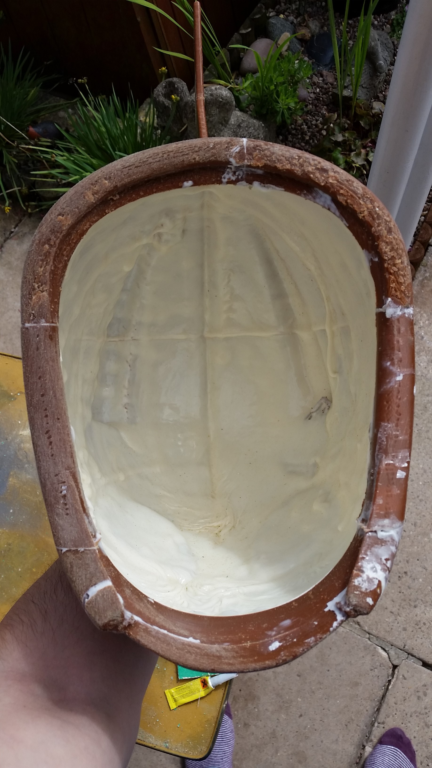

i then slush cast the inside with fast cast resin.
the fast cast fills in any gaps and holes saving a bit of work filling with epoxy resin.

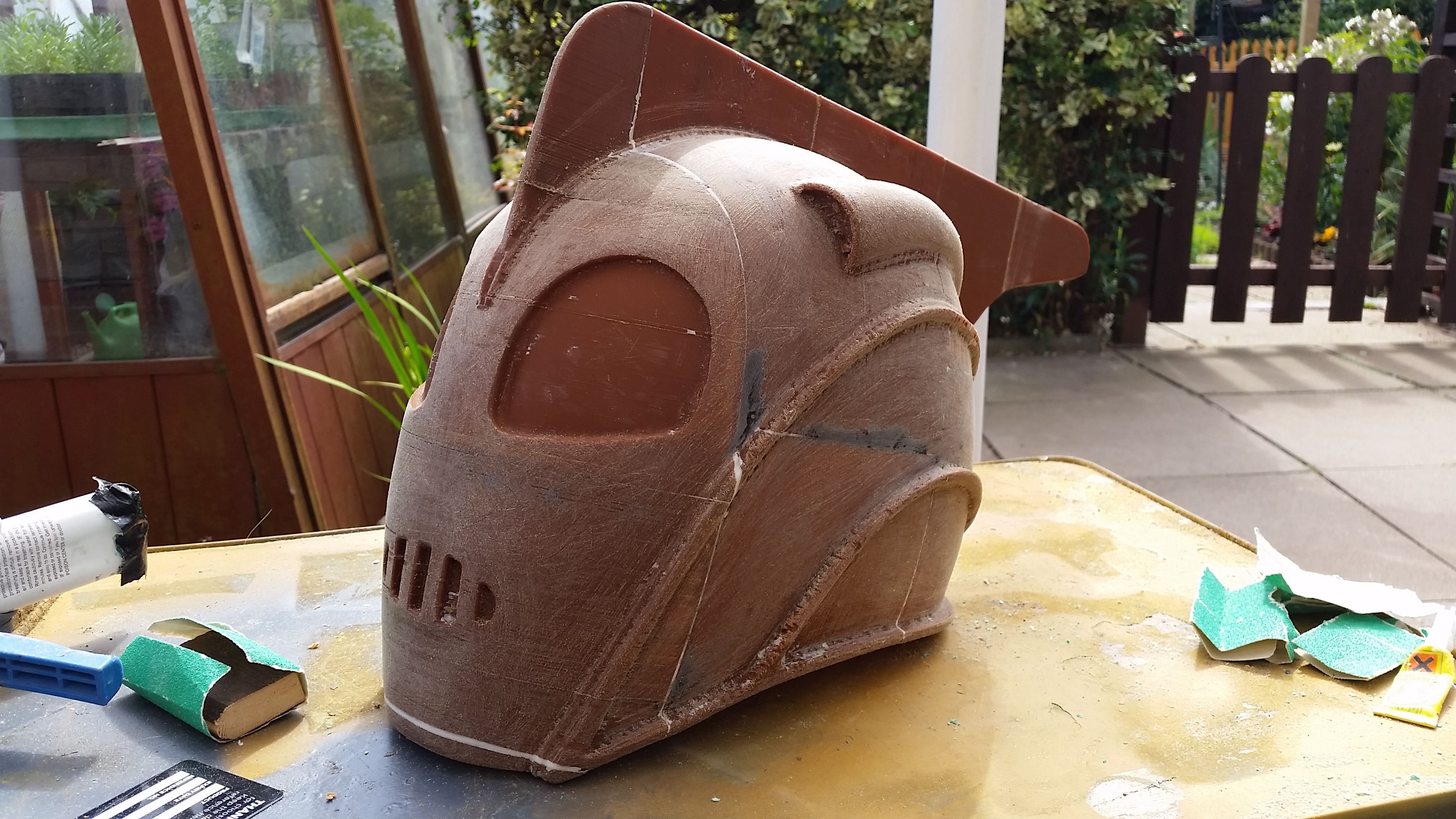

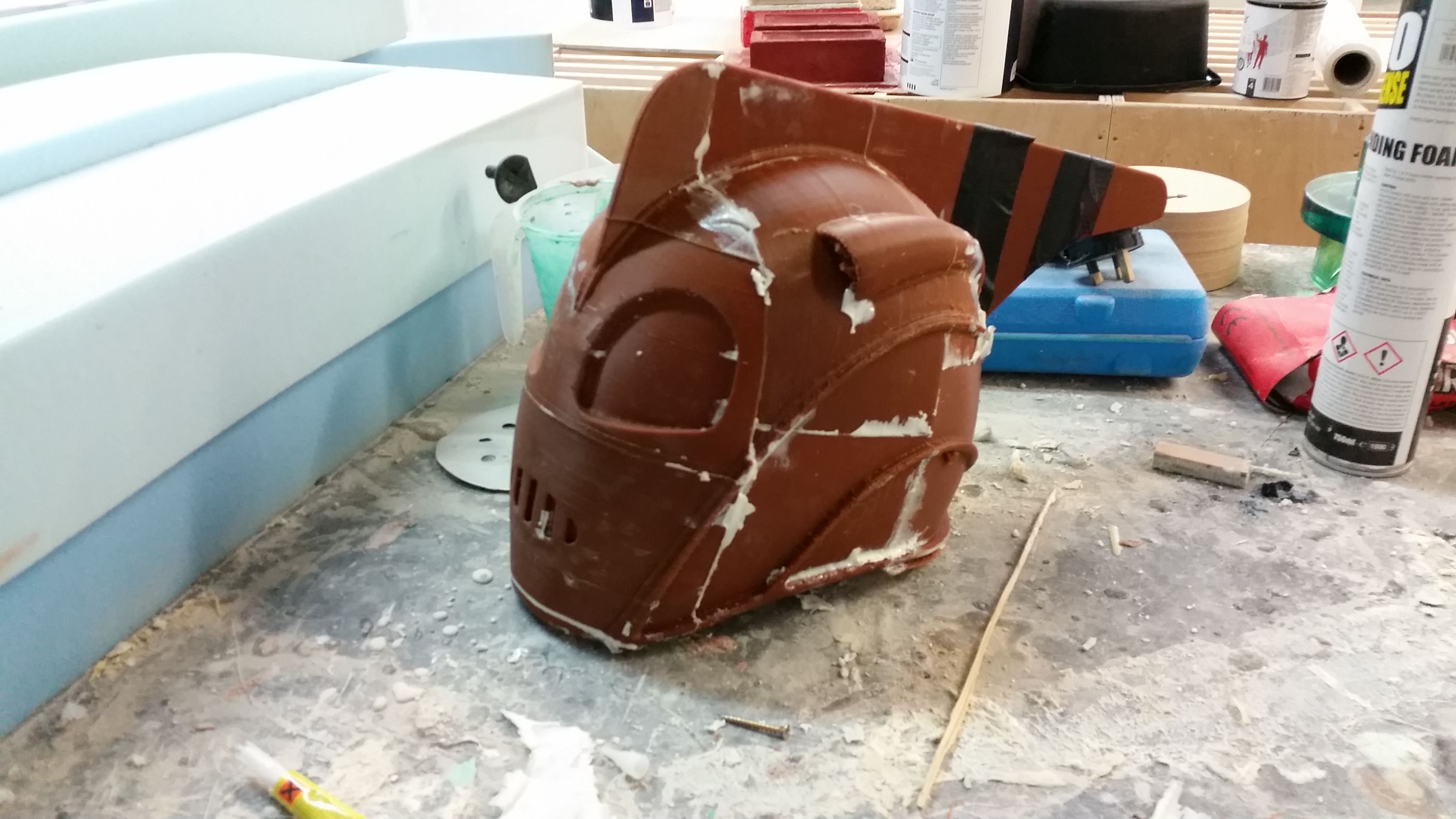

i then started to sand it with 60 grit sandpaper, thats should give it a good bed for the filler primer to bite onto.
and that's where im at so far, i plan on chopping off the fin so i can make a single part as its not that strong as it is. i also plan on making it out of polyurethane in the end. hope you finheads like it and if you guys have a any tips and tricks please let me know.

slush casting works a treat. best to sand the insides to help it bite but other then that its great.
i chopped the fin off today and finished sanding
i cut just below the 3d printed plastic leaving the resin in tacked, that way it keeps it strong then filled in the gap with car filler.
iv now can use the fin as a template to make it one piece.
when i come to fixing the fin to the helmet i will wax the fin first then add the weld lines to the helmet and fin. this way i will be able to remove the fin so it makes it easyer to cast.

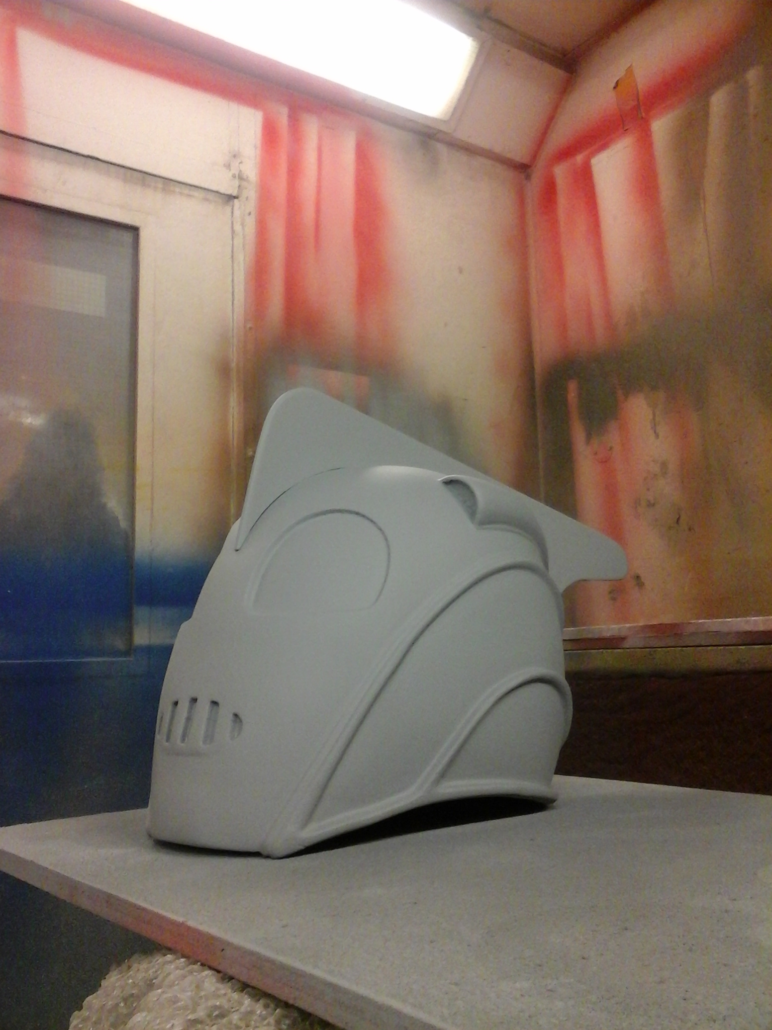

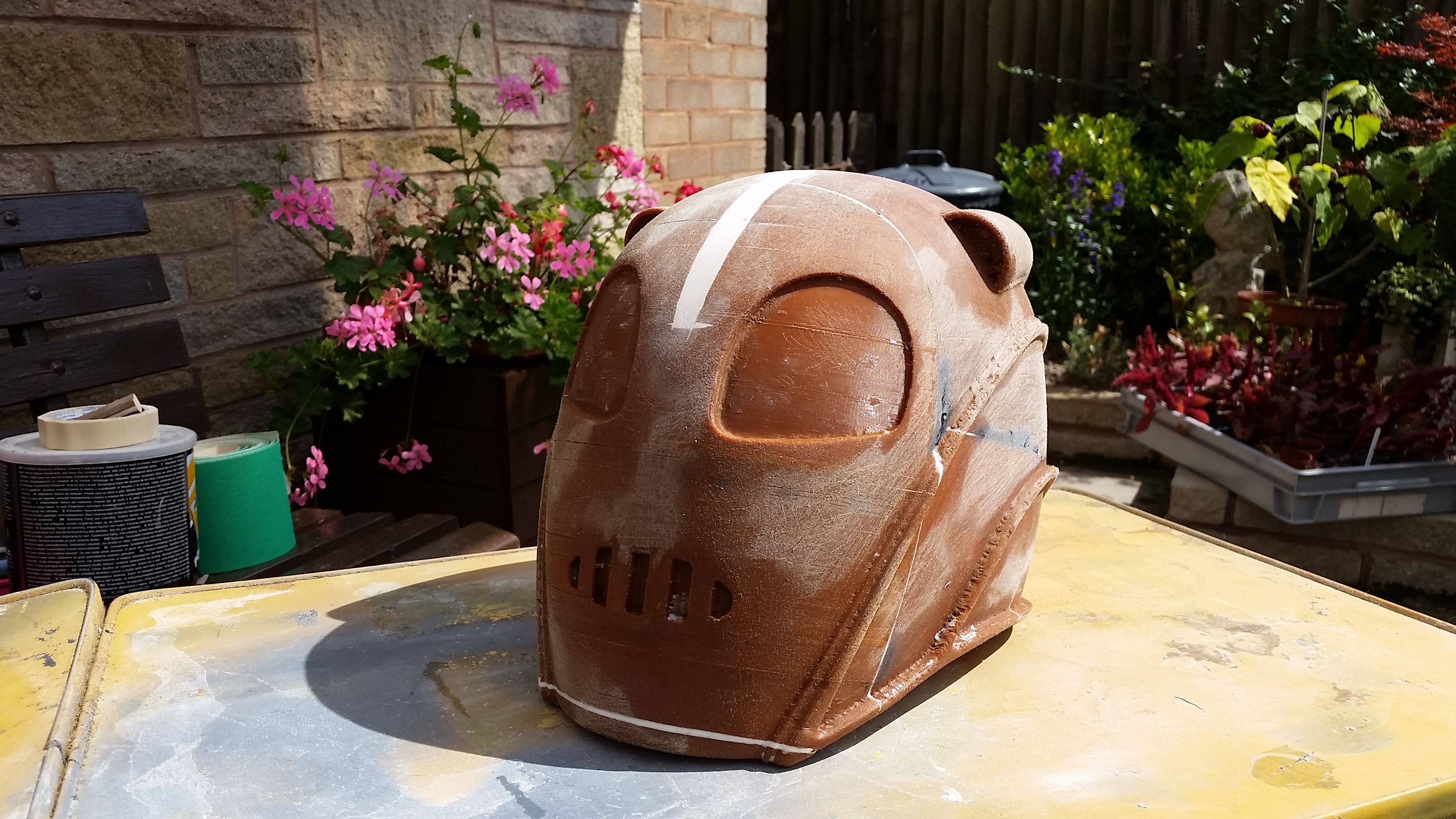

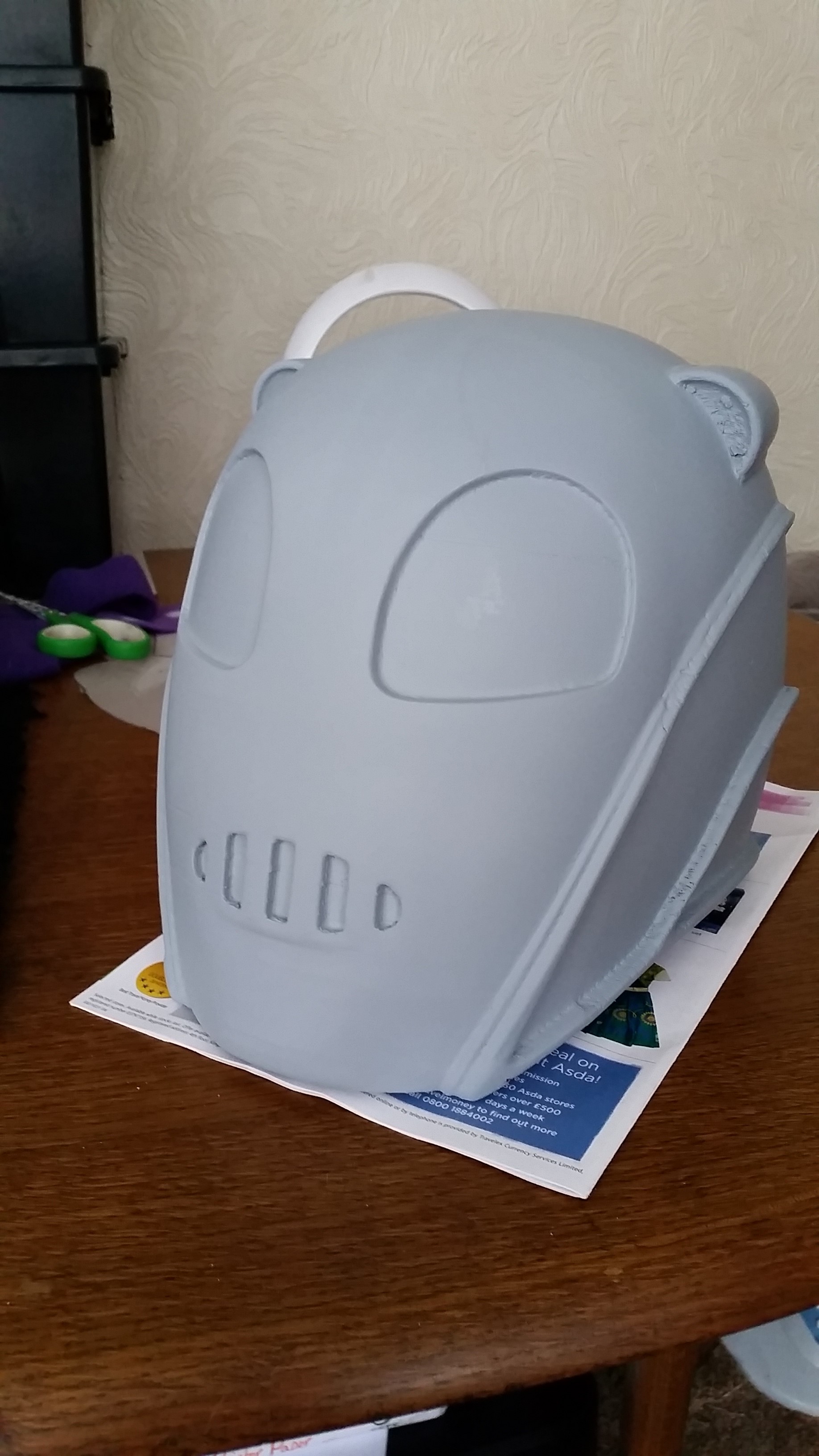

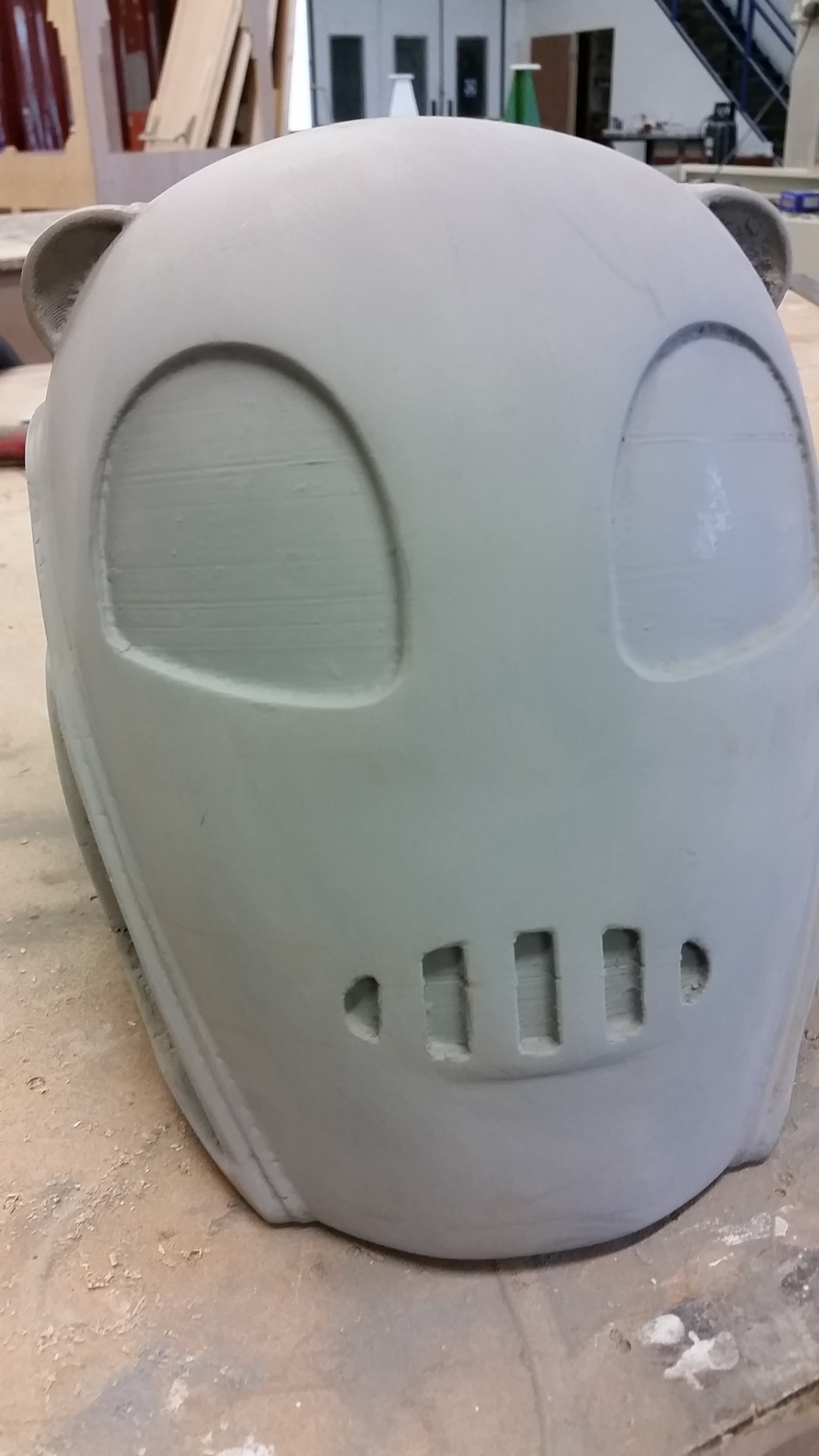

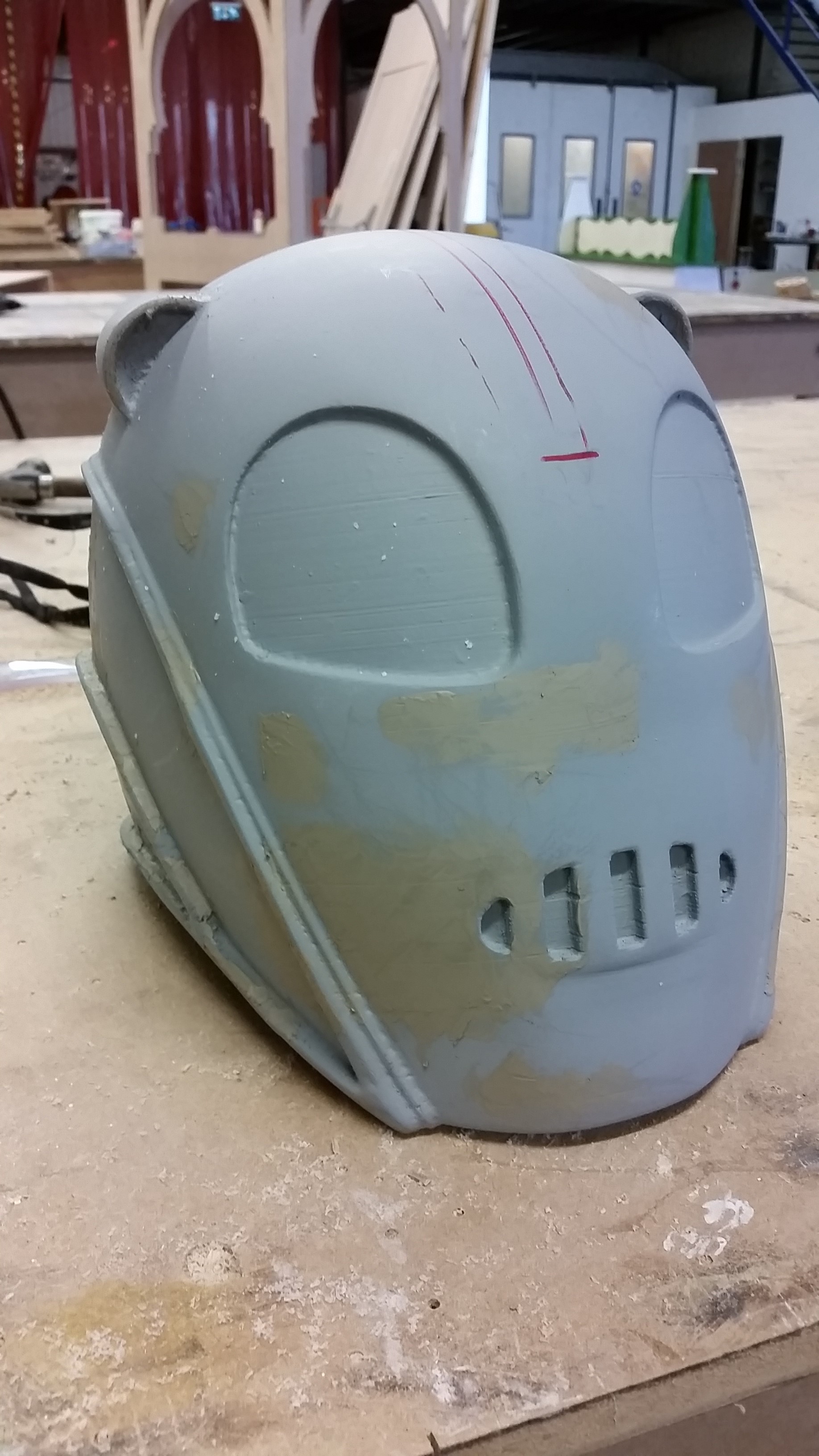

today i finally got to give it a few coats of filler primer. the first coat its just a thin coat. this raises the plastic fibers so that i can sand them off with 120 grit paper as you can see in the first pic. the dark patches are where the fibers are standing up.
i then gave it i good few coats to help fill in the gaps i then sanded the gaps back to the plastic leaving only the primer in the grooves. then another good coat

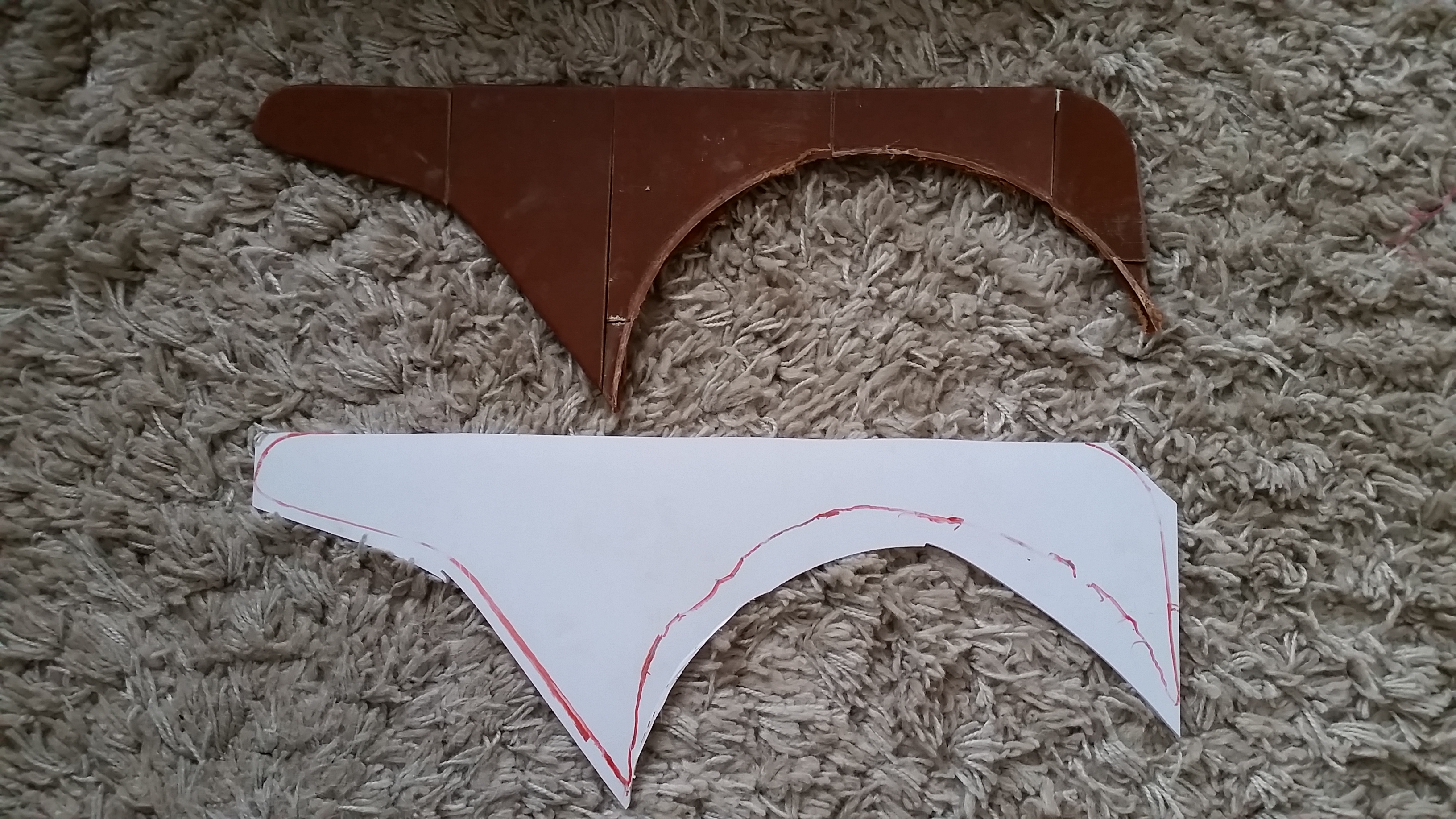

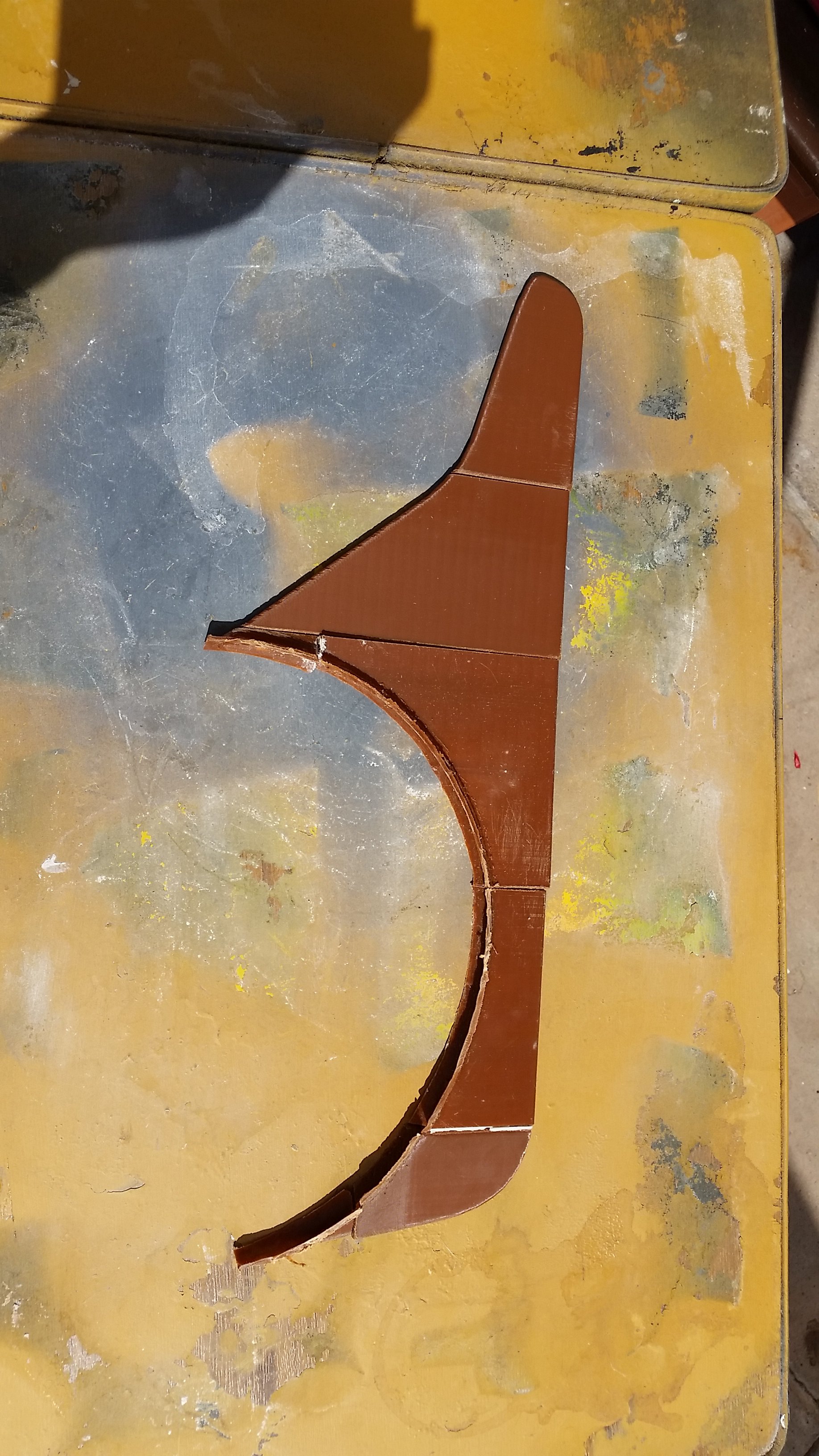

i also made a start on the fin, i traced round the original onto a 5mm polycarbonate sheet
still needs sanding and shaping but it will be perfect for what i need.
Good idea JPH I just had the polycarbonate knocking around. But I might have a look to see if I have any aluminium. Would definitely be better.

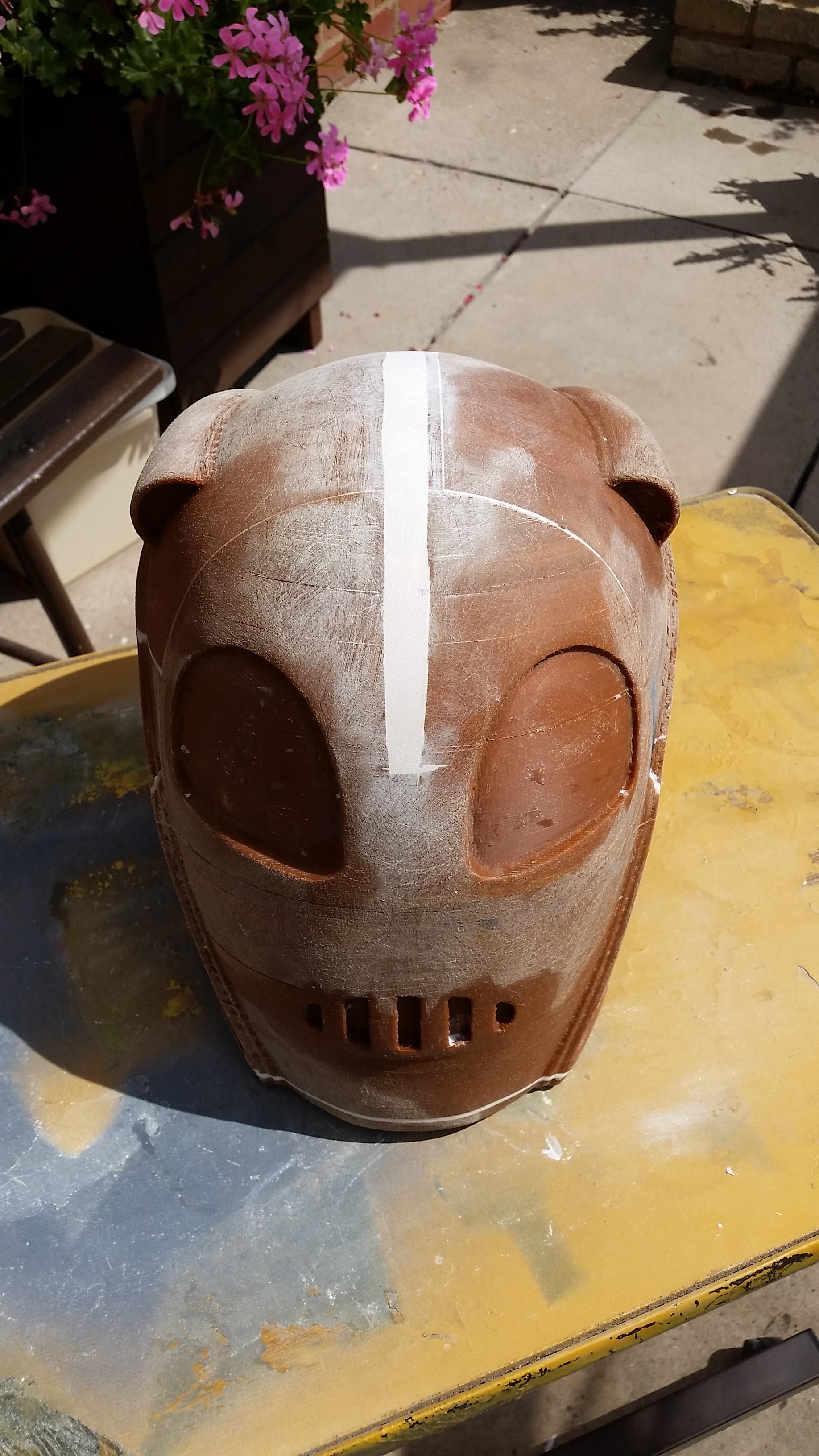

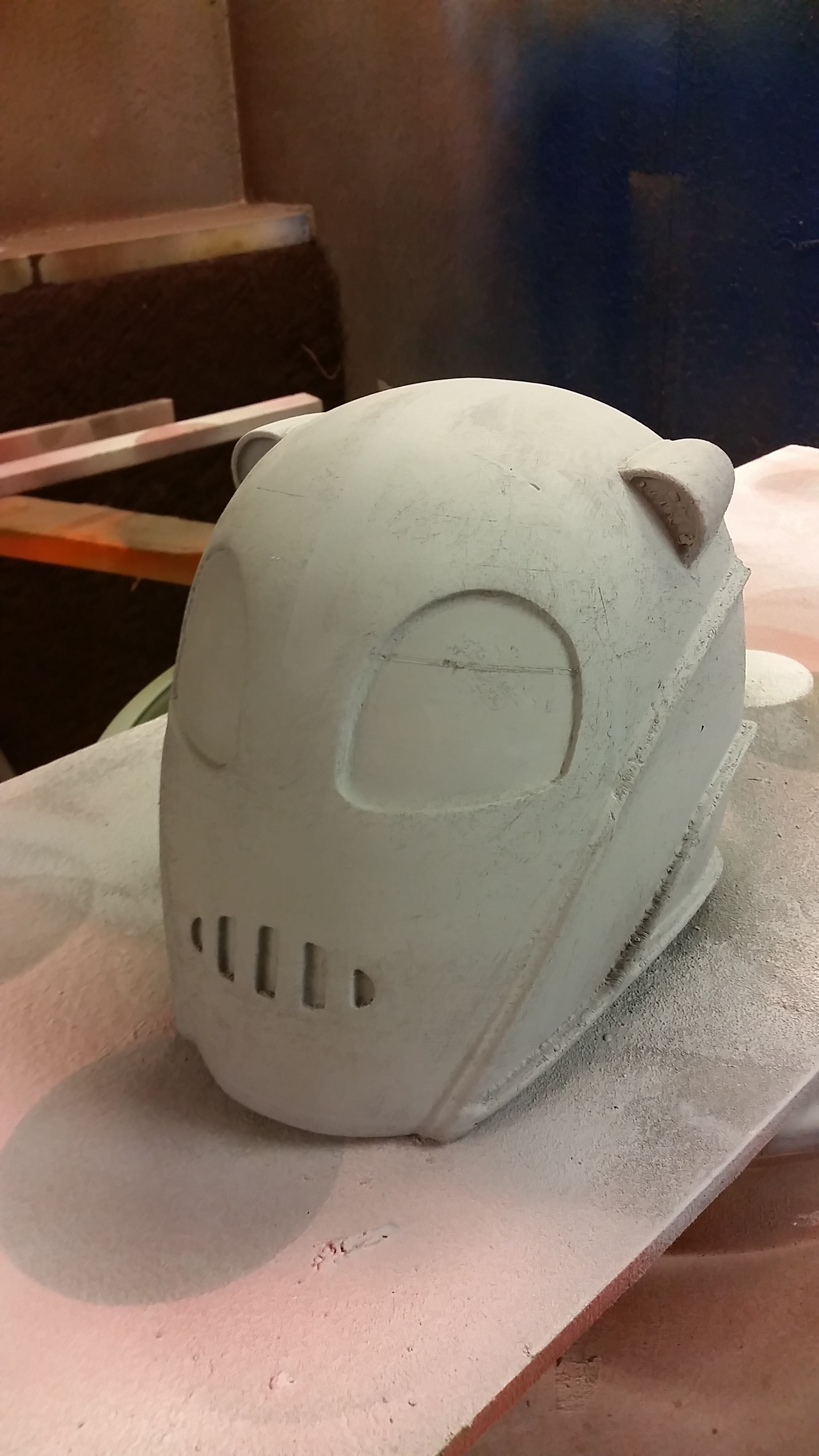

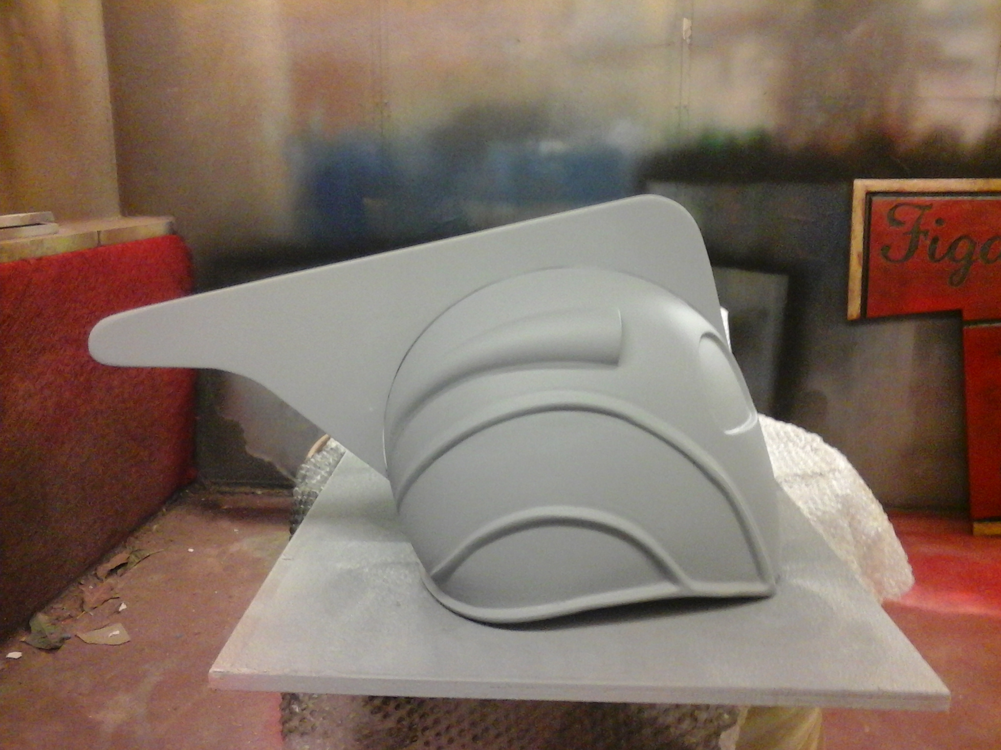

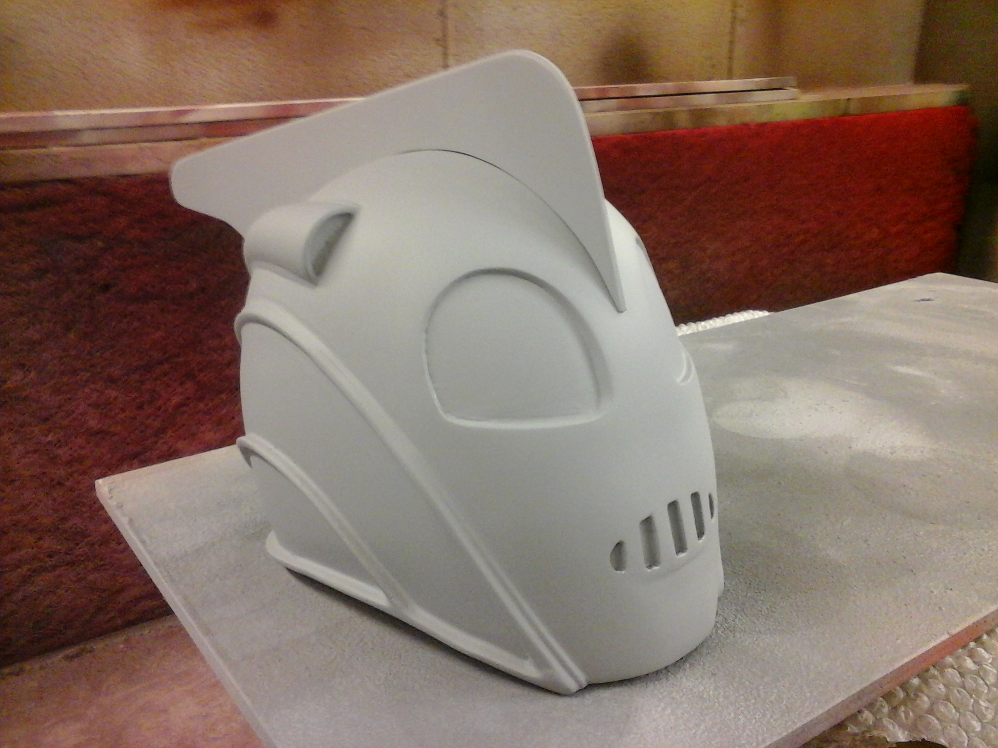

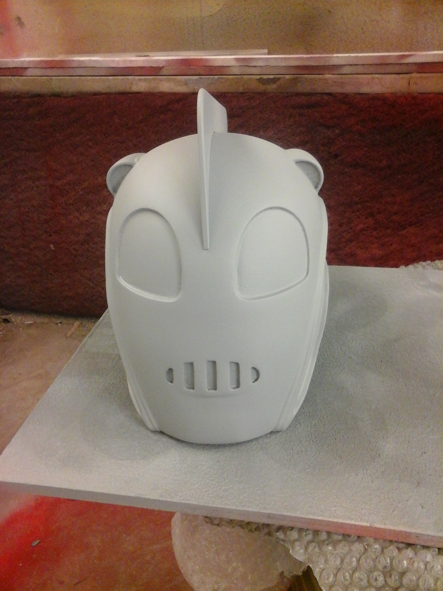

today i used some cellulose stopper to fill in some big lines and pin holes, if you have never used this stuff its great it like a very thick paint that can be sanded withing minutes and isn't as hard to sand as body filler.
stopper applied
then sanded off with the gaps gone

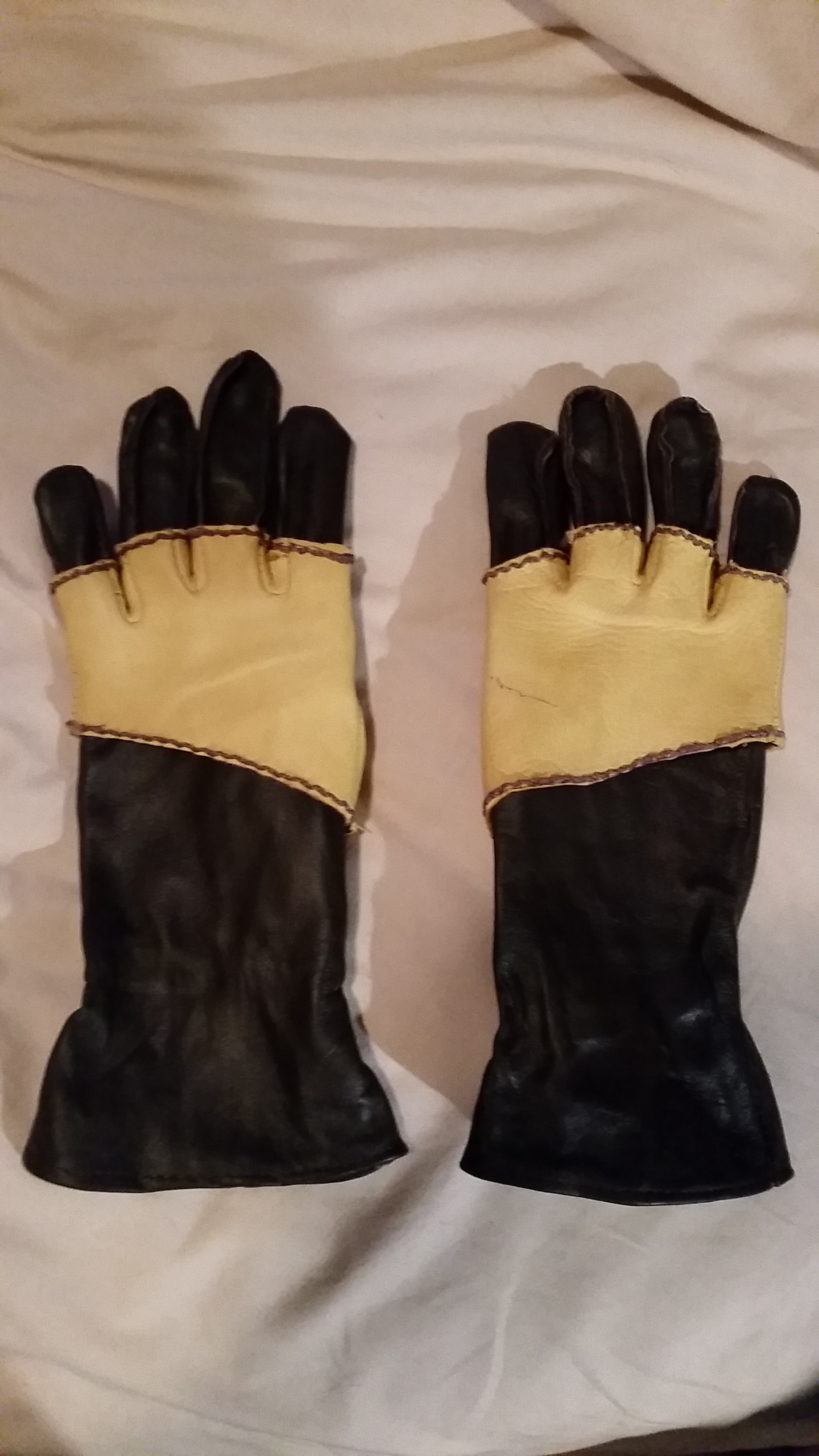

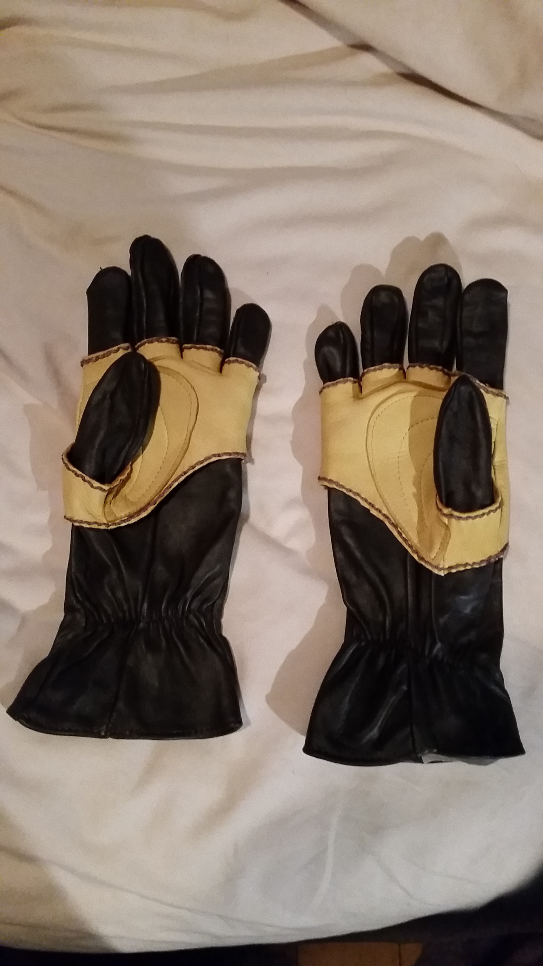

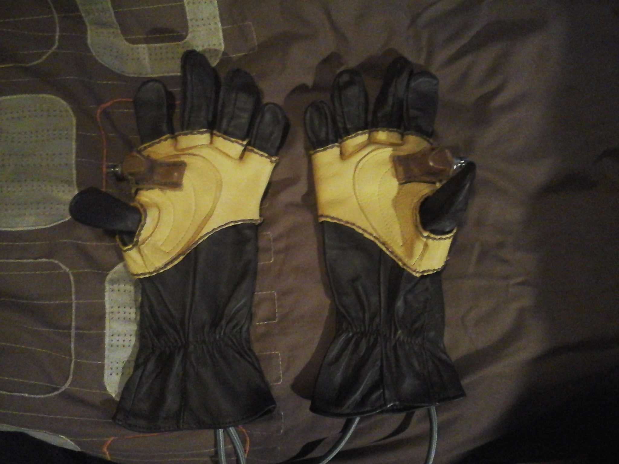

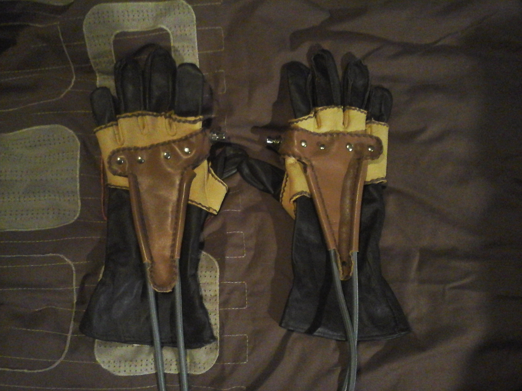

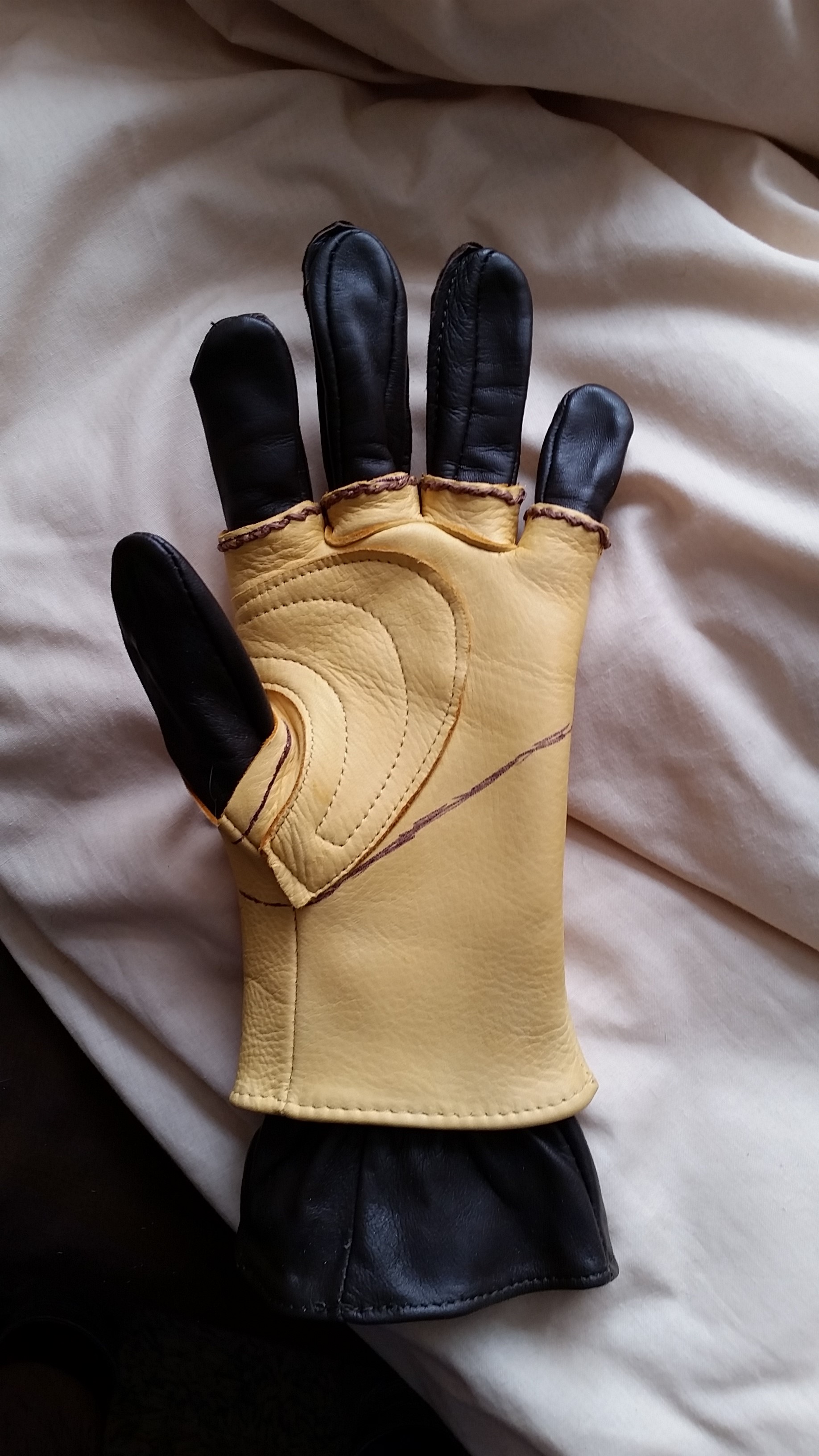

ive been doing some work on the glove controls for the past week

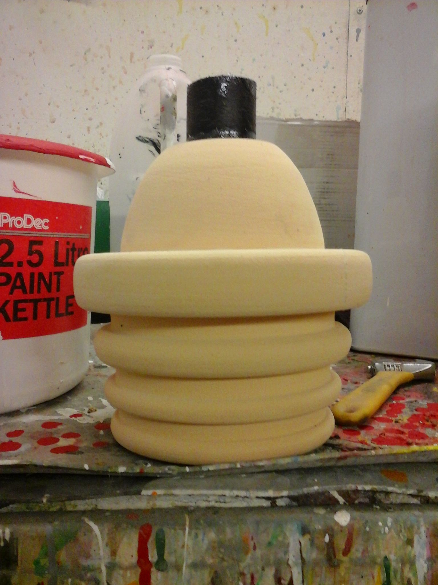

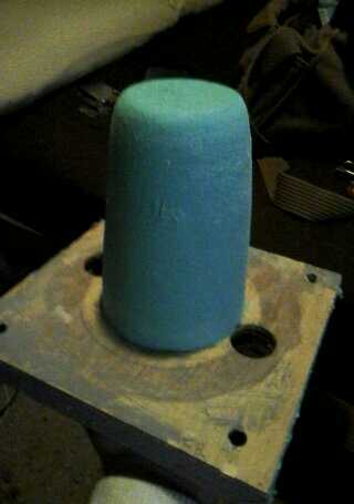

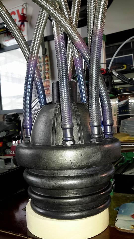

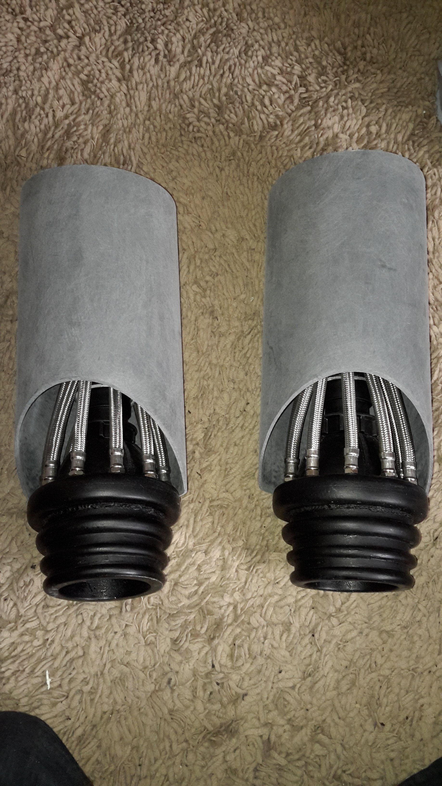

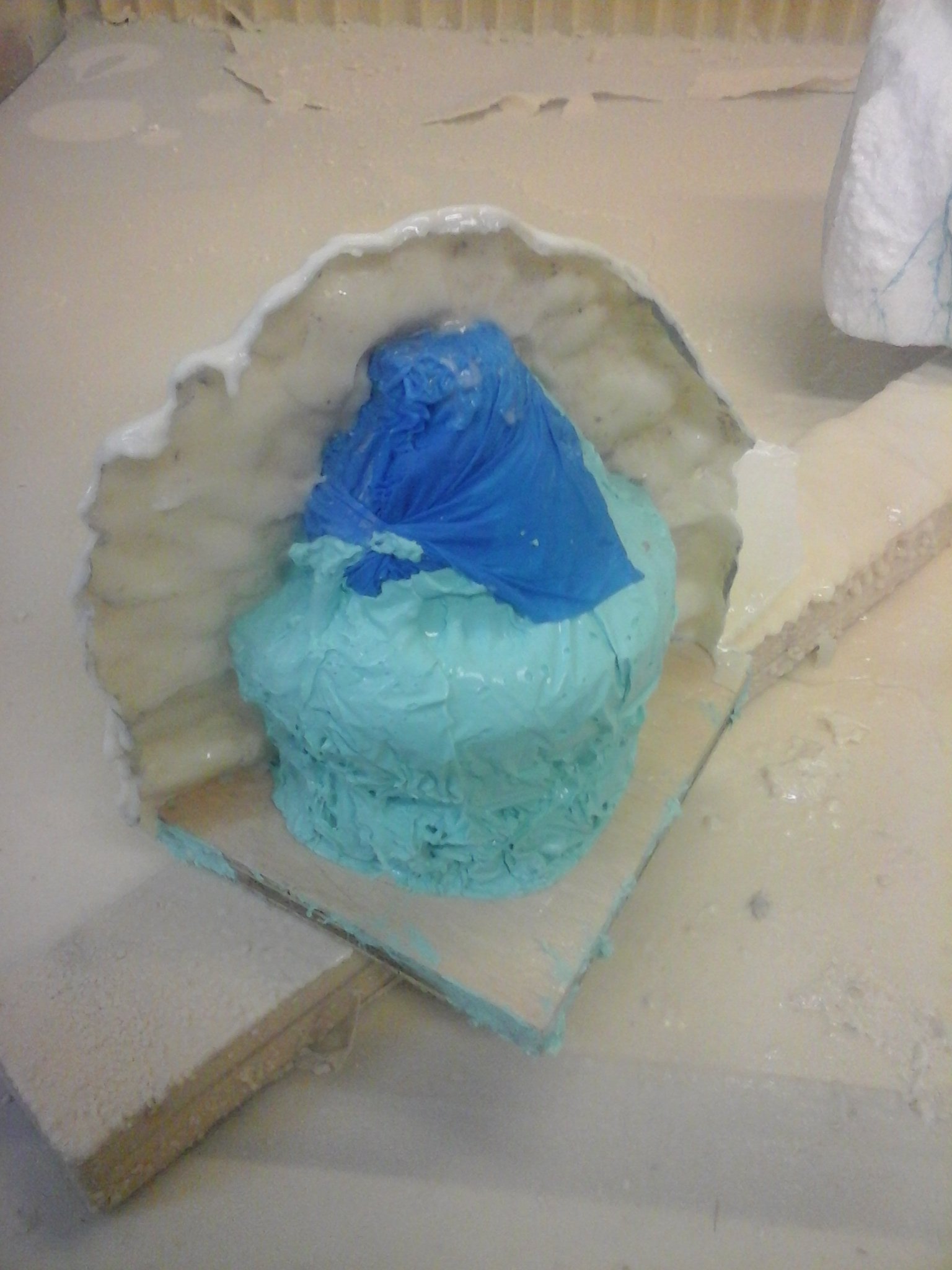

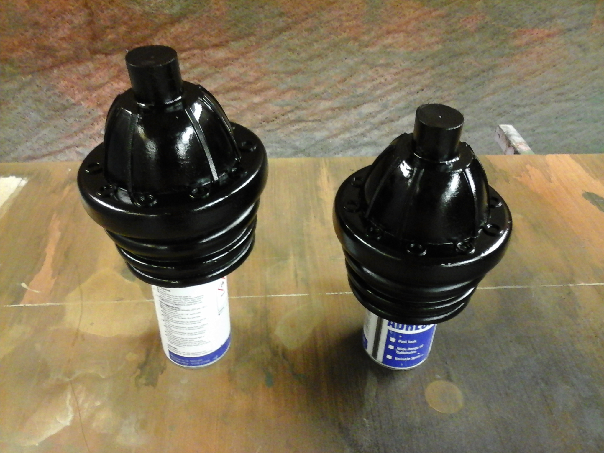

ive also made a rocket base/booster using a lathe and some high density foam. i will make a mold and make two hollow casts of this

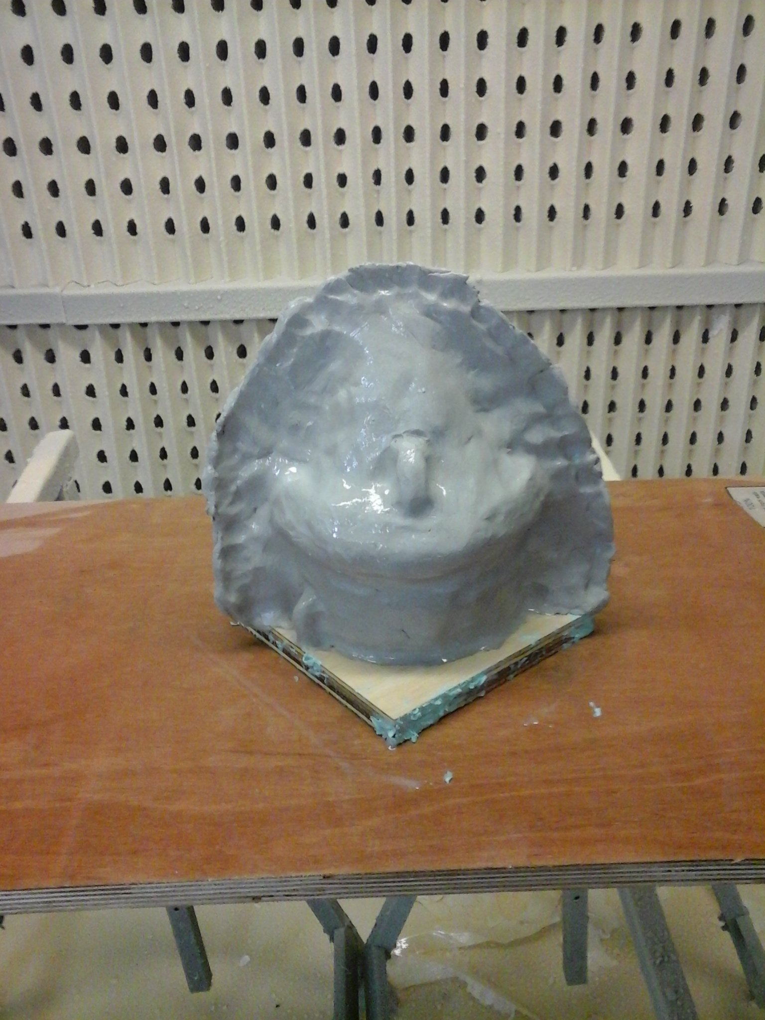

hay guys its been a while since i last posted but i have been working on my project. i cast my rocket boosters
20150914_133123.jpg20150928_202500.jpg20150925_122804.jpg20150928_202512.jpg20151127_163057.jpg

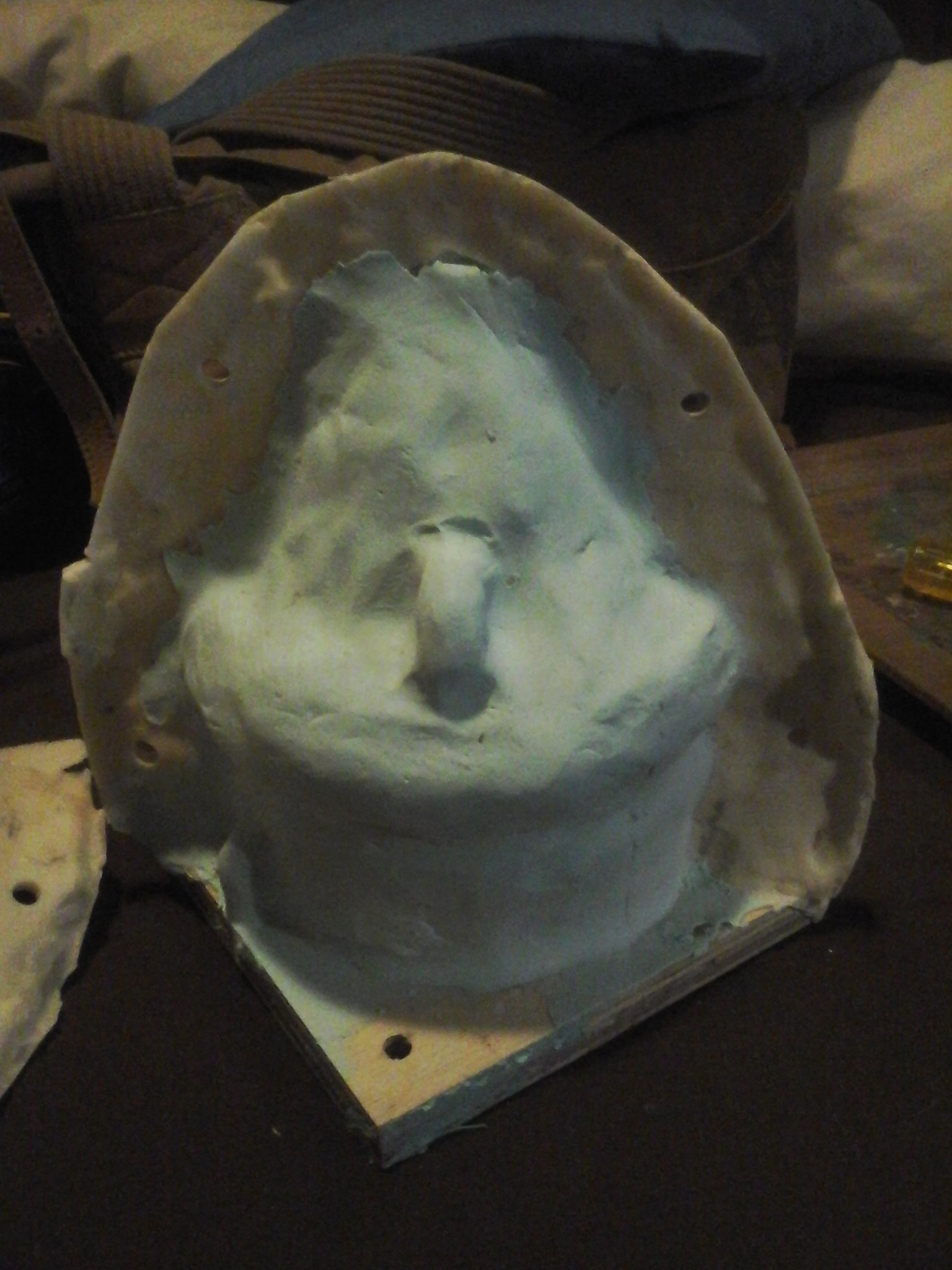

i also had to make a silicon *coff* plug for the inside of the boosters
as for the fuel pipes i got some flexable water pipes and screwed some bolts into the end then cut the heads off and screwed then into some pre drilled holes on the booster
the gray pipe i will be using is 6" soil or drainage pipe.

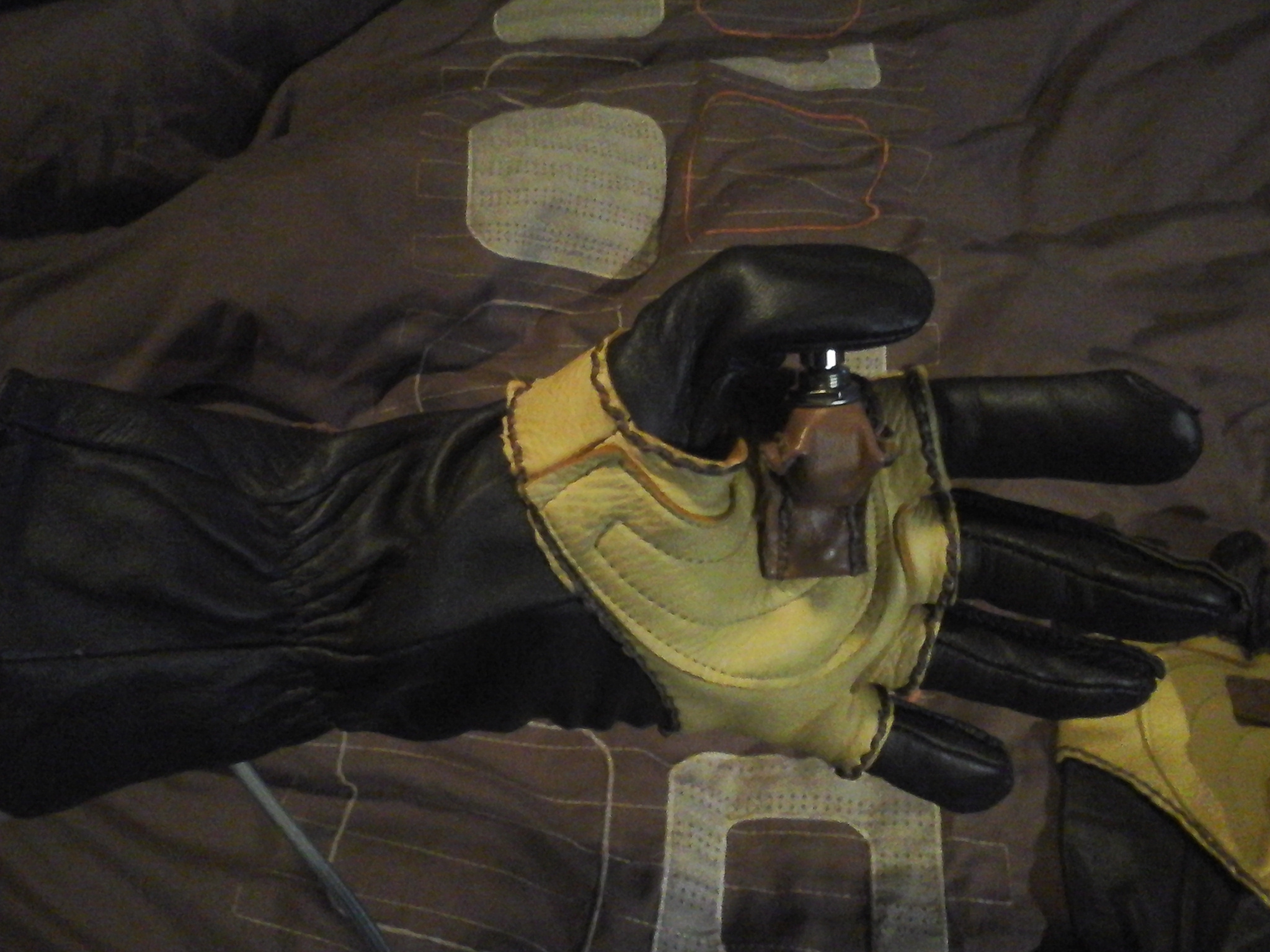

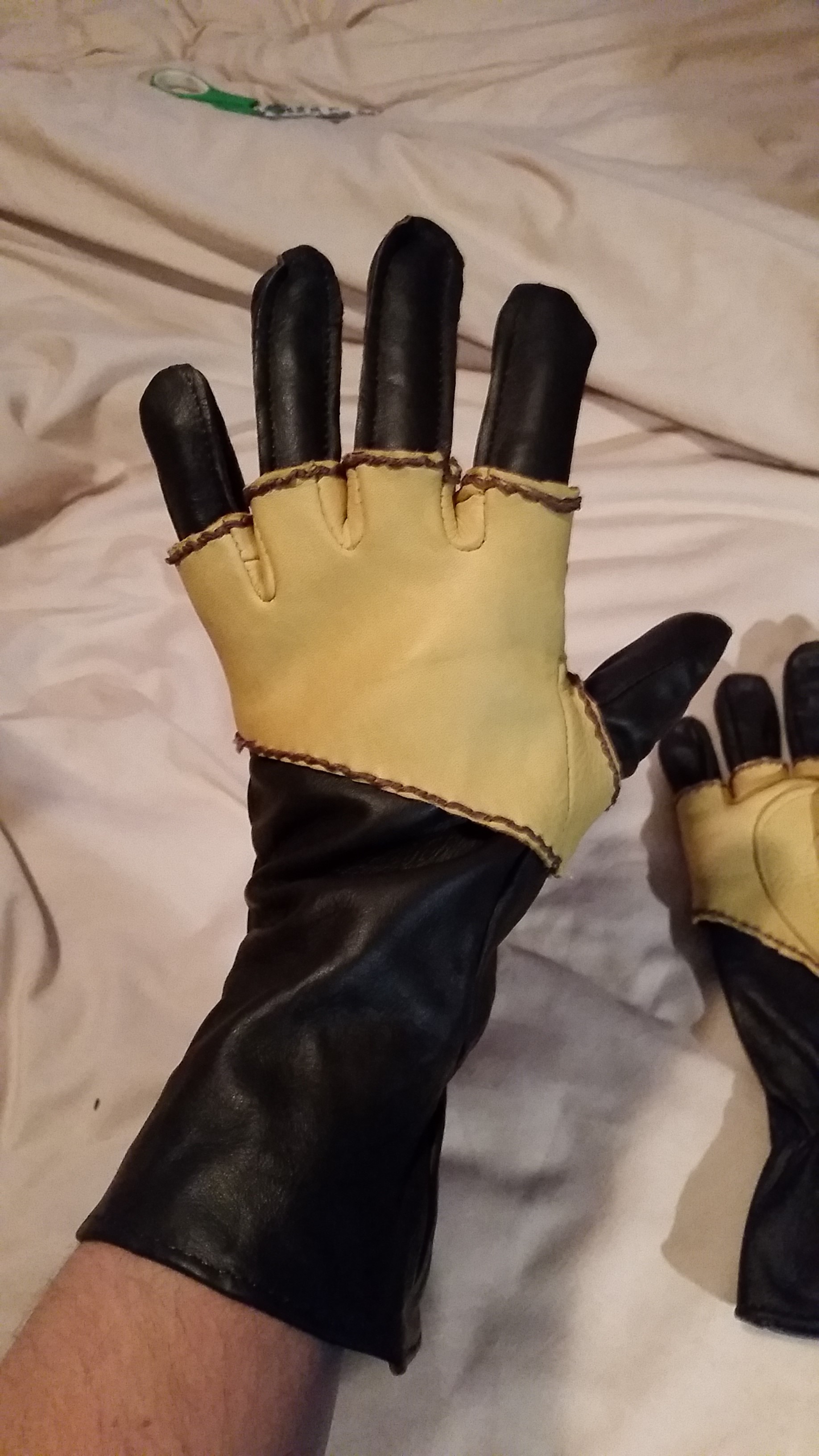

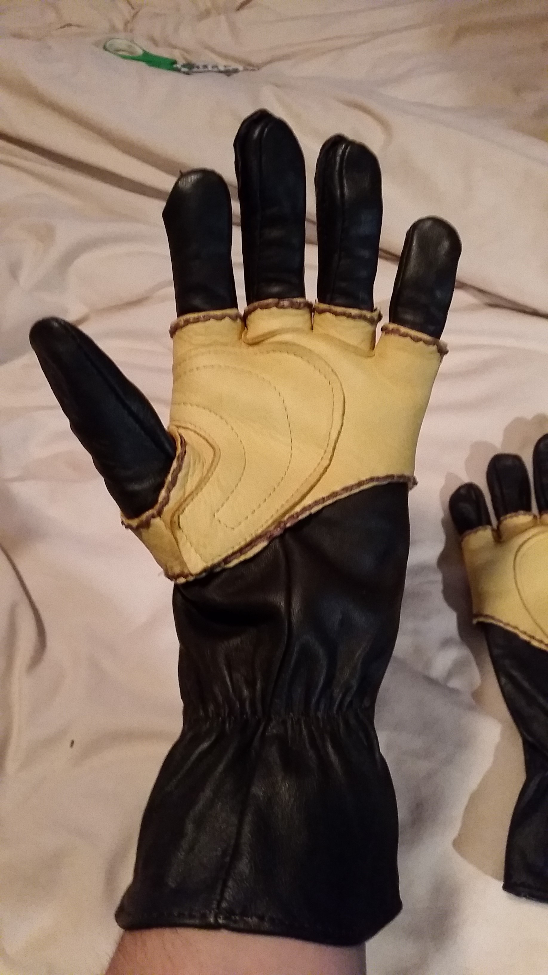

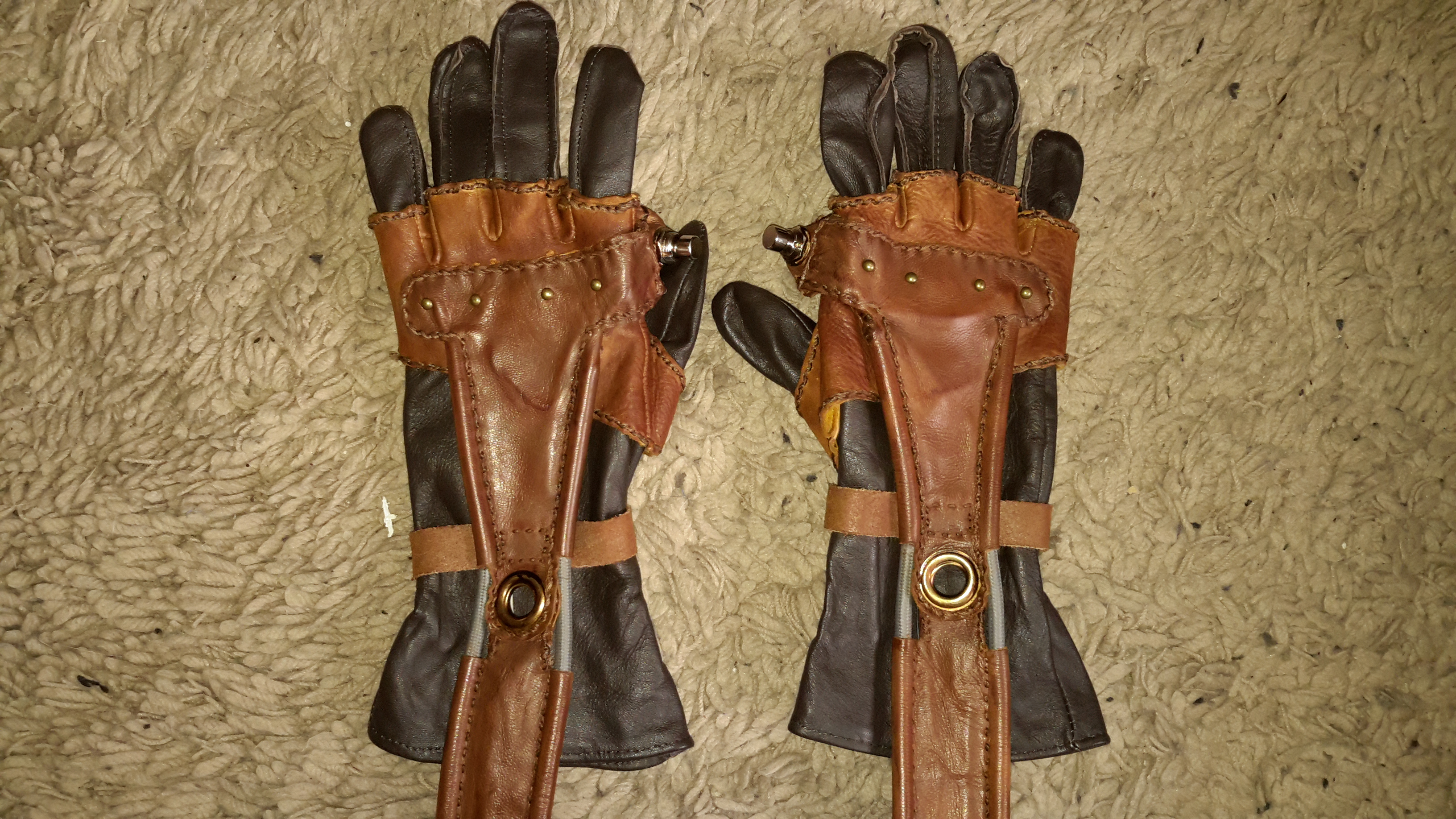

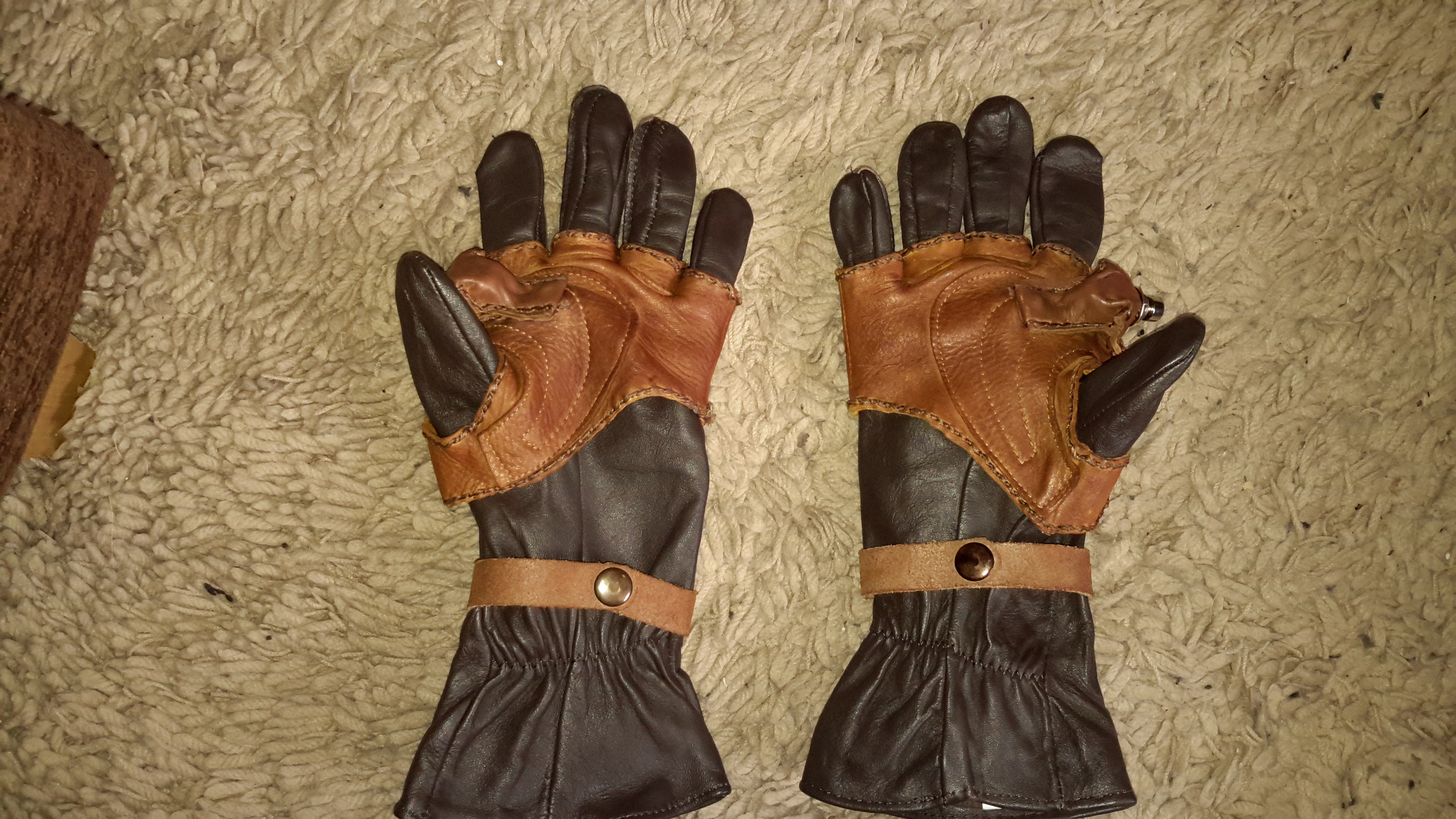

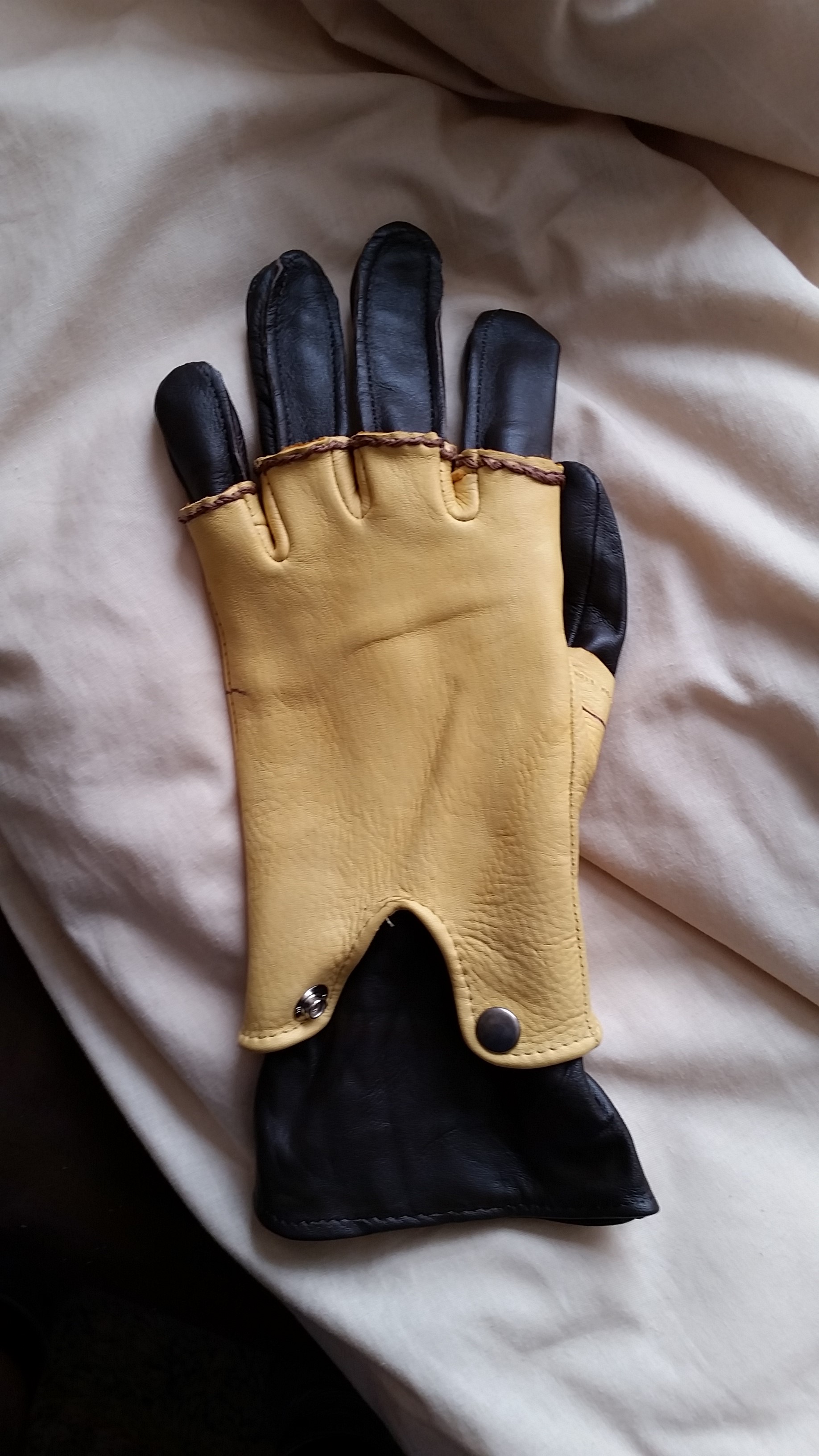

the gloves are almost fully complete now, i want to add some straps up the arms to keep the cables in place if i dont have a jacket on but that will be a small addition.

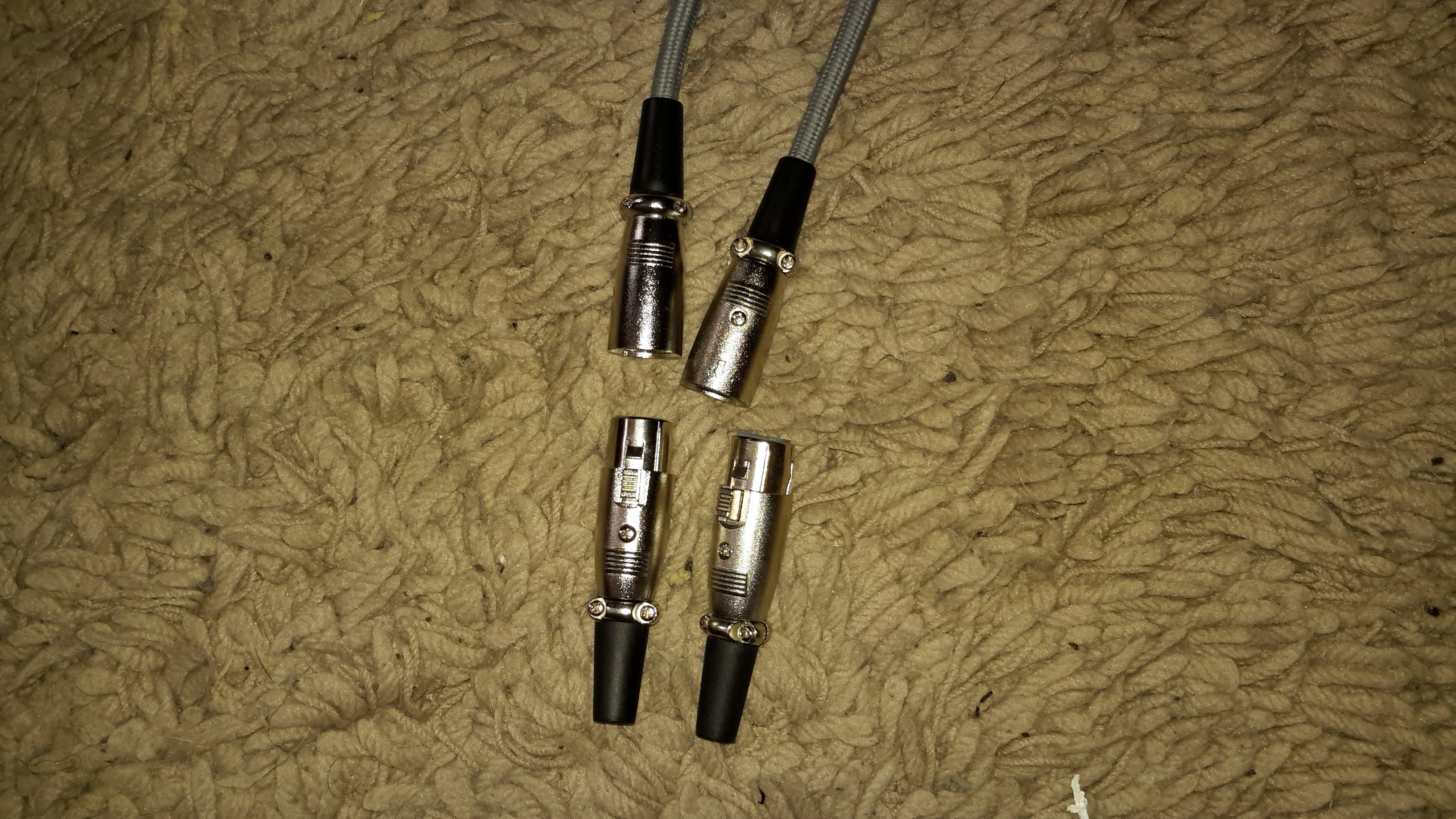

to connect the buttons to the jetpack i have some 3 pin connectors
these will be great so i dont have to struggle getting out the pack and gloves at the same time.
