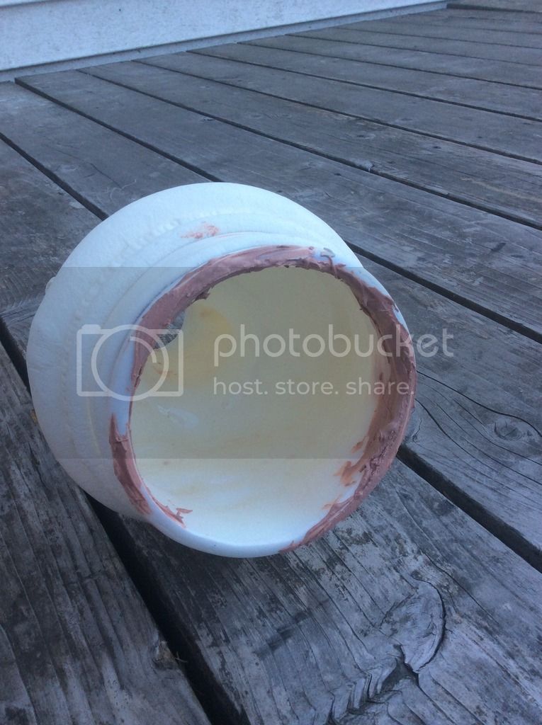

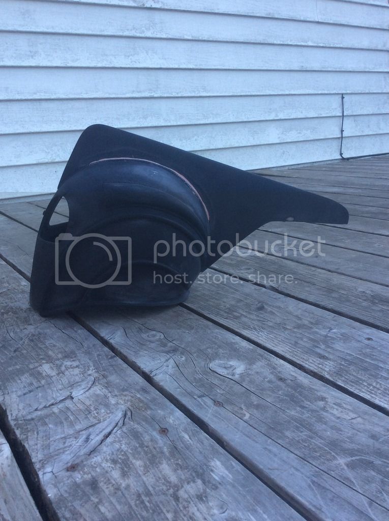

Now for the stuff you want to see, I'll save you from some of the smaller tedious stuff I've been tweaking and share with you a problem of sorts. This rocket was cast super thin at the base, so thin in fact that you could easily see light through it and feel it flex. Well, I've decided to bondo the hell out of it and give it some much needed help. Here's where I'm at as of tonight, I've got the Bondo on and just need to sand and shape it.
its probably going to require a few passes of bondo and sanding but hopefully it'll turn out nice. I've also got the body 90% ready for paint and it should be going in within the next two weeks. I totally scored and an automotive painter with a paint booth is going to shoot it for me. I'll have some photos of the body up in a day or two showing its current state along with some repair work I had to do.

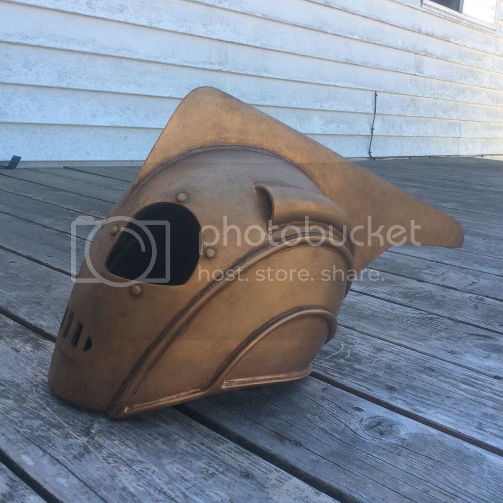

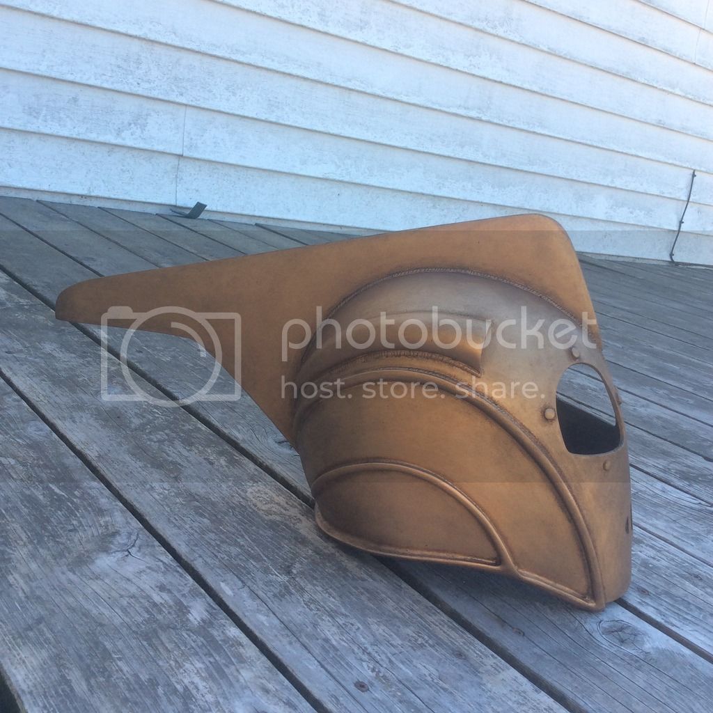

I also decided that my plate wasn't full enough with the pack and all that goes along with that, so I cracked open my OZ helmet kit and started cleaning that up. I got the fin attached and decided to fill the gaps where it mounts. The sculpt is so beautiful and I love how light it is compared to the ACME one.

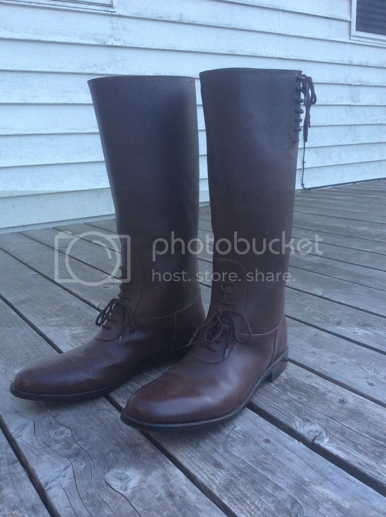

Lastly, while it's not a part of the build. I'd still like to show off and give a shoutout to Indy for making these Rocketeer boots. They're really fantastic, and for the price nothing even comes close. He was also kind enough to make them in a US size 14 for me. Once I tried them on with the helmet and jacket it really got me motivated to finish the pack so I can see the whole thing together. The boots do come with regular nylon laces which are totally serviceable, but I will be replacing them with leather ones in the near future. I truly am over the moon with these boots!

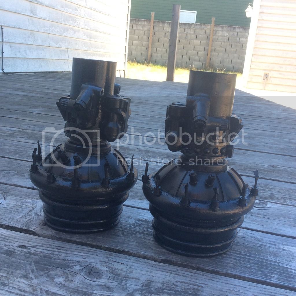

All right, I've had the engines sprayed for a few days with Rustoleum hammered black. It's a cool paint with a very interesting texture. However, it's says it takes 48 hours to fully cure. I call BS. We're at 72 hours and it's still soft to the touch on the inside. I'd really like it to be fully dry so I can start weathering them.

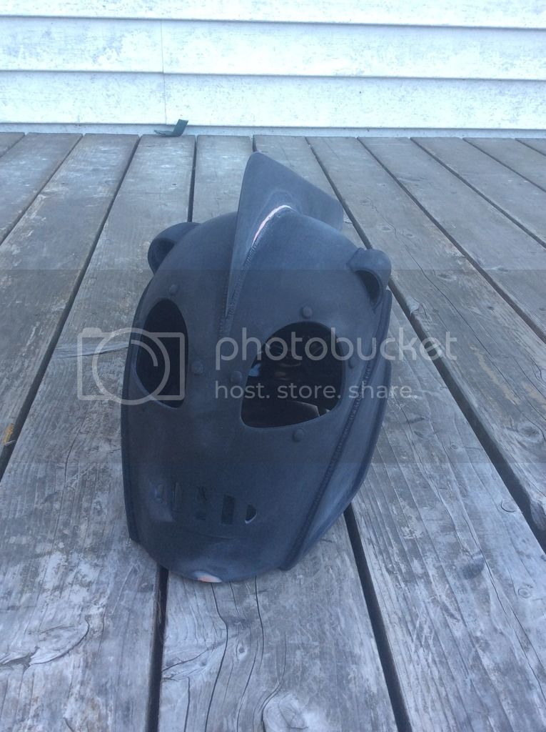

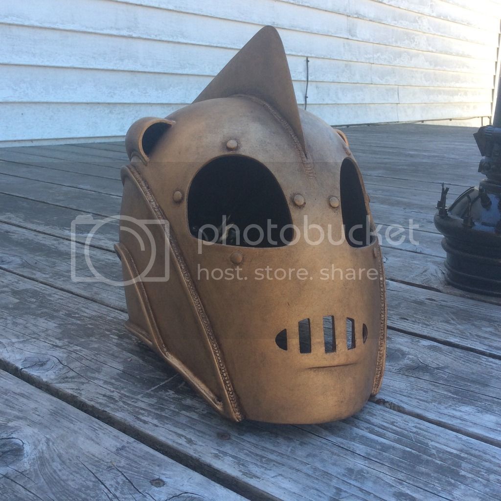

In the mean time, I've got this Oz helmet I've been weathering a little bit. This is the early stages of the weathering process. Just laying down multiple black and burnt umber washes before I start picking my detailed areas for dirt and patina. Not sure if it'll be as severe as my ACME helmet, but I guess we'll just wait and find out.

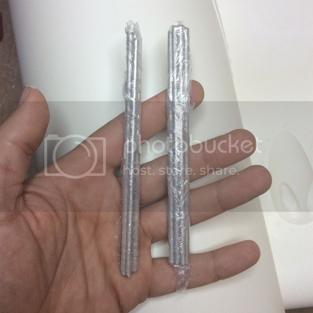

Anyway, the pack will be going in for paint next week so I'll have photos of that soon. In regards to the pack, my kit came with these metal rods.
Does anyone know what these are for? I'm at a bit of a loss and any help would be greatly appreciated.
The metal rods are to attach to the flaps situated at the bottom of your pack. They designed it as to make believe that by orienting those flaps toward the engines, the Rocketeer could also influence his directional path (an up/down motion). As for Rustoleum, the drying time depends of the type of plastic/resin, etc it's sprayed on. I have sprayed it on surfaces that were dried in less than 24 hrs and others took at least a week to be handled safely. I found that spraying a coat (or two) of a similar primer before helps a lot.

It sounds like you're talking about the push rods, which I have and these are not those. I appreciate the input either way!
The last person who posted that these are the tie rod arms is wrong. Those are detail pieces for the aluminum flaps. They fit into the grooves and can be JB welded into place.
http://i468.photobucket.com/albums/rr44/sundelin/image_6.jpeg

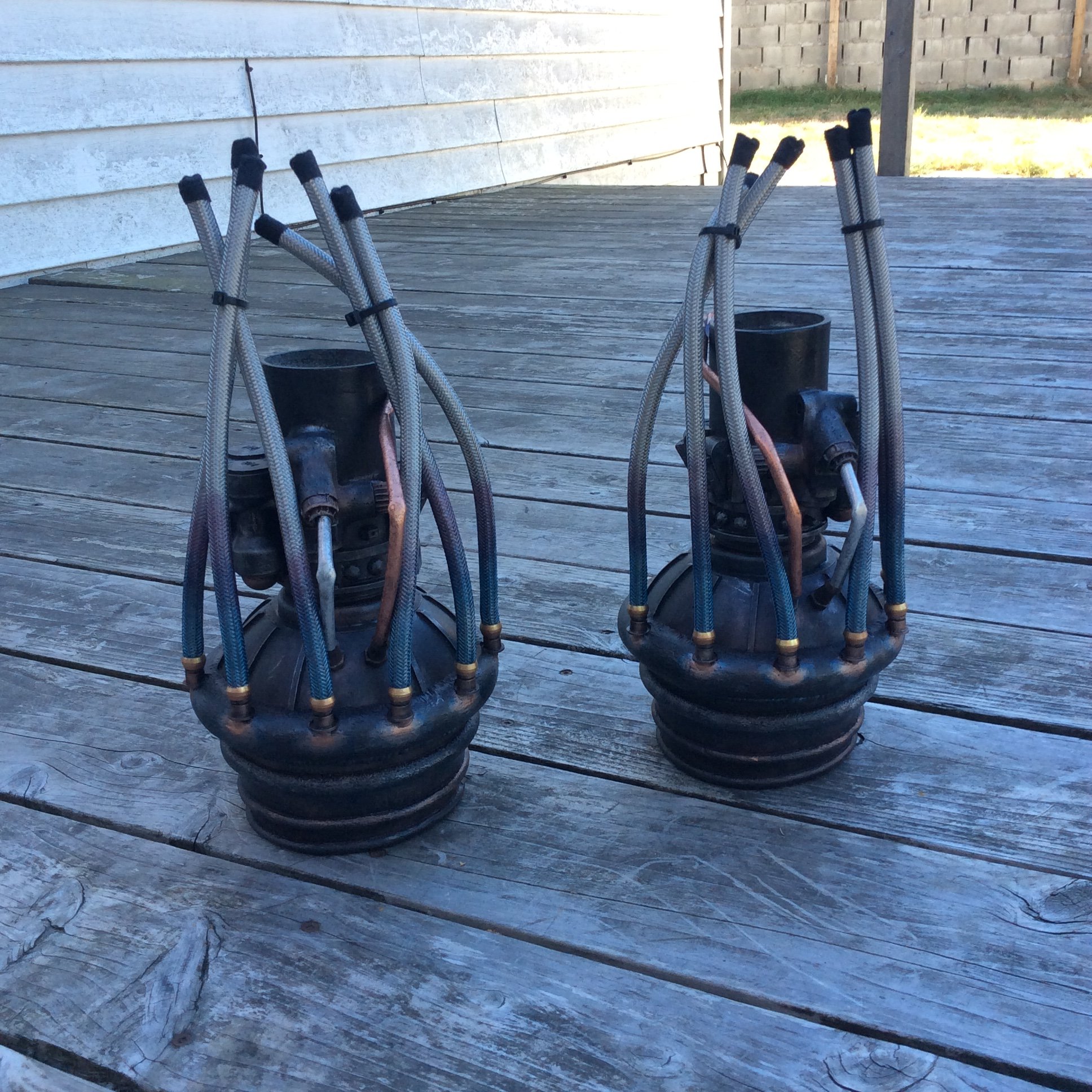

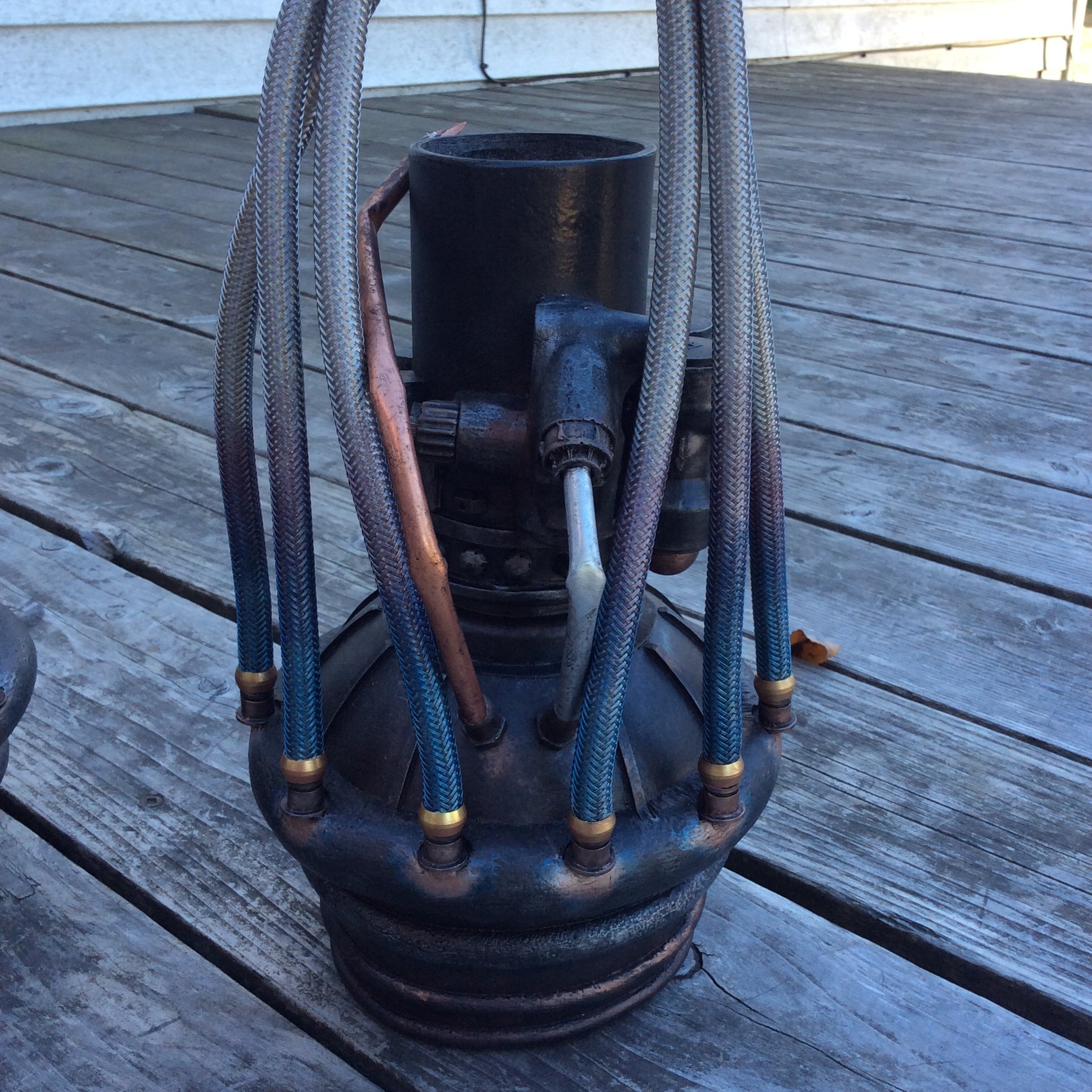

Rockets are finished(for now) and I'm fairly pleased with them. The base color is Rustoleum Hammered black with a coat of matte finish on top. I then used several different rub 'n buffs to achieve the various metallic hues. All the hoses along with the copper and aluminum tubing are held in place with hot glue for ease of future removal.
