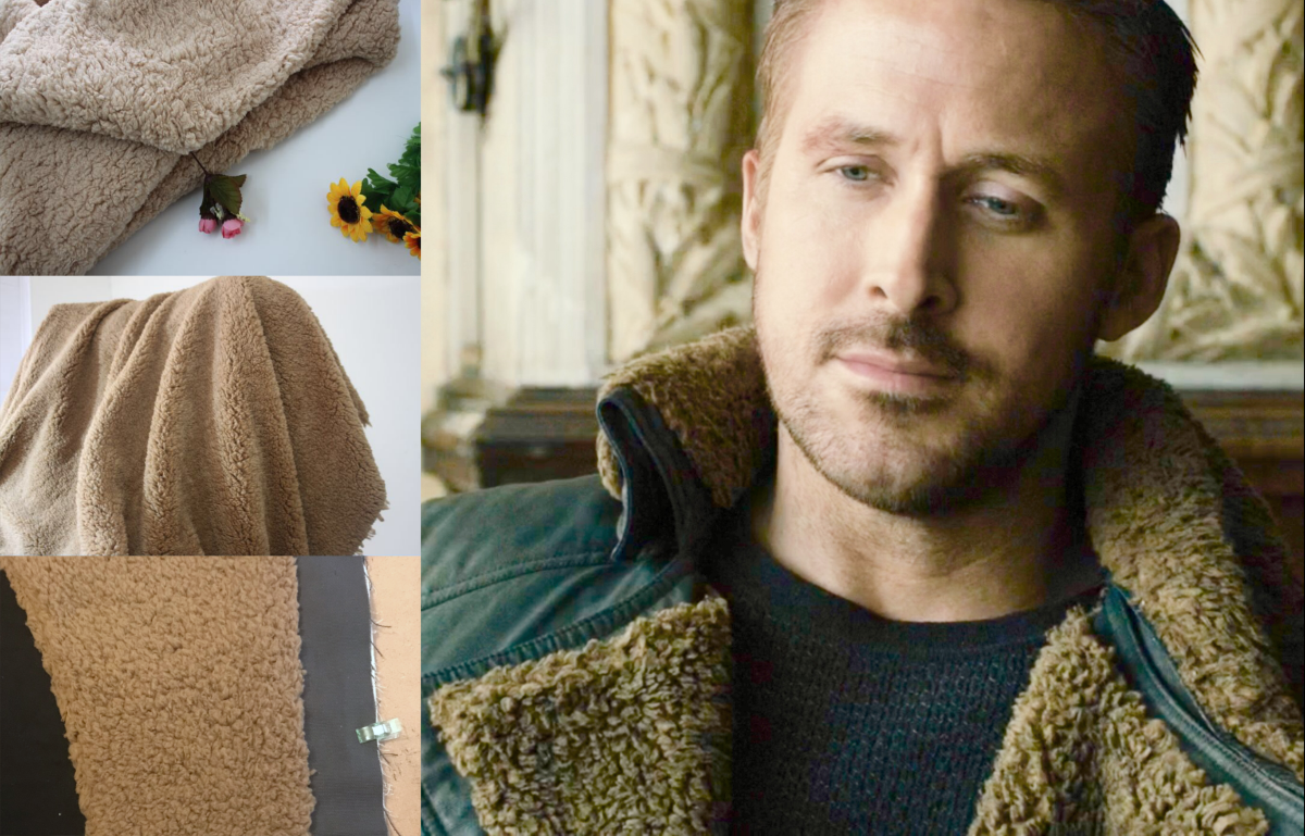

The slight indents on the fur are where I've temporarily attached it to a backing piece of cotton to make it a bit more sturdy (it's a very floppy fleece fur...very soft too) when I attach it to the facings (which might be happening tomorrow).

The fur is machine stitched along the long edges, and hand sewn on along the short ones. It was a little fiddly but I'm happy with the result.
Re: robo3687's Officer K Coat Build - Blade Runner 2049 (Pic Heavy)
That's great looking fur!!!
Yeah I’m really happy with it. I think the pile might be maybe a few millimeters short but it was the closest I could find.
