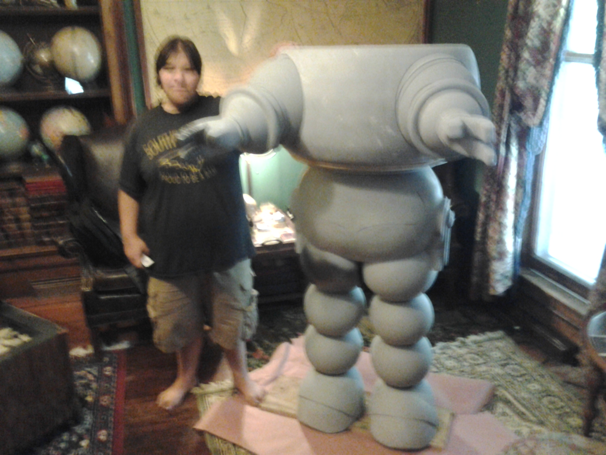

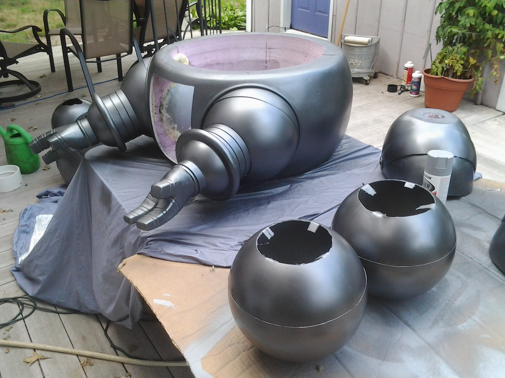

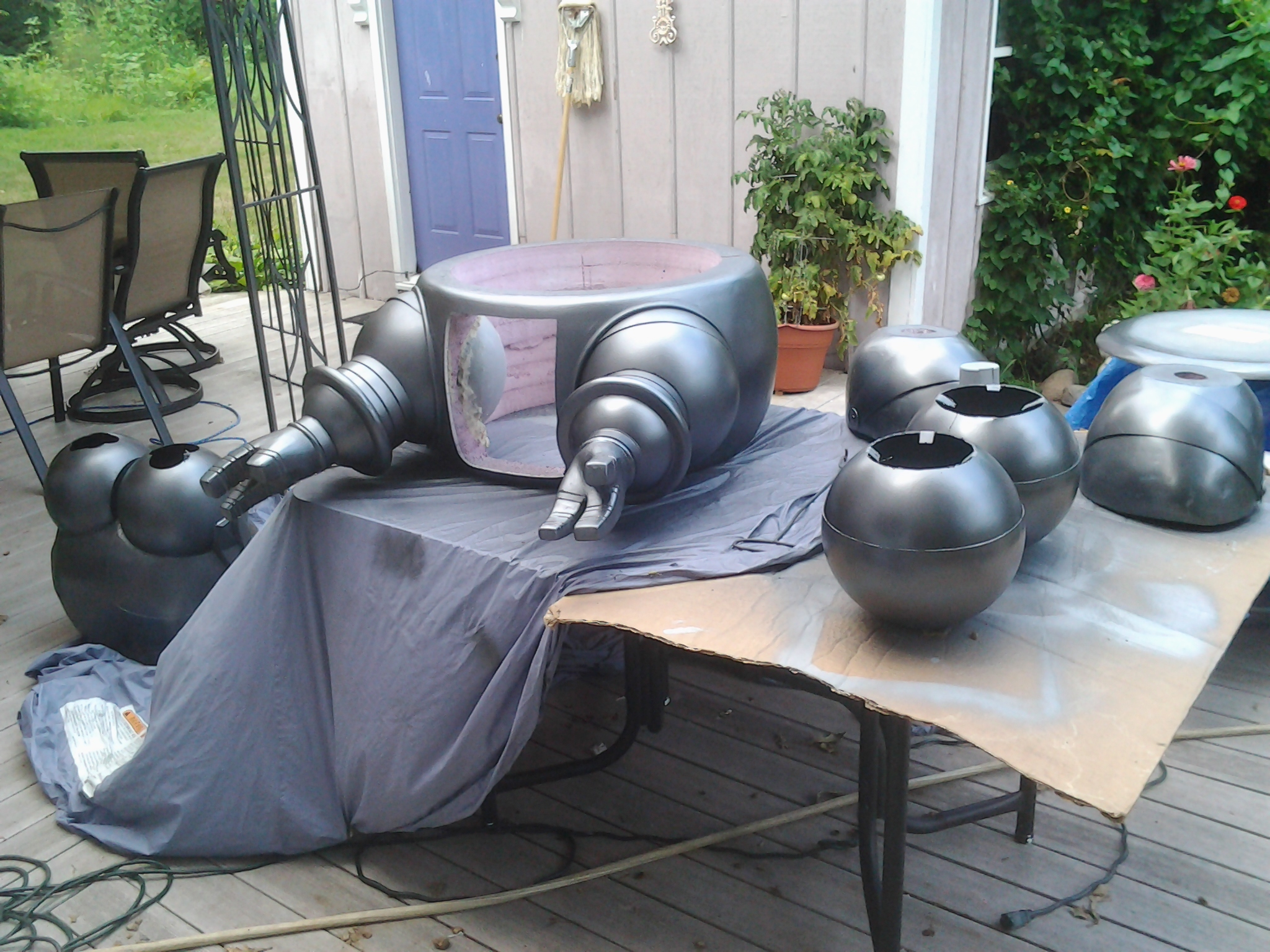

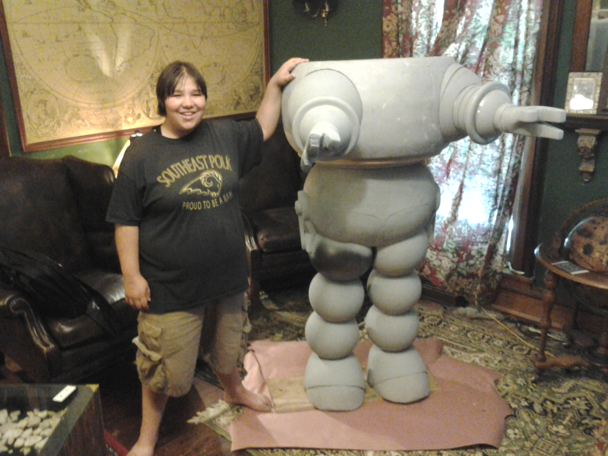

I've been working on a Robby, but I am stuck because I can't find a place to do the dome. Here are a few Pics of the progress.

Edmanrobot, that is fantastic! You need to give some details as what is the body made of (I see Pink foam) also what are the legs made of are those balls vacu formed or solid please help us! He really looks great!:thumbsup
Thanks, the balls for the legs are 10" plastic outdoor Christmas ornaments. the balls at the top of the legs are 12" plastic Christmas ornaments. the shoulder balls are 12" acrylic lamp globes the arms are PVC pipe. the pelvis piece is carved solid foam same with the hands. let me know if you want to know anything else. Good Luck.

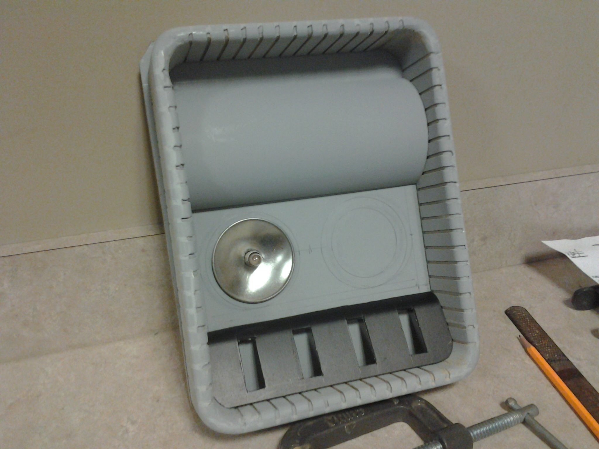

Edmanrobot seeing your Robby I have decided to build one too. On your chest pice where did you get the tray part? And did you cut the slots or was it made that way? Thanks
the chest box was all scratch built, the outside frame was MDF the inner part was plastic sheet. the half cylinder was a PVC pipe.
