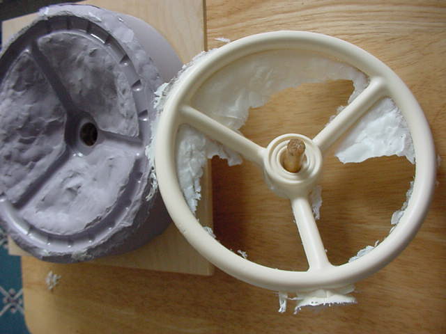

This is half of the first mold I ever built and it worked for ten years before it became so cooked from the heat of curing parts that I had to make another.
The new one has better registration marks to line thing up so I have less flash to remove after the casting cures. Like others have said with silicone molding rubbers you do not need mold release to the original part but if you are making a two part mold you will need it between both sides. I use good old fashioned vasaline

I have made a few hundred steering wheels with no mold release. Since they have such a large cross section they generate a lot of heat during the curing process. and eventually it hardened the mold so I made a new one.
The old one would probably still work today but I did not get the part line centered on the wheel so it was geting hard to remove the wheels. I can not speak for the tin products but the platsil 71-20 that I use does not seem to need it. Of course one of the primary reasons you use silicone is for low mold cost over a short production run. If you are looking to make thousands of parts you should go hard tooling. I would have some concern that the mold release would vary the finished part. after all I have one mold that I did not clean a fingerprint off of the master part and now every reproduction part has a fingerprint on it.
