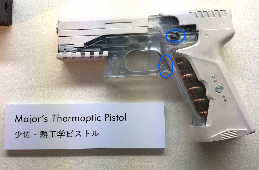

This master is 99% there but will still have a tweak or 2 done by hand. We will add the missed detail on the trigger guard (thanks Sean for pointing that out). We are also planning to use real metal Glock slide releases, so will allow for those to be fitted.

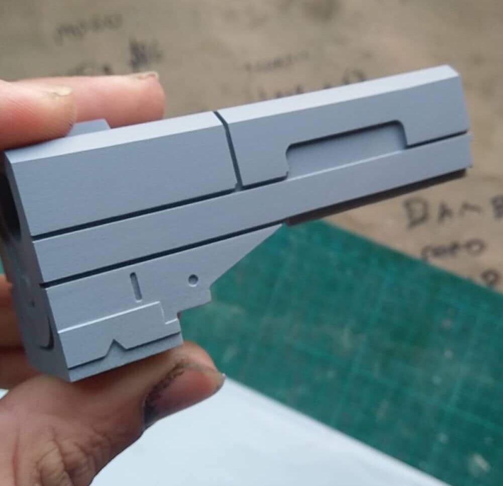

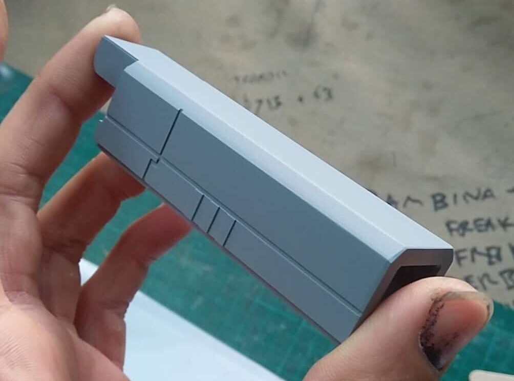

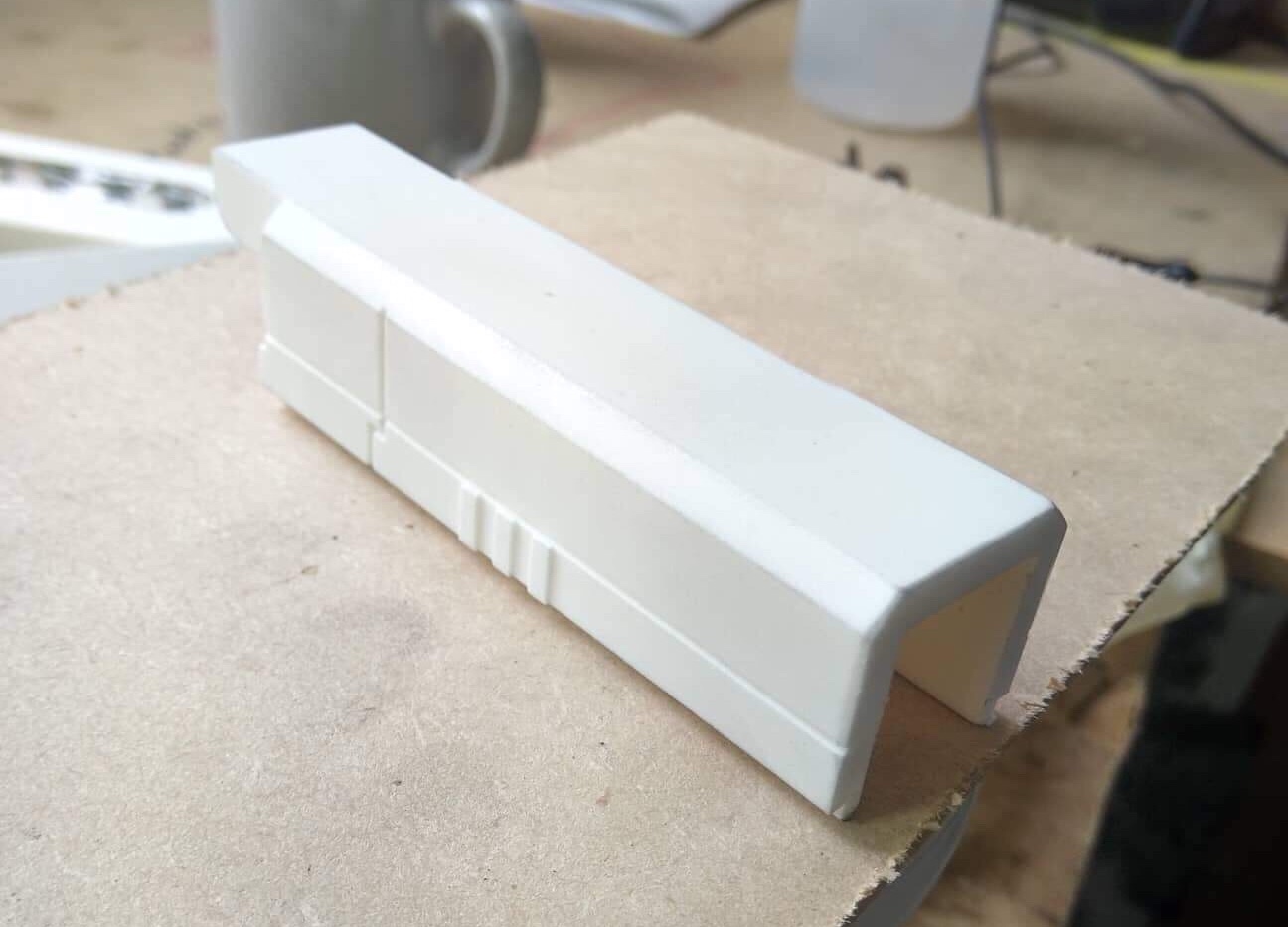

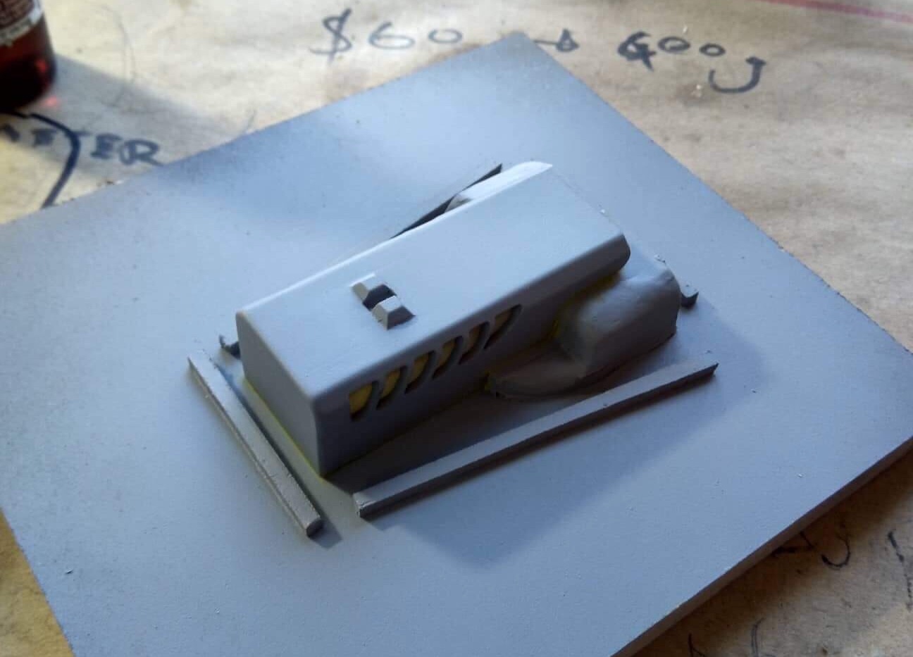

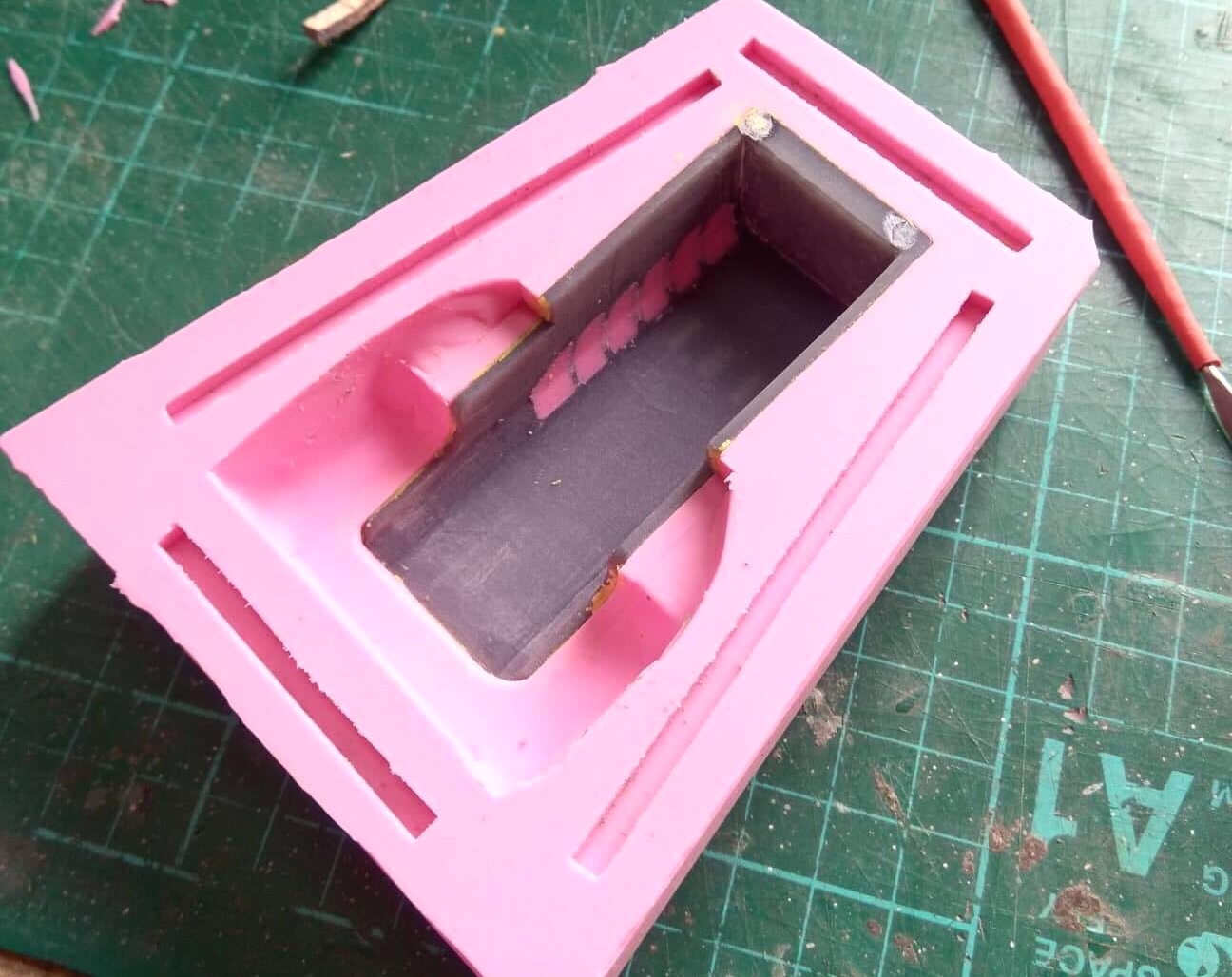

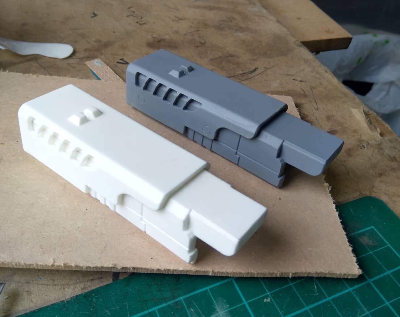

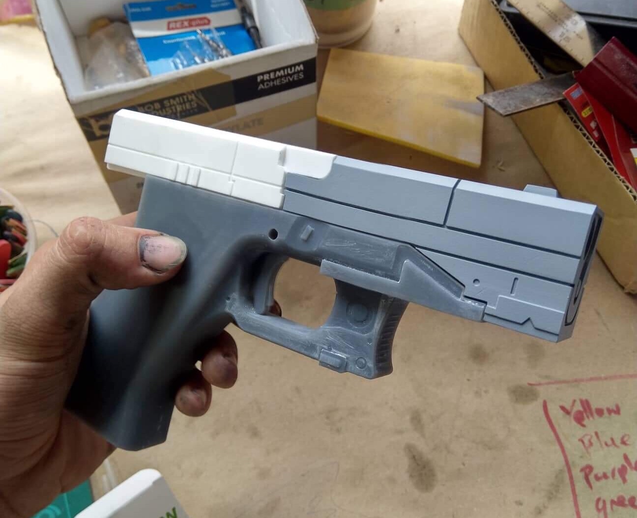

Ok, the master has been tweaked...
Ready to mold...

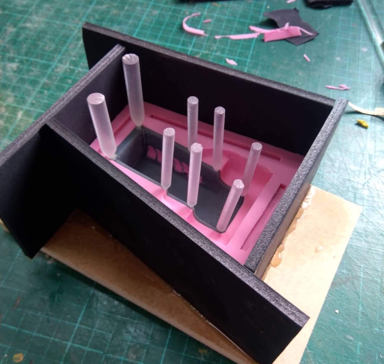

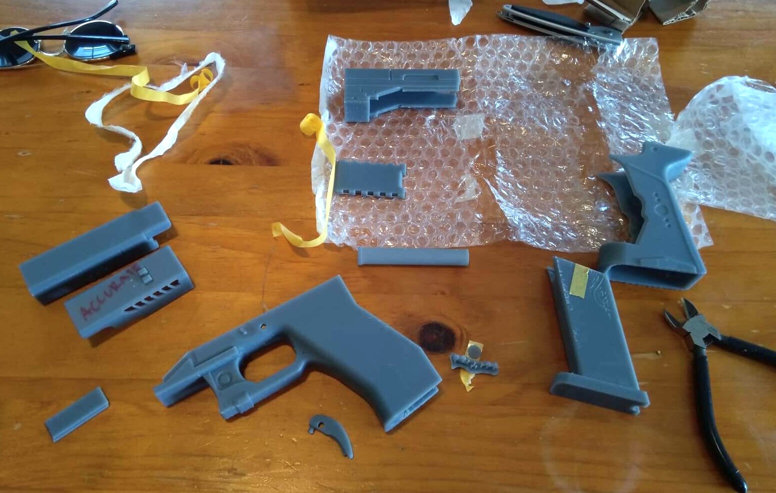

First test castings...

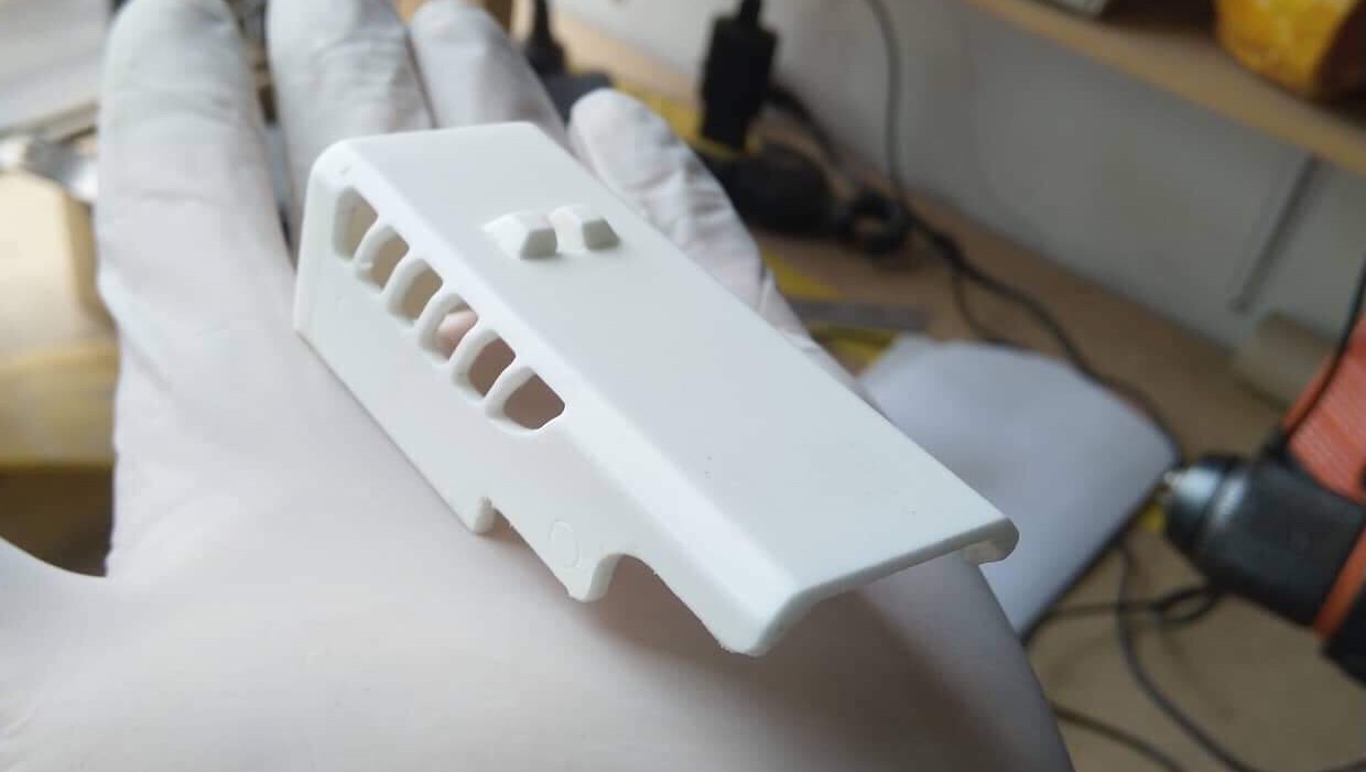

Onto production...

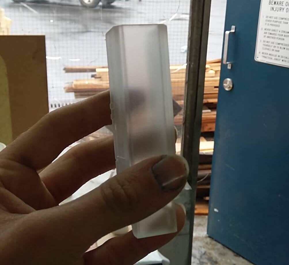

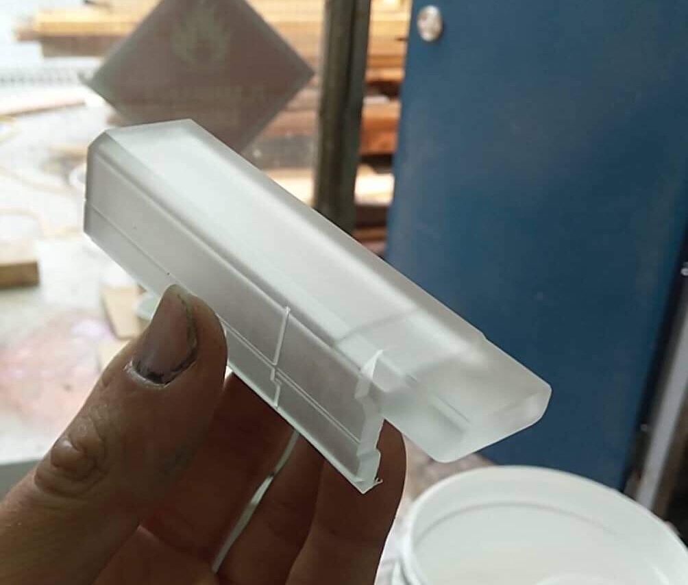

And what you've all been waiting for... clear pieces!

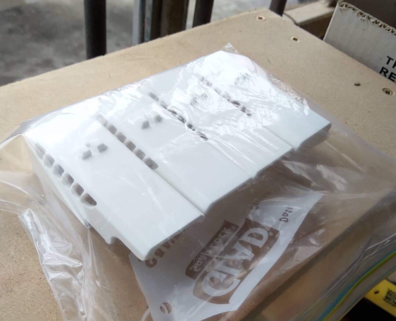

Work continues...

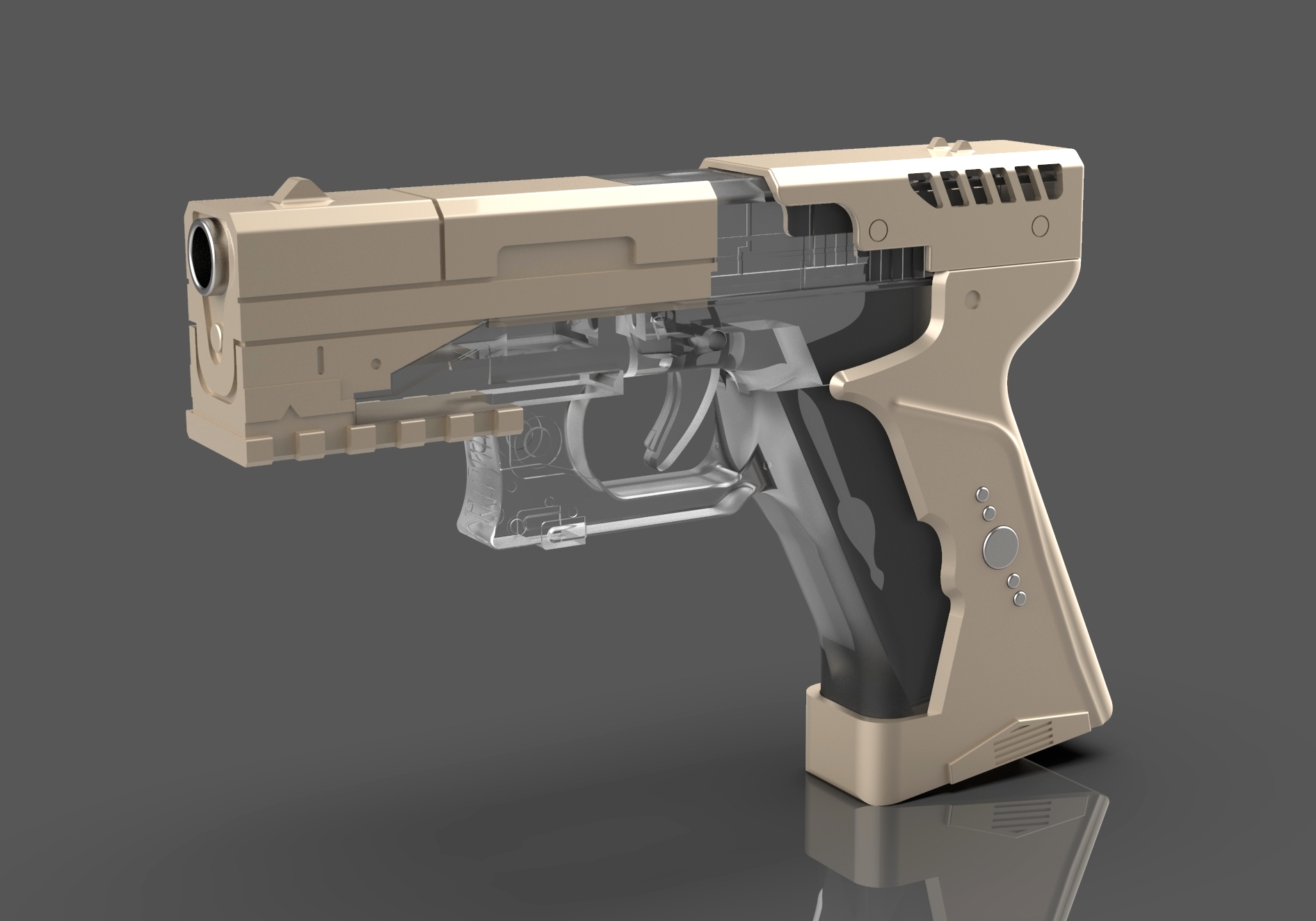

On a recent trip back to New Zealand, I made some very interesting industry connections that have allowed us to offer this incredibly accurate Thermoptic Pistol, as used by Major played by Scarlet Johansen in the Weta produced Ghost In The Shell.
While I can't name names, etc, what I can tell you is that we have had access to some pretty incredible reference material, resulting in what we believe will be the most accurate replica available. Construction will utilise similar techniques used to create the original prop. The master will be 3D printed in New Zealand on a high-resolution SLA resin printer, then prepped for molding. Molding and casting will also be done in New Zealand by a professional prop maker, resulting in a mixture of clear and white resin parts. These castings will then be sent to my workshop in Canada where we will prep, paint and assemble the finished pistols, ready for shipping.

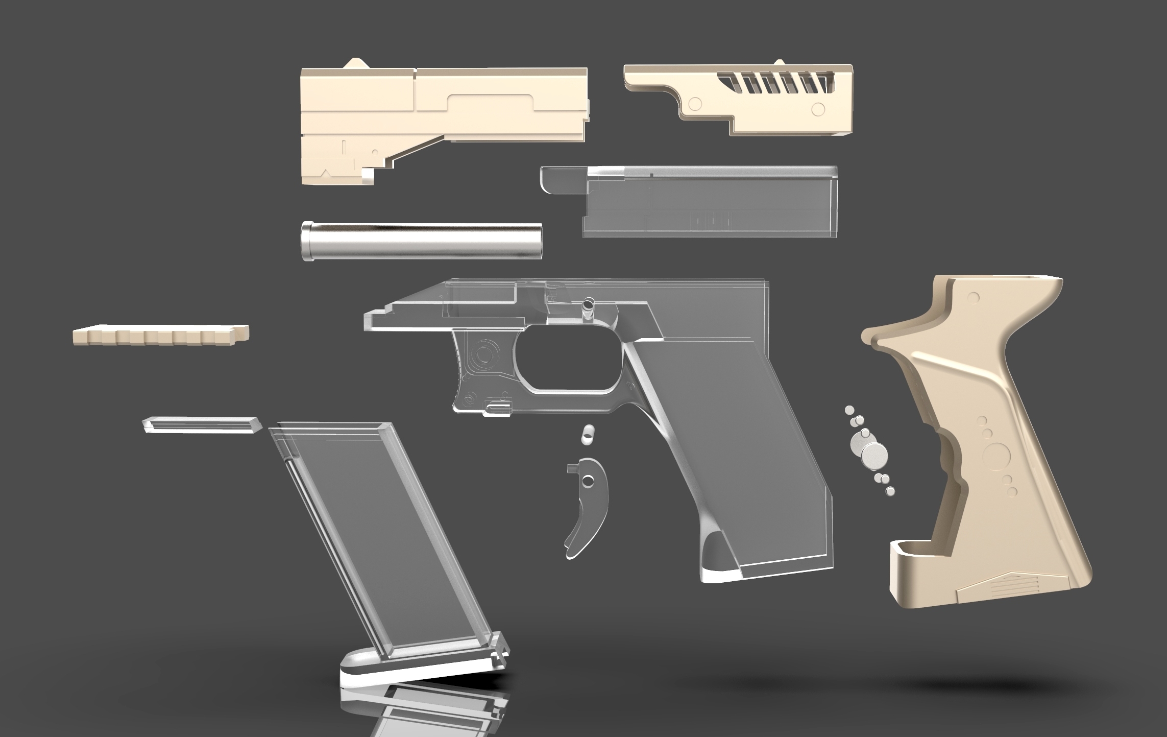

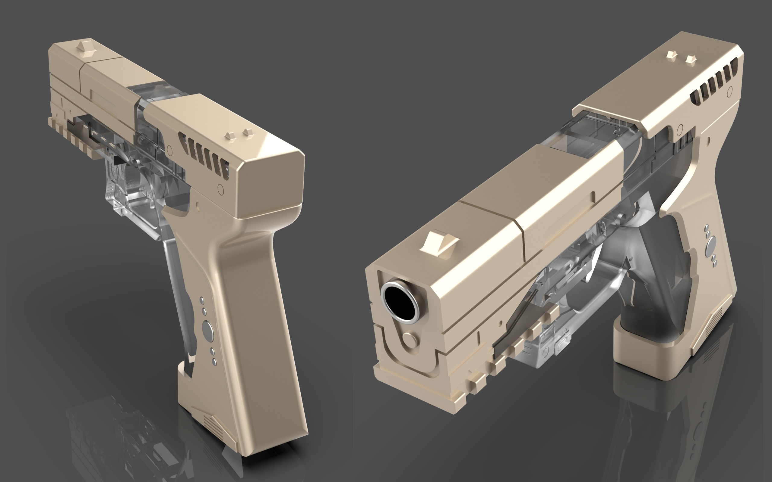

Our design work begun in August this year and here is our final design.
There are 3 changes that will be made by hand to the resin master...
- adjust front and rear sights
- create beveled edge on front of rail plate
- create more curve on the front of the grip shell (at the bottom of the grip)
We printed a test-kit from a slightly earlier version of the design on a standard PLA printer to ensure the parts will work for molding. We are very happy with how this test-kit turned out.
The pistols will have a working trigger, with a visible internal spring like the original prop.
The replica will have a removable mag, held in place with magnets.
The mag will be hollow with a sliding top panel. This is so we can ship the replicas with empty mags so buyers can add their own dummy rounds, eliminating the concerns of sending "ammunition" through customs. The hollow mag fits 9mm rounds which will diagonally stack in the mag, as they would in a real Glock 17. There will be a spring (or similar) in the bottom of the mag to securely hold the bullets in place.
When comparing our test-print to a real Glock 17, the dimensions are spot on. Our rear outer shell even fits perfectly over the Glock receiver.

Bro. any updates on the clear handle part?
So we've had a slight delay... the guy I'm working with back in NZ has shifted cities (and workshops) and is purchasing a degassing chamber to continue casting. This delay puts us a couple weeks behind.
Wish I could tell you who's workshop he's working in... :eek:
