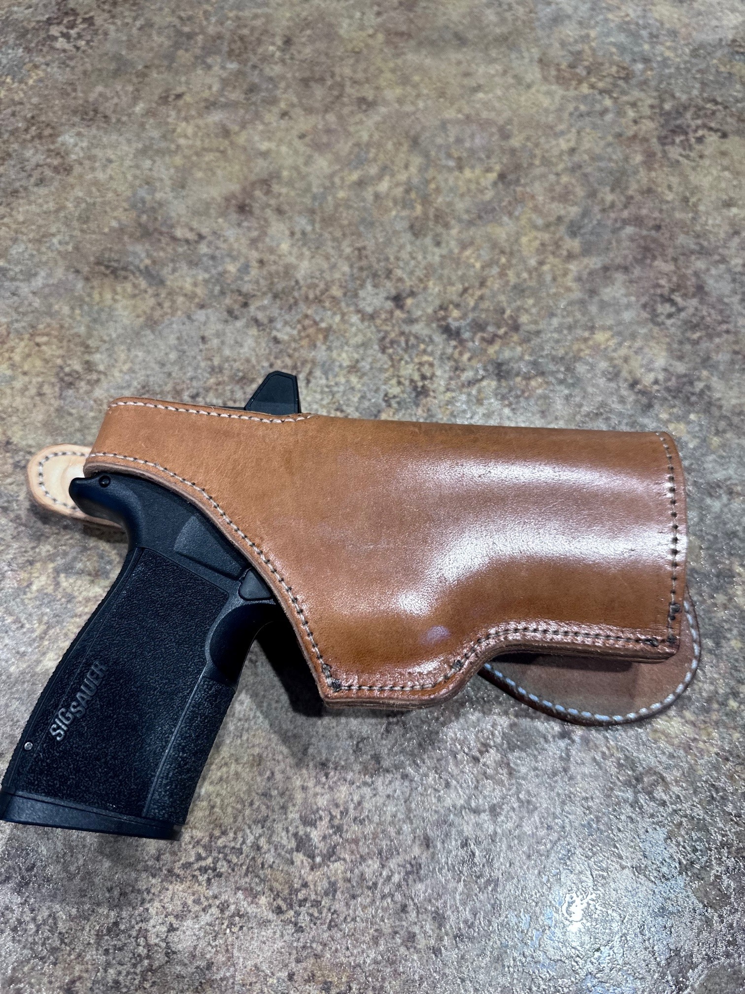

I've been doing leatherwork for about a year now. It's yet another hobby that is expensive. You're going to find yourself doing a lot of trial and error and a lot of experimentation to find what works best together. Different weights of leather will have different qualities that give different results. I've been working with sandwiching leather of different thicknesses recently as I'm working on recreating the Justified holster. A lot of the hardware is hidden between layers. I'm currently working on my third version, with minor tweaks to things I've noticed could be better.
