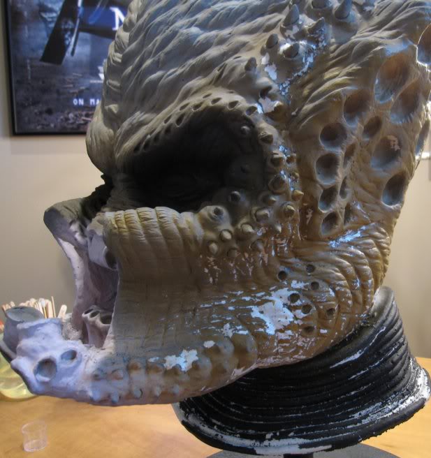

Hi everyone, weather looks like its going to be getting better here in Chicago, so I can get to this hobby and repainting a Howard P1 bust...and I brought with me, more questions!!
Does anyone know any effective methods for removing Createx paint from resin without damaging the bust? I don't know about alcohol, but I do know acetone would completely mess up the poor guy.
Or should I just simply paint over it?
Any input is appreciated
The paint is peeling in some areas even though it was primed. And nope, it's not sealed. The createx I used were water-based airbrush colors.

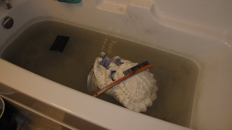

There is no \"easy\" way to remove paint from resin, but it depends on how easy it flakes off. I\'ve had to do that a few times, and each depended on how much the paint was sticking to the resin. The easiest way is to use a metal dental tool or something metallic that can rub the paint off with little damage to the resin. If that doesn\'t work, try a wire brush, but that will no doubt leave scratches on the resin. In the case of your Howard bust, scratches aren\'t a bad thing - it will just look like wrinkles and blend in with the skin.
Here\'s a pic of a resin head that I had to use a wire brush on to remove all of the peeling primer:

Thanks for the picture references! Only some small areas of paint are flaking off, so i guess I dont have to run down the whole thing with a brush. It's just the cheek area, where there are most wrinkles, so I guess the primer didn't make it between the channels.
