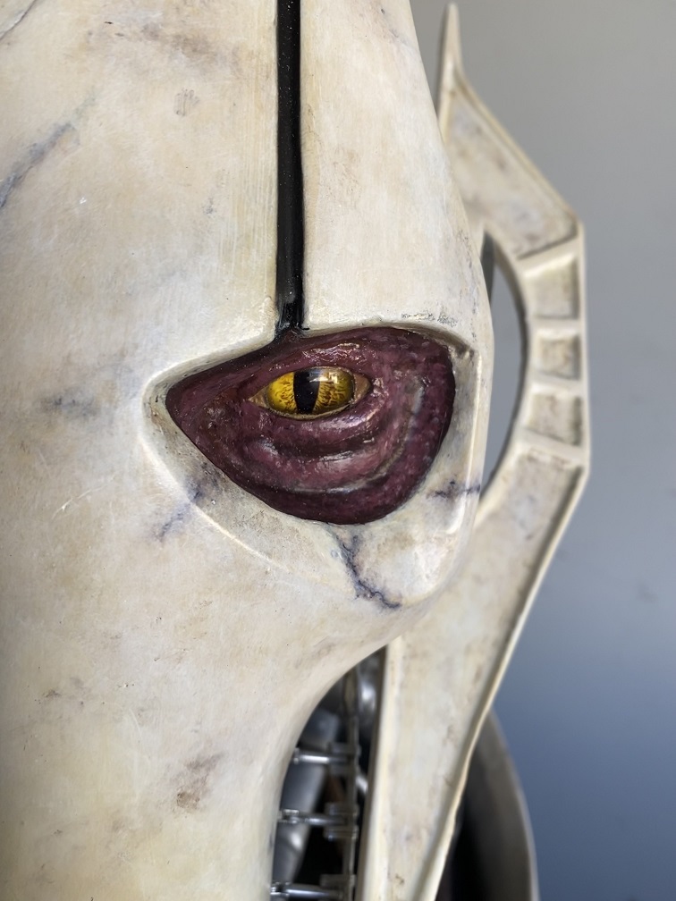

While prepping the pieces with bondo and sanding probably took the biggest chunk of time, painting was a close second. I'm not a painter, so it was some experimentation with figuring out how to get the right mix of stone/plastic/marble look I was going for. Overall, I eventually found a method I was happy with. I can't tell if it's fully coming through in the photos. Some angles on my screen seem to drown out some details.

  • Added glass eyes - I knew I wanted to put some glass eyes in this thing, so I found a pair I thought matched up well on Etsy and spent the time removing the area around the eyes. It wasn't really built for this, so it was a challenge to try to clean out the area in a way where I could put the eyes in through the eye openings while also making sure they stayed put. I used some super glue to get them in place then used some milliput to fill in the space around it and blend it with the rest. The rest was paint and an aqua gloss finish.

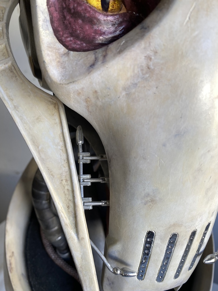

  • Made metal fin greeblies - The metal fin greeblies attached to his mouth were 3D printed, but because they were so small, they seemed to print out pretty stringy. I couldn't quite get them smooth and they were standing out quite a bit, so I went on a journey to rebuild them. I got some blendable aluminum bars and then made a trip to Hobby Lobby, grabbing a bunch of random metal bits in the build-your-own-jewelry isle. I lucked out with some of the pieces lining up perfectly. I then used some milliput to shape the top and bottom parts, which were more specific in their design. Once the milliput pieces were painted, it looks pretty good.

That's about it on the basic details. It was a fun project, and I still plan to refine the grill a bit more, but I'm definitely ready to move to something else. Haha.

Do you mind elaborating on your paint process. Did you use any particular colors, or just go based off of reference.
I used Vallejo Iraqi Sand for the yellow and mixed it with my acrylic airbrush white for a light yellow and medium yellow. Along with the plain white, those were the three colors used for the main coloring. I first started by painting everything in the medium yellow. It looked like a Battle Droid when that coat was done.
I then started to apply the marbling effect and dirty marks. That included a large sharpie, an acrylic dark brown paint, and some alcohol. I woukd draw marks with the sharpie then thin it and spread it out with alcohol on a qtip. I then did the same with a dab of the brown paint on top of the sharpie area. It just adds a more realistic effect when the two colors are in the same space. I also went around and just did some solely dark areas or brown areas for blemishes. Make sure to clean up the edges as needed so it blends.
I then used the lighter yellow in various spots to break up the main yellow color and blend in the marble areas. It lets you balance out and clean up any harsh areas. Once i had a bit more variety with the two yellows and the marble effects were blended a bit, I dabbed white across the entire thing with a cotton pad, wiping/blending with another paper towel as needed. I then touched up some areas by going back with a fine tipped sharpie to add more detailed lines over the marble areas.
In the end I still think it looks a bit too clean. I plan to go back and add more blemishes and redo the scars. The angle of the ones on the print are a little off so ill fill them in and create new ones.

Sorry to necro - but did you get the eyes from Megan Petersen (her Golden Dragon eyes)? If so, what size (in millimeters) did you get?
Sorry that I didn't see this earlier. Yes, these are the Megan Peterson golden dragon eyes. I bought a few, but I believe I settled on the 20mm.
Thanks. And now that you are all done, do you stand by the 20mm, or would you go a little bigger if you could do it again? I ordered the 14mm (by just guesstimating), and they were way too small.
Yeah, the 20 are what I preferred so you can get a sense of the shape of the pupil. The bigger ones cut off the tapered part of the pupil so you dont get as much of the “dragon eye” effect.
