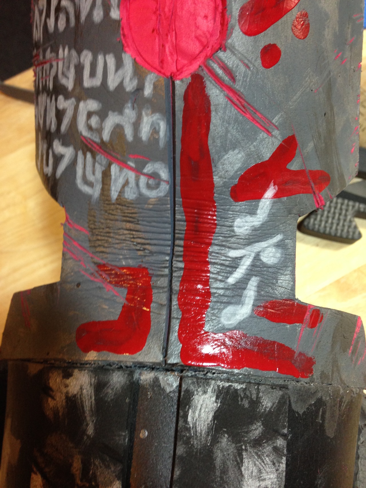

  • He didn't use any of the Unitologist symbols like I had asked him to. He just slapped them on there. Repainting it all and adding the correct symbols along with better weathering, nicks, and more blood splatters. [making the unitology script actually say something instead of just random symbols]

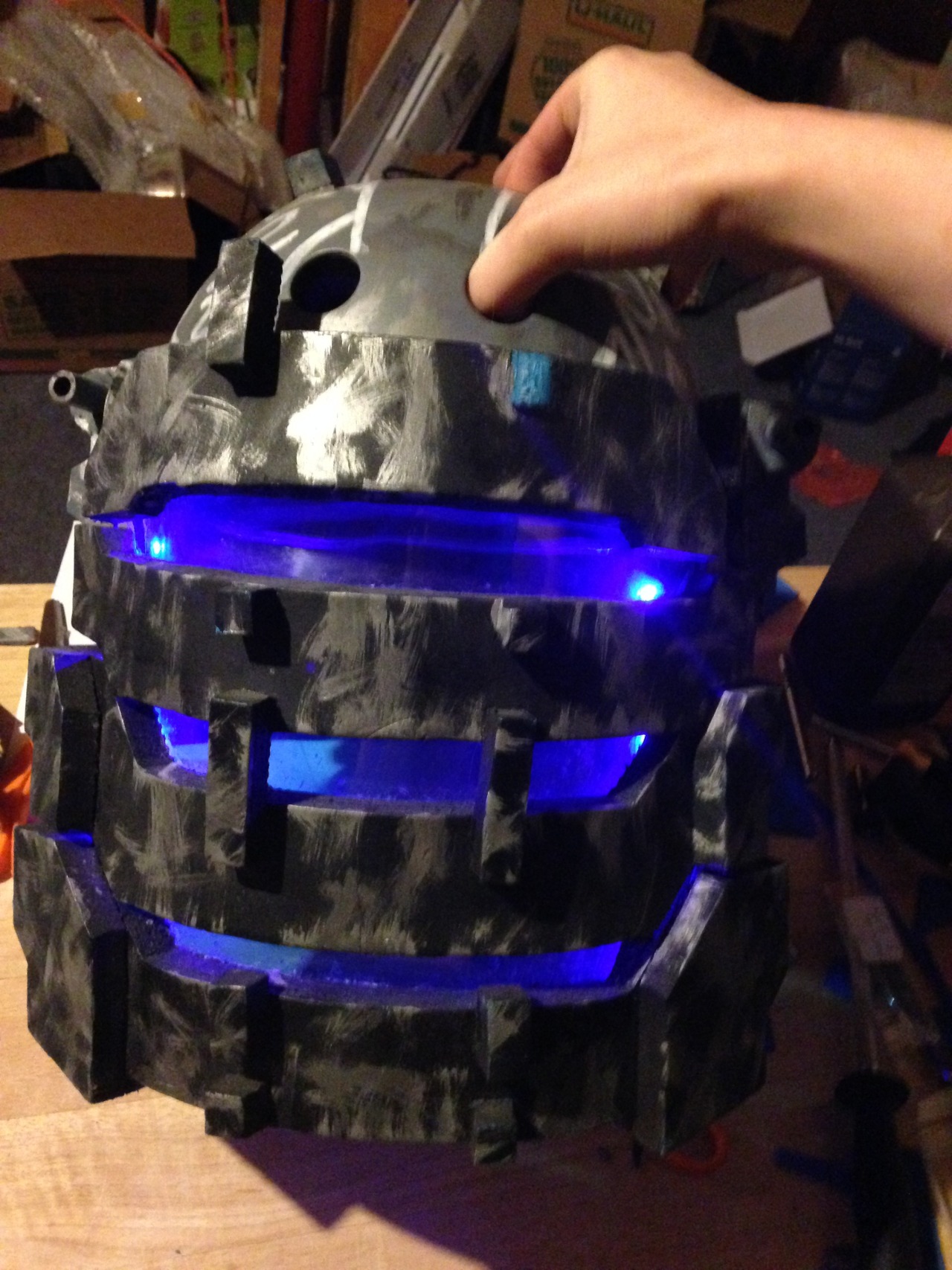

  • The helmet was huge. Doesn't even fit me and makes me look like a bobble head. The only thing that can be salvaged are the LED's.

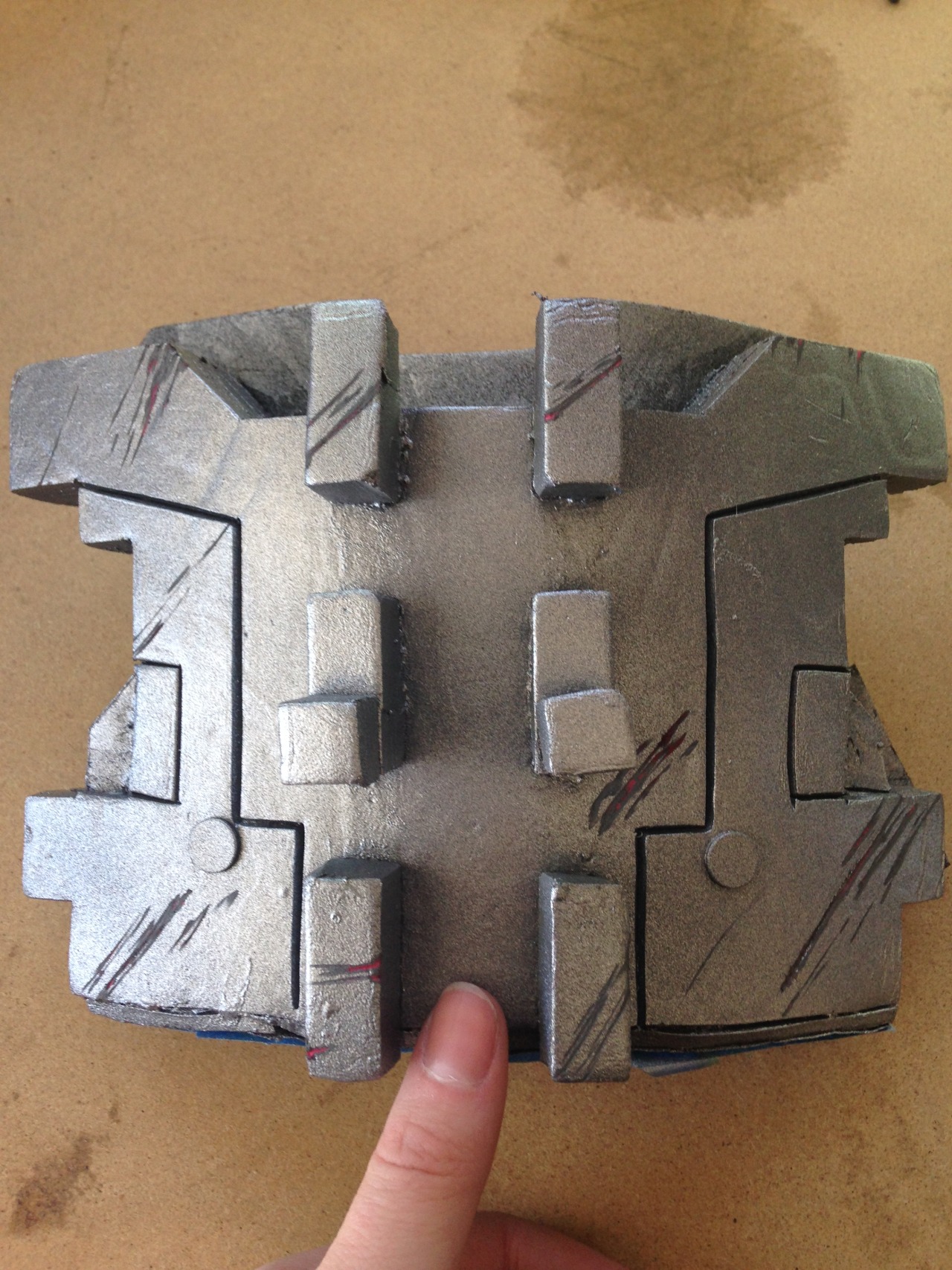

Added some small details to the chest... thingy. Small details but it already looks better!

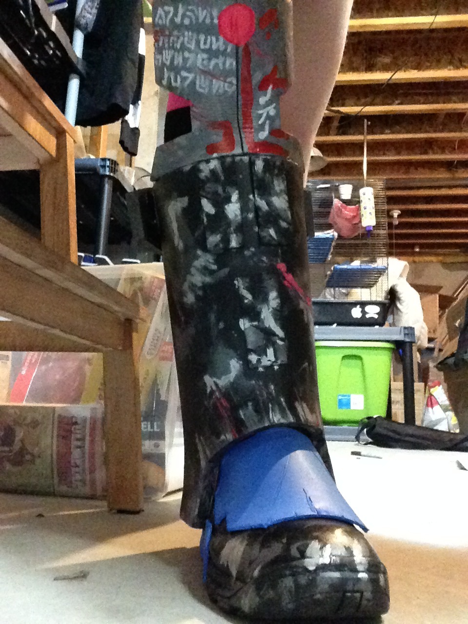

Fixing a big part on the two pieces that go on the back of the boots.

Will be taking apart the helmet today. Just have to do it so I don't damage the LED's.

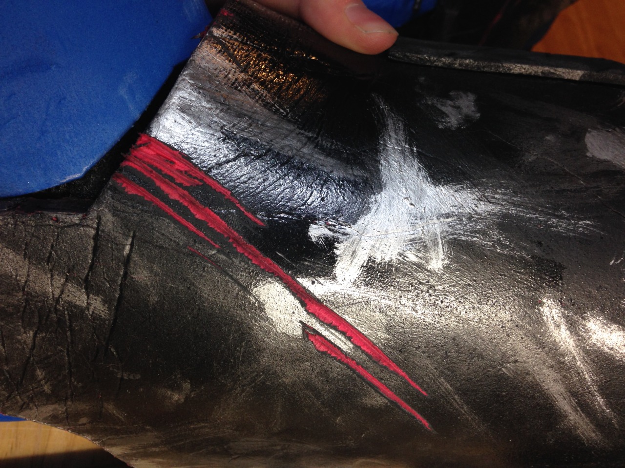

AUTHENTIC BATTLE DAMAGE

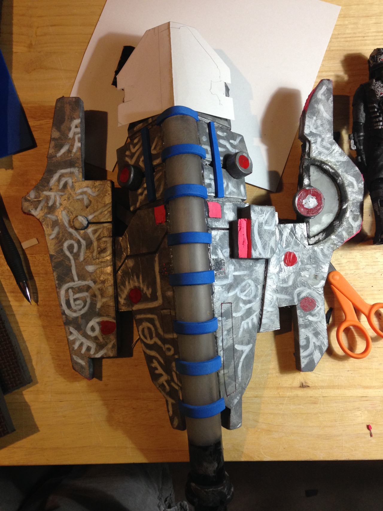

Improvements on the RIG back.

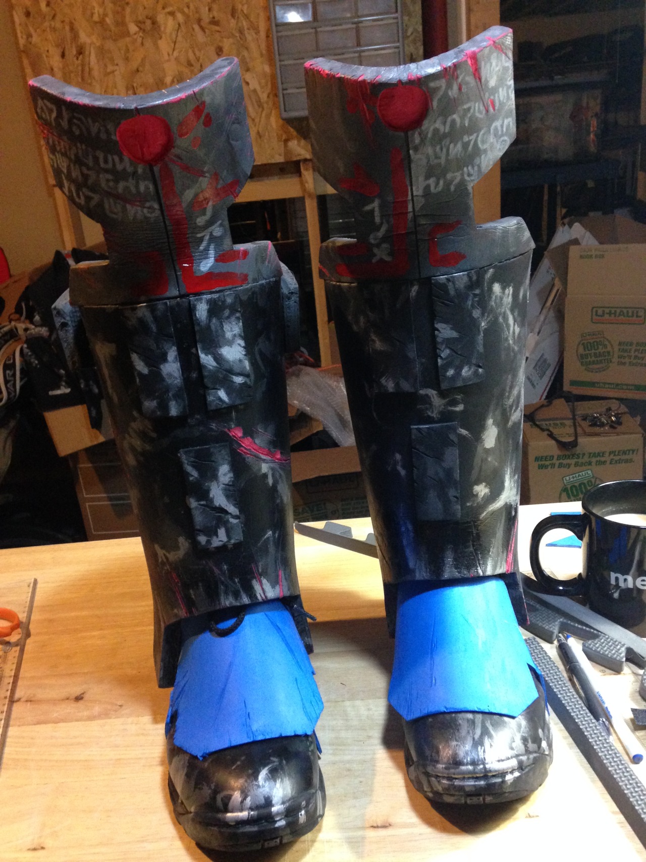

Improvements on the boots!
The shin armor actually slides on first [added elastic to the inside of this too because velcro is so noisy] and it works great!

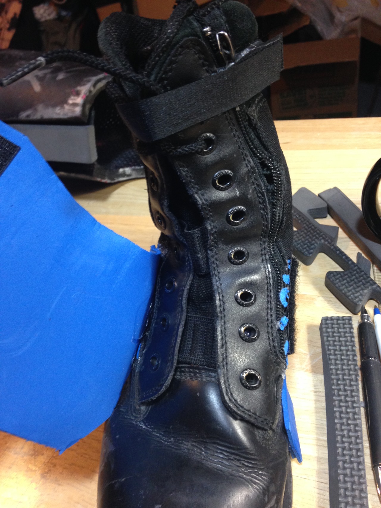

Took out the laces on the boots and only kept them in the top two rings. Velcro at the top makes sure everything stays snug and the laces are out of the way. Elastic on the boot makes it so I can just slip my foot in and out with minimal difficulty. Top "panel" is velcro so I can fix elastic if I need to.
