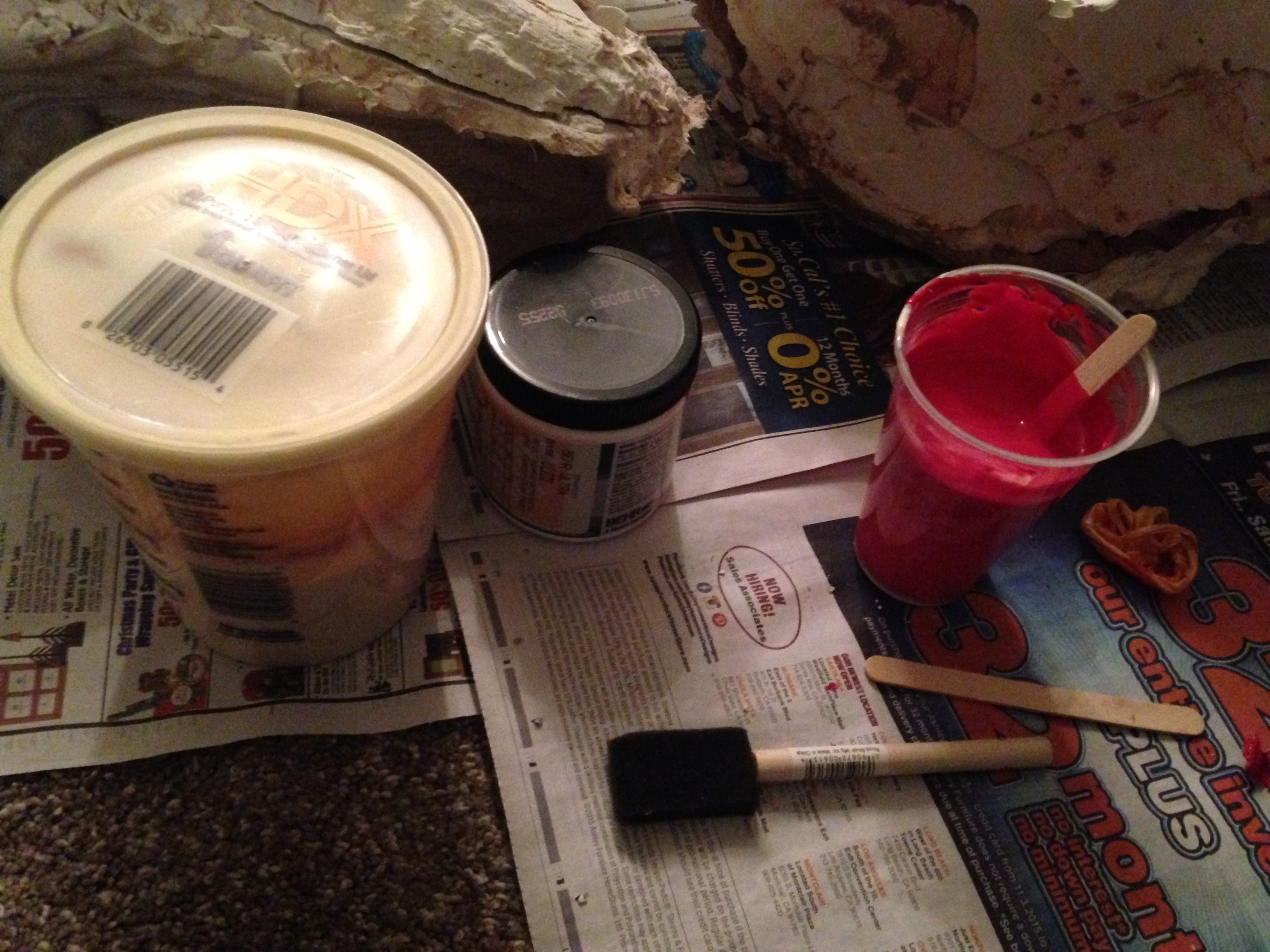

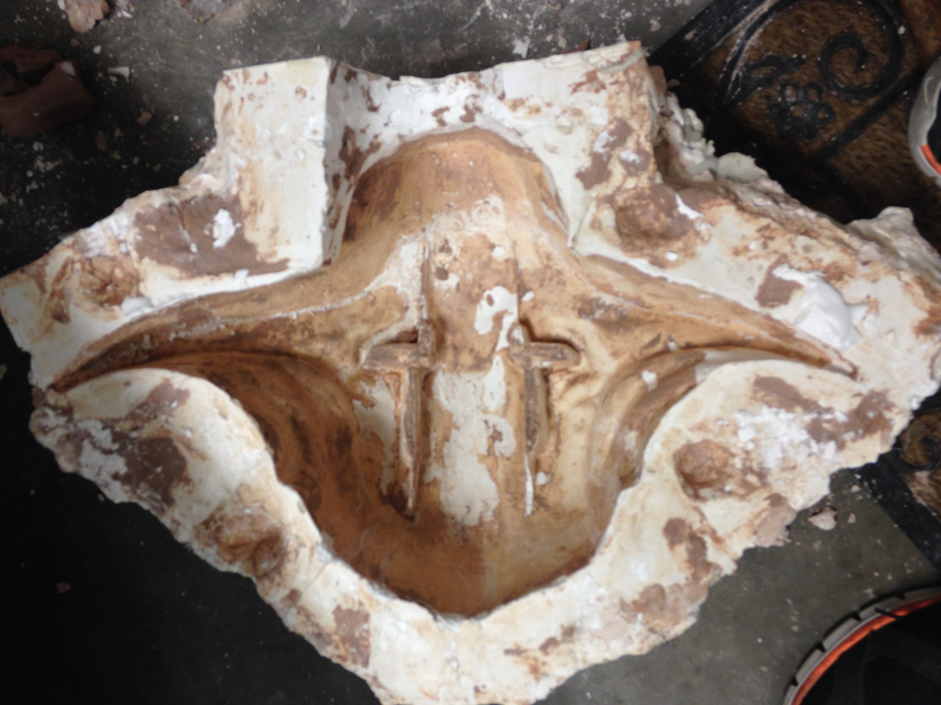

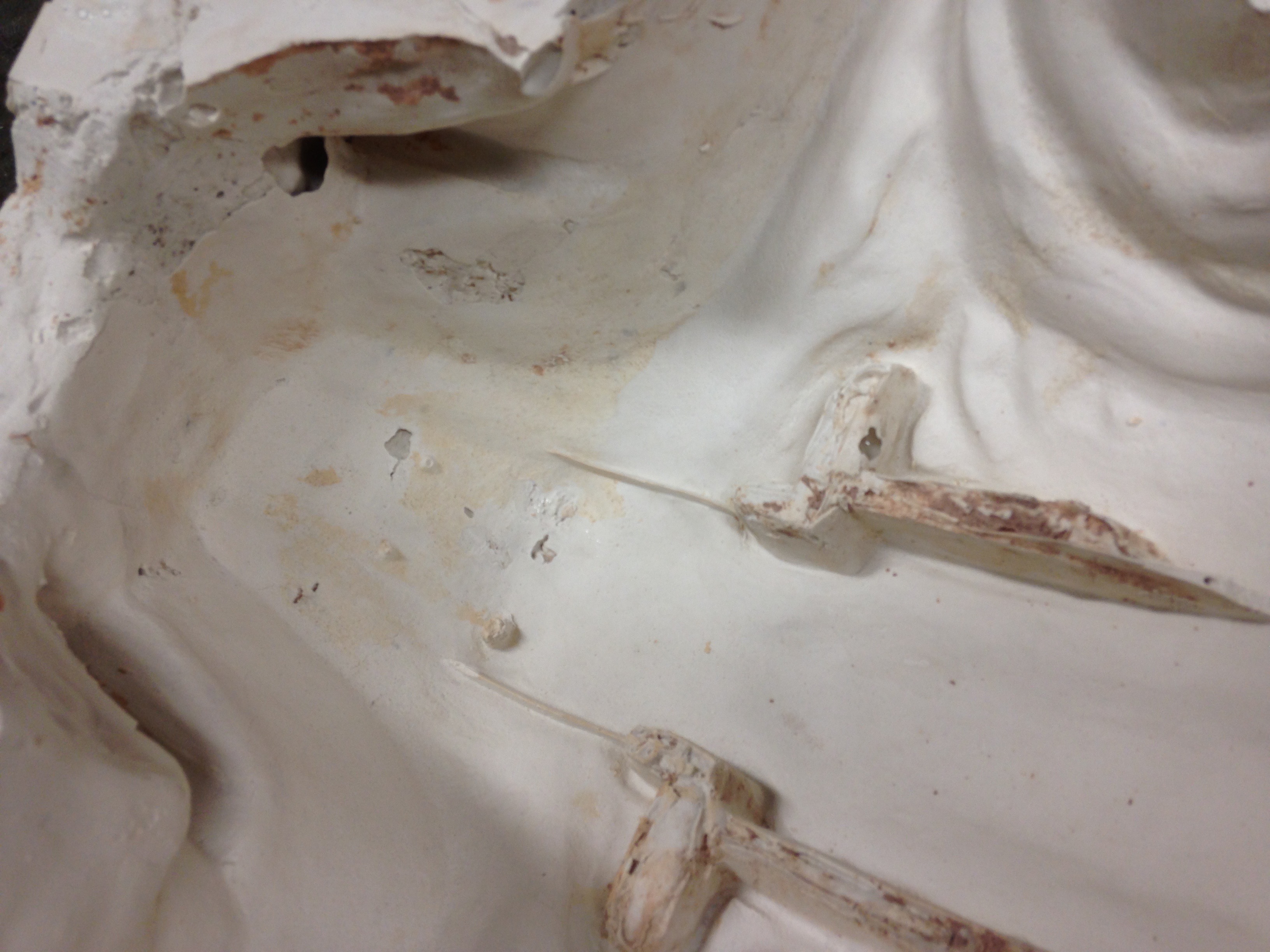

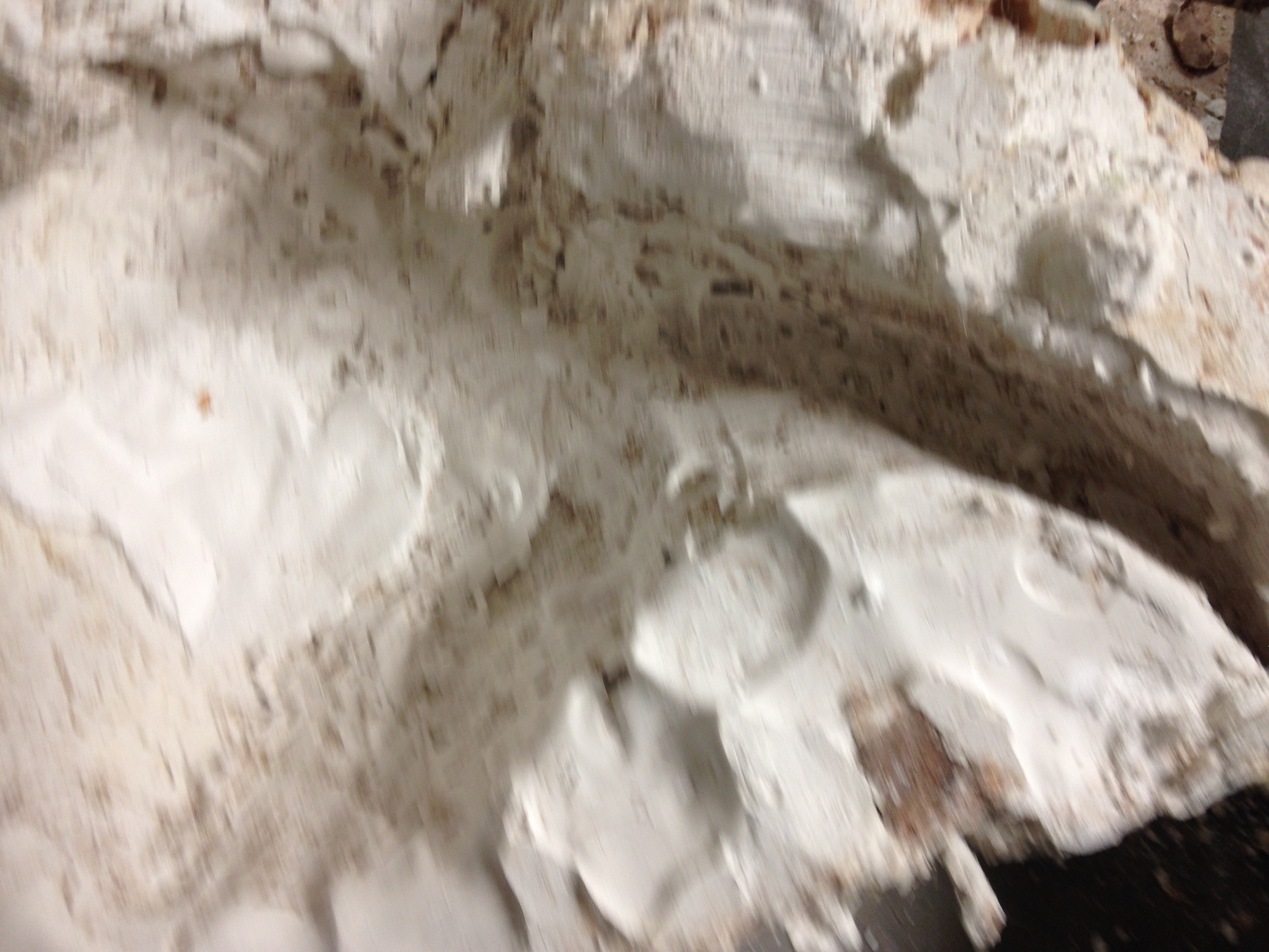

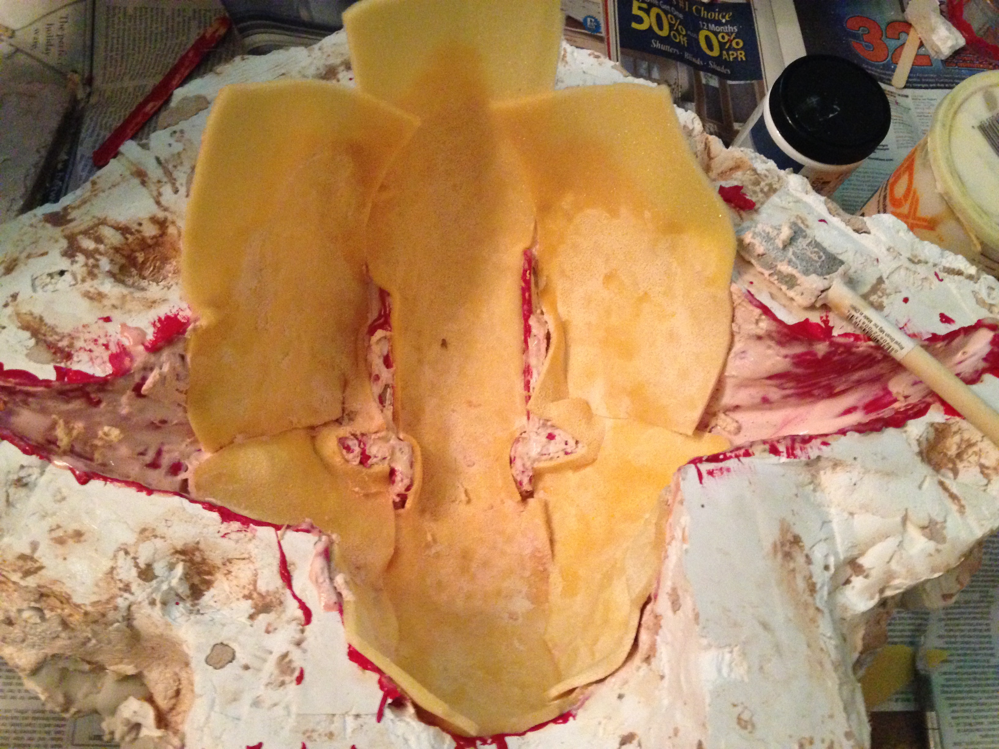

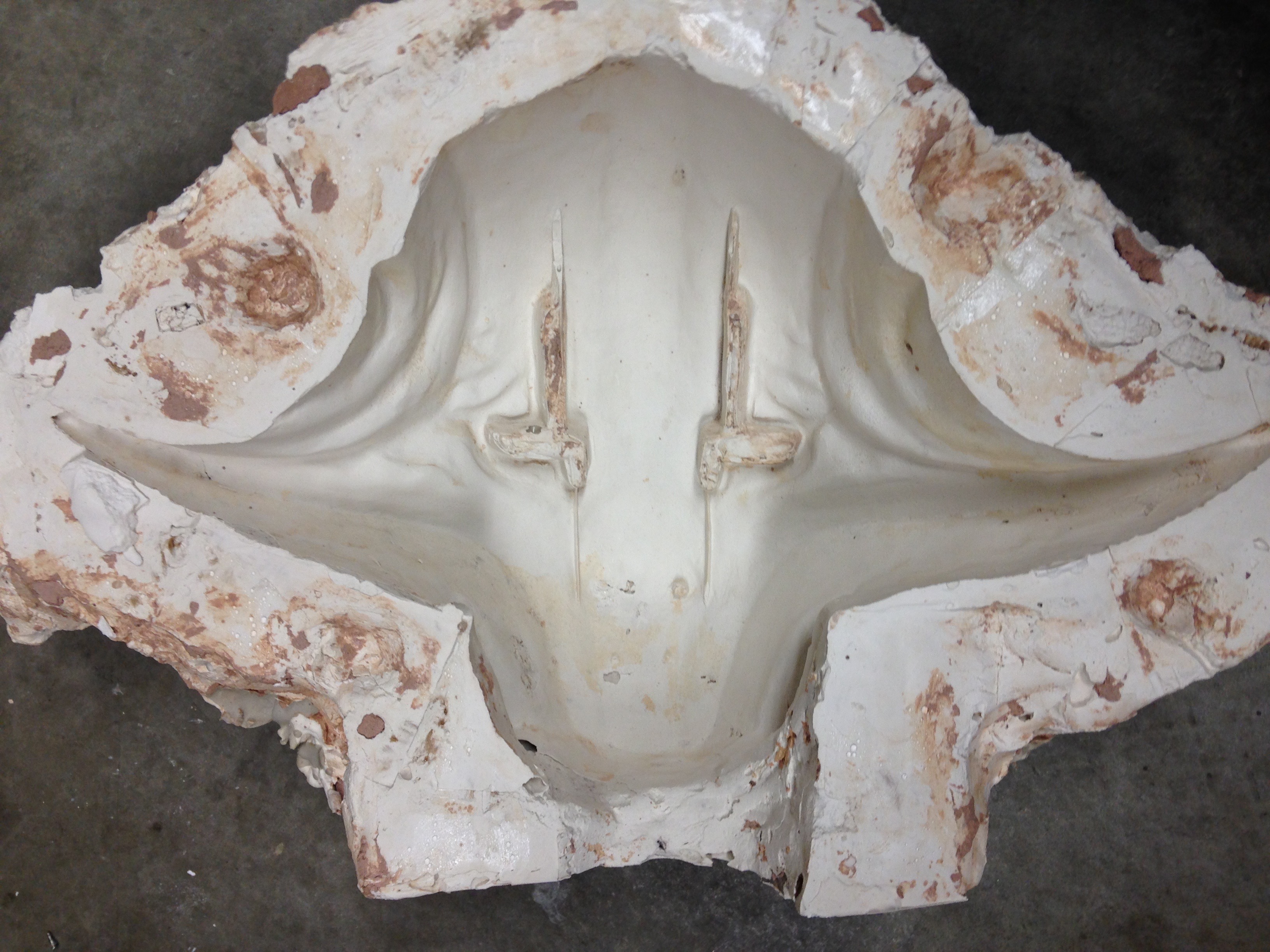

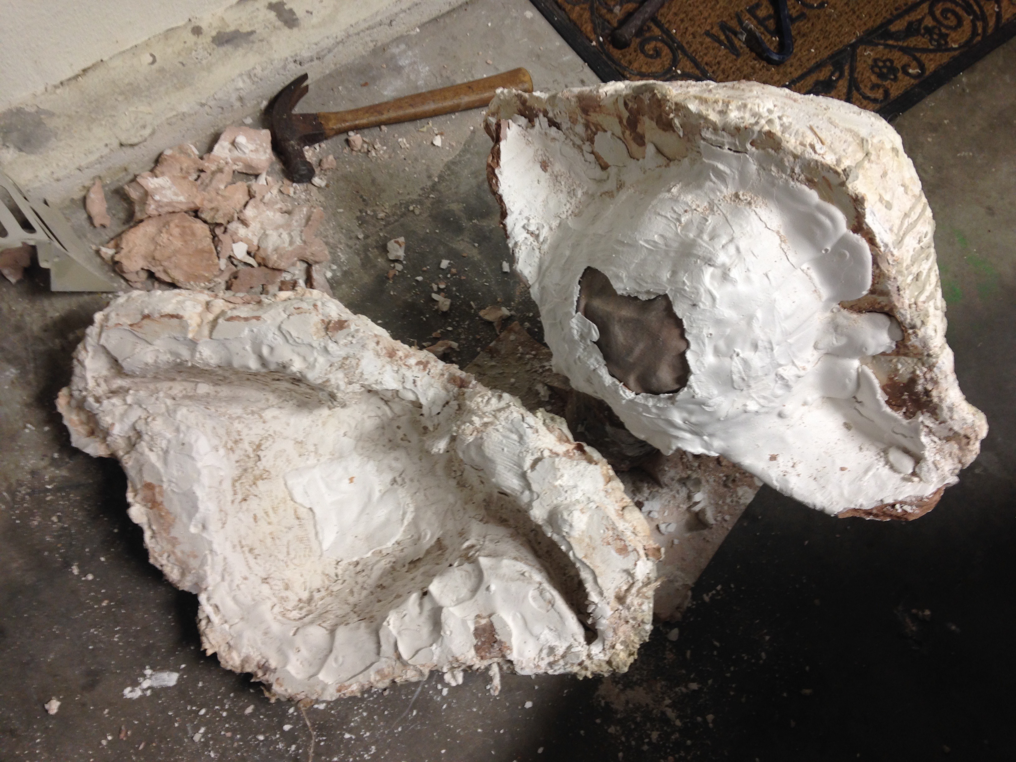

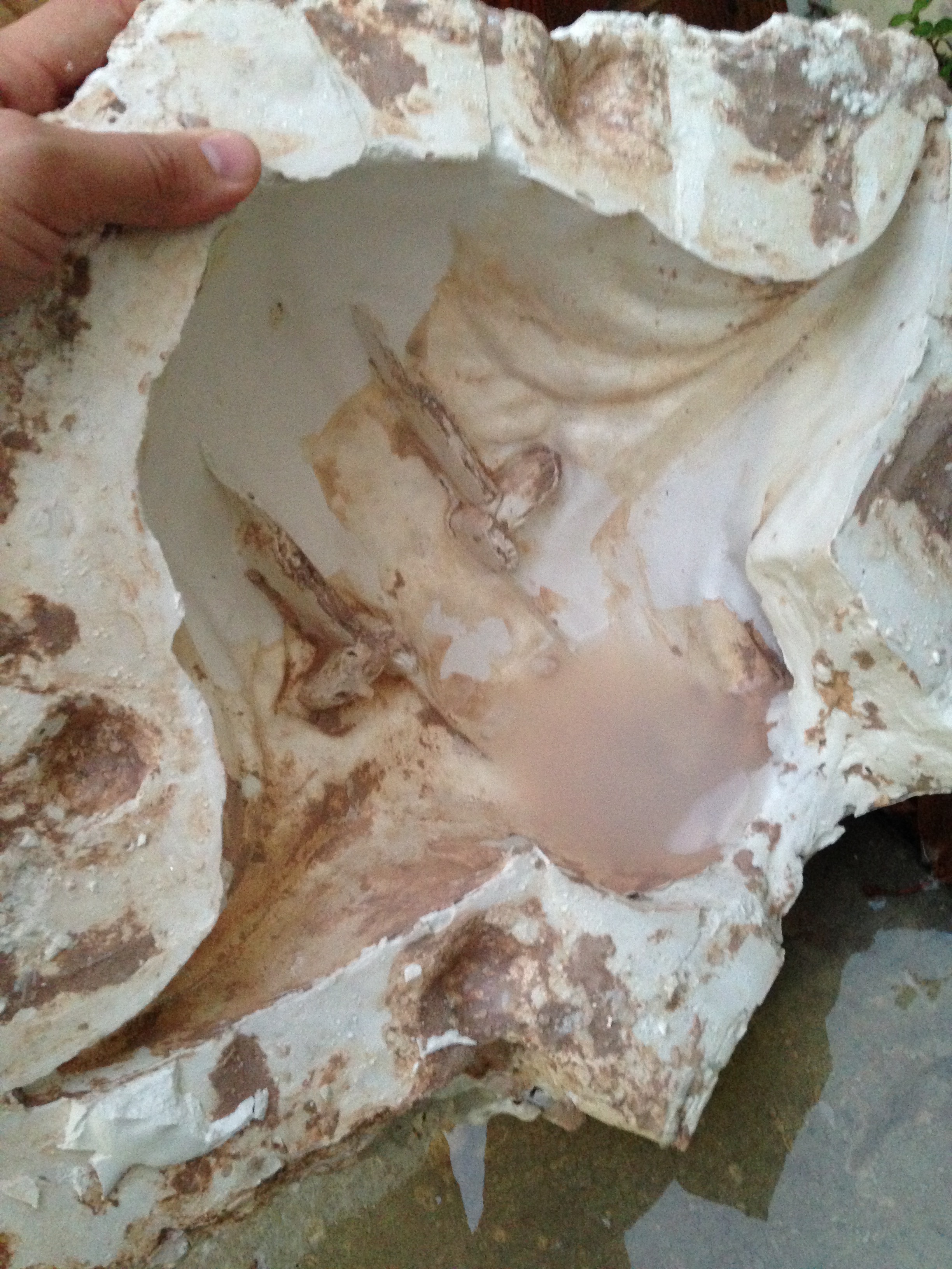

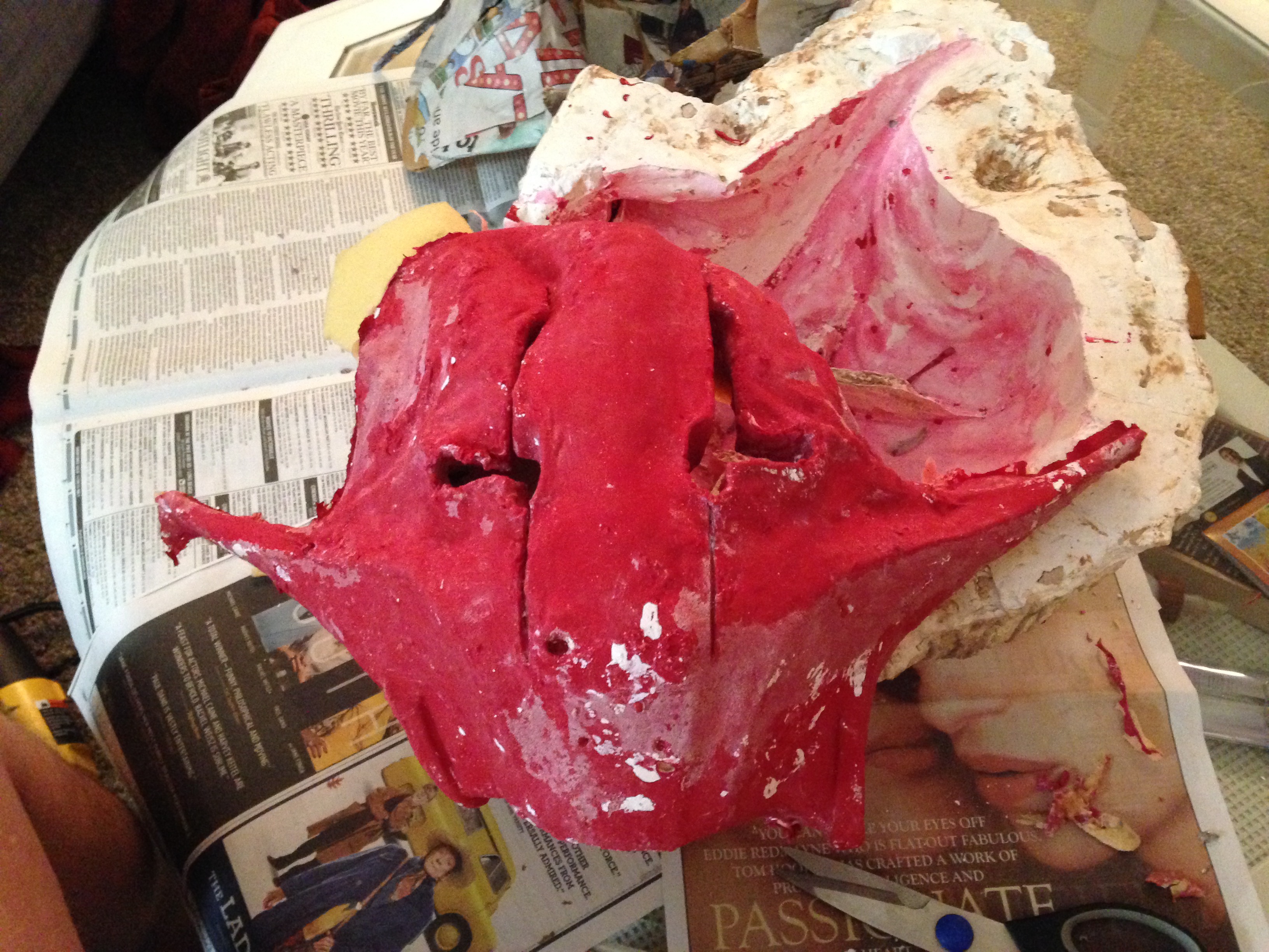

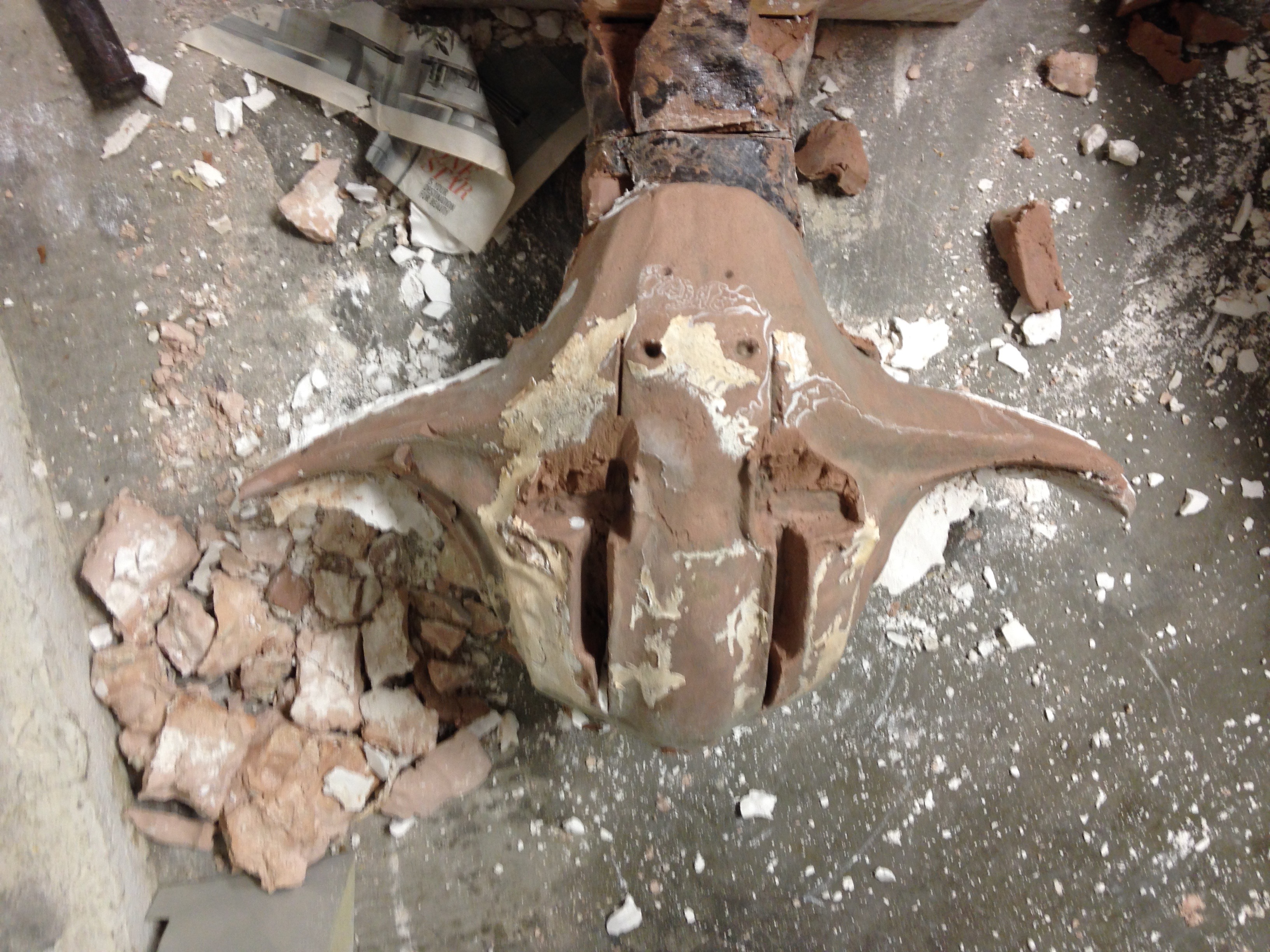

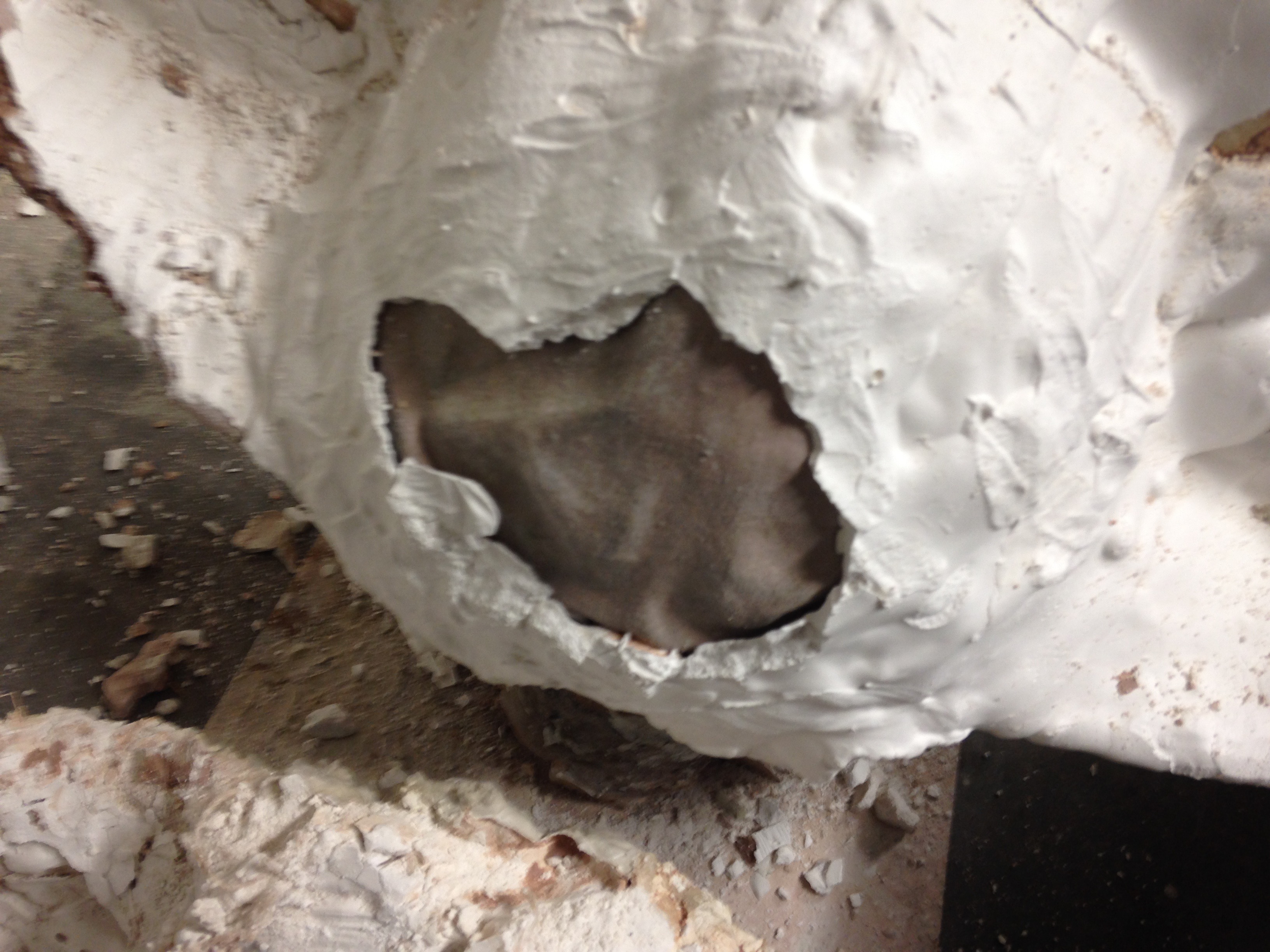

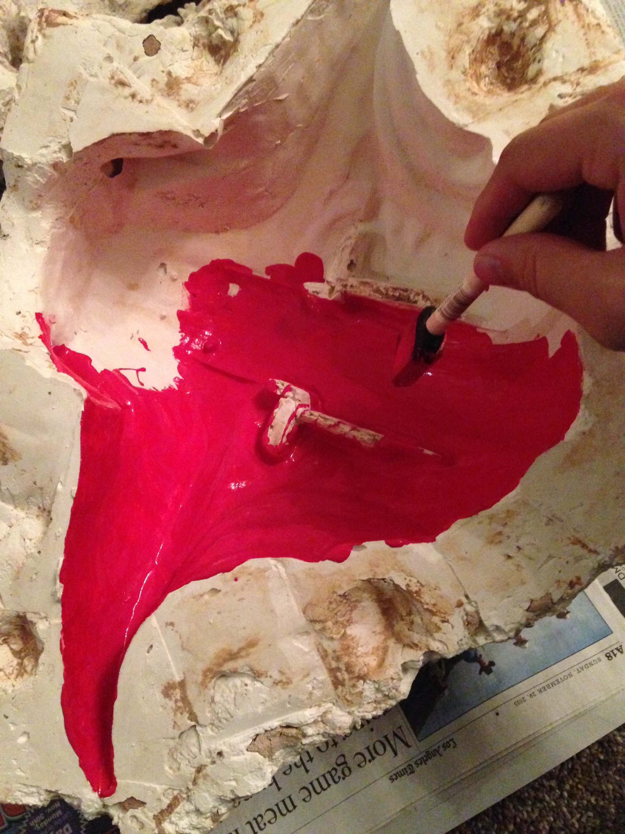

Hey guys. Sorry it has been so long since my last update. I think I have seriously misjudged how much I can get done with a newborn baby. So I am still working down to the wire to make the premiere and I will need to keep this post short and simple so I can use the time to work. I finally got to crack open the mold and it was a catastrophic failure. The first layer of plaster that I put down to capture the details was completely crumbly and turned to powder if you touched it and it also delaminated from the rest of the mold. It probably has something to do with how I ran out of plaster halfway through the back of half of the mold. The front turned out really well though. I cleaned it up and mixed up some latex based house paint with the liquid latex and started casting the front half.

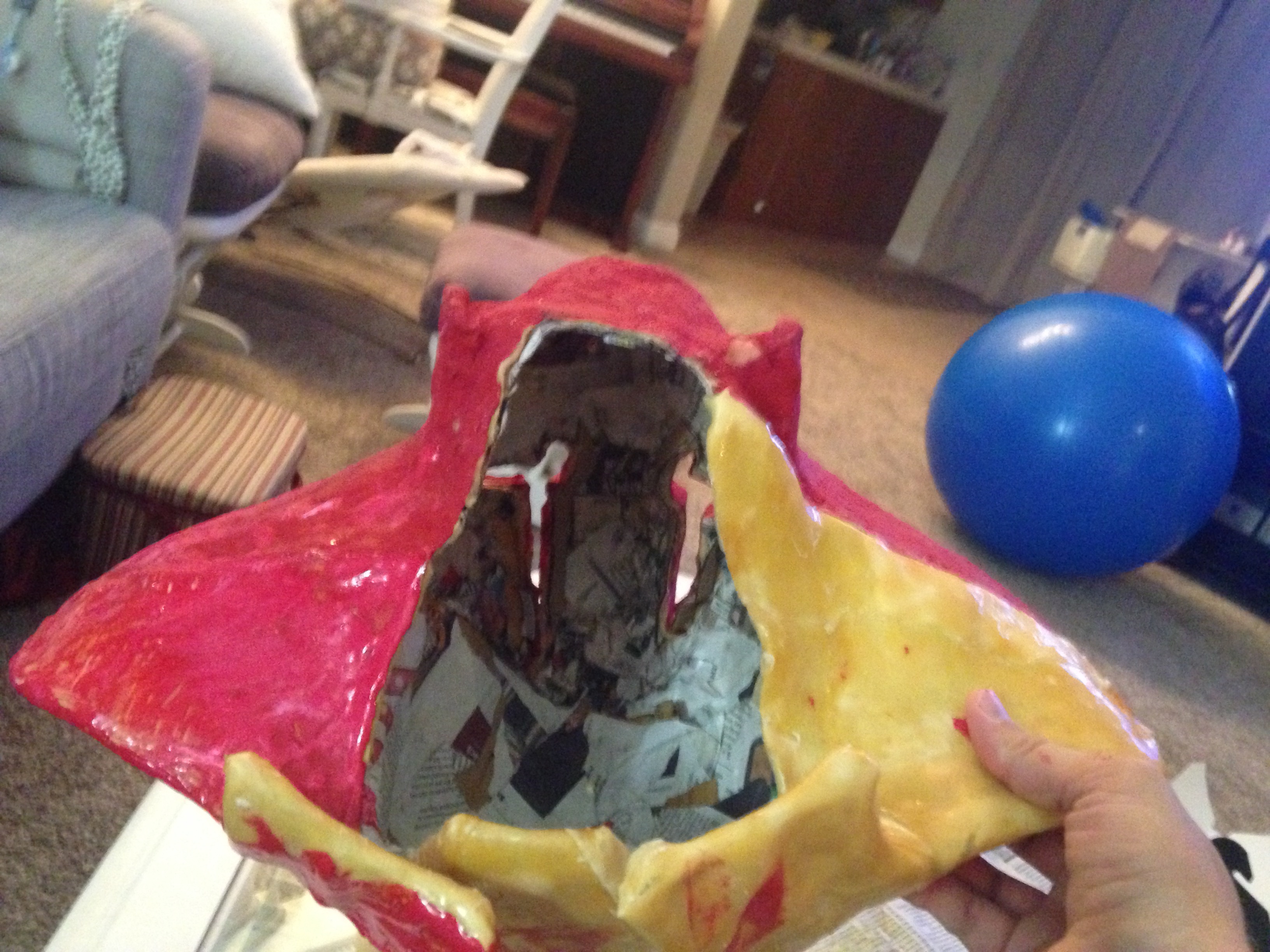

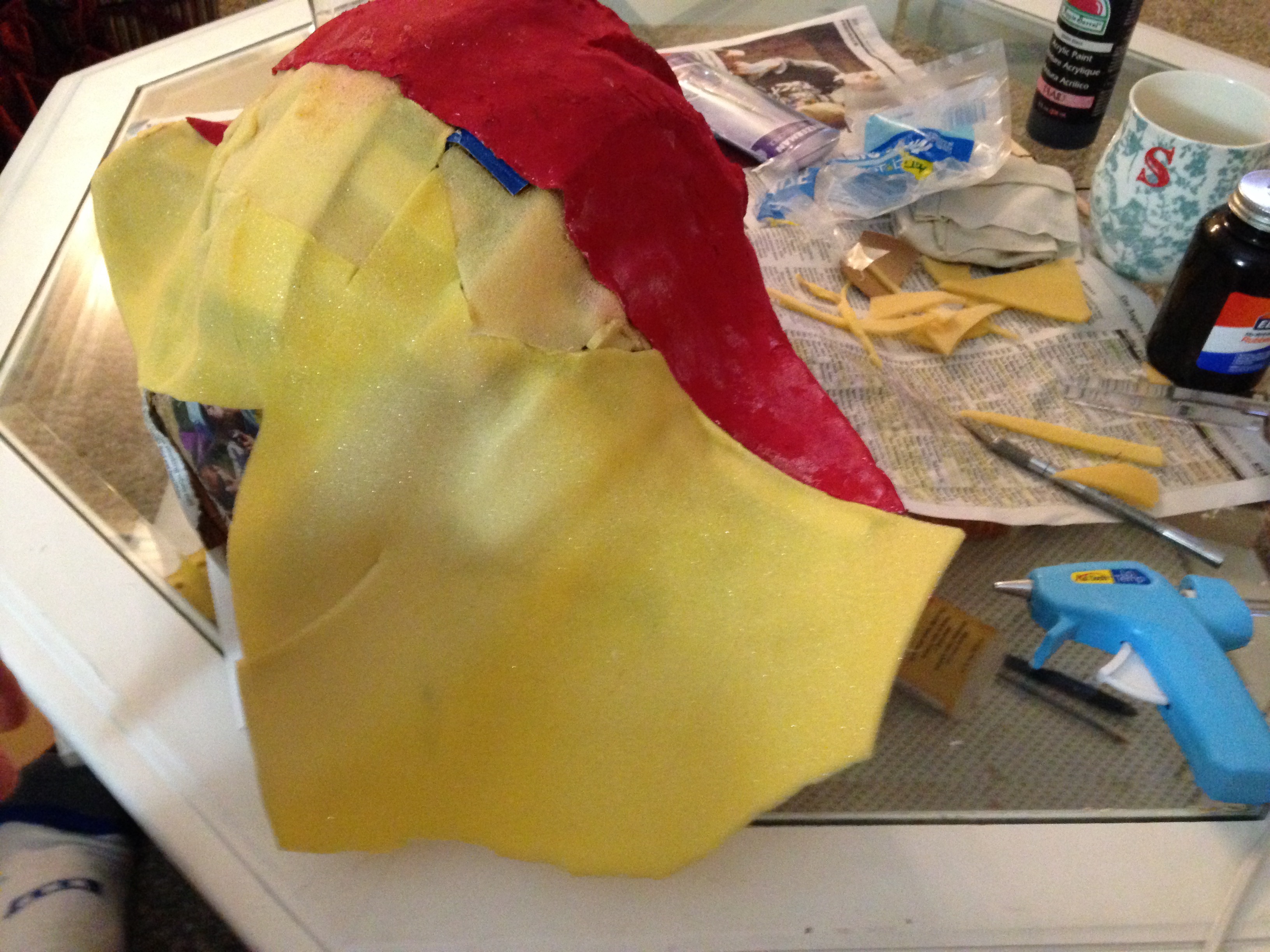

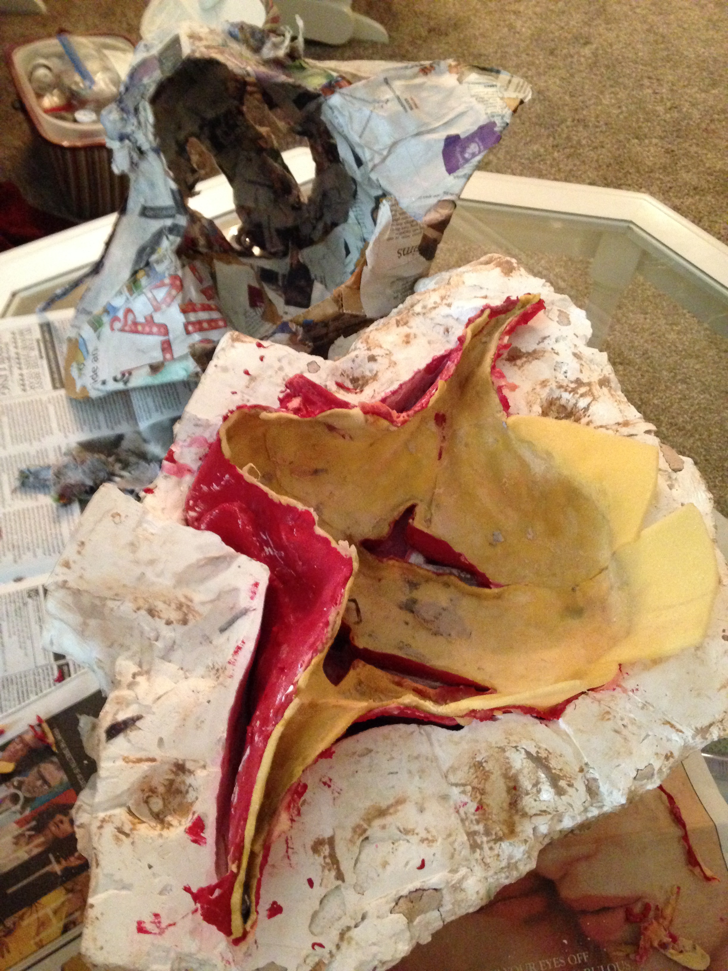

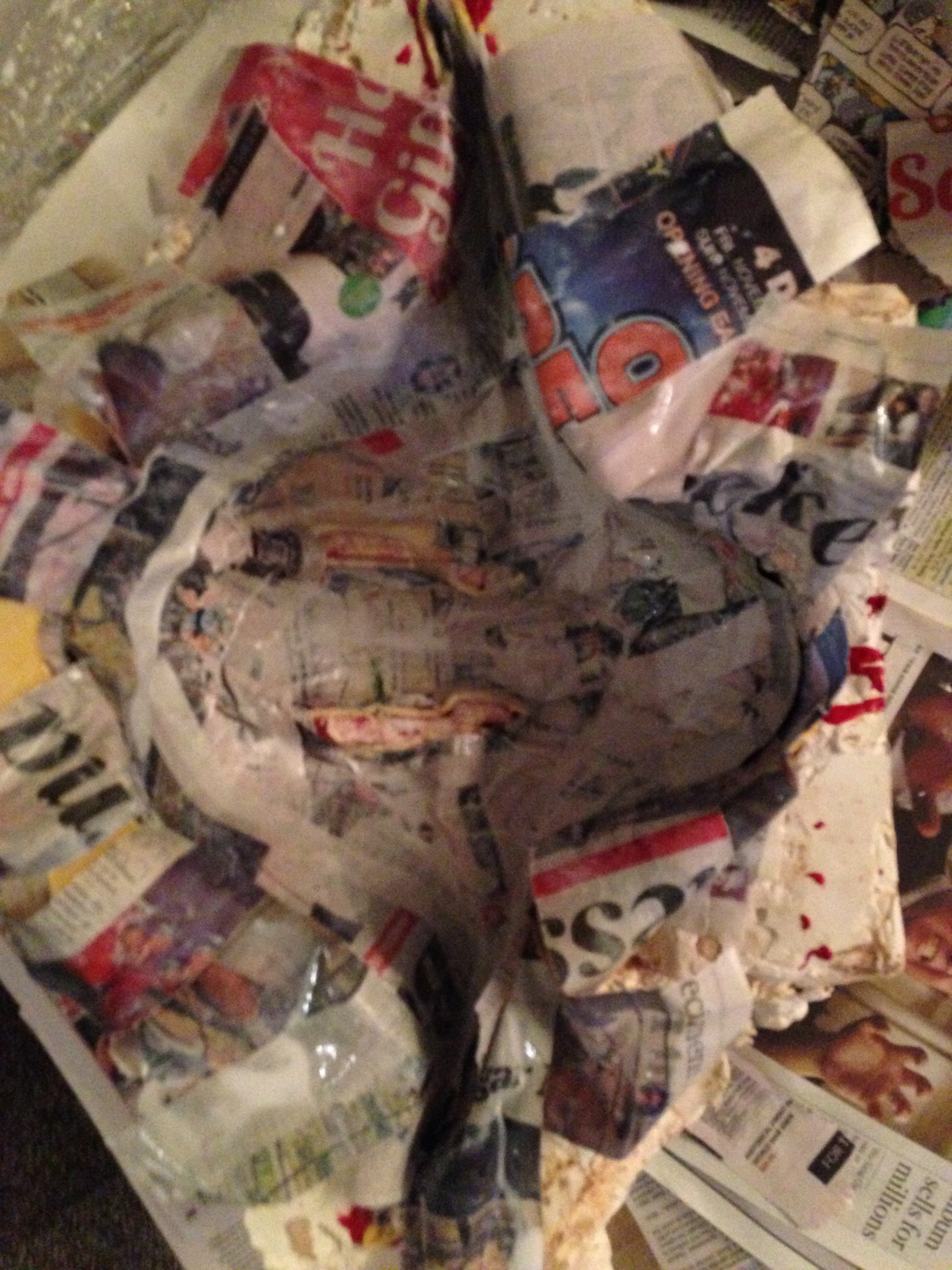

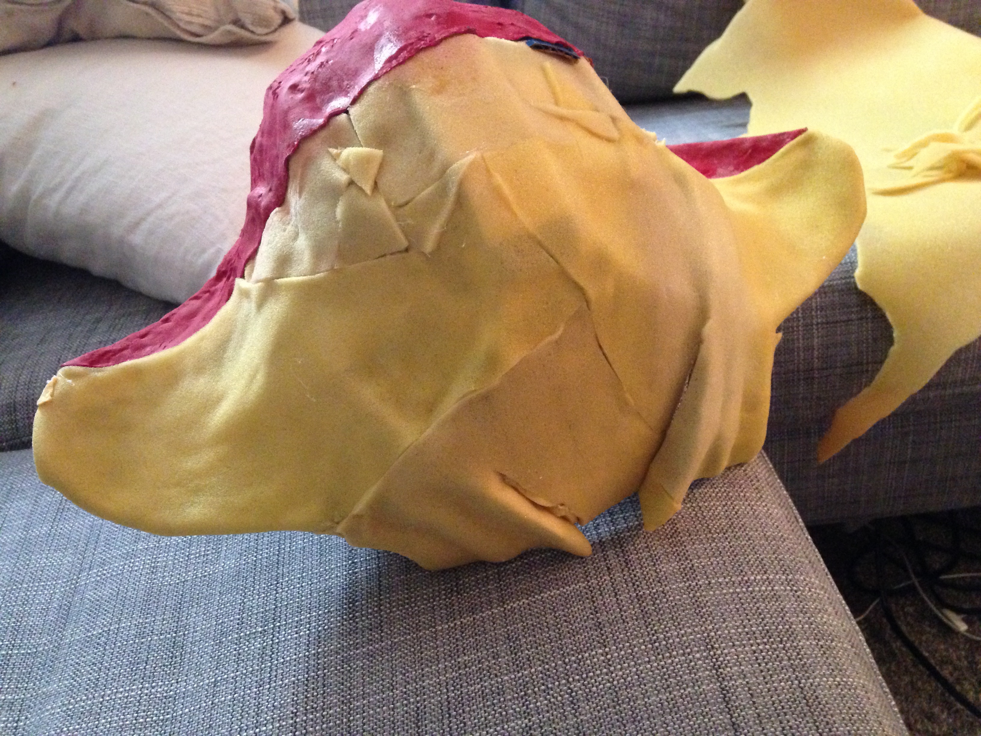

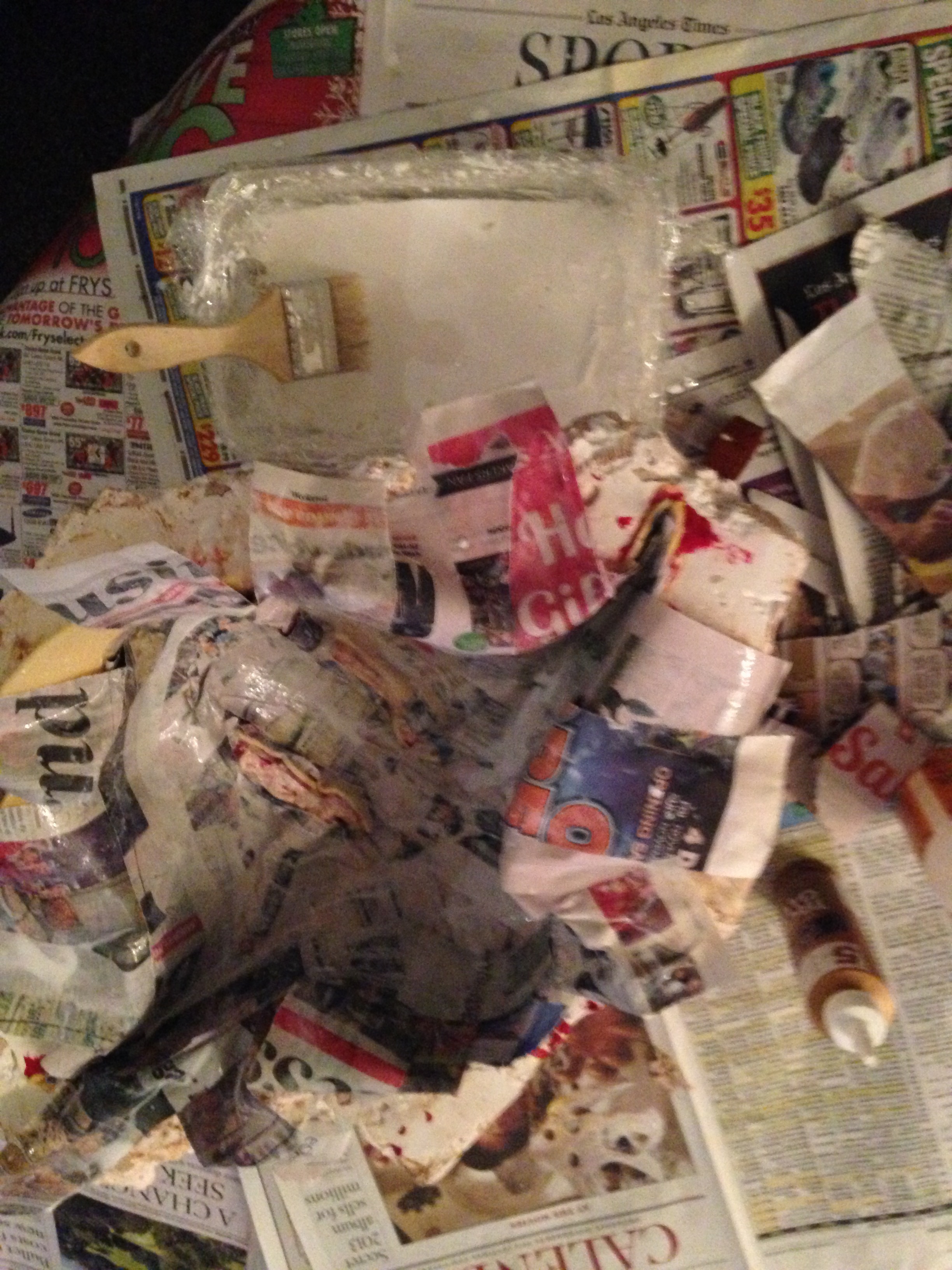

Once I had a couple of layers of latex I soaked some foam in latex and laid it in. You have to hit each side a little with the heat gun first so that it is tacky for it to stick. I made the back half of the mold as best as I could out of cardboard and hot glue and then I started making paper mache to give ti some structure. I made the back half of the mold as best as I could out of cardboard and hot glue and then I tried to blend it into the paper mache of the front to connect the two halves. The paper mache wasn't sticking to the foam so I had to remove it and let it dry. Then I used rubber cement to glue the foam and latex to the paper and cardboard. I started to cover the back cardboard half with foam and did a test fit.
IMG_2387.jpgIMG_2388.jpgIMG_2398.jpgIMG_2390.jpgIMG_2389.jpgIMG_2401.jpgIMG_2400.jpgIMG_2399.jpgIMG_2404.jpgIMG_2402.jpg

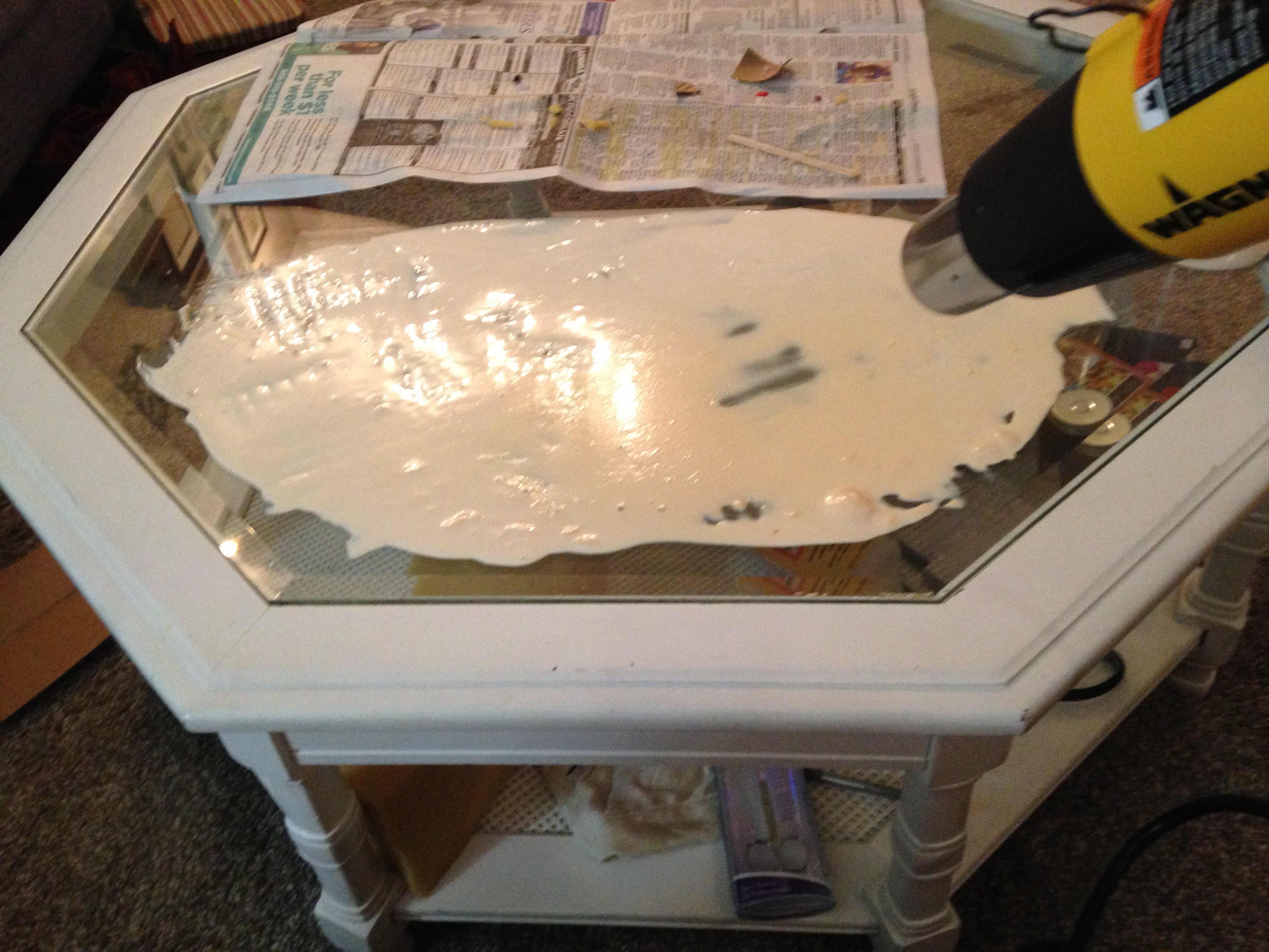

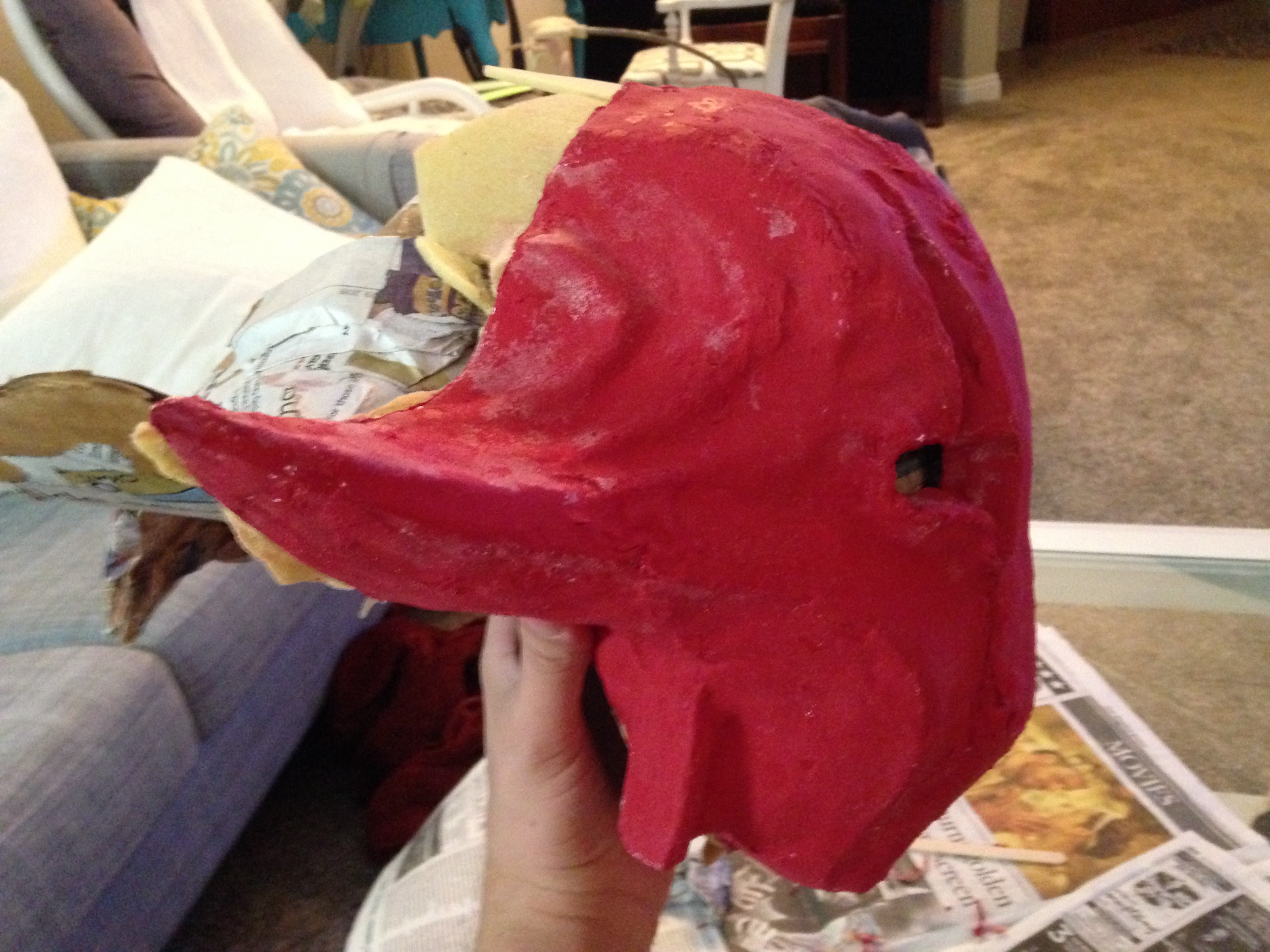

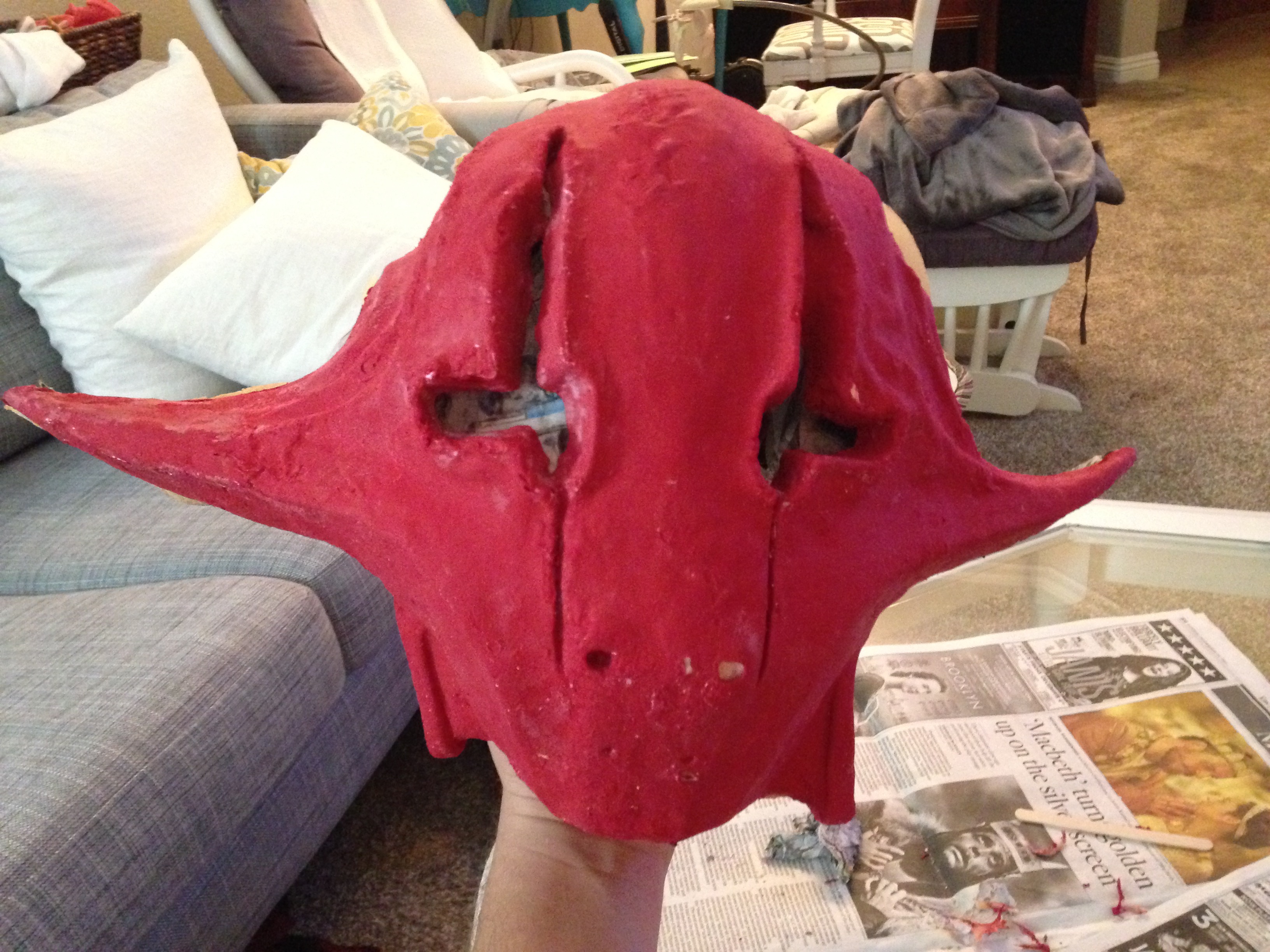

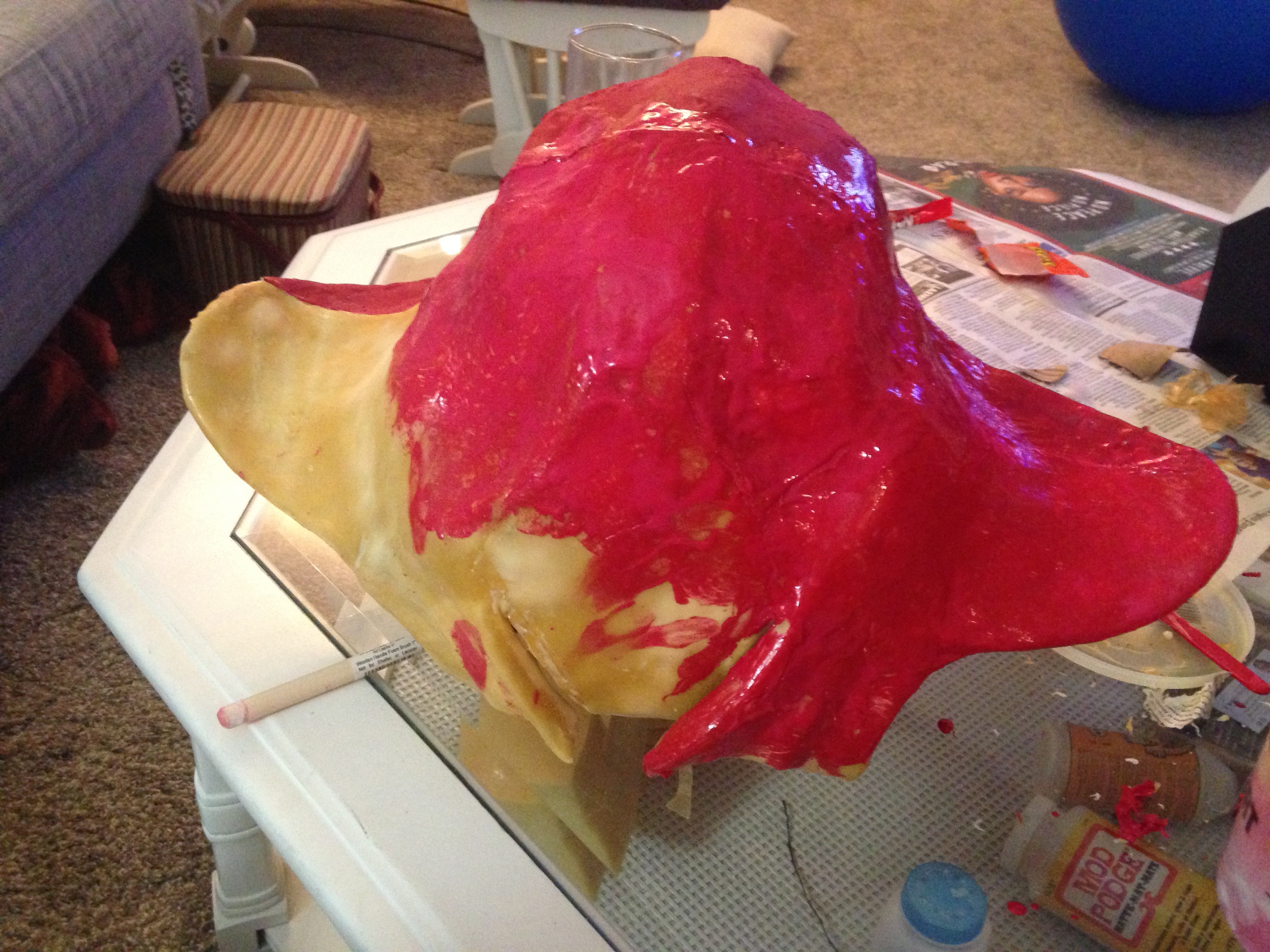

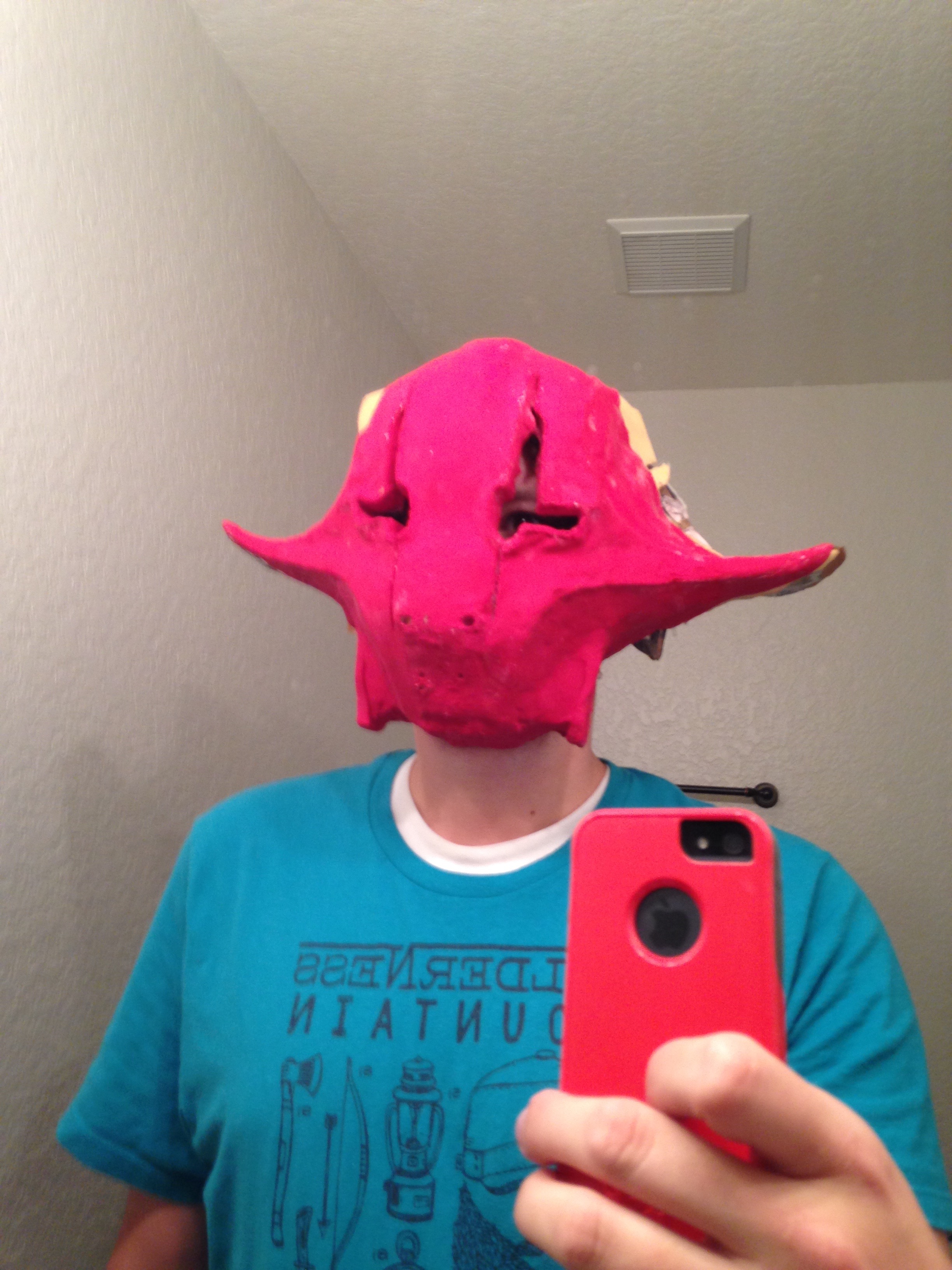

After that I started layering foam latex on the foam and trying to blend the back into the front. I spread some latex out on my coffee table glass and waited for it to dry and then peeled it off. I used baby powder to keep it from sticking to itself and then used latex to glue it onto the foam for a first layer. I just get a foam brush or chunk of couch foam and dab the latex on with that. The outside of the cast latex was really rough too so I went over everything with another coat to make sure that any pitting or texture that I didn't want got filled in. I trimmed up the neck opening and then used some of the red latex mixed with black acrylic paint to do some of the weathering effects. In the end it all has a very slimy organic alien skin kinda look. The proportions are a bit wider in the back than my original sculpt, but I guess I am ok with that considering how close it was to complete disaster. It fits really snug and I can still see out of it pretty well. I will be making a spandex undermask to hide my eyes and neck and hopefully I will still fit and be able to see with that on also. I finished the pants but I don't have any progress picks of that. They turned out pretty well. I will show them when the costume is finished. I am also working on the shirt. It would be pretty straight forward except for all the little feathery strips that I have to tack on.I am currently finishing up hemming the shirt and cutting the gauntlets and shinguards out of L2000 foam. Stay tuned for more updates soon. Can't wait for Thursday!!!

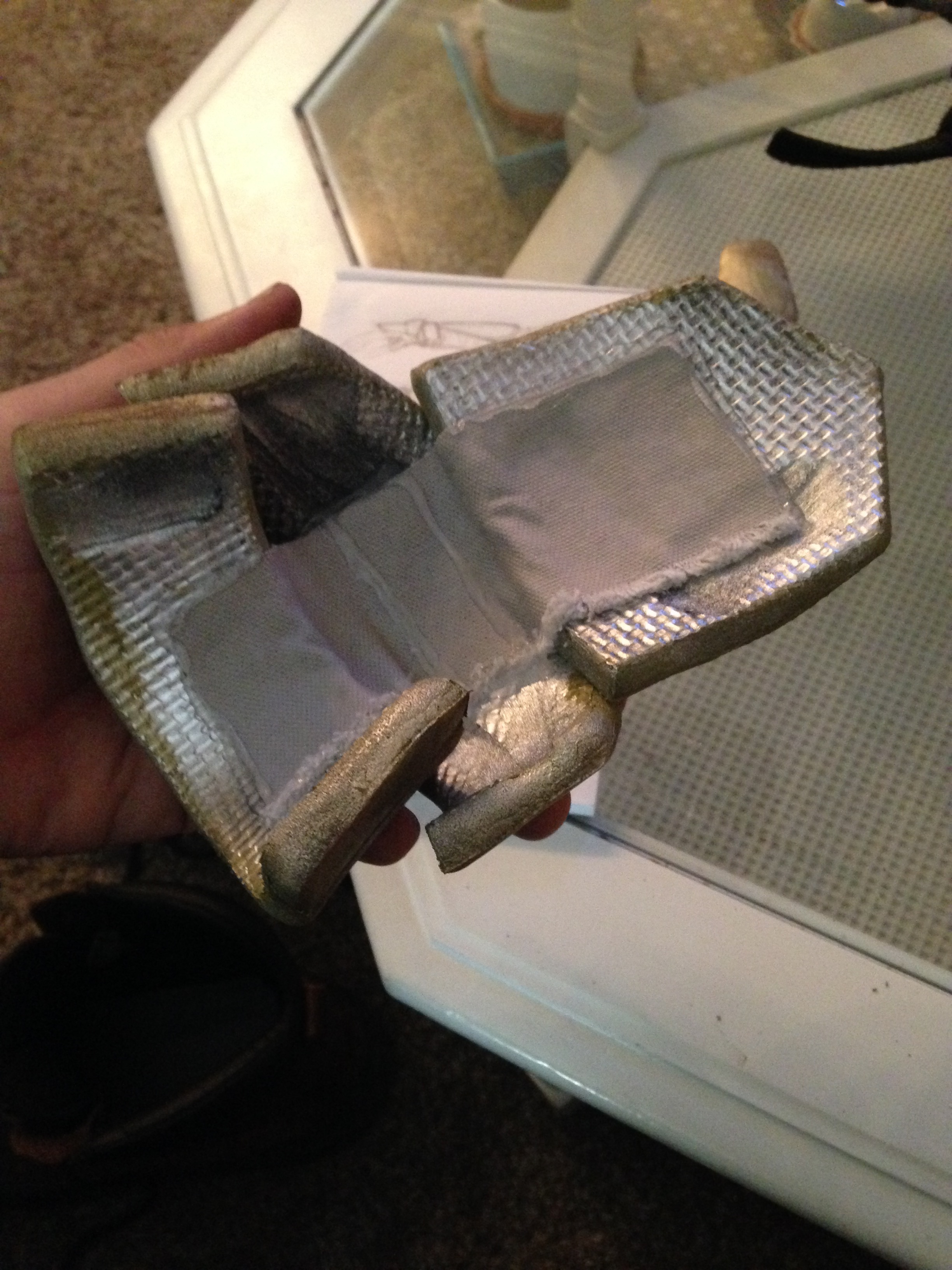

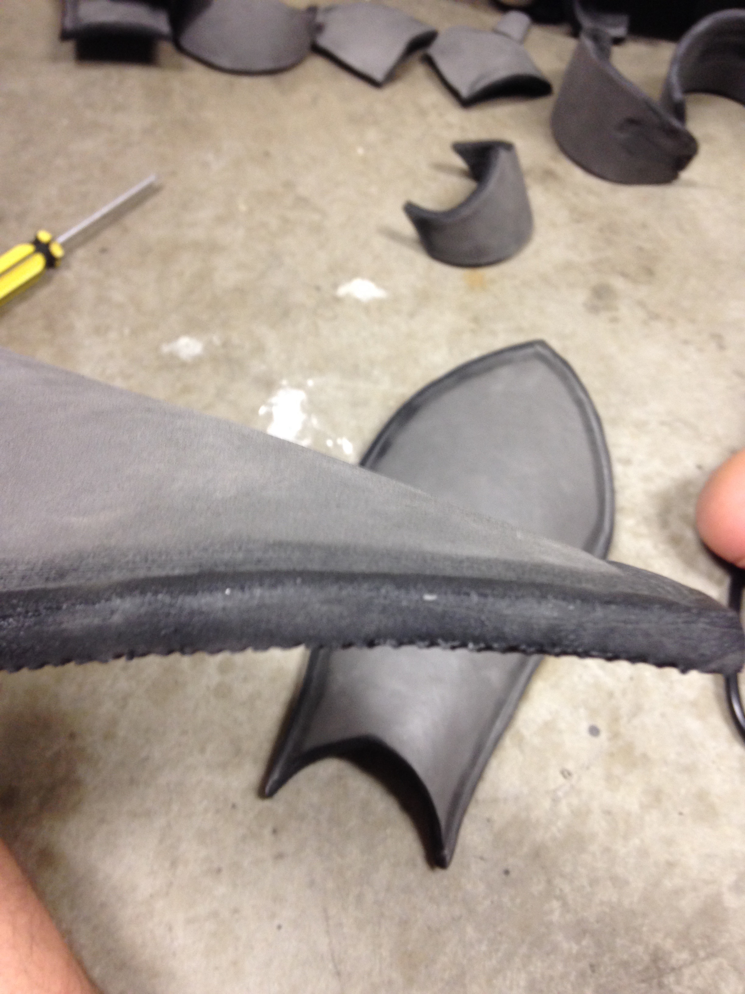

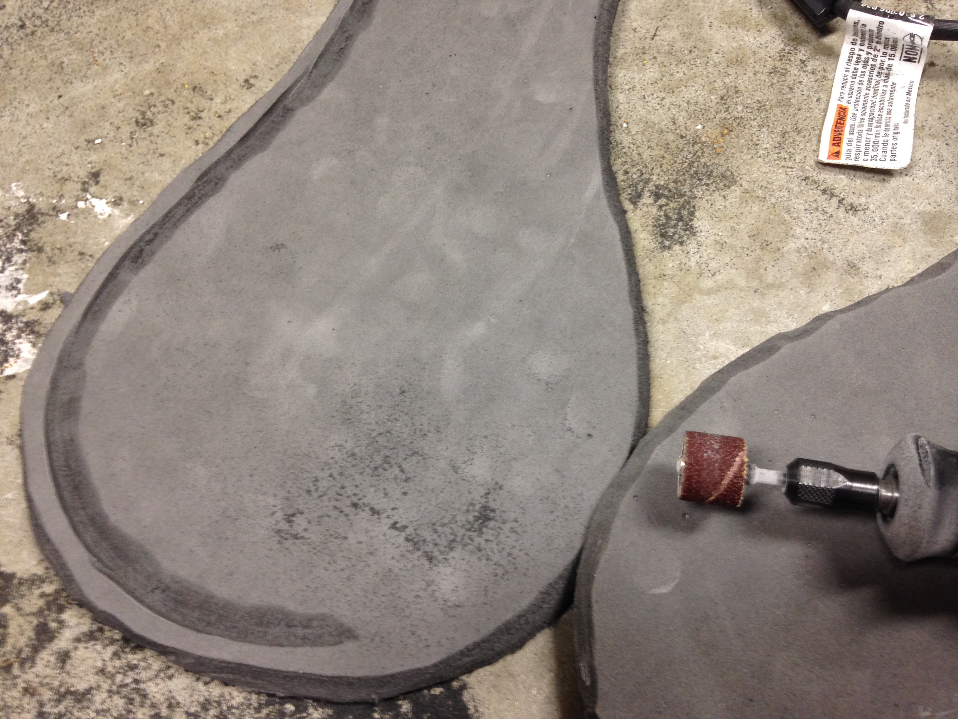

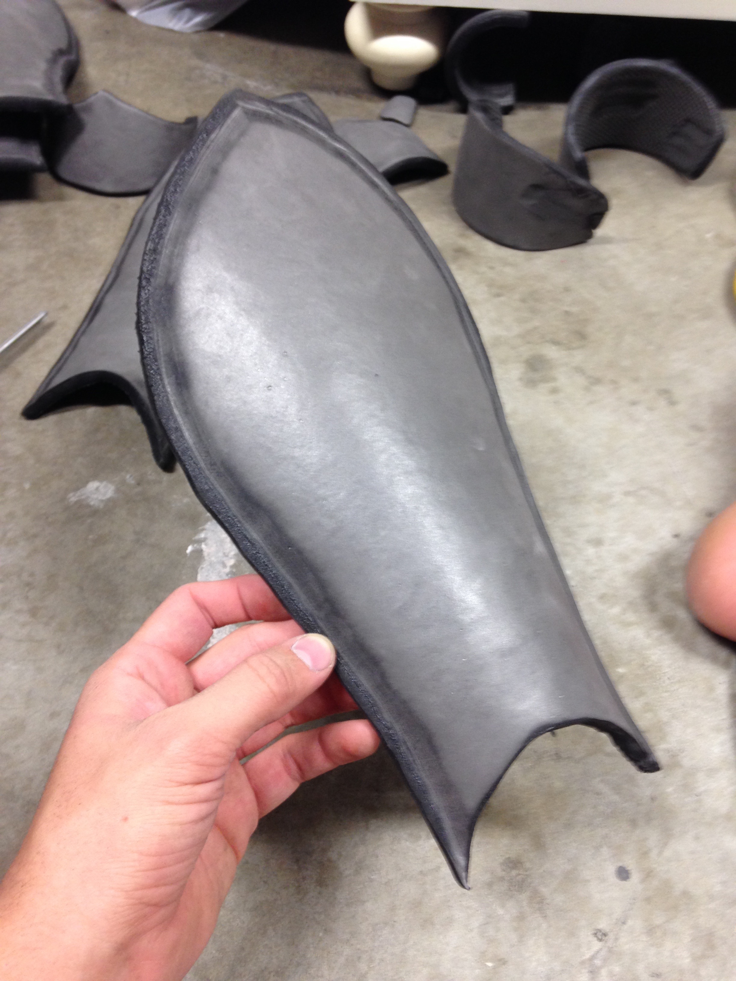

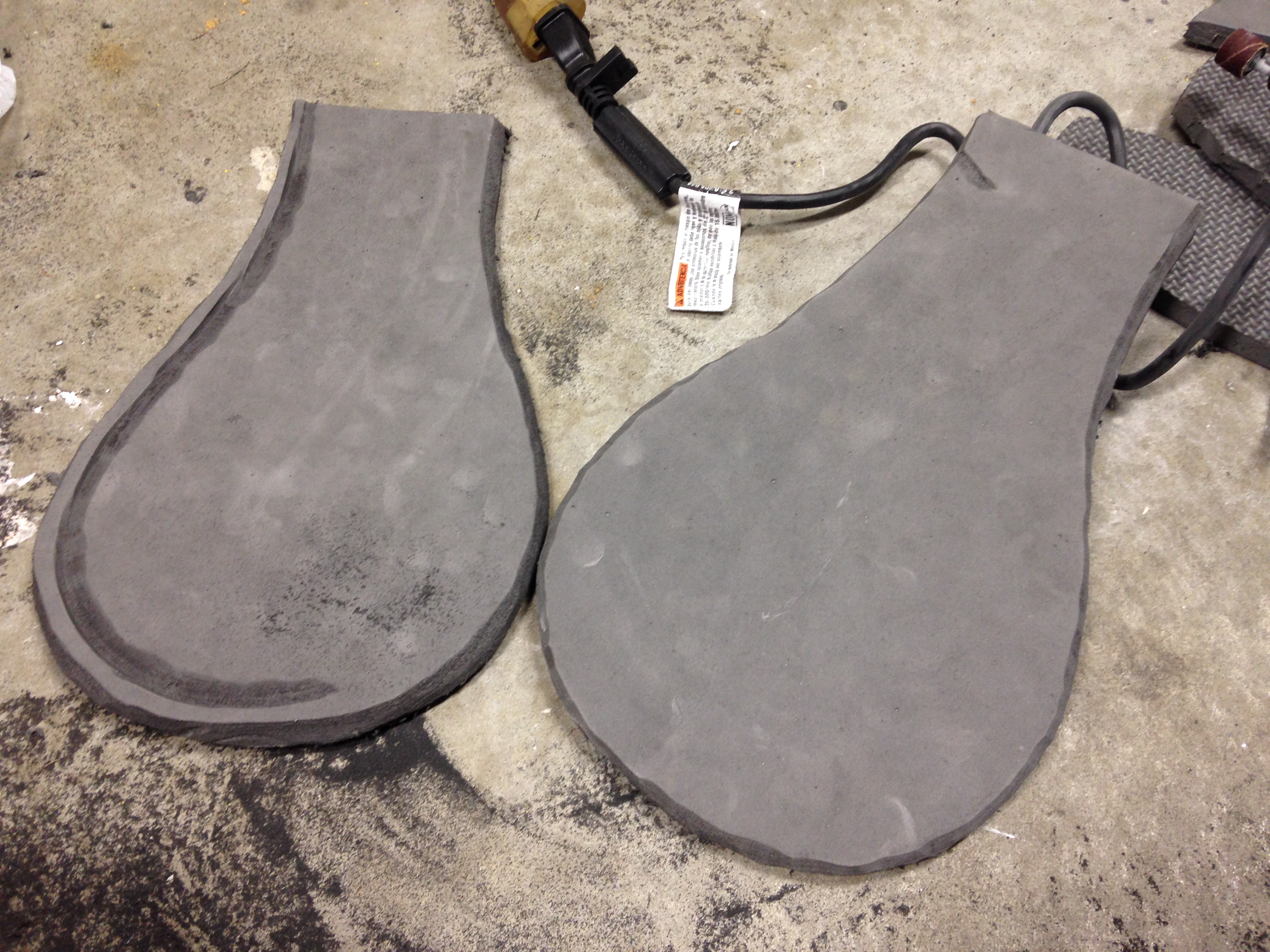

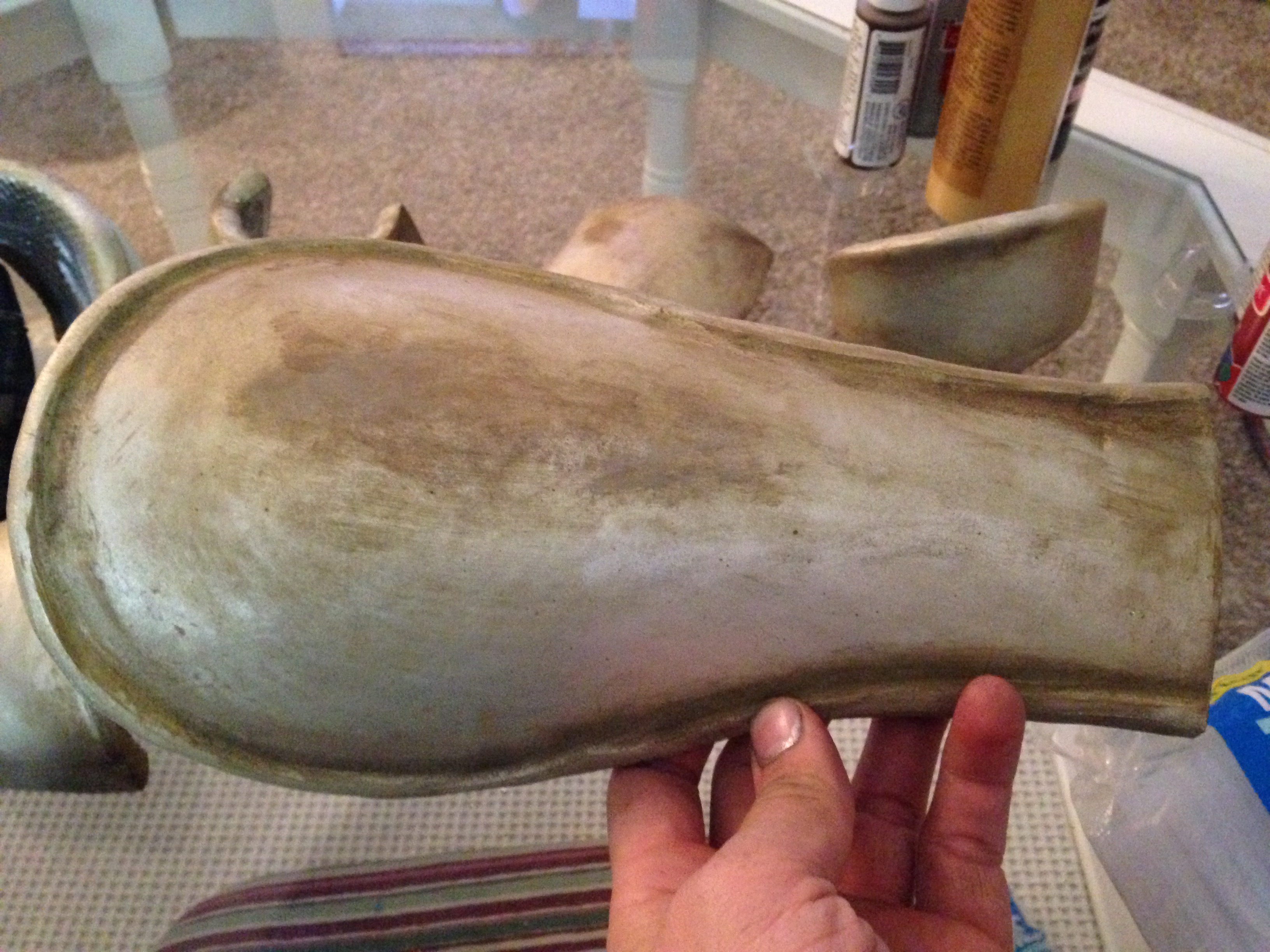

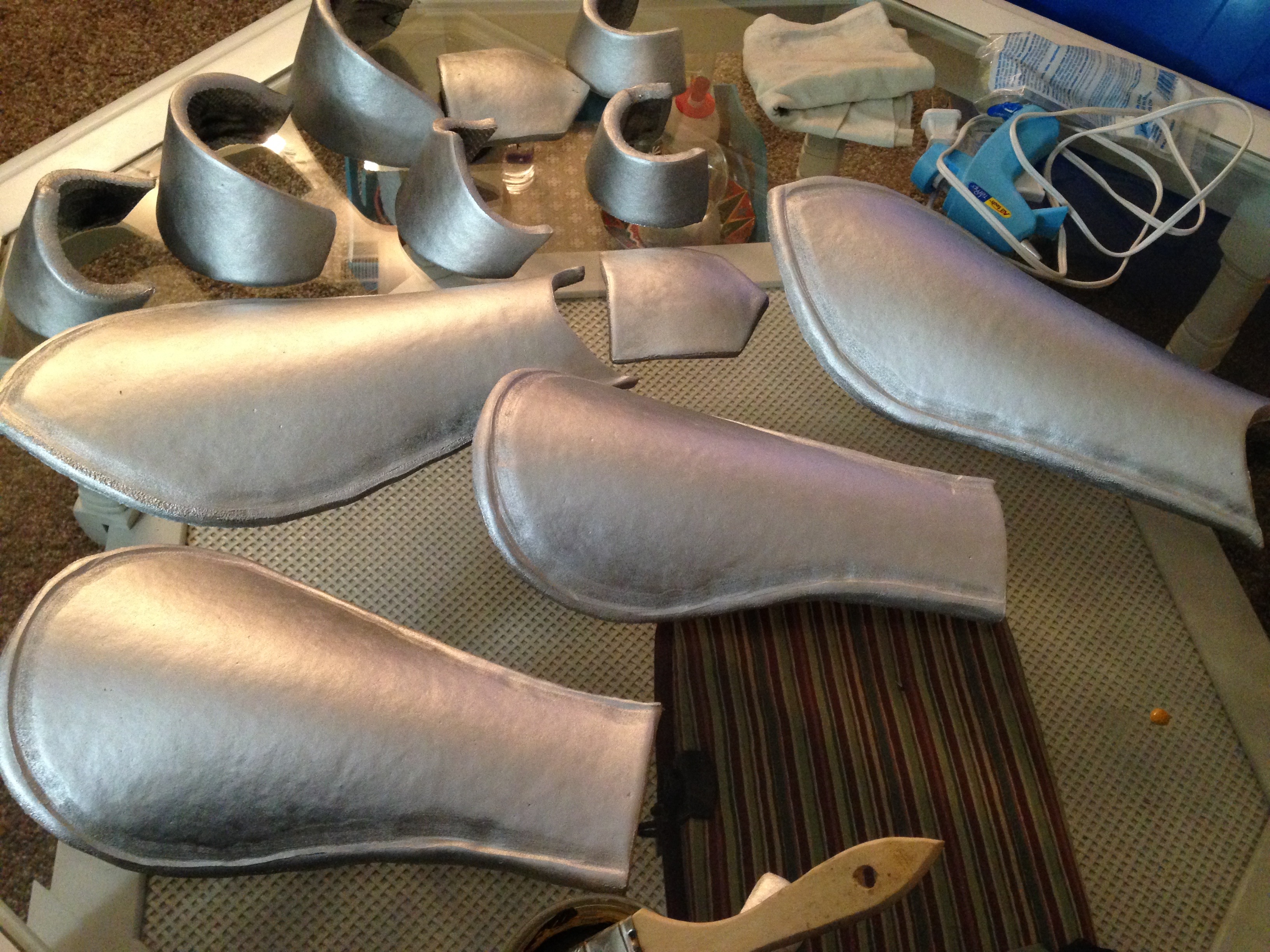

I started making the gauntlets and shin guards. I cut them out of L200 foam and used my Dremel to round off the edges and carve out a rounded trim piece shape on the perimeter of the big pieces. I used my heat gun to melt the edges and seal the rough parts that the dremel left. it also kinda evens everything out and hardens it which was really good to smooth out the shapes and give it some structure around the edge. Then I heat formed all the pieces into a curved shape that would fit my body and then painted them. First a base coat of black to seal everything and then silver.

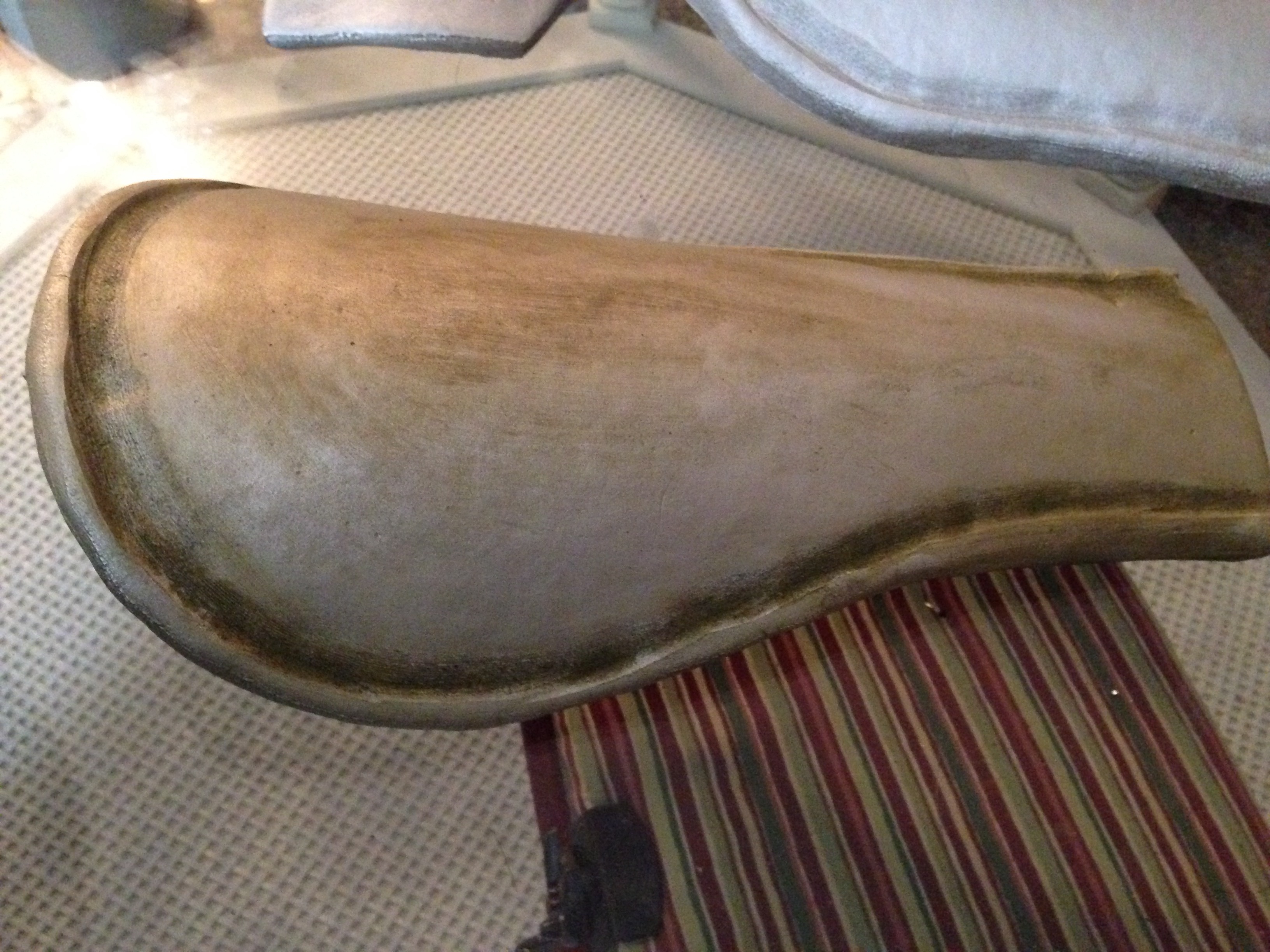

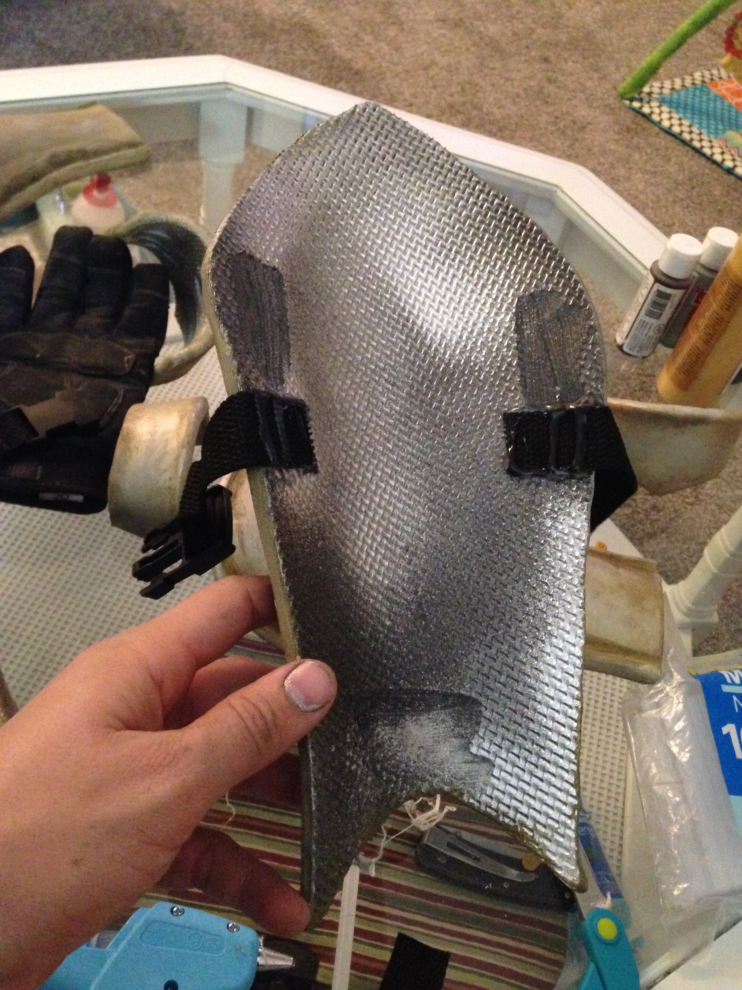

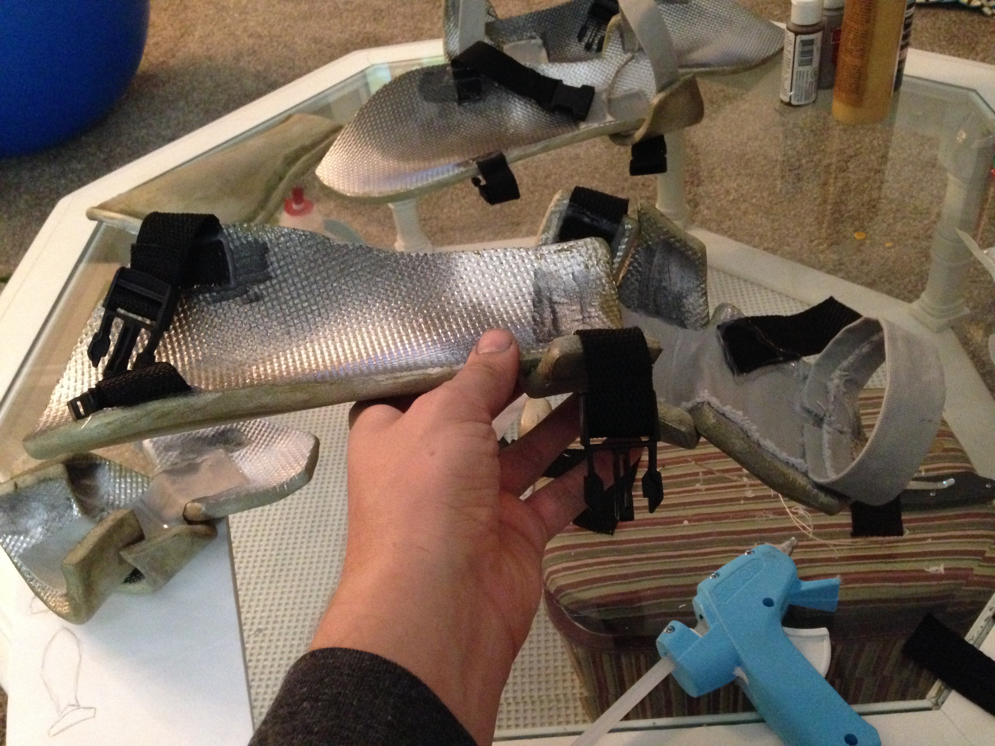

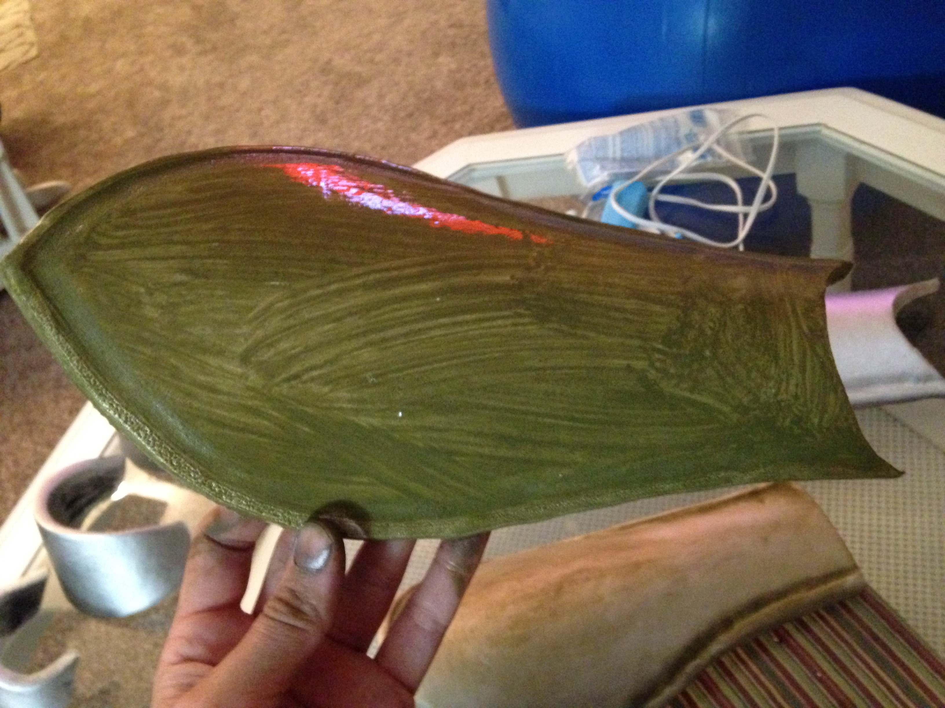

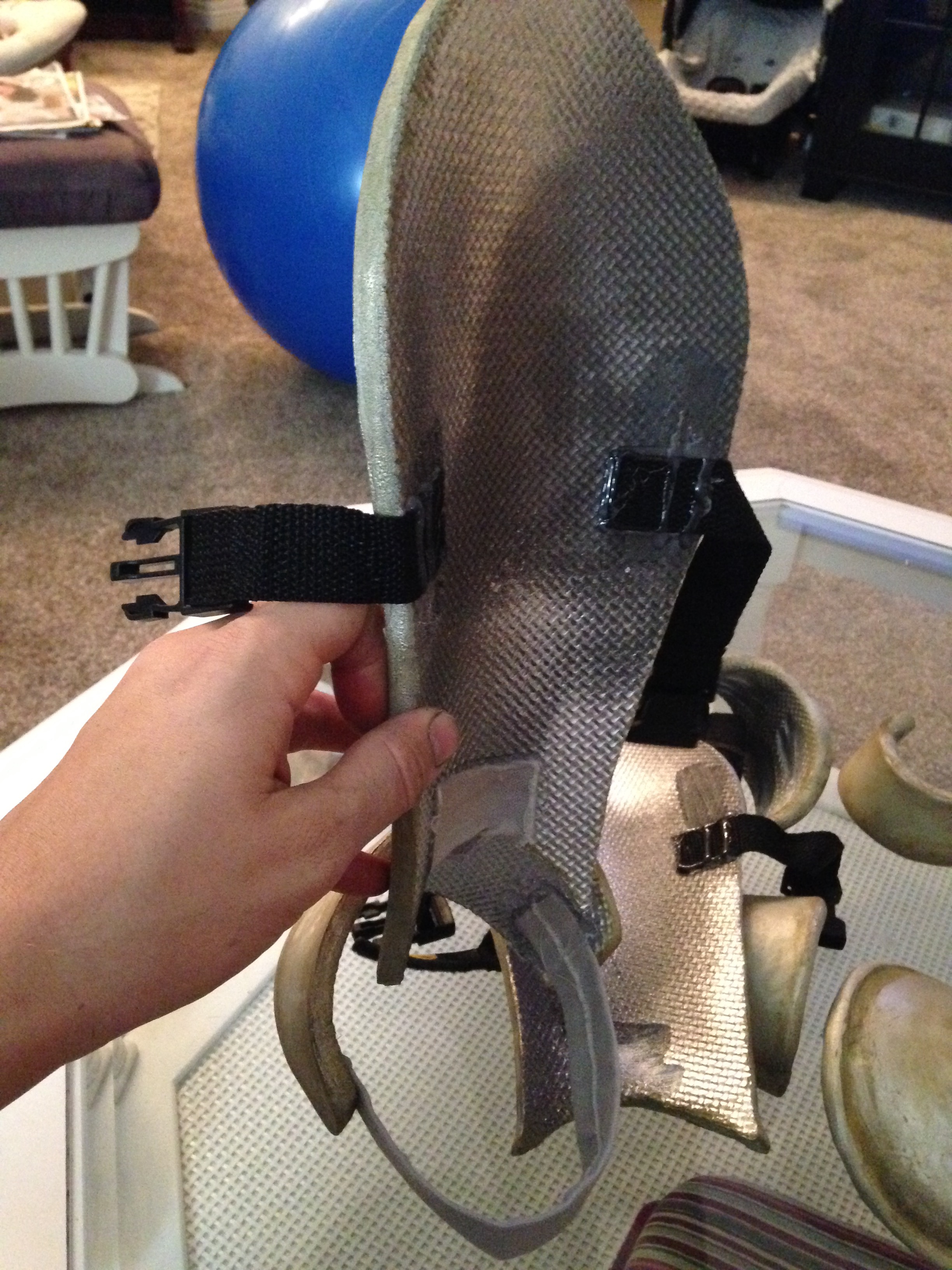

Then I weathered them by coating them with a greenish brown that I wiped off with a rag to give it a dirty kinda antique look. I also wiped some darker brown and some red/brown into the cracks to give some variation to the color. I dry brushed some lighter color in a few places for the highlights and then started assembly. I had used my Dremel earlier to carve out some spots in the back of each piece for the straps to glue onto. That gave me a place where the hot glue had more texture to grab onto. I attached the pieces together with these clip straps and some scraps of canvass that I had laying around. It turned out really well because it was still flexible and yet it stayed strong through the whole night I wore it. The only part that had a little problem was one of the leg straps that started to peel off because it had a little bit of paint under it that made the surface more slick. They work really well with my heavy work boots and gloves that I am wearing under them and are pretty comfortable.

As far as durability the mask held up perfectly. It really helped that I backed it with thin couch foam soaked in latex and then glued that to the structure. As far as detail in the casting, it was so-so. I was an idiot and forgot to put in mold release before I poured in the latex and so it was difficult to get out of the mold. There was some tearing and stretching in most of the detail areas that I had to go over by hand and that led to it having much more texture that it should have. If I were to do it again I would probably make it out of a hard material that I can sand smooth like sintra or something. I think a more rigid hard and smooth surface would be more accurate now that I have seen more reference. I was under the assumption that it was a fleshy face, but the reference all states that it is a helmet. I have never used silpak so I don't know what that will be like.
