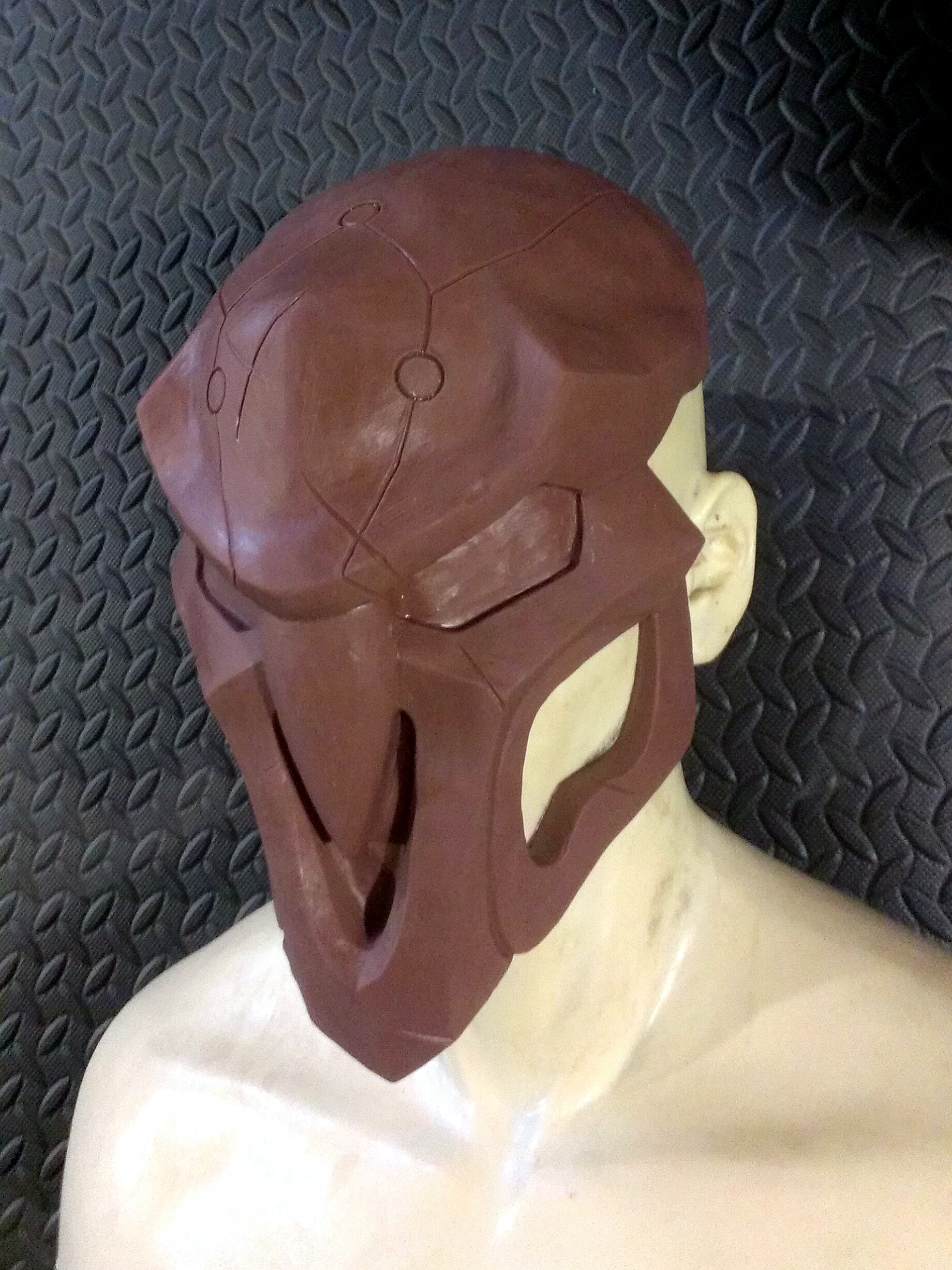

For many of my mask/helmet builds I often opt to go the sculpting route, and the same held true for this project. I’ve used Monster Clay from the company Monster Makers for as long as I’ve been sculpting, it’s well priced, easy to use, and heat activated (which also means it’s completely re-usable!). The higher temperature the clay is the softer it is, which allowed me to quickly start blocking out the rough shape of the mask with warm clay.
After messily throwing clay on the head form, the next step was starting to refine the shapes and angles of the mask, and for this I worked in stages, focusing on one side of the mask at a time. The eyes & brow were an area of special significance on this project, as Reaper’s mask has a very pronounced expression that I really wanted to capture. Some makers and sculptures like to put their own artistic spin on things and take creative freedom’s here and there, but I really take pride in trying to attain perfection in relation to the source, making game assets really come to life!
The tedium of chasing symmetry was a large portion of the 100+ hours this project took from start to finish. To help keep things identically mirrored throughout the process, I periodically took photos and would throw a grid over it in Photoshop so I could measure proportions and angles. While time consuming, it was definitely worth it to get all the sleek curves and lines of the mask looking impeccable.
After I’m happy with the shapes of the main portion of the mask I moved onto the cheeks, and made a quick pattern with painters tape so the cheek portions would continue the symmetry I’d been working hard to maintain. Rinse and repeat the same process of blocking out, refining, and double + triple checking on the cheeks, and then it was time to move on to adding details and smoothing things out.
I measured everything out and marked off the detail placement with pin pricks to line everything up and make sure the distances and angles were correct. Then to get the indented seam lines in the mask I simply played ‘connect the dots’ with a small metal dowel, pressing it into clay until all the lines were at an even depth. The rounded recessed areas were made using a small plastic tube, sharpening one end and again just pressing it into the clay. In the final stages of the sculpting process I will brush the clay with mineral spirits once or twice to help smooth out the clay.

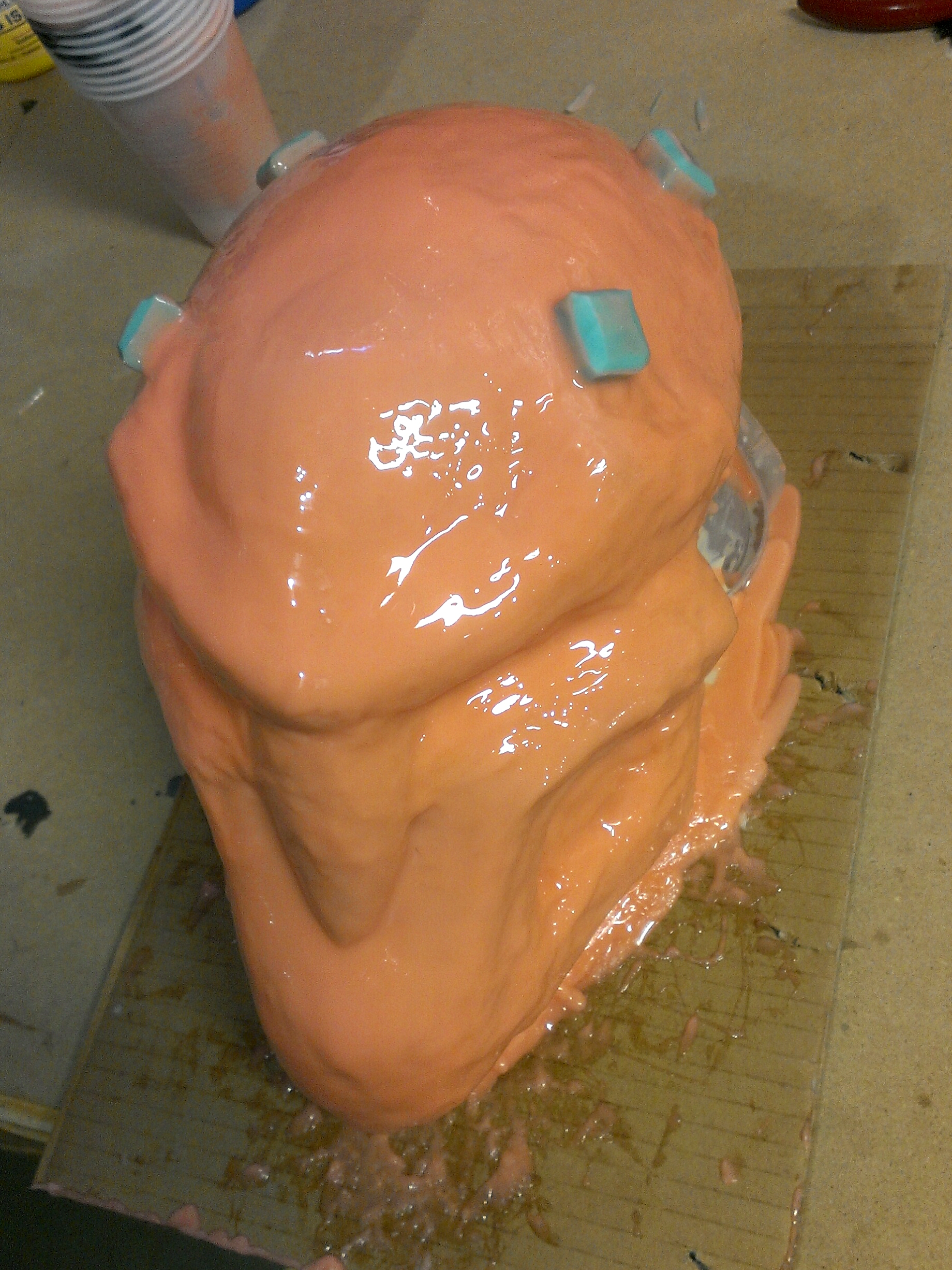

Next up was making the first mold. I used Smooth-On’s Rebound 25 for this mold brushing on 5-6 layers IIRC. Knowing I only wanted one cast from this mold make a cheap and dirty mother mold using plaster bandages and coating it with resin. I used this method for many mother molds on my first few projects, and while its cheap and works, If you’re planning to get a ton of casts out of your mold I recommend making a sturdier mother mold (like I did for the final master copy of the mask).

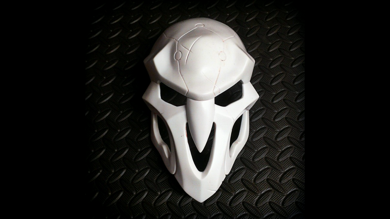

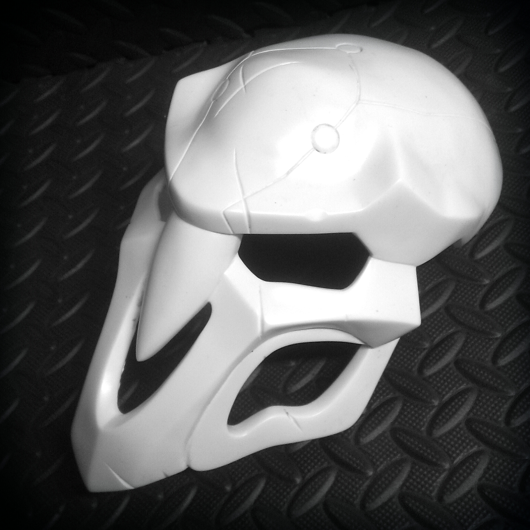

With the mold done, I cast up a resin prototype, ready for further refinement. As you can see from the cast, I could have done more work to smooth out the original clay sculpt, but knowing I would be making a second mold, I find it easier to smooth and refine a resin mask than the clay.
What followed was a long process of sanding, apoxie sculpt, filler primer, and wet-sanding (with multiple rounds of each), but in the end I got that original cast nice and smooth. I also backed the eyes and open spaces with sintra for the molding process – and etched ‘Henchmen Props’ and a few Reaper quotes into the sintra just for fun, and it would be there in raw casts before prep work. :p
I made a clay base to prop the mask up for molding, and set about on another Rebound 25 mold. Knowing I wanted to do a 2 part mother mold for the final mold, I added registration keys to keep the molds aligned when casting from them in the future. After the silicone mold was done, I made a quick cardboard divider, and filled in the seams with clay.

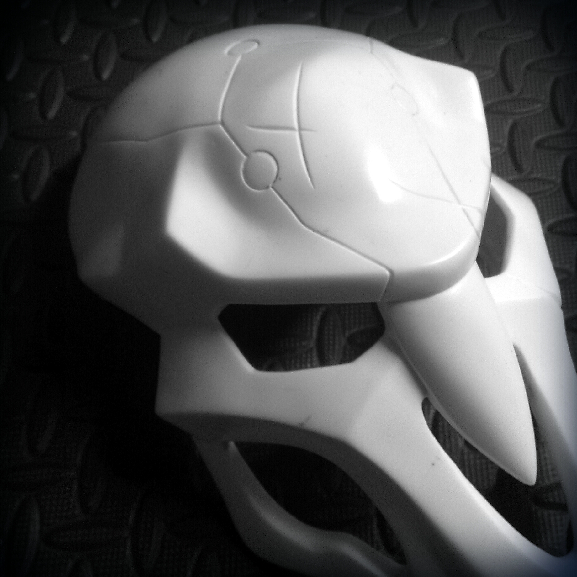

With final master mold entirely done, next was casting up the first copy of Reaper’s mask (I used Smooth-On’s Smooth-Cast 65D). For these masks, I did about 6-7 thin coats of 65D for a strong and lightweight casting, and after the final layer is done the masks are left in the mold for at least 20-30 minutes to let the casting fully set and cool down before demolding.

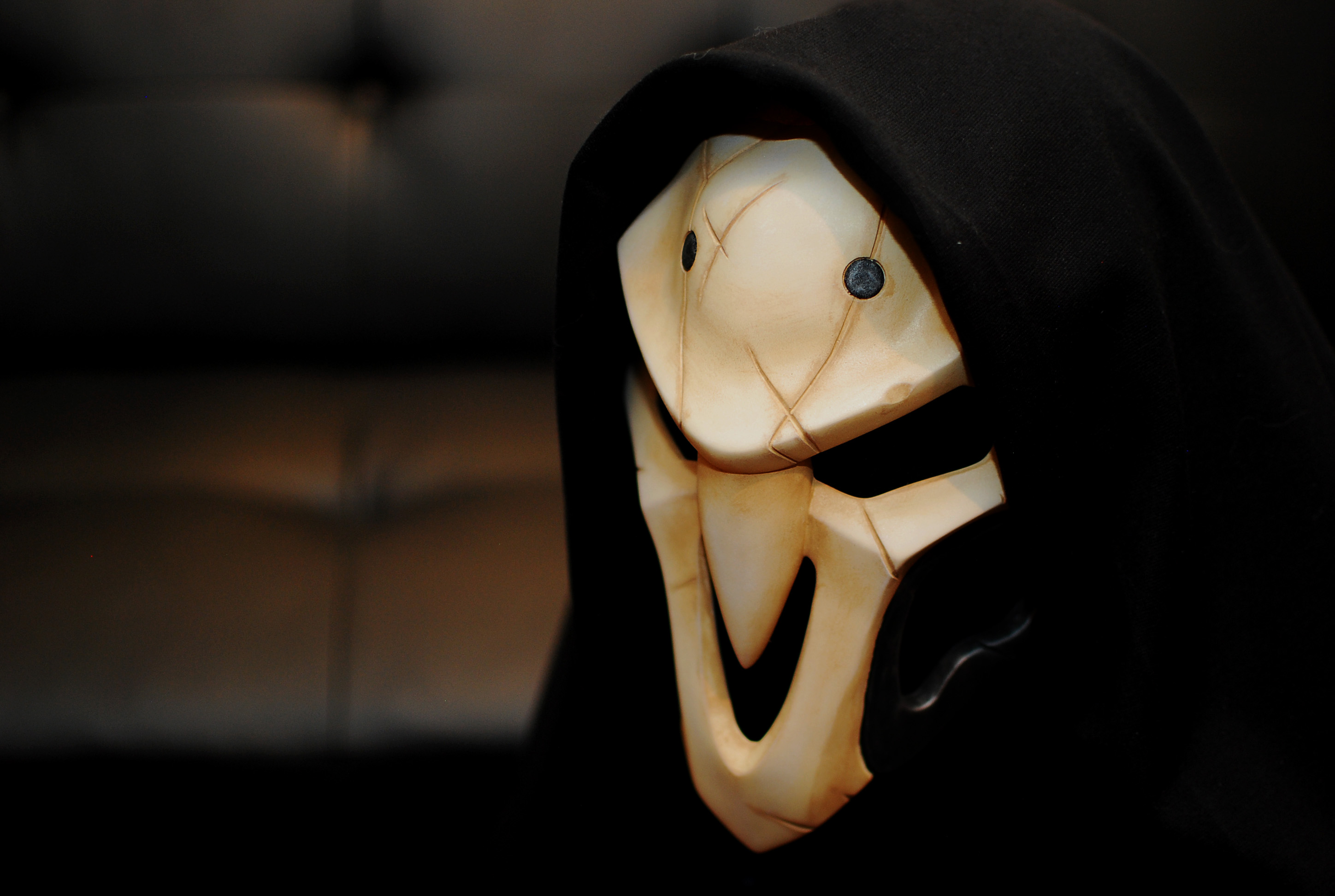

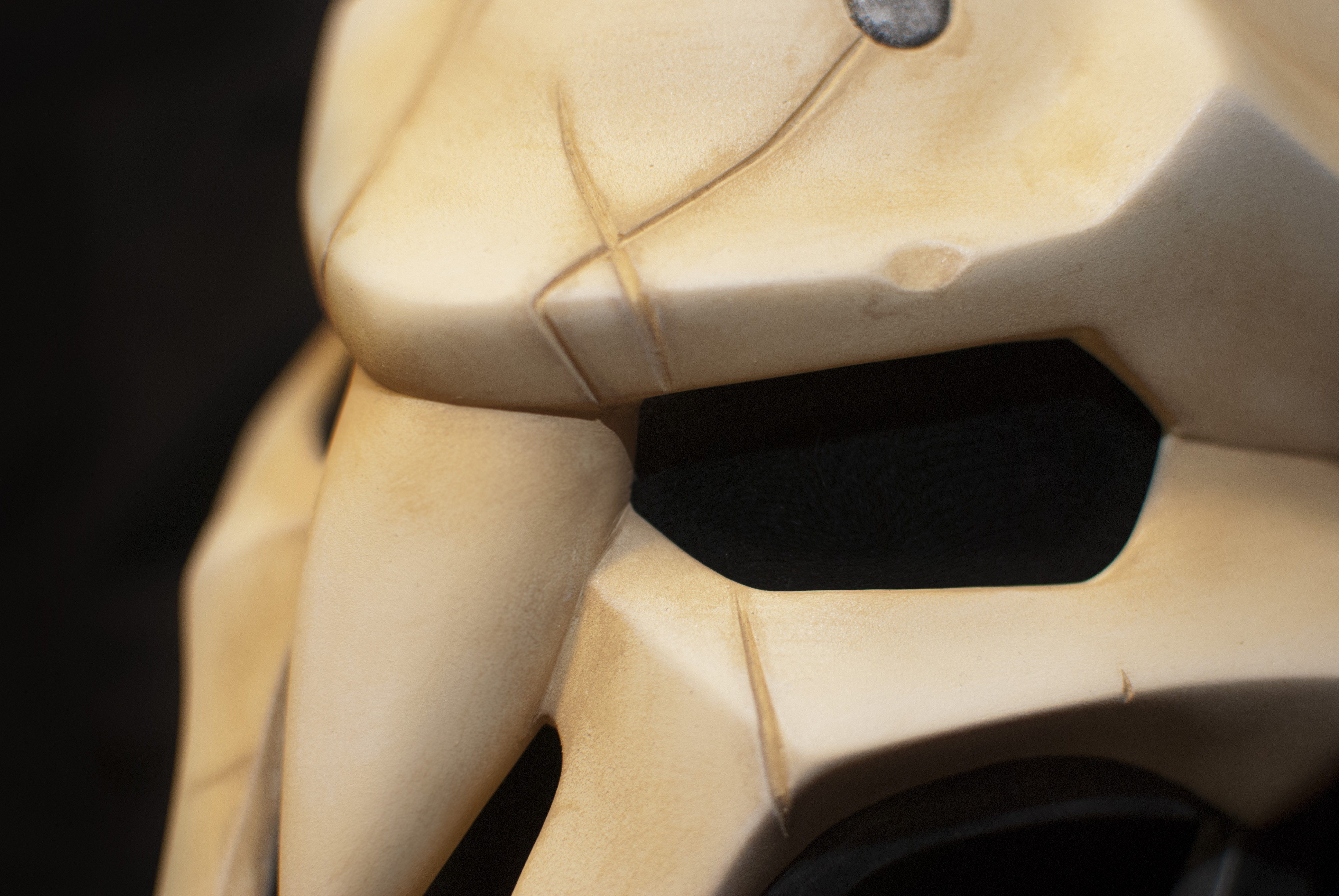

After all that, it was time to slap some paint on the cast
