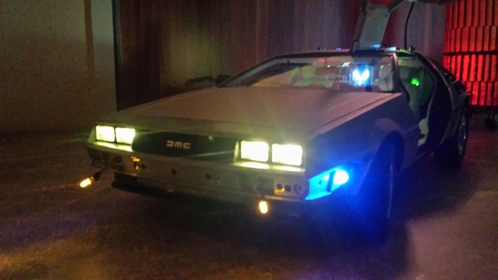

And now, it time to check the lights :) :) :)
Dashboard, 88mph-meter, plutonium meter, timecircuits, overhead lights.... CHECK !
Flux-Capacitor, X-Mas Tree... CHECK !
Headlights, front turn signals, front and bottom door lights... CHECK !
Rear Lights, back door light, engine compartment light... CHECK !
As I feared from the beginning, the brake light might not work as the contact is pretty weak. I wont fiddle around on that as I really don´t care about that feature ;)
Trunk light... CHECK !
Front and top Flux-band lights... CHECK !
Everything toghether... AWESOME VIEW !!!!!! These photos just don´t do justice :) :) :)

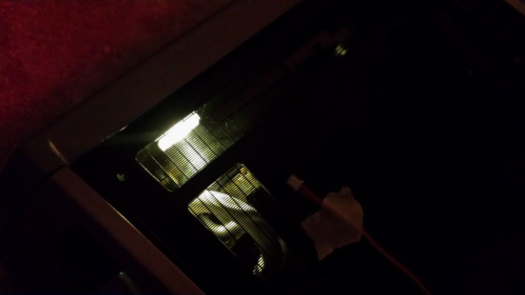

I forgot to show the lighted engine compartment with the last "light test" so it comes. Not very spectacular, but for the archive :)
Looks nicer in RL as the light is NOT as bright as shown in the pic. On the other hand, pretty useless as it wont be visible after all the time machinery is build on the back. unless it is easy to remove somehow.

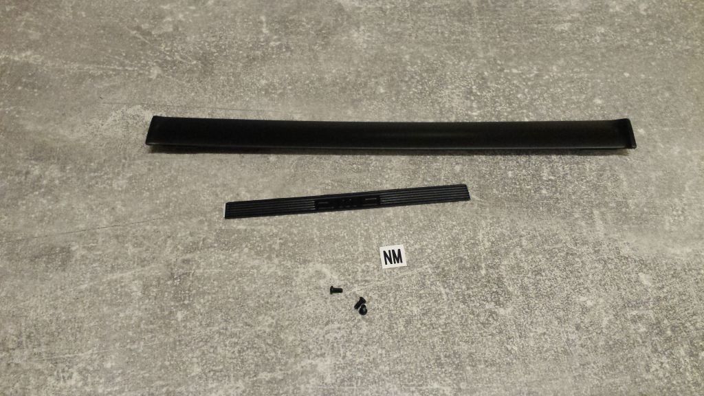

#97 / 130
all parts - same as #96
( ahm, do I hear the word "milking" ?? :) :) )

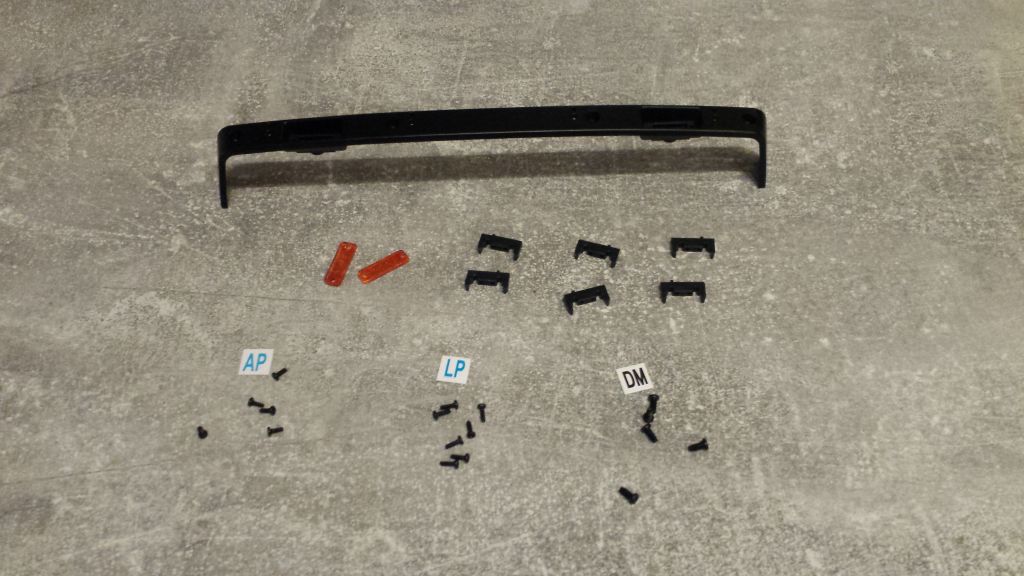

#98 / 130
all parts - plastic

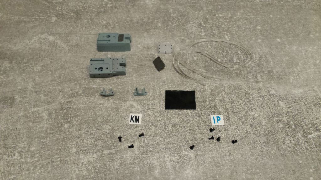

#99 / 130
frame - plastic
meshes - metal
and testing :)
uhm...yess... its kind of "ok" for what it is, but I would have expected it a bit brighter. Need to pull the fibres in a straighter position too. Maybe my favourite Mod-Group comes up with something

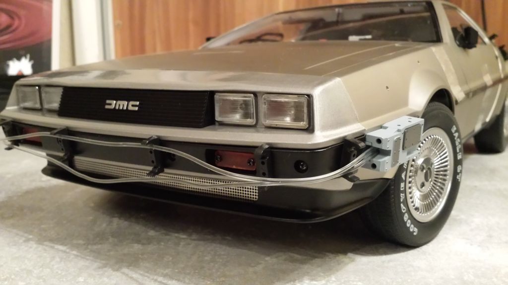

Howdy folks ! :)
Well, a little unexpected, but still welcome, one more french issue arrived yesterday. And after brainstorming about possible solutions for better lighted fliux bands, I also recieved an order from amazon.
#100 / 130
all parts - plastic
deco wire

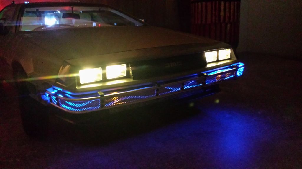

# upgrading the flux band(s) :)
I found this EL rope unit on amazon for about 8 bucks. It´s powered by two AA batteries, and switches through three modes, constant light, slow flashing and fast flashing
Unlike some other members from different moding-groups, I wanted to hide the light strings and the power cabel as good as possible.
So, this unit has 5 individual strings with a length of 1 meter and a diameter of about 2,3 milimeter.
Most mods I have seen so far are using a single string, to light front AND rear flux bands. So they run the light string on the outside bundle with the deco wires and covering the unwanted light with paint or black tape. It DOES the job but thats exactly what I wanted NOT do to.
First I cut off, two strings. Then I disassembled the entire front and removed the orignial Eaglemoss LED-wire. I pulled one string from the bottom and from inside of the fender on the passenger side. For perfect fit to the brackets, I needed to make the recesses a little deeper. I pulled the light string around and hid the remaining end in the hole again where the original LED came out. Now I can hide the power cable on the bottom of the vehicle and the two remaining strings fit perfectly for the rear flux bands
A little fidley to install, when you don´t want to pull apart to entire car again, but possible.... and man, the effort is worth it, looks so much better than the original EM light strings. :) :) :)
Parts count so far : 1762
custom parts : 57
Agree with the superior effect the EL wire has over the original stock (?) lighting setup , but wondering if you’re experiencing the slight whining noise associated with this type of lighting ( as I did until I changed from battery powered to adapter ! ) , or is it negligible (n) ?
