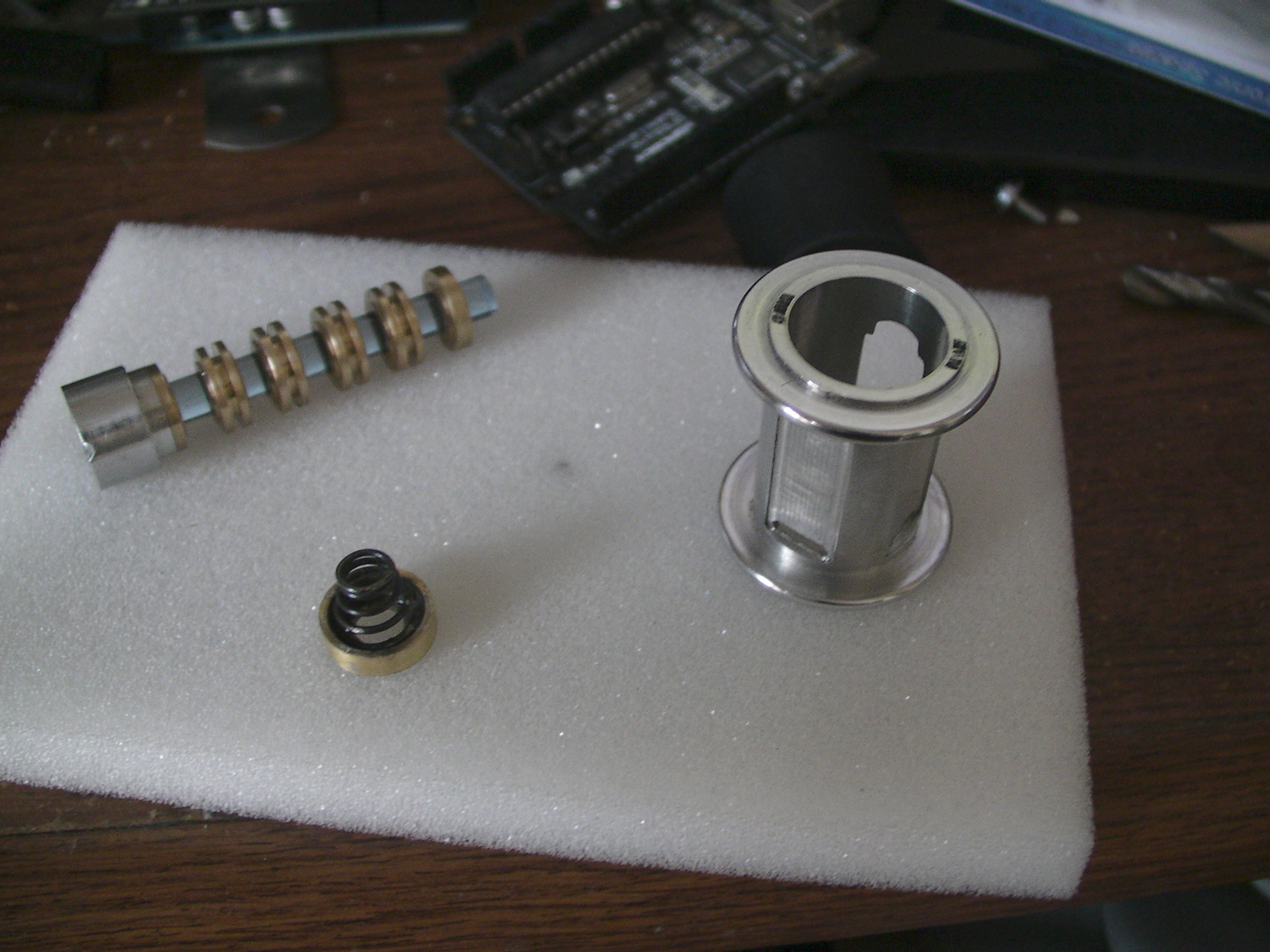

So without further ado, a picture of the new bobbin, the bottom spring contact and part of the central core of the sonic.

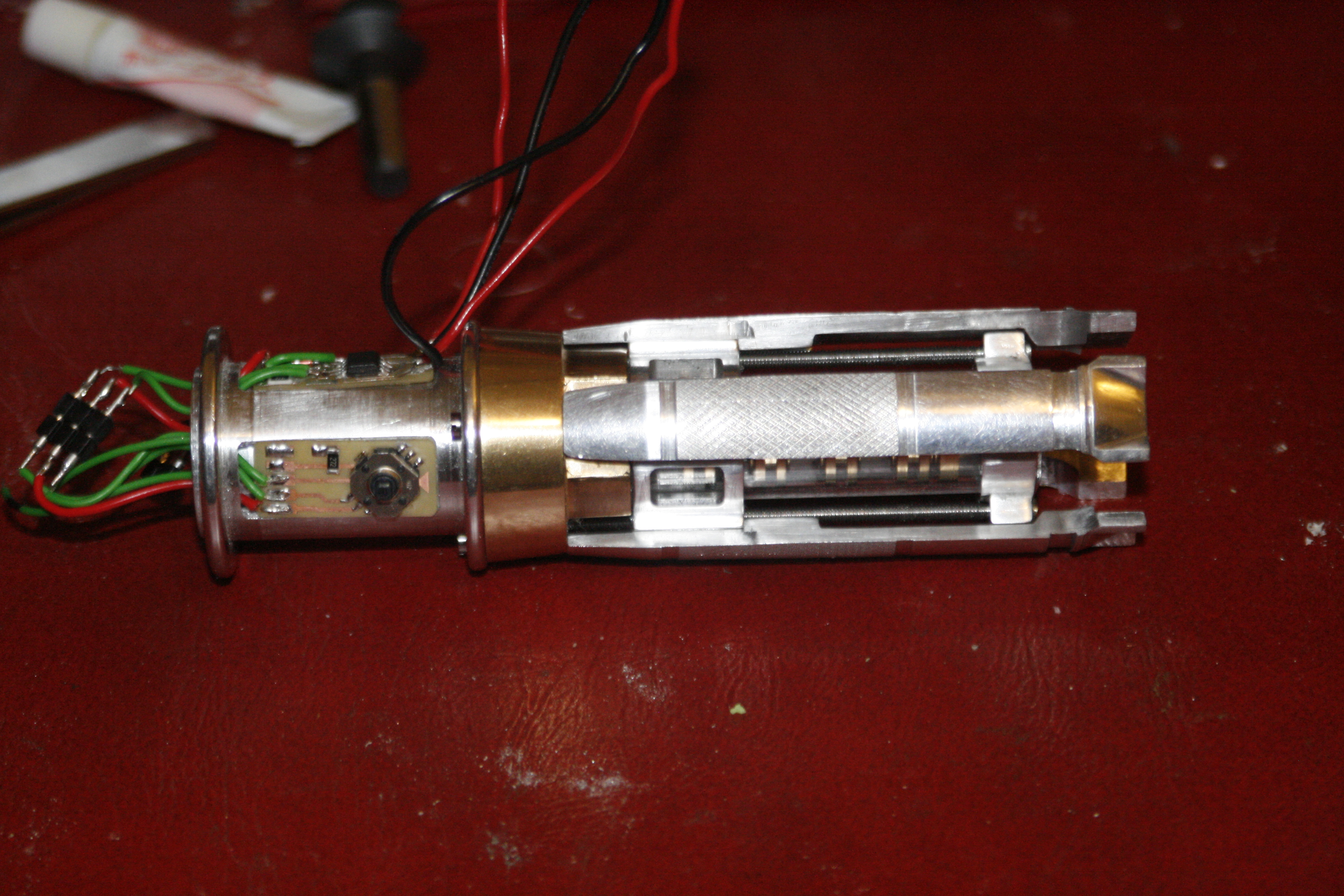

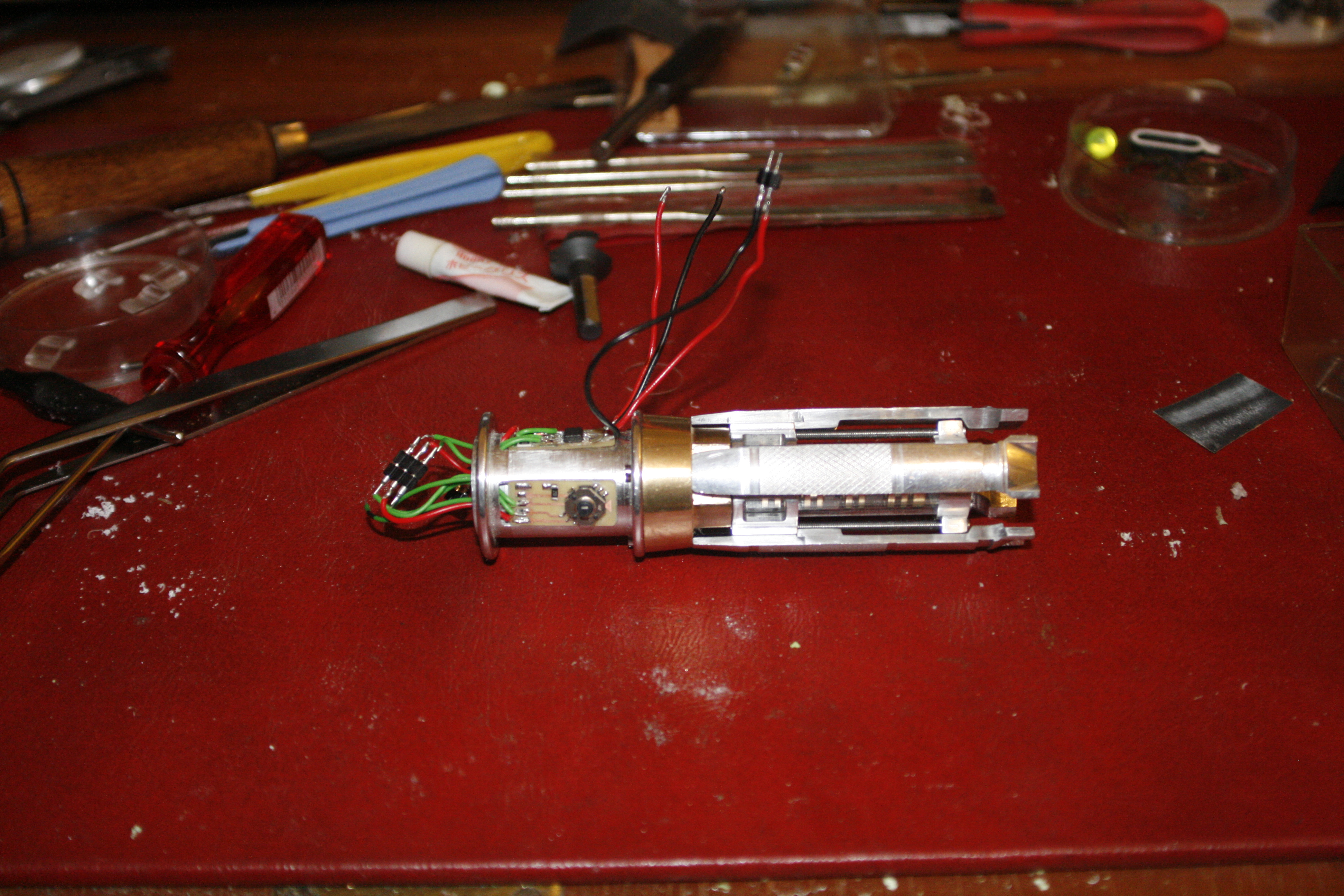

So another update. I am still moving forward and finally the electronics are coming together. I have temporarily installed the control switch and motor control into the handle, in order to work out how to route the wiring. There is still so much to do, but now it seems to be coming together. The support arms for the emitter are now reworked and fit correctly without fouling the top. I have some very dark blue acrylic to make a bezel for the switch, and will make a control switch from aluminium to fit into it. The clear outer tube tube has been shortened and I need to take a millimetre off of the blue centre tube. I am still ambivalent about installing the sound part of the sonic. With the proximity of the speaker to the motor, there might be problems with interference between the circuits.
That's all really for now so here are a few of pictures for you all. Just to whet your appetites.

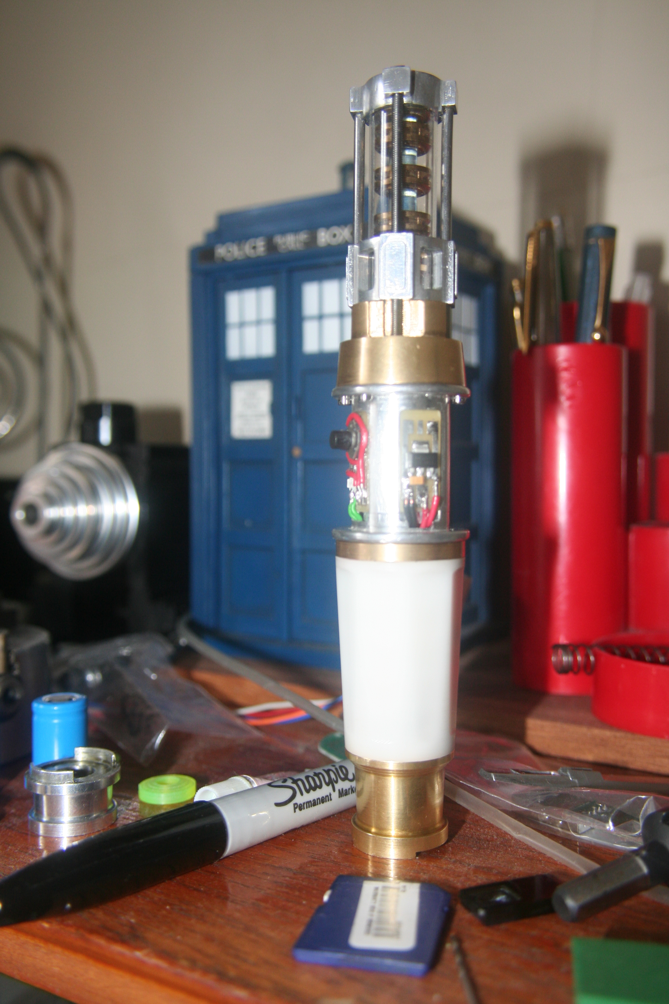

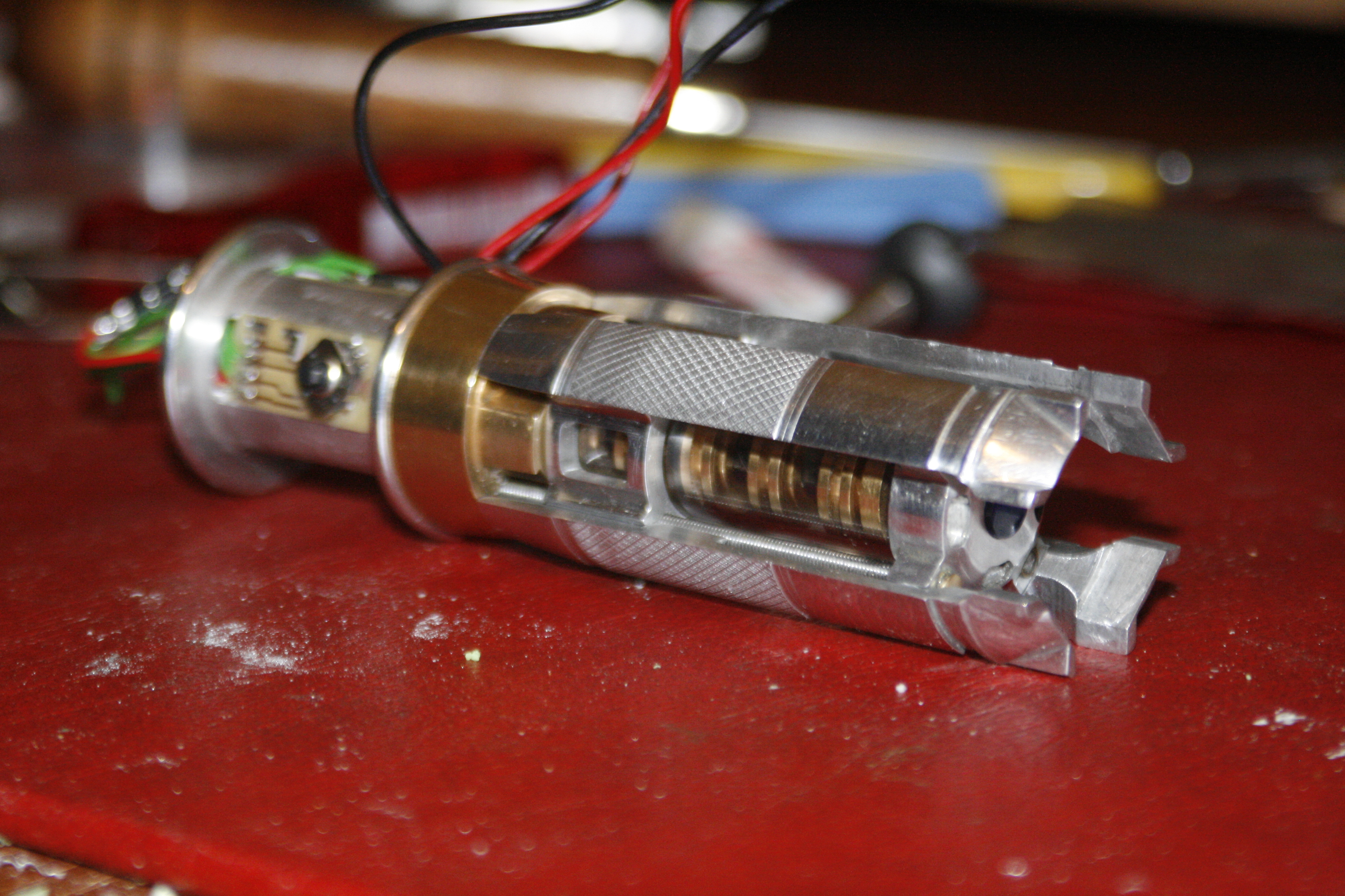

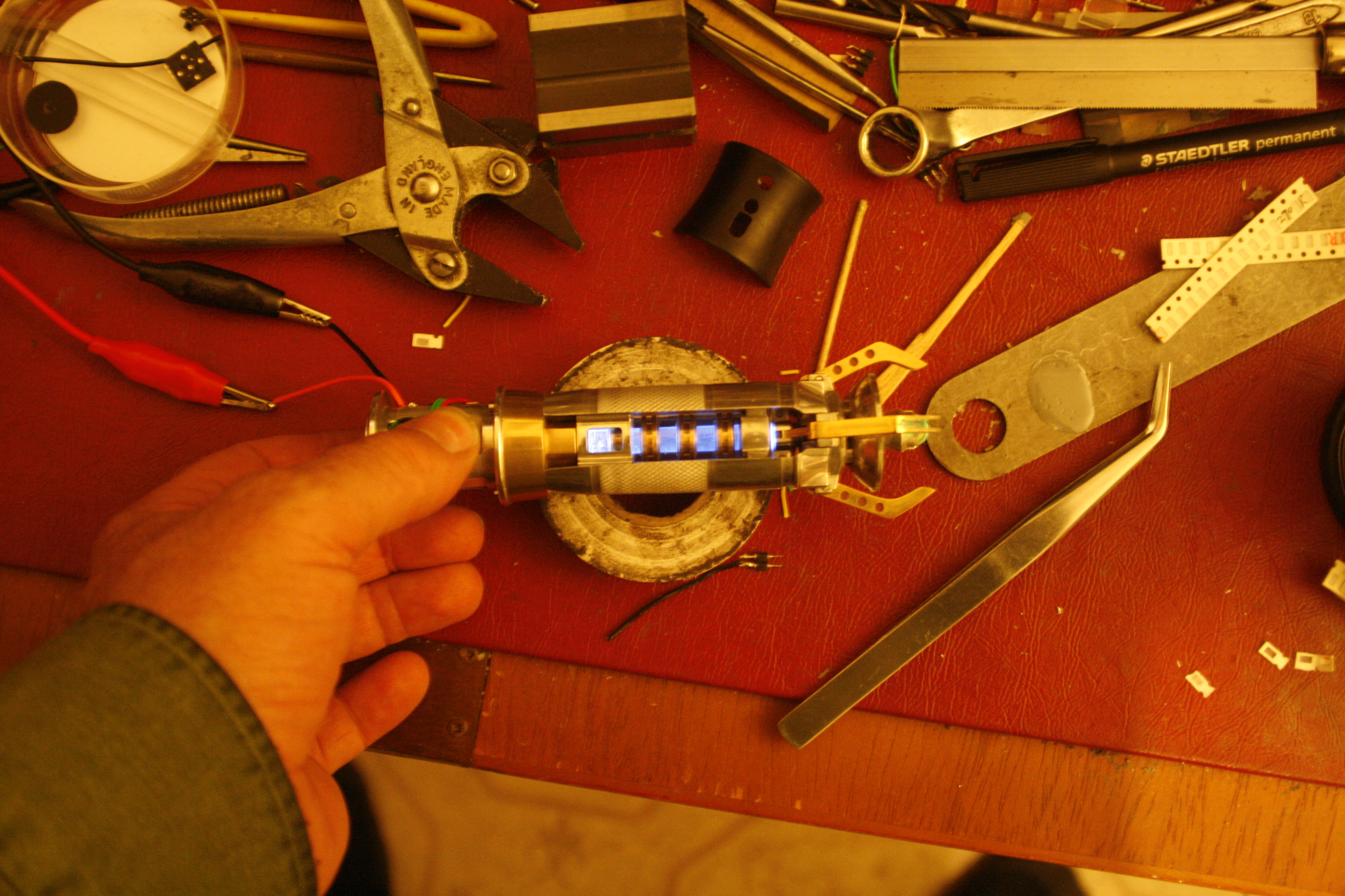

Final assembly is underway, still mostly concerning the electronics, particularly testing them in situ. Soldering up the wiring has proven to be a Right Royal Pain, with one track pulling off of the circuit board for the motor controller. The wire to the motor was resoldered at a point further up the track. The biggest problem has been getting the solder and soldering iron in between some of the wires to solder up connections. So now for the most part the electronics work. I just need to hook up the battery monitor circuit and test it. I may need to batter this part into submission as there have been some changes to the original layout, which haven't been tried out yet.

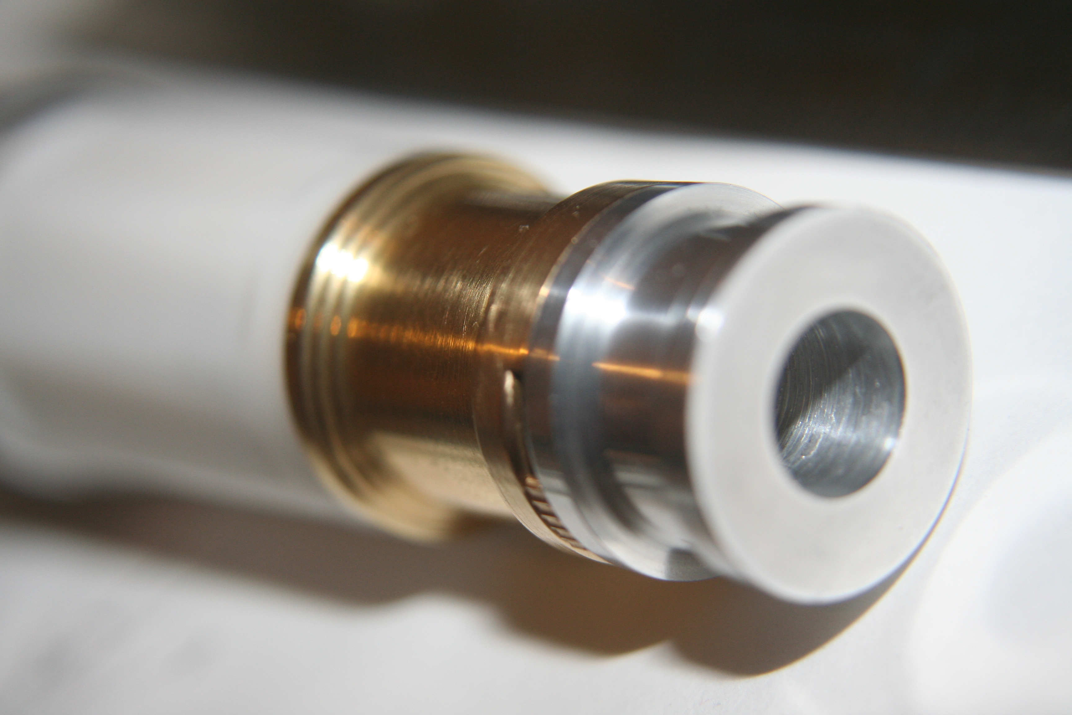

Finally for your entertainment, a couple of pictures, one is a special treat, with the screwdriver powered up and centre column lit the lighting is poor in the second picture as the flash was switched off to avoid washing out the lit column.

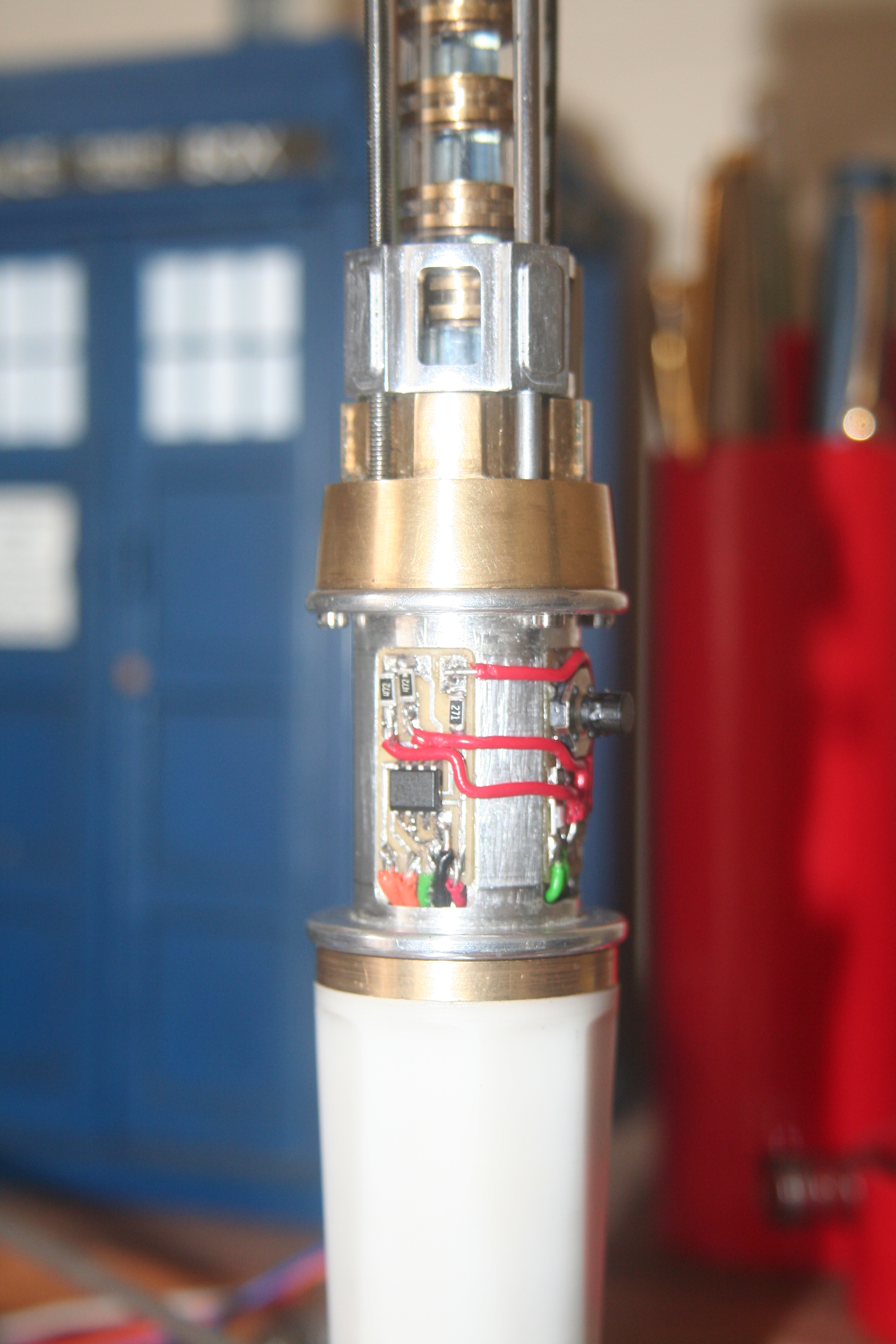

Not much of an update, more of a drive-by than anything else. I hit a small snag this evening. Well everything to do with surface mount electronics tends to be small! Any way, I was working on the last part of the electronics, the battery monitor circuit. I did not want this to run continuously, so introduced a transistor, that would switch on the circuit when the sonic screwdriver was activated. When I powered up the circuit, nothing, no LEDs, nothing, at least also no magic smoke. So off to troubleshooting. It turns out after a little work with a simulator that where I had used an NPN transistor, I should have used a PNP type. Those letters actually mean something :facepalm Who'd a thunk it! So off to de-soldering the transistor. The correct version has now been ordered and as we speak is winging it's way merrily to me for insertion into the circuit.

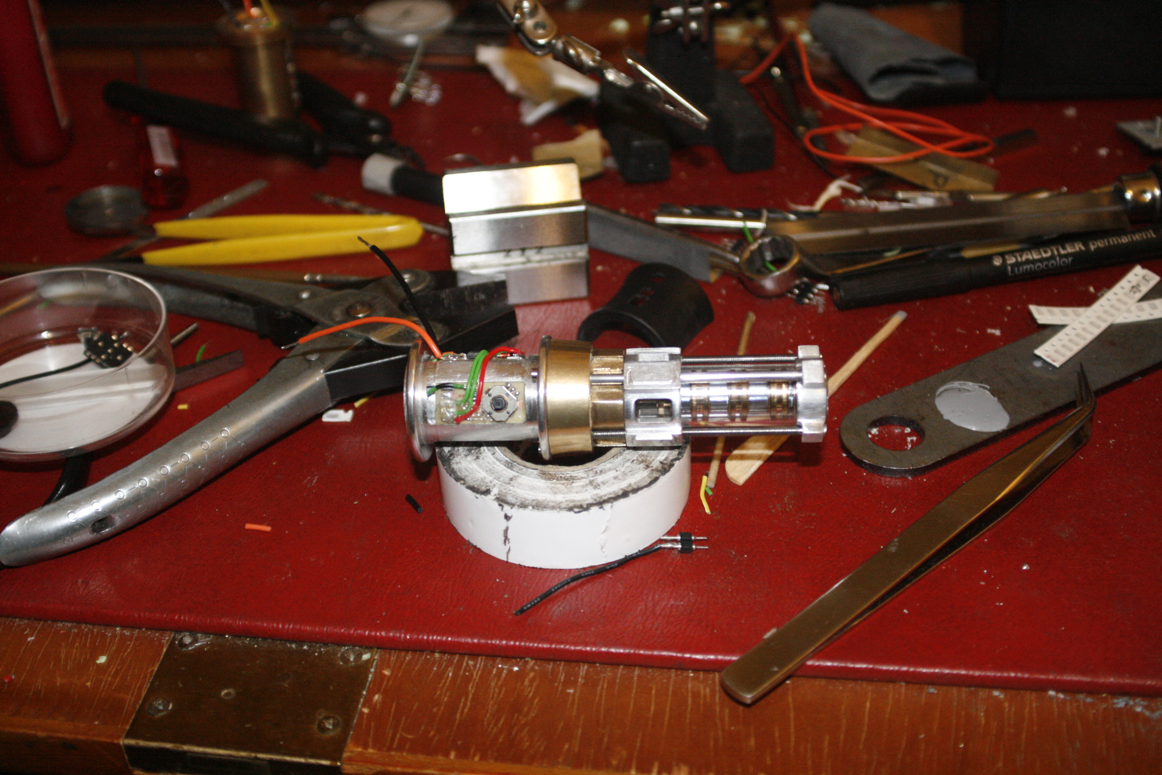

So, all of the electronics are complete, and the screwdriver has been tested electronically and mechanically in it's final configuration, and it works. The LEDs light, the motor works, so all that is needed is the final assembly, cleaning and polishing. I also have to finish the battery charger, which is mostly done.
A couple of pictures of the Sonic before all of the electronics are covered and it is finally assembled.

So one more picture with part of the black part of the handle in place, including the control bezel.

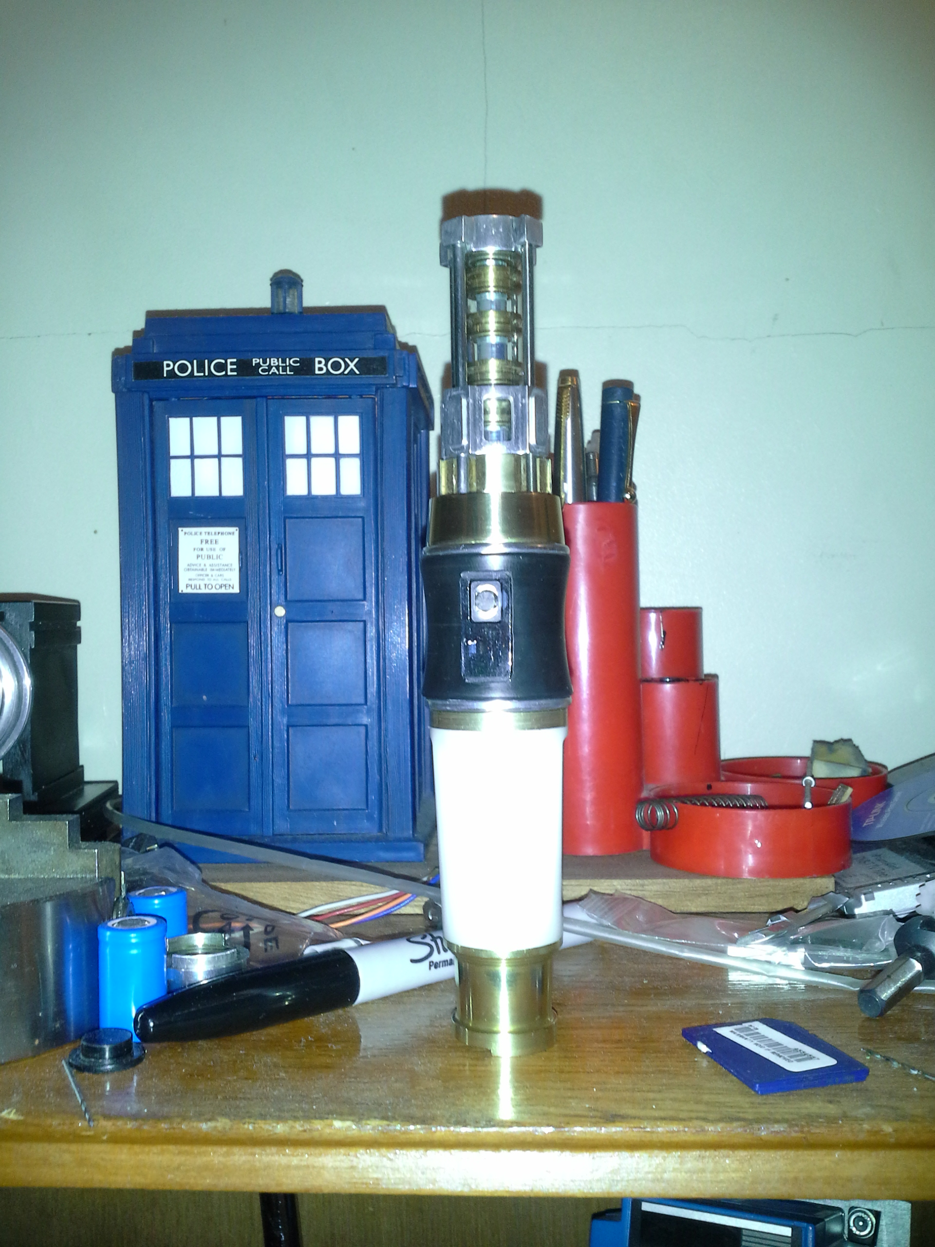

Nope. Not that easy. time for a little tease...
FIVE
IMG_3377.JPG...
