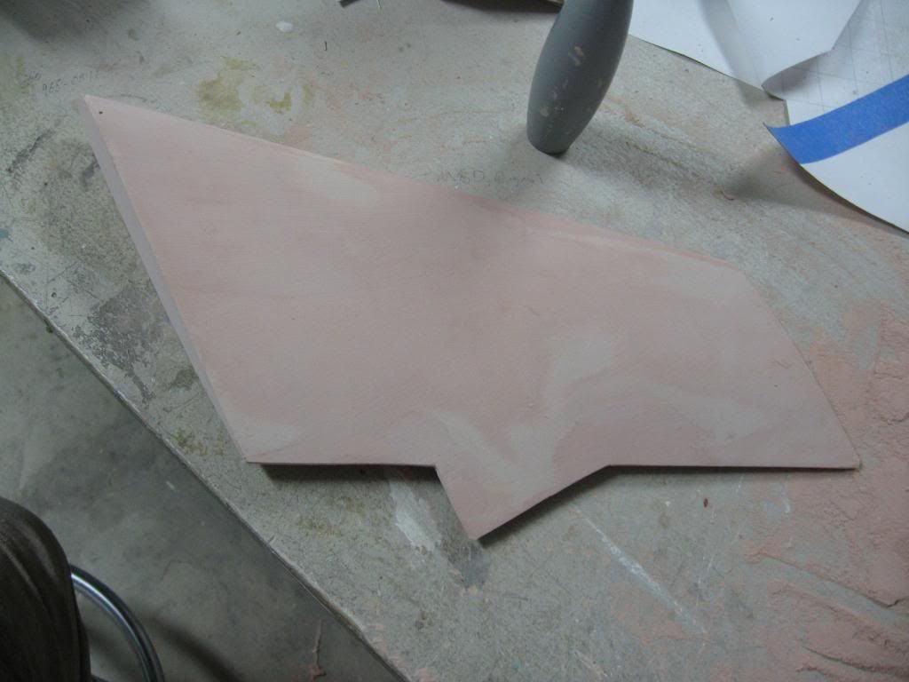

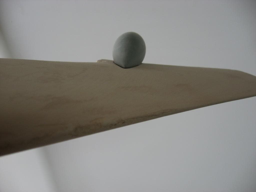

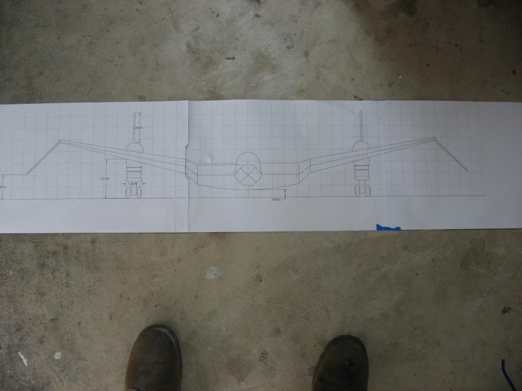

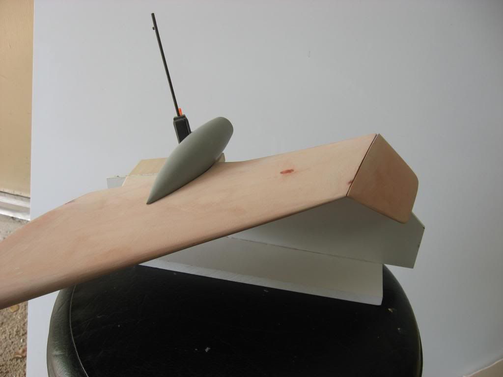

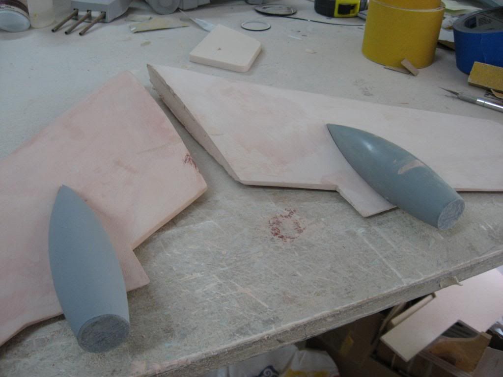

While the laser cutter is cutting the patterns for the wings and the body, I did a quick and dirty mock up of a wing section to see how I wanted to attach the engine nacelle. I decided on cutting the shape in the wing and leaving the nacelle whole. heres a few pics of the plans and the mock up.
Thanks for looking
Al.

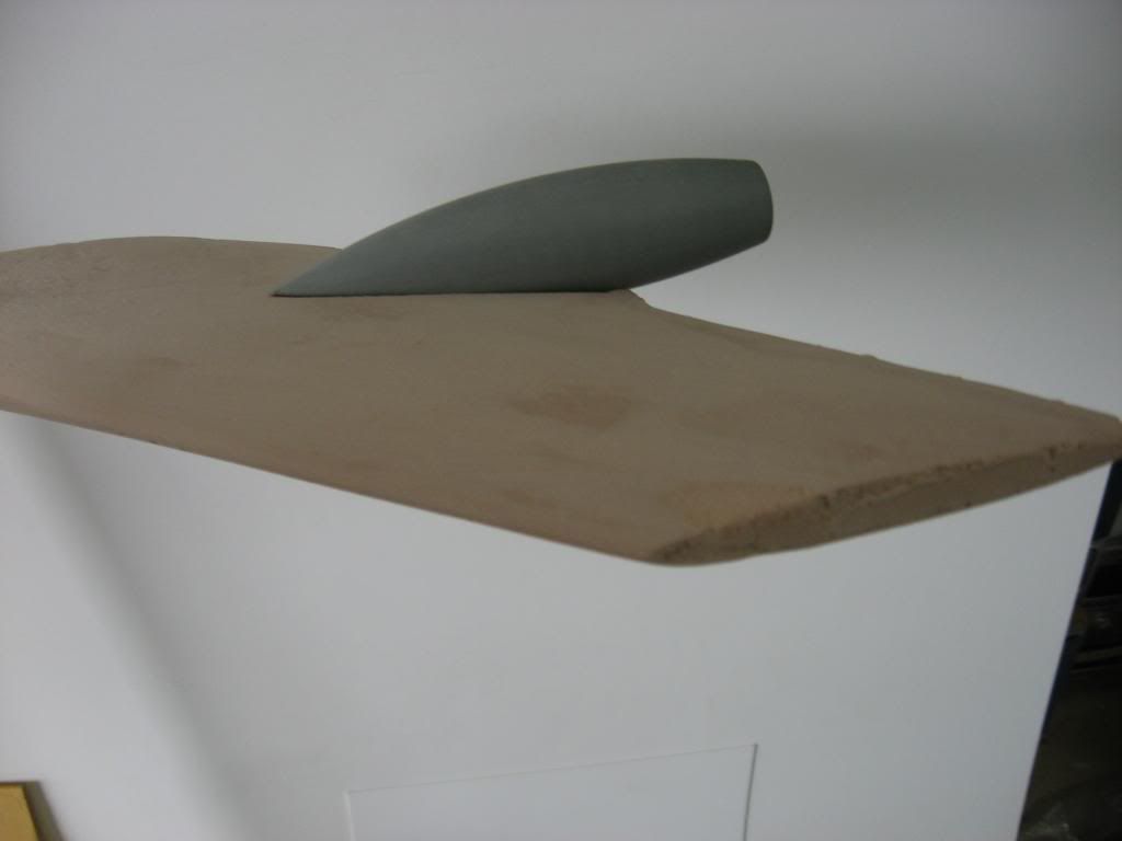

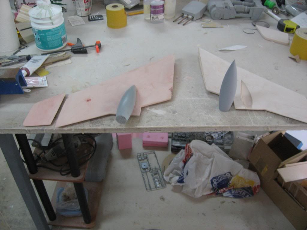

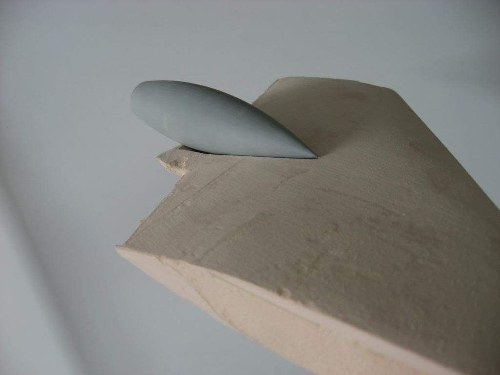

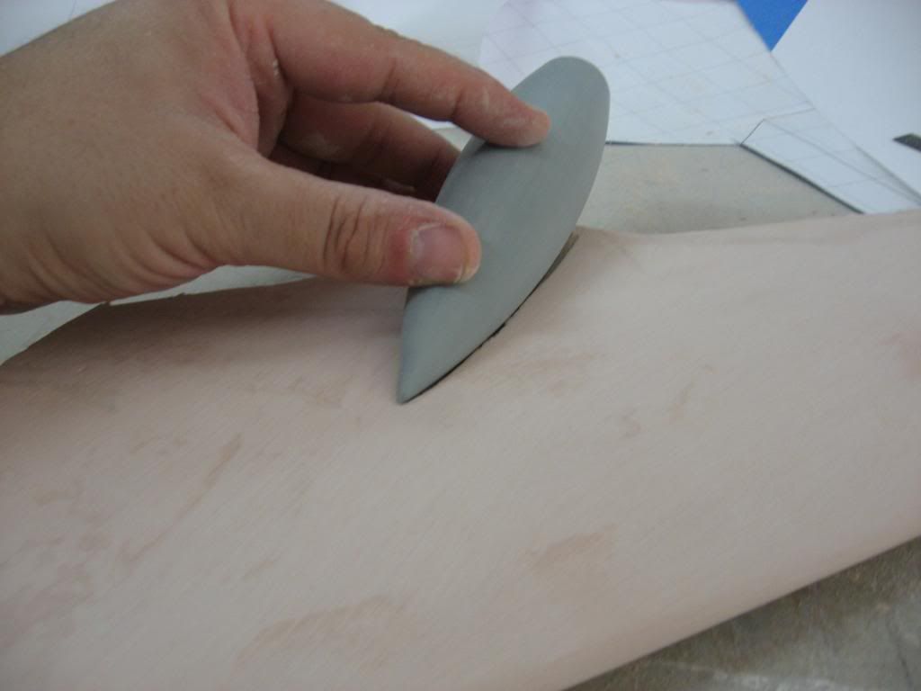

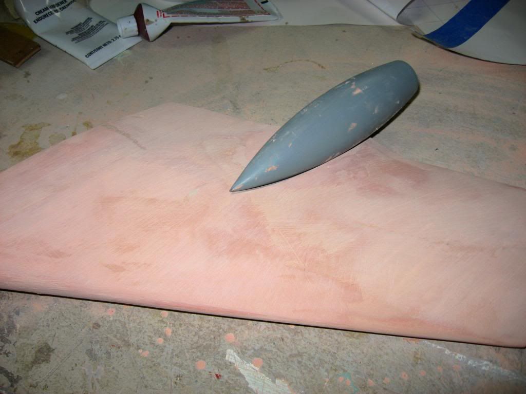

Ok, Got one wing ready for primer. I did the old wax the part and fit with bondo trick. to give me a perfect and smooth contour on the wing. next ill get the other wing done and then the wing tips. then concentrate on the center section. hope you can see whats going on. take better pics once theres some primer on it.
Heres a few pics.
Thanks for looking.
Al

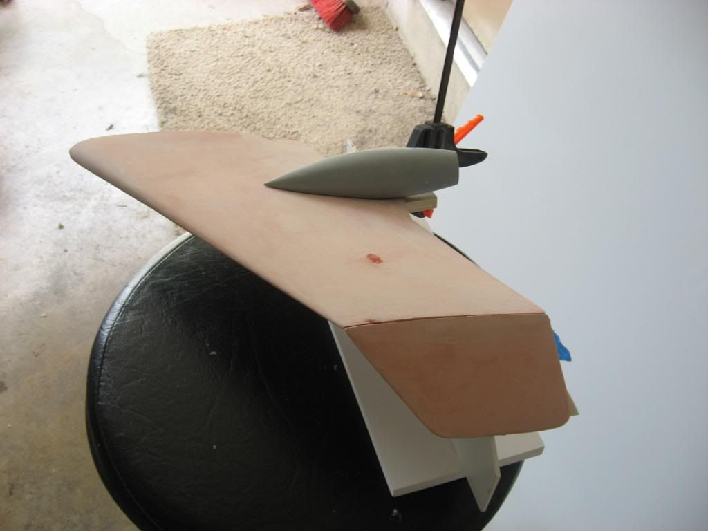

Re: WINGING IT, Raiders Style

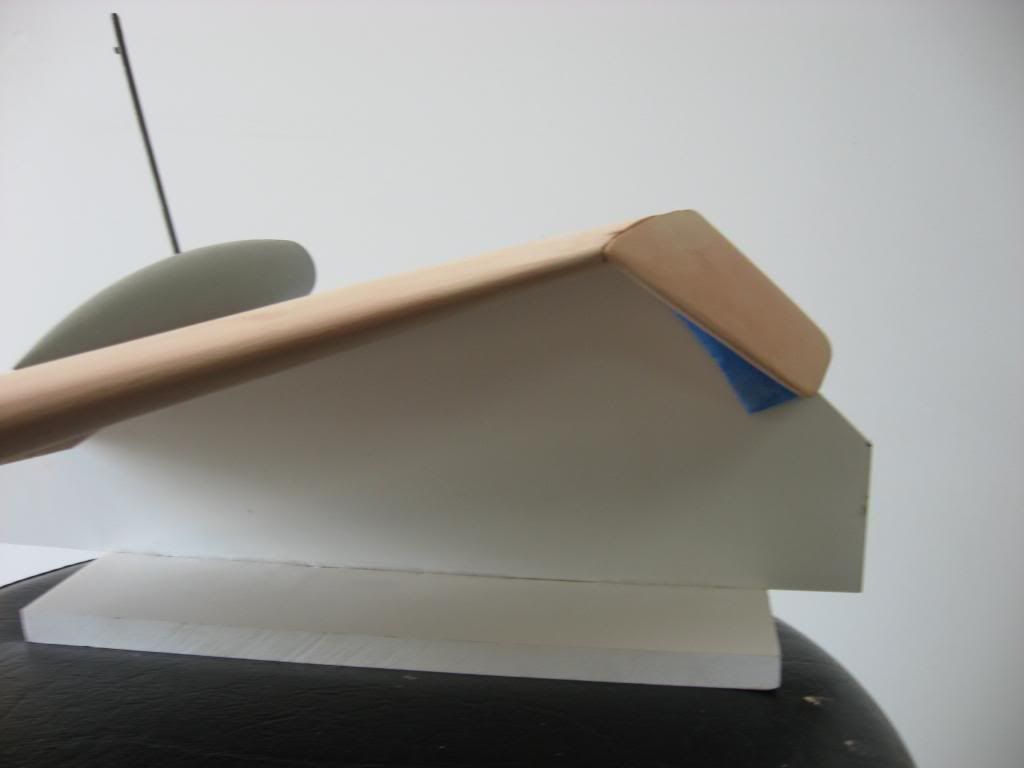

Started on the wing tip for the first wing. made a quick fixture to index it and get the proper angle. and also started on the other wing. fit the nacelle.
Next ill fit the wing tip. then start on the center section. Im having such a good time, ive decided on my next raiders project check out the last pic.
Thanks for looking.
Al
