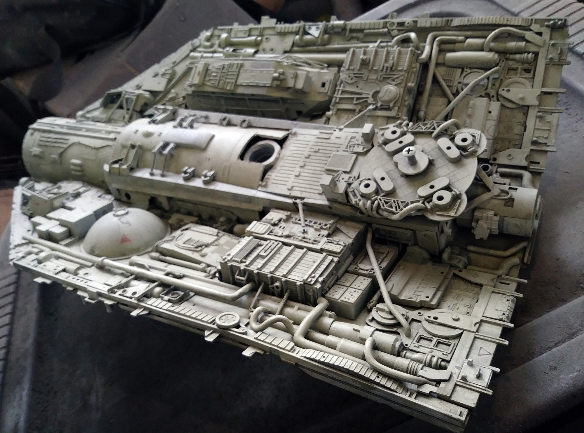

Decided to tear off the Phantom drop tank halves:
attachment.php
...and go with part of the Fruehauf Tanker:
attachment.php
Gussied up the exposed edge:
attachment.php
Needed to fill the gap between it and the Saturn stage, so I used the remaining half of another Monogram Saturn part that I had cut down for use on the upper hull:
attachment.php
It didn't reach the bottom, hence the 8rad parts.
But you could still see in there:
attachment.php
...sure, only if you're REALLY looking, and only from certain narrow angles. Heck, the Galactica had big honkin' open spaces visible down its Saturn halves.
But I just had to put something in there.
So I made this ugly thing with sheet styrene* and a rubber tank track:
attachment.php
attachment.php
*another fake sample credit card as seen on the unpainted upper hull earlier in the thread. If it's styrene, I keep it!
There we go.
attachment.php

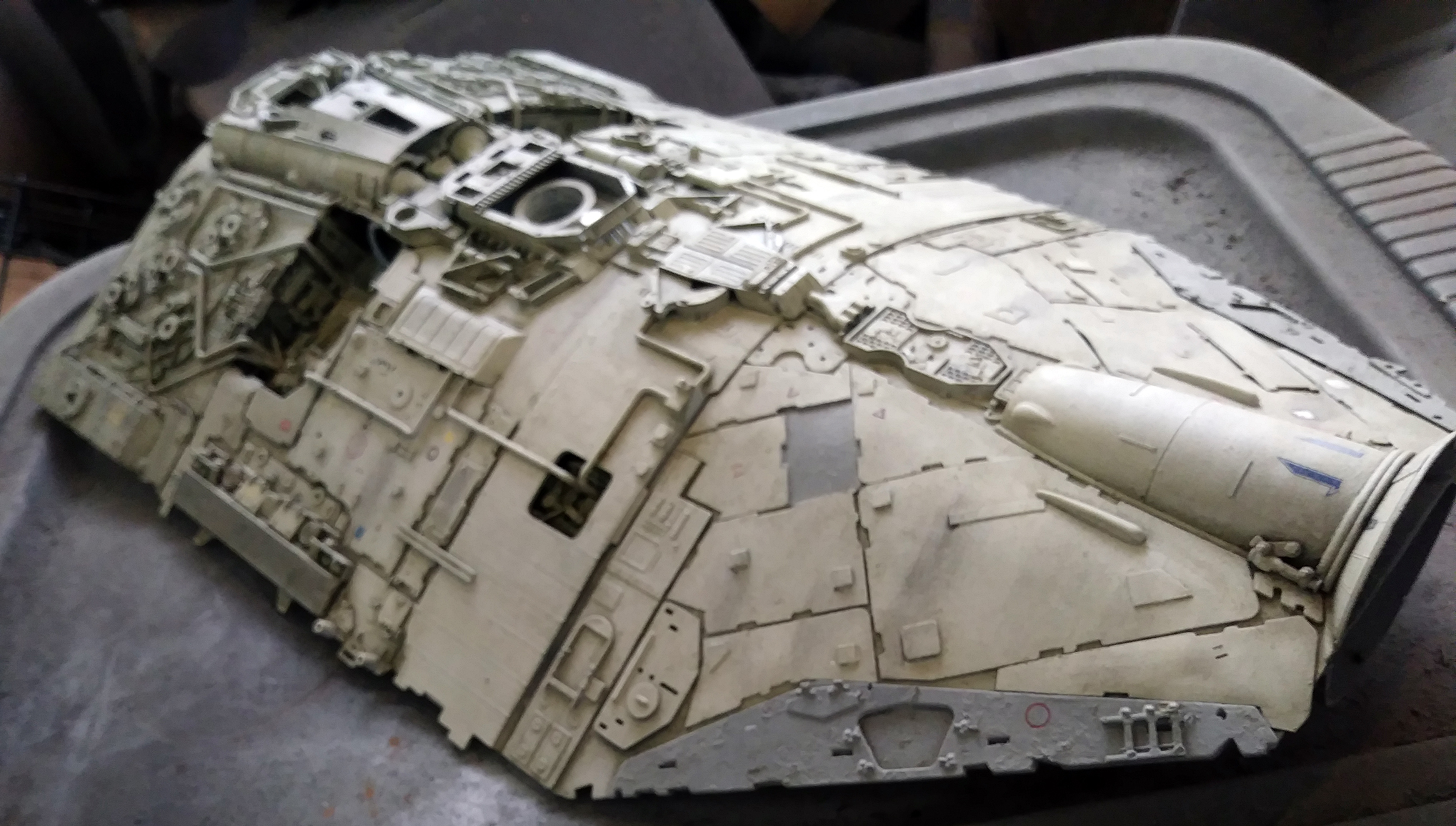

Gave it a quick paint job. Alternate mistings of Modelmaster Camoflage Grey and Tamiya Insignia White. The latter is rather cool, and the former too warm, but I like them together. You can kind of tell where some areas got more of one than the other, but that's okay. Gives it character. (And there's still weathering to come.)
IT LIVES
(dear jeebus, I started this NINE YEARS ago?!)
I was doing some washes on another model so I dragged this one out. I used Vallejo Streaking Grime. I then did some streaks with India Ink.
Many happy accidents on this:
-A few chips fell off a while back, revealing bare plastic.
-A decal or two also fell off, revealing an earlier paint pass.
-A plate fell off and I decided to leave it off and paint the recess gray (or maybe I originally left it off intentionally, I don't remember at this point!).
-A plate warped and fell off and I glued it back on, even though it's buckled.
-An experiment with a red color on those long pieces on either end of the nose I ended up not liking, combined with pre-masked paint chipping I also didn't like, resulted in a rough texture when I painted gray over it.
I love them all. They stay.
I made some of those ILM ESB Falcon "equal signs" and "L's" and such with extra fine Sharpies (both black and red) and a stencil. Likewise some triangles and other trapezoids.
Also did washes on various mounting point covers:
I will do some dry brushing with base color for some highlights, but otherwise painting of the main ship is done:
20180909_155315.jpg20180909_155328.jpg20180909_155413.jpg20180909_155346.jpg20180909_155405.jpg20180909_155256.jpg20180909_155359.jpg20180909_155248.jpg20180909_155307.jpg20180909_155339.jpg
Now to finally paint the engines and decide how I'm attaching them. And come up with a mount for the dish.
