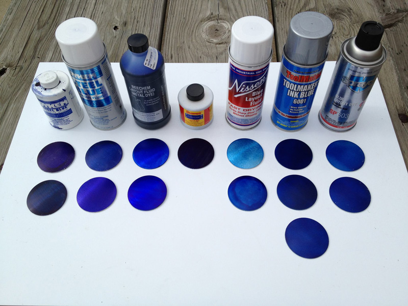

It wasn't until looking through a thread on Astromech where kimncris was machining some of his own aluminum parts as just mentioned above and using a machinist layout dye that it all fell together. The blue of the dye was perfect! it matched the highlights, had the dark blacks, in some shots a slight purple tint, and the thickness issue seemed to be totally gone. Its basically a permanent maker dye.
There are a LOT of machinist marking dyes out there and I started researching as many of them as I could get my hands on. This pic shows some of the test samples....
I kept coming back to the DYKEM brand Steel Blue dye. (the two left most samples in the above pic) The same stuff Kimncris was using. Strange but true coincidence. That brand, different than the others, also has a brushable AND rattle can version. It seemed perfect.

We didn't want our droids to look purpleish in person even though the DYKEM is in all likelyhood technically correct so we had to find an alternative. What we came up with after a bunch of testing was an automotive clearcoat with a candy blue tint mixed into it. The color we found and ended up using is a Dupont Hot Hues True Blue Candy Tint that we mixed into our clearcoat. Then sprayed through an airgun in multiple coats until the desired darkness and color were achieved. It photographs virtually identical to the DYKEM Steel Blue yet looks great in person.
