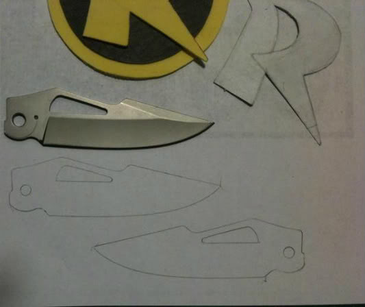

I took both knives apart, set the handles aside, and I traced one of the blades twice to make two stencils.

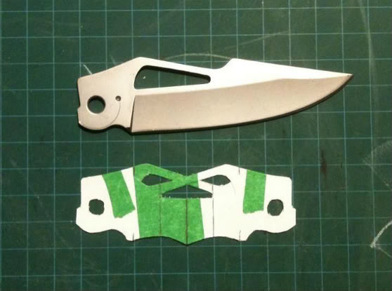

I cut the stencils out and taped them together so the blades overlapped symmetrically. I trimmed the blade portions so I had a stencil of just the rear of the blades. This would allow me to later connect the two handles to each side like wings.

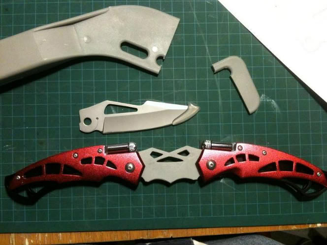

I then traced the stencil on a piece of plastic the same thickness as the blades. In this case, the donor plastic was a dollar-store floor-hockey stick.
Missed a picture/step, but I cut out the stencil and cleaned up the edges to the exact size of the blades. I then reassembled the handles around each end of the plastic piece I carved. The result is a passable generic Birdarang. The middle portion could look like anything you want, so long as you get the connecting butt of the blades exact.

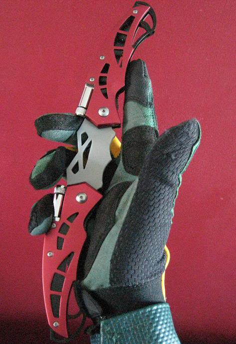

And it folds using the original mechanism so it can hang either tucked in a belt or with a loop of velcro.
With the sheer number of ridiculous folding knives you have no end of possibilities for custom batarangs to fit any theme for about 20 bucks. I wore it to a work party and it felt substantial, passing as a high-end prop without having to worry about passing it around or dropping the thing. Plus, lights!

Have to say, having only held plastic replicas and toys before, the weight of this is nice. I need a quick release way to hang it on a belt, because you feel pretty badass drawing it from behind a cape with a flick as both wings lock into place.
