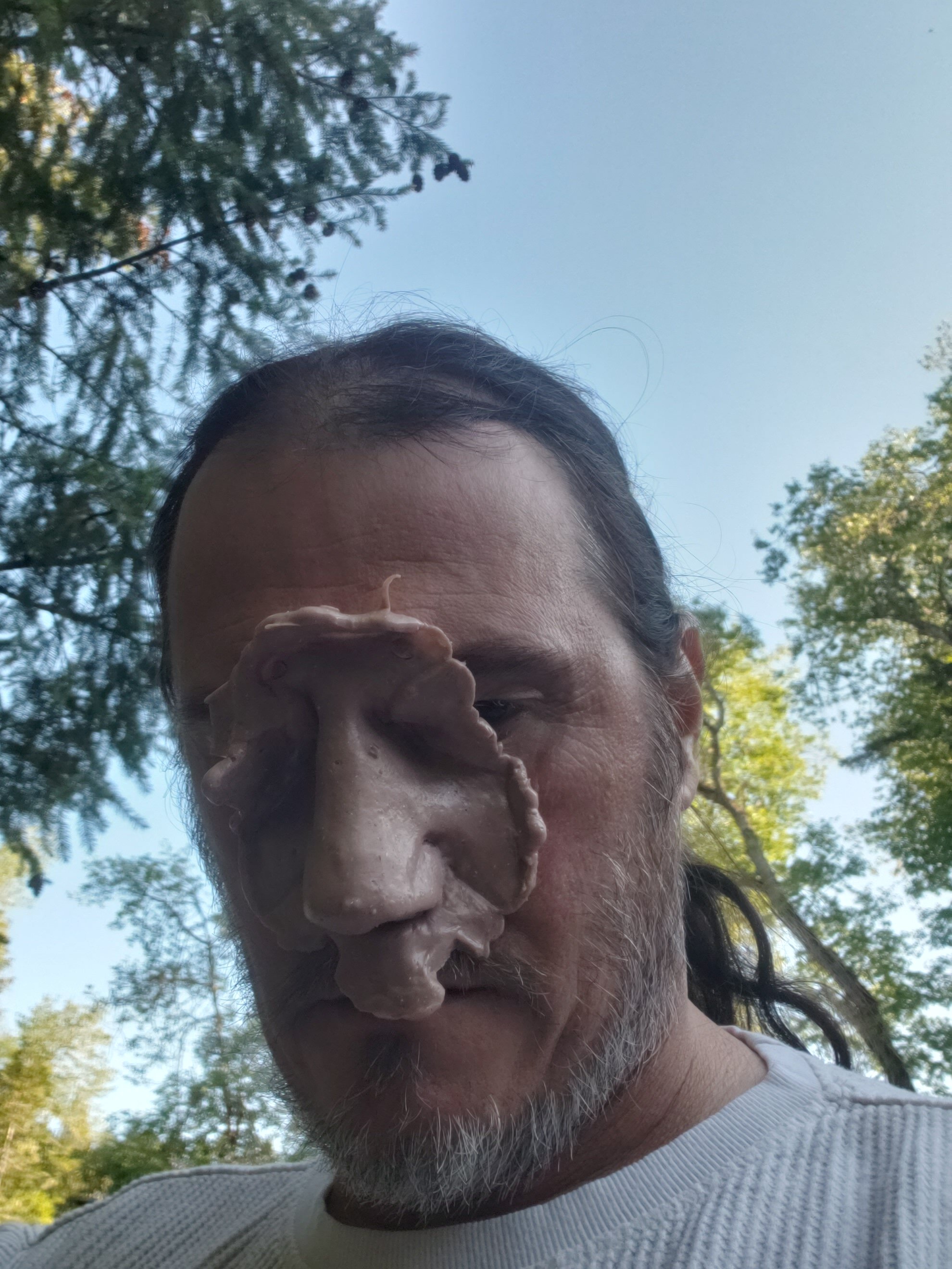

Well, my May the 4th efforts ended about as successfully as Qui-Gon's fight with Maul. I pulled out my pile of stuff and started into a new pour for "the nose". The gelatin was stringy and clumpy, even with only gentle heating. The color had changed over time to zombie gray and I could not bring it back around to pinky tan. But, I plowed ahead. My pour was hardening rapidly..... because I forgot to heat my plaster mold. The mold itself was hardening the gelatin by cooling it too fast. When all was clearly not closing completely, I still attempted to use it.
It is at this point that thin edges are no longer possible. In order to get the thin edges, the liquid pour must stay liquid and the mold must close completely.
But I plowed on and on, knowing that at the very least, I was getting my short course in remembering how it is done THE RIGHT WAY.
I had bubbles, holes, thick edges, everything was looking pretty gruesome. I had some silicone filler from Dermaflage and was able to correct all but the thick edges.
The edges were far too thick and I did not have any bondo to lay on them to feather the edge. Right at this point my pros-aide began to release. You can see it in the tip of the nose as it is pulling away from my face.
So, I relented to Qui-Gon's defeat with the following tips gained:
1) Gelatin ages and becomes more opaque and gray. Use new batch (it has been years).
2) Pros-aide also ages, buy new
3) Purchase bondo cream for the just in case moments.
