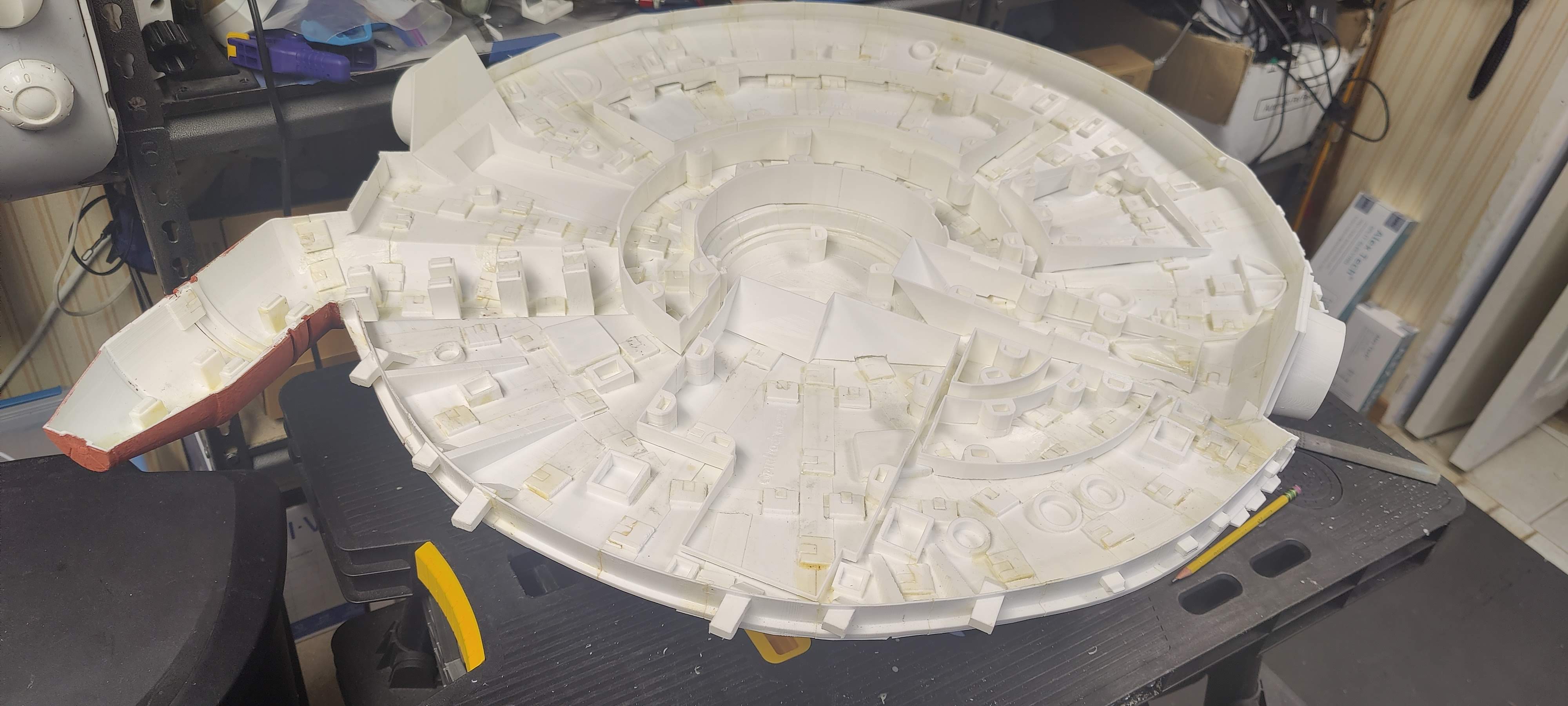

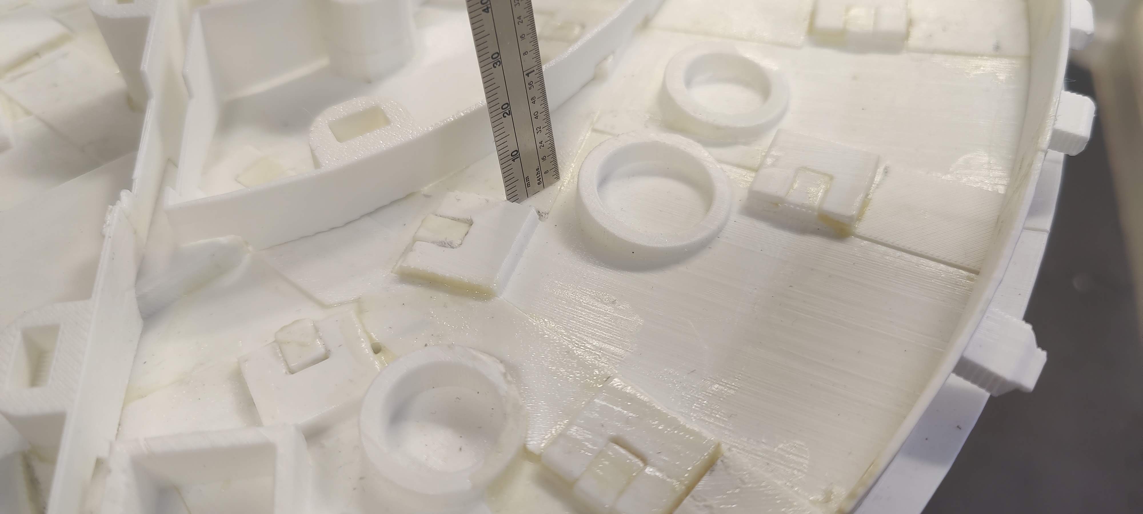

Sorry if this has been asked before, I searched but didn't find anything. So I'm working on a Millennium Falcon found at gambody.com (Millennium Falcon 3D Printing Model | Standard Assembly Kit) I'm pretty close to the point of painting the inside lower portion of the ship, but after looking at it and given that it printed in PLA and doesn't have "perfect" seams I want to cover and fill the bottom of the ship so that the "coupler" pieces are all covered and I have a relatively smooth/flatter surface for the black paint to go on so all those "coupler" pieces are hidden from view. See images. I'm looking for recommendations on a light weight (this thing is going to be heavy once done without it) but thick mostly liquid item to put down to "fill" in the bottom. I don't want to use expanding foam as it will get too think, and I think bondo would be too weak/crack a lot. the ship as of now does flex a little. but once this is done I think it will be more rigid. I do plan on running wires / leds / fibers to many location eventually but I can worry about that later, once I get a plan going.

Would those parts not be covered up or otherwise hidden anyway?
I think mostly, but some of the cover parts are pipes and whatnot, I think I may just paint it all flat back and should be good enough. I don't think there is really any good, easy filler I could use.
